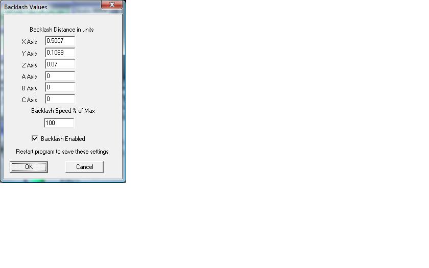

2. Figure your backlash in all three axis. Try to get as much out as possible but there will always be some to deal with.
3. Once you reduce your backlash as much as possible it is time to setup Mach3's backlash comp (works great on these machines). Set the backlash of each axis, set Speed % to 100. Now go into General config and set your shuttle accell to 0.005 (if this number is larger it starts causing pausing during direction changes).

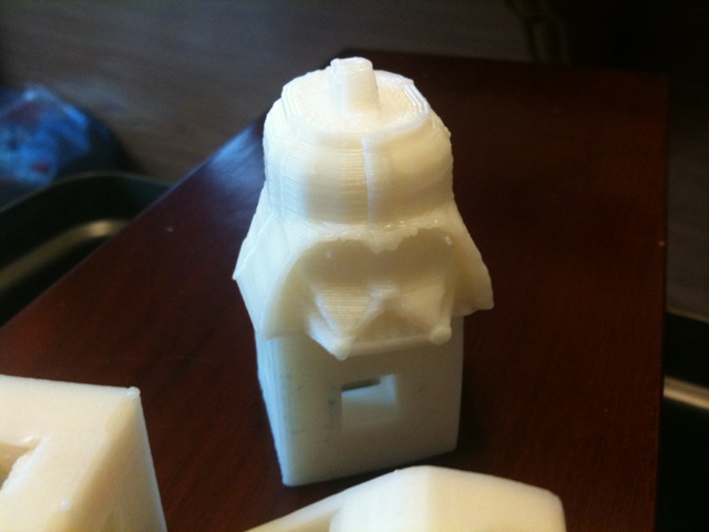

Here is Vader key chain done at 0.30mm layer hegiht
0.30mm Layer height
0.30mm Layer height
Here is two cubes, one done before calibrating axis and setting backlash comp in mach at 0.30mm (left) and the second done at 0.20mm to the right. Notice the improvement in the bridge!
Lastly two tone whistle done at 0.15mm layer height. I was astonished with this one, it was the best print yet!

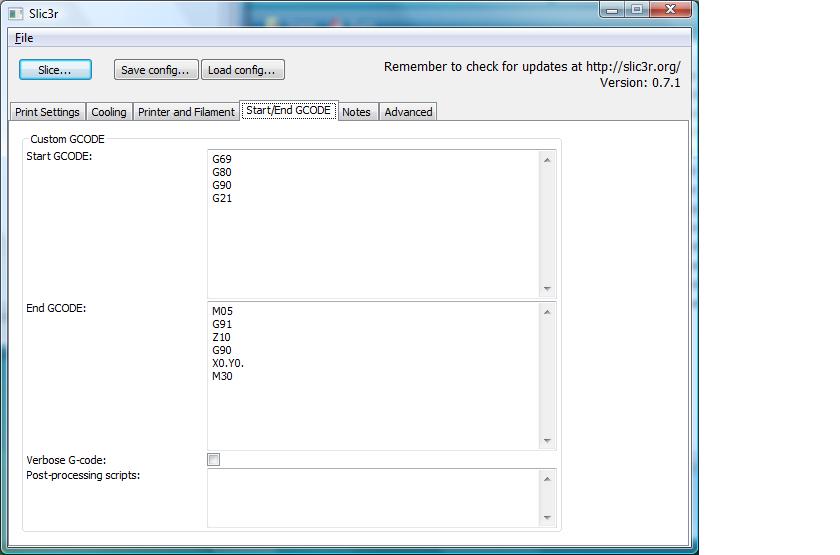

OK, here we go loading up screen shots!
Calibration: Found in the Settings Tab
Resulting motor tuning from calibration
Calibrate A Axis will 100mm/min or less to get a accurate steps per setting. I guess my Accell is higher than I stated above... Problem with trying to remember info! LOL
Slic3r Settings for 0.3mm layer hieght (just what I started working from)
Hope this helps.

How did you determine your backlash?
Re: My Slic3r Results
Posted: Wed Mar 28, 2012 2:59 pm
by cquinby
Dial indicator or DTI on each axis and coverted to mm from inches.
El Hoss has a good video on the concept. http://www.youtube.com/watch?v=buXHZ_McbOY

Just watched the video. do you recall how much backlash you found on your machine?
I will be testing this next chance I get.

Dave_Sohlstrom wrote:Chris Q
Sorry Dave, missed your post!!! :roll:
I have the backlash figures in a screen shot on the previous page. They are in mm as that is what the machine is currently setup in. To be honest I left my machine a little loose, I tried to tighten up the belts and did not like the results. Maybe the skatebearing mod will allow me to tighten up the backlash but for now this is working good.
