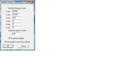

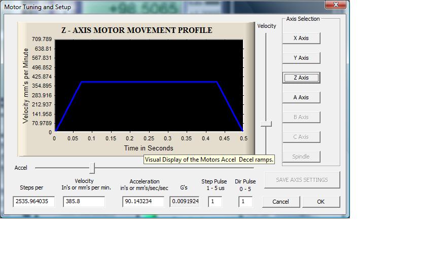

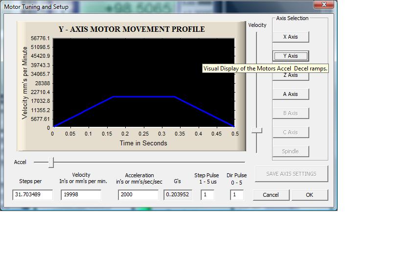

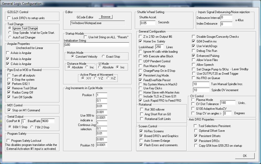

Mach3 Settings:

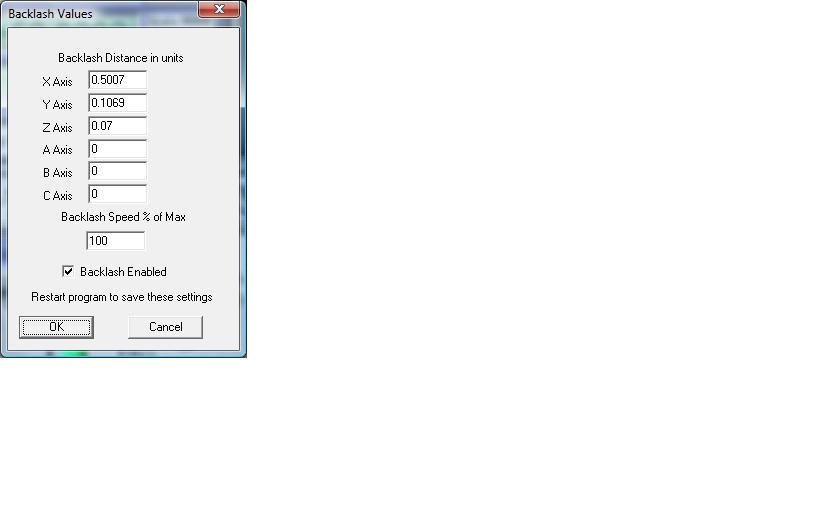

1. Get your steps per as accurate as possible, measure and measure again. (Use the axis calibration in the Settings tab of Mach3)
2. Figure your backlash in all three axis. Try to get as much out as possible but there will always be some to deal with.
3. Once you reduce your backlash as much as possible it is time to setup Mach3's backlash comp (works great on these machines). Set the backlash of each axis, set Speed % to 100. Now go into General config and set your shuttle accell to 0.005 (if this number is larger it starts causing pausing during direction changes).
4. Save your settings. (I usually exit Mach3 and restart it just to be sure the changes took.

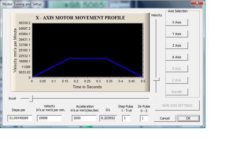

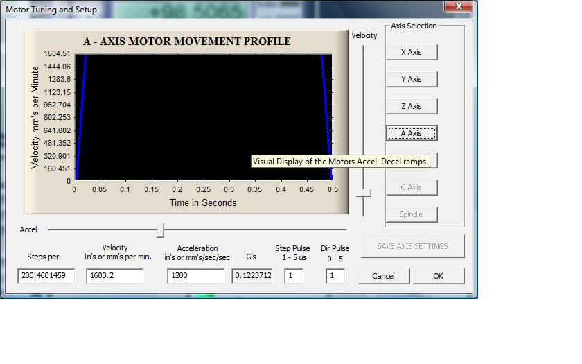

5. After you calibrate your extruder (do this at about 50mm/min) Go into motor tuning and set your velocity for A axis as high as you can without loosing steps and put the accell to about 50% of your max velocity. I found by doing this I could eliminate bulges in the filament when the X and Y stop to raise the Z axis to the next level. For example, right now my velocity is set to about 1600mm/min and accell is set to 800mm/sec. When I get to the Slic3r settings I will explain how the previous values help.
6. Save your settings again!
Now your Mach3 should be setup pretty well.

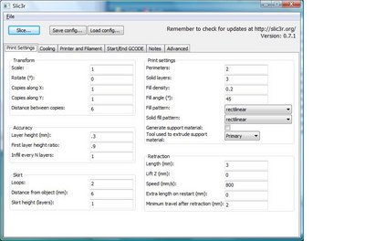

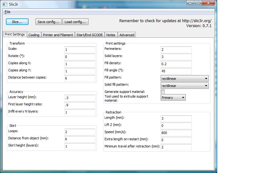

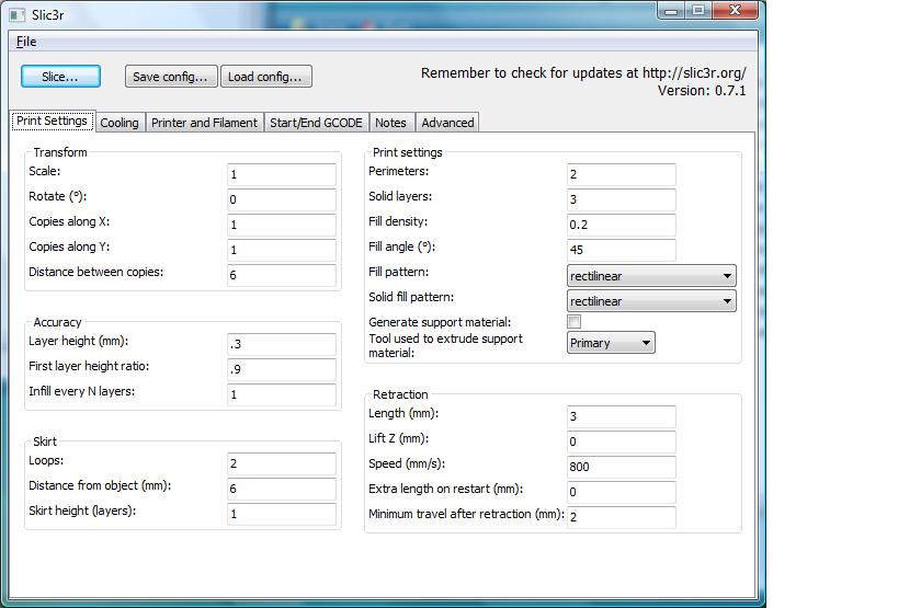

Slic3r settings that I use:
I have a few profiles, 0.3mm layer height, 0.25mm, 0.2mm, 0.15mm, 0.10mm (still working on this one).
What I have noticed is that I can go faster when at lower layer heights (more consistent fill rates).
Print Settings tab:
First layer height ratio set to 0.9
Retraction set to 3mm (this is where the faster velocity of the A axis comes into play along withe fast acceleration this prevents blobs when changing layer height and moving from one area of the print to the next) This one setting dramatically changed my prints.

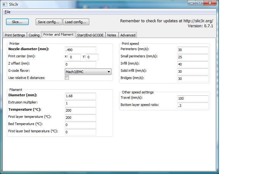

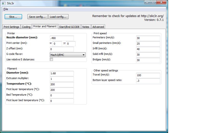

Lets key in on the Printer and Filament tab:
The figures I have changed from the default SeeMeCNC config are:
Nozzle Diameter 0.490mm (this was done as the top layer was not completely filling all voids.
Measure your filament! Mine is 0.168mm
Perimeters set to 35 for 0.2mm and lower and 30 for 0.25 and 0.30mm layer heights.

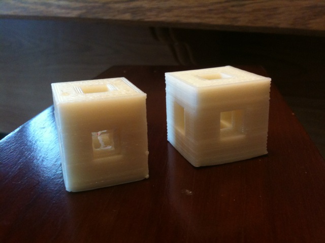

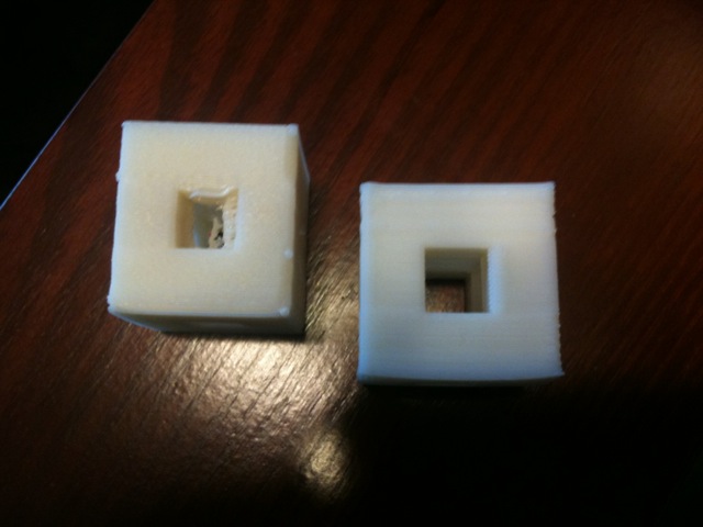

I found Bridge set to 25 worked great (see the cubes below).
Solid infill set to 30
Infill set to 40
As I drop layer height I increase speeds a few mm/sec. Adjust to your liking.

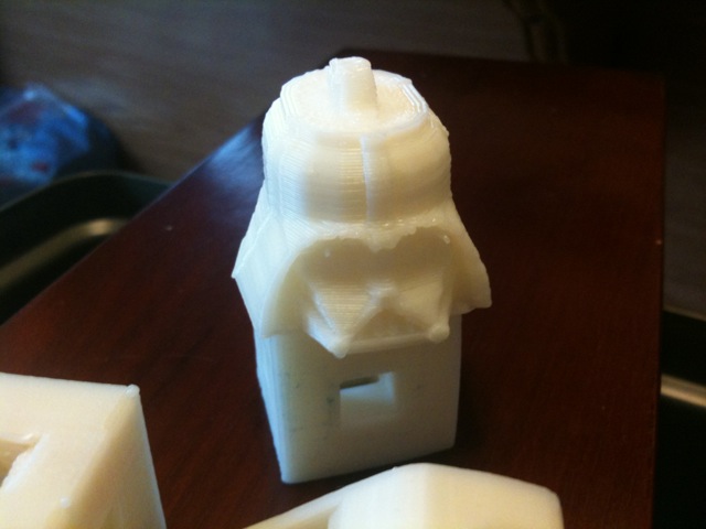

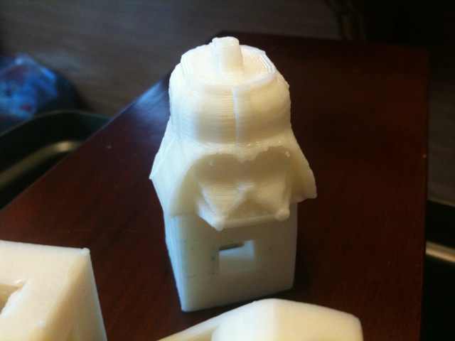

Here is Vader key chain done at 0.30mm layer hegiht
0.30mm Layer height
0.30mm Layer height
Here is two cubes, one done before calibrating axis and setting backlash comp in mach at 0.30mm (left) and the second done at 0.20mm to the right. Notice the improvement in the bridge!

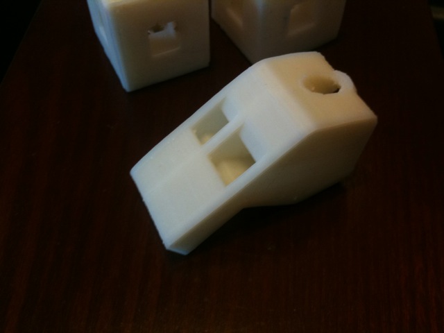

Lastly two tone whistle done at 0.15mm layer height. I was astonished with this one, it was the best print yet!
I hope this helps some folks out! Been at this for a week and finally feeling like the parts are coming out as expected. Now off to modify the H1 to accept a MK1 heat bed!

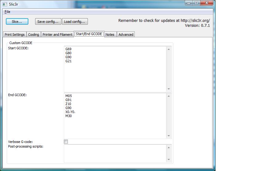

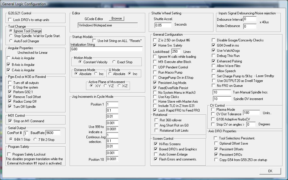

OK, here we go loading up screen shots!
Calibration: Found in the Settings Tab
Resulting motor tuning from calibration
Calibrate A Axis will 100mm/min or less to get a accurate steps per setting. I guess my Accell is higher than I stated above... Problem with trying to remember info! LOL
Slic3r Settings for 0.3mm layer hieght (just what I started working from)
Hope this helps.

Very nice.
How did you determine your backlash?
Chris Muncy
H-1 #5
cquinby
Posts: 43
Joined: Mon Mar 26, 2012 6:58 pm
Location: WA State
Re: My Slic3r Results
Post by cquinby »
Dial indicator or DTI on each axis and coverted to mm from inches.
El Hoss has a good video on the concept. http://www.youtube.com/watch?v=buXHZ_McbOY

Just watched the video. do you recall how much backlash you found on your machine?

I have the backlash figures in a screen shot on the previous page. They are in mm as that is what the machine is currently setup in. To be honest I left my machine a little loose, I tried to tighten up the belts and did not like the results. Maybe the skatebearing mod will allow me to tighten up the backlash but for now this is working good.
