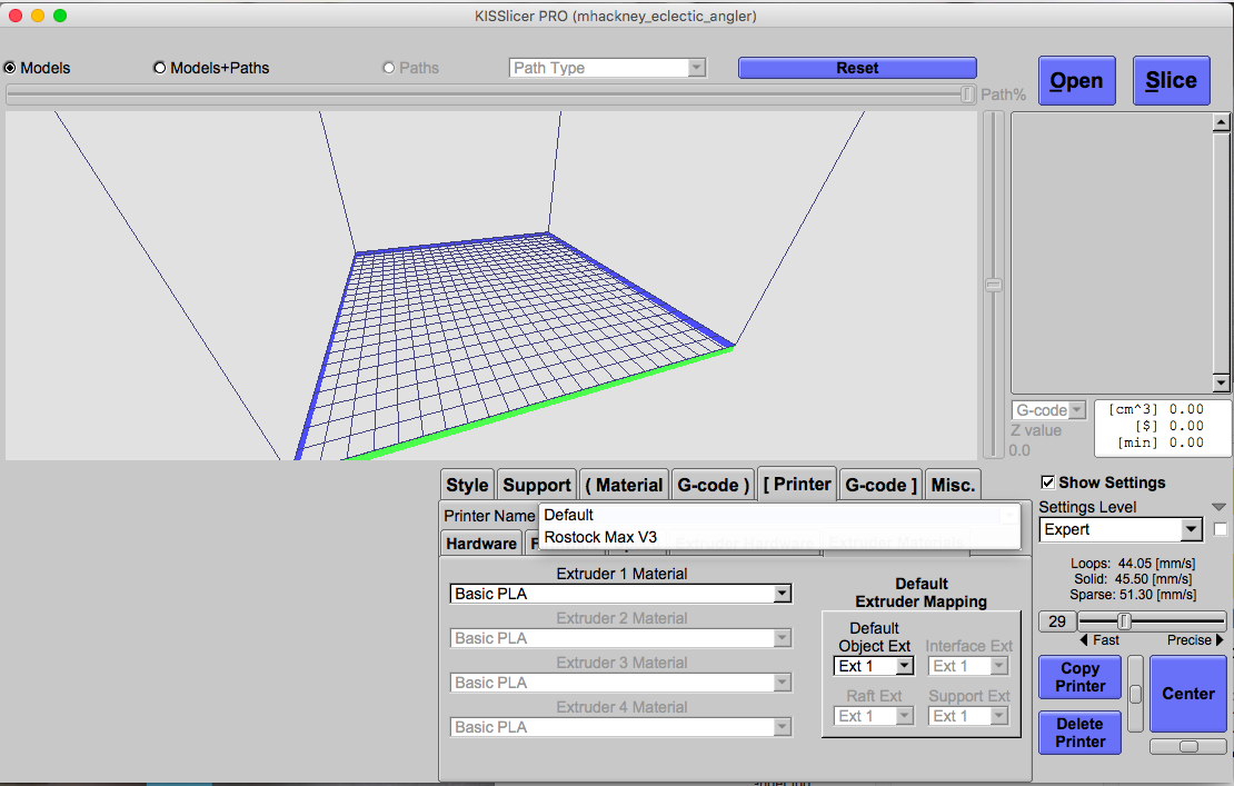

Downloaded and installed KISS, copied the profiles from above to the folder and sliced.
There were a few errors I ignored since I figured it was normal (having no idea what I was doing and just hoping for the best)
Loaded the SD card and began to print. My V3 started trying to print in mid air, right from where it was. Epic fail. Oh well. :lol:

What sort of errors did you get? Post the gcode file and I'll take a look. You probably did not select the printer and maybe other profiles once you loaded kiss. You have to explicitly set to the profiles I included in the drop down lists otherwise kiss uses it's "Default" for printer, material, etc.
Here are the 3 main places where you need to select the configuration from the files I posted above.
