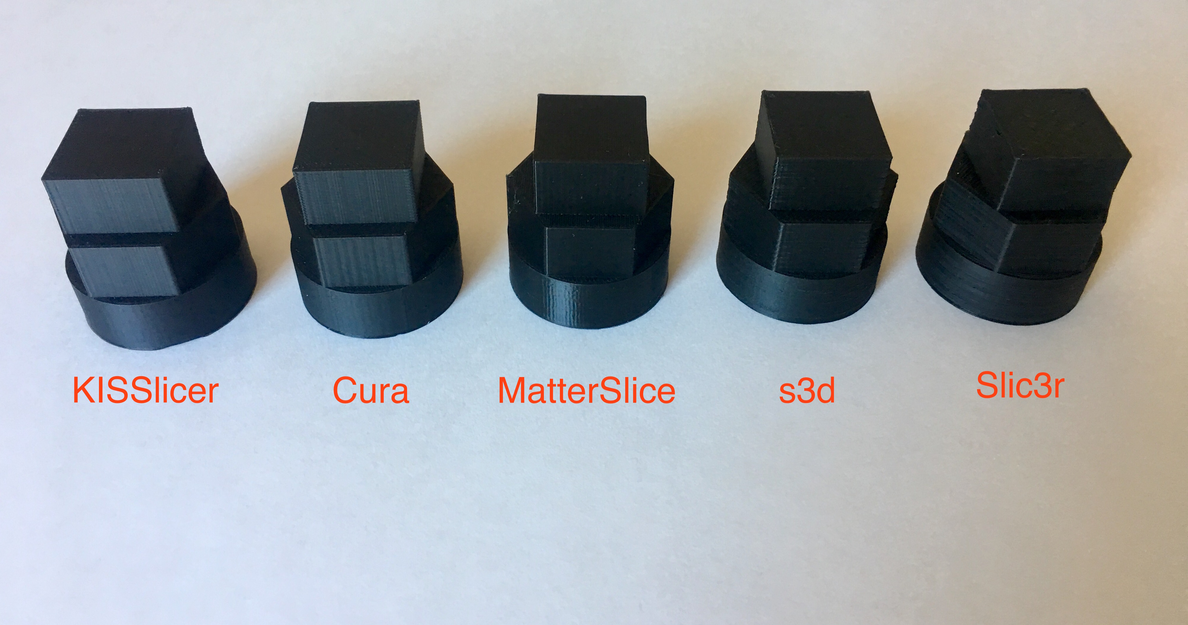

I sliced my BandAid model and saved gcode for each of these slicers. I used OctoPi to print all of them as it eliminates potential jitters and other print issues related to desktop USB control applications. Two of each were printed in SeeMeCNC's black PLA (except the Slic3r gcode was printed 3 times as mentioned below). The BandAid model is relatively simple but has some features to test the slicer. A calibration model of some sort would be ideal but that will have to wait for the book. Here are the results with the best on the left to the worst on the right. Comments below.
KISSlicer: although maybe not as obvious in the photo, the parts were much cleaner, more consistent and had better surface finish on both the perimeters and top and bottom surfaces.
Cura: output some respectable gcode for this model. Interestingly, the bands did seem to be slightly more pronounced than with other slicers on both test prints. Otherwise, it was quite clean.
MatterSlice: the primary issue I had with MatterSlice was that even at the same print speeds (and I verified these in the gcode) the print came out a bit glossier than the others indicating a slower print speed for the perimeters.
s3d: had some artifacts, particularly the "warts" that many see. In addition to the set of defaults I used for the other slicers I did attempt to tweak the s3d parameters to improve things. I was able to get slightly better prints.
Slic3r: is an odd one. You might not be able to see it in the photo but the perimeters were horrible. It looked like the printer might have had a loose belt or arm or joint but that was not the case. In fact, immediately after the first Slic3r print (that was horrible) I printed the KISS code and it was perfect, then the Slic3r code and it was horrible. I scrutinized the gcode and all of the parameters were exactly how I configured them (as described above). I ended up printing 3 just to make sure. I don't understand this at all. I attempted to tweak the slicing parameters to improve things with very marginal success.

One thing of note that can dramatically impact outline quality is the extrusion multiplier.
All the slicers use approximations of the extruded plastic to compute how much input filament is needed, IME Slicers don't do this in any standard way, so an estep setting with correct filament diameter on one slicer will pull more filament through than on a different slicer.
Given how simple your model is, you could find one of the cube sides, and look at the amount of plastic pulled through by each of the slicers.
If you really want to compare them at their best, you might want to do a thin wall test piece on each of the slicers, and adjust the extrusion multiplier.
Though having said that IME Kiss > Cura > S3D with some exceptions depending on the print. I've never had the warts issue with S3D, I did have issues with the way it deals with fine details, but I haven't done a lot of printing on the current version, I did recently reinstall it and use it for a couple of prints..
Re: Slicer Tests on the Rostock MAX V3
@Polygonhell, I agree, slicers do not handle the multiplier in a standard way. For this test, I set it to "1" to standardize settings as a baseline. If I were going to use a particular slicer I would continue to tweak and test that one until I understood it inside and out - like I've done with KISSlicer. In my tests and usage over the last few years, s3d is the worst of the lot with extrusion multiplier. It uses it as a band aid to fix or hide other problems. I implemented a very simple slicer and the calculations for extrusion are not rocket science. If you just extrude based solely on the math AND if you have measured your filament, calibrated your extruder and know your nozzle is the right size, you get very respectable results.
I really look for predictability in my slicer. One of the big issues I have with s3d - the technology - is that its path layout is buggy. I posted a "keystone" layout problem a year ago that still exists. Because of that, I can't use it for any of one of the parts on my fly reels.
This was not really meant to be an all-encompassing review of these slicers (as you know) but rather to let folks - especially new Rostock V3 owners - that they can get reasonable results with any of these slicers (except Slic3r for some reason) and to put some stakes in the ground for a basic configuration for each. This test did not have anything to do with infill for instance. And for my work, only KISSlicer has the infill pattern and quality I need. Most slicers treat infill as simply filling up the inside of the model. I look at it as both visual element and a structural element. Off my soapbox and on to more printing!

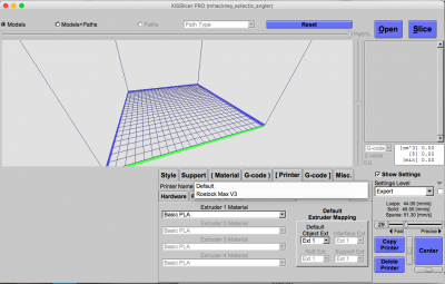

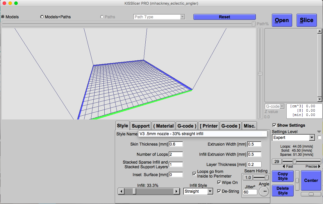

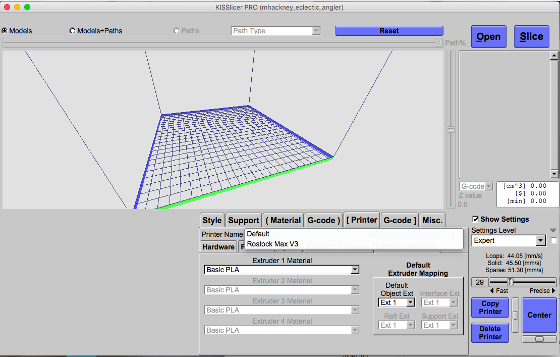

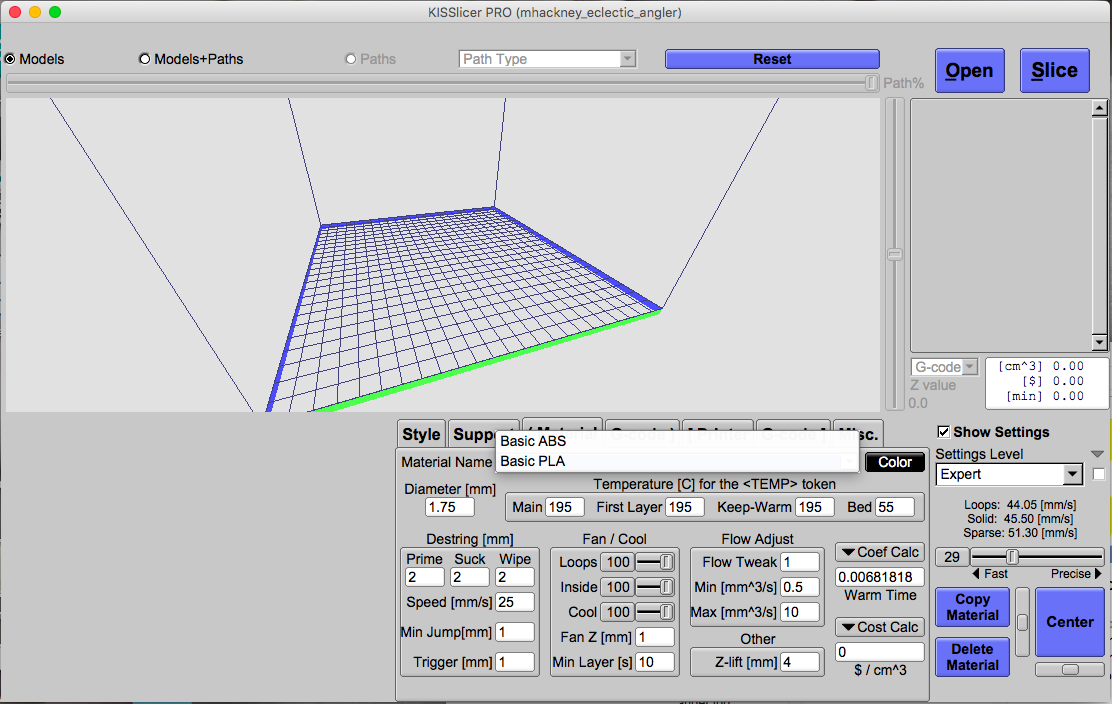

What sort of errors did you get? Post the gcode file and I'll take a look. You probably did not select the printer and maybe other profiles once you loaded kiss. You have to explicitly set to the profiles I included in the drop down lists otherwise kiss uses it's "Default" for printer, material, etc.
Here are the 3 main places where you need to select the configuration from the files I posted above.
