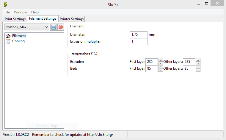

Attempting the first print , having some small problems , and one major. Of course the abs isnt sticking to the glass. didnt have any hair spray did find pink hairspray of my daughters , hope it works. What is also happening is when I hit Run Job button
my hotend temp drops down to 175 , I have change my default settings to 250 hotend and 115 bed , but it still drops it down? Anyone got ideas ?

Both of those seem a little high. The hotend should print ABS around 230C and the bed around 80C should suffice. Did you verify your temps with a multimeter/thermocouple? Very important step! If you get that hotend temp too high with a stock SeeMe, you will damage your PEEK section. I would do the verify step ASAP.

Thinking im confusing you all , my hotend I can set to 2xx whatever and it gets there pretty fast , but when I go to print the cali cube and hit Run Job , it changes the setting to 200 , when it is reached it begins to print but is not hot enough to extrude the abs , Im thinking.?
I heat up the hotend to 230 and extrude 20 mm of abs just fine. I just need to figure out why Repetier or whatever gcode is cause my hotend temp setting to change down to 200?

What did you have the temp set to in whatever slicer you're using?

Im using the slic3r in Repetier -Host , Under printer settings I have change the default Extruder Temp to 230 , which it stays there , doesnt change. Now that I think about it not sure if that even that hotend ?

So in this window what temp? 230C?
and this one?..."manual control" Repetier host
Re: Prozacs Max Build
Posted: Sat Feb 22, 2014 2:50 pm
by Prozac
Thanks that was the problems I was changing the settings in the printer and not the slicer , and must have overlooked that last night when i was averaging the abs diameter.
See how this works now thanks again.
