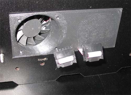

Chrissi wrote:Update: moved to kitchen, back on granite counter top instead of floor. Ran it with LCD door wide open, Printed last part to fail. Came out fine.
I know, I know... bad girl I changed two things at once so three possibilities.
1- static on waxed hardwood floor. I think this is unlikely.
2- door open,solved cooling issue.
3- not 1 or 2, problem is random and don't have clue yet.
I'm gong with #2 and adding a fan for the electronics. While I am in there I will fuss with the rats nest. If I fixes things then the answer is one of the two.
Adding that fan will probably eliminate your problem for good.

Solved? Hopeful. :geek:
Made a cable to plug directly into the PS connectors, if it is on the fan is on.
Designed and printed a fan housing for the door and the 40mm fan...
The (4) #6 FH screws thread directly into the holes

Success! 8 hr print without a hitch.
We'll call the new fan in the door plus wire arrangement the cure for our quitting problem.
Previously I had taken all of the slack in the wires into the front bay with the board. I un-bundled each wire and pulled it back to whichever bay it originated in and coiled I there and tie wrapped it. Each connector was unplugged one at time re-routed for a clean path and plugged back in. The motor wires were bent downwards from their connectors and ran across the bottom, all other wires were dressed to run higher in the enclosure.
This gives a clear path for air from the fan direct to the motor mosfet driver chips just above the motor connectors.
You can just feel a gentle breeze coming out the crack next to the door.
Thanks everybody for the suggestions, tips and ideas.

Okay, don't have time to add the raised lettering, here is the STL file for the fan duct for the LCD door.

Even with all the pictures I am having a hard time envisioning how this fits. Does it fit on the inside of the door in the space behind
the Lcd Display? And you can close the door completely with this in place?
Re: It just quits!
Posted: Sat Mar 08, 2014 12:53 am
by Chrissi
Yes, loosen or remove the LCD display, make sure your fan wires exit right or left so they won't get in the way of pushing through the opening from the outside in. The part has a small flange on the outside.
This did not cure the quit problem 100% but 99% is very nice!
