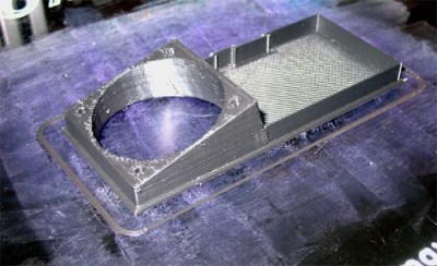

OK, print #2 of fan housing without incident. I am feeling bold, maybe do the 13B water manifold again. I'd like to get a lost PLA aluminum casting of this.
By the way, either I have burnt out those receptors or ABS does not stink. Its just across the hall.
What about lost ABS, has anybody tried this? Is the resolution the same with ABS and PLA? I like the idea that I can do the acetone vapour smoothing on ABS.

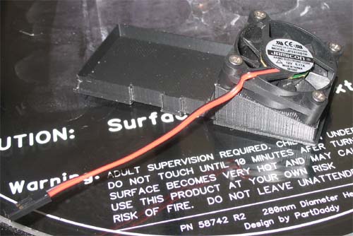

Going to add a board fan and look at the wiring today.

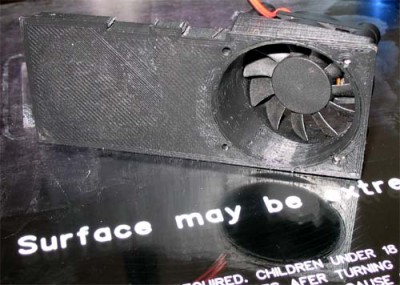

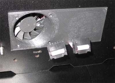

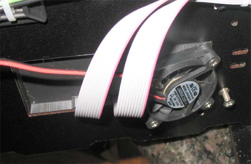

Update: moved to kitchen, back on granite counter top instead of floor. Ran it with LCD door wide open, Printed last part to fail. Came out fine.
I know, I know... bad girl I changed two things at once so three possibilities.
1- static on waxed hardwood floor. I think this is unlikely.
2- door open,solved cooling issue.
3- not 1 or 2, problem is random and don't have clue yet.
I'm gong with #2 and adding a fan for the electronics. While I am in there I will fuss with the rats nest. If I fixes things then the answer is one of the two.
