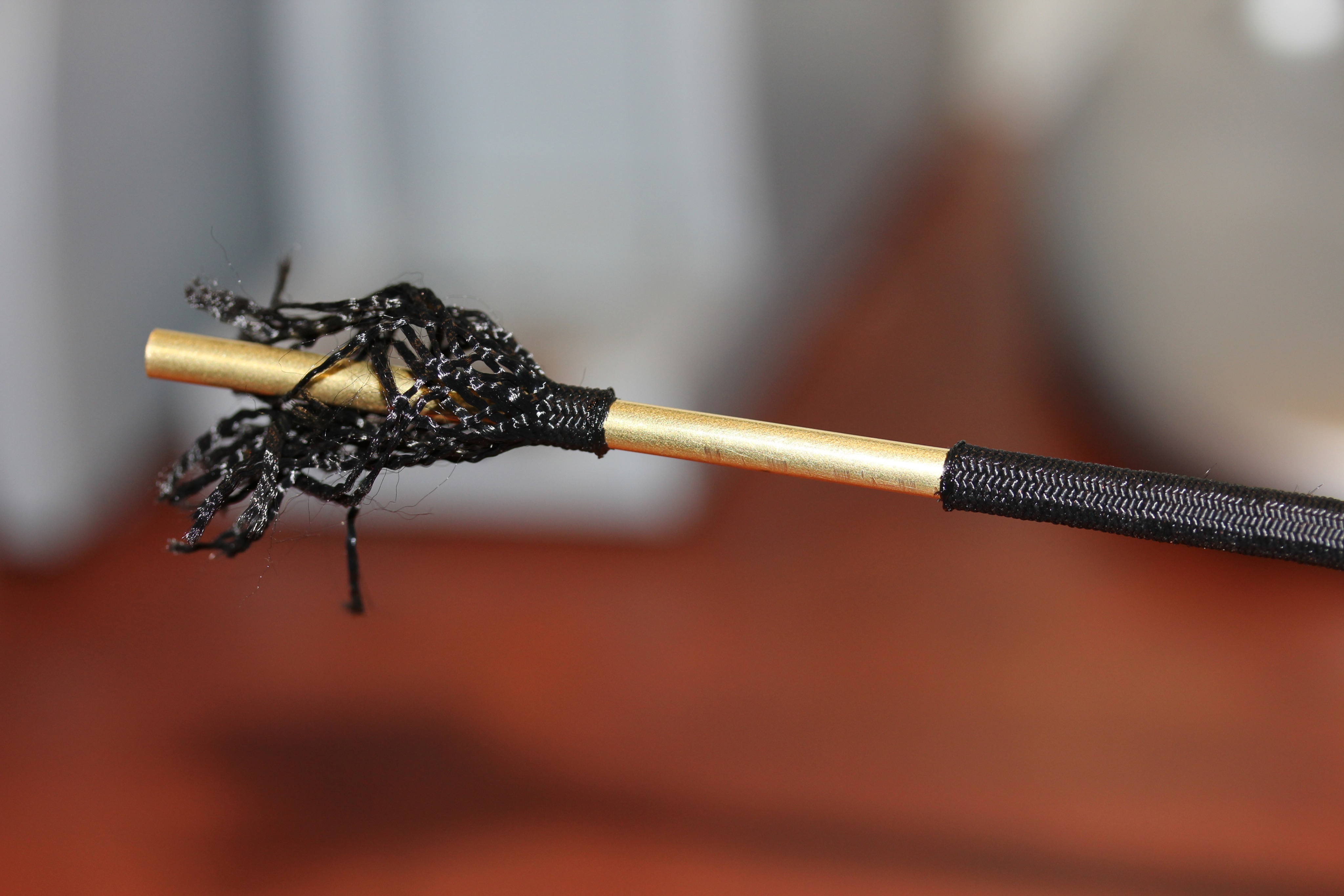

"Ah, yes. The old paracord motor wire sheath trick." — Maxwell Smartgeneb wrote:I'd love to learn more about the "paracord sheath trick" you used.

Can you tell me the approximate ID of the Paracord. I assumed it was 1/4" from the looks of it.kbob wrote:Thanks, guys. I am familiar with "store bought" cable sleeving products. But paracord has a completely different texture from the cable sleeve I've used. It is much softer and more flexible, and it frays less (even before you melt the ends). I assume it's because paracord is made from thinner fibers.
It is also limited in that it only comes in one size.
I think it's closer to 1/8". It stretches a little when it goes over a 5/32" tube. I have used it over larger wire bundles, but it looks better when it's not stretched.Eaglezsoar wrote:Can you tell me the approximate ID of the Paracord. I assumed it was 1/4" from the looks of it.kbob wrote:Thanks, guys. I am familiar with "store bought" cable sleeving products. But paracord has a completely different texture from the cable sleeve I've used. It is much softer and more flexible, and it frays less (even before you melt the ends). I assume it's because paracord is made from thinner fibers.
