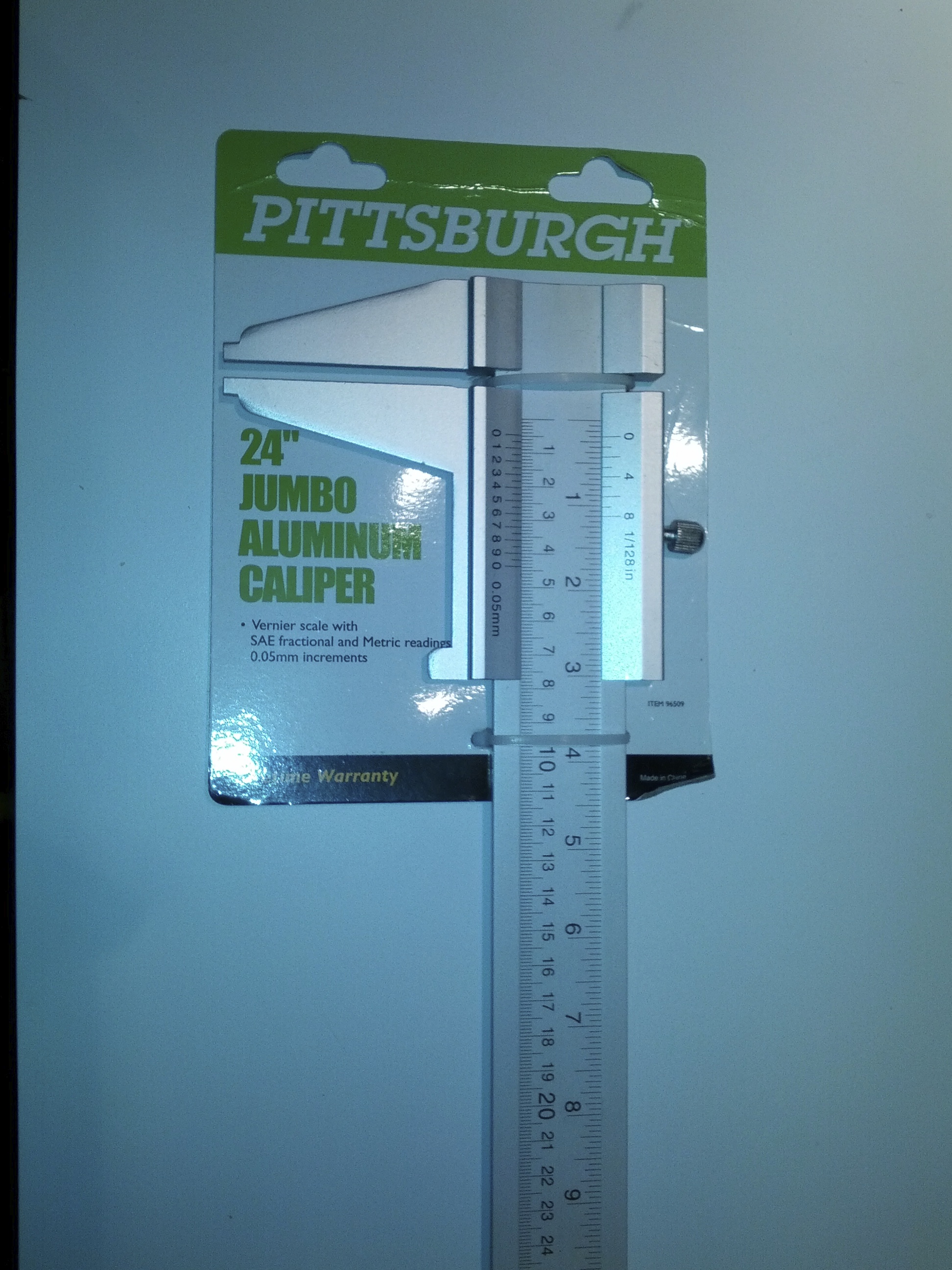

I found this fine article at Hor'ble Fright tonight. It will be just the thing to measure whether my towers are equidistant and parallel. With its vernier scale, it should produce repeatable measurements down to 0.02 mm or so. (Not necessarily accurate, just repeatable.) The outside edges expand to almost 29 inches, so it might also be a suitable replacement for the sawed off yardstick.
In England, this would be a "Sizable Aluminium Calliper" and it would be Birmingham brand.

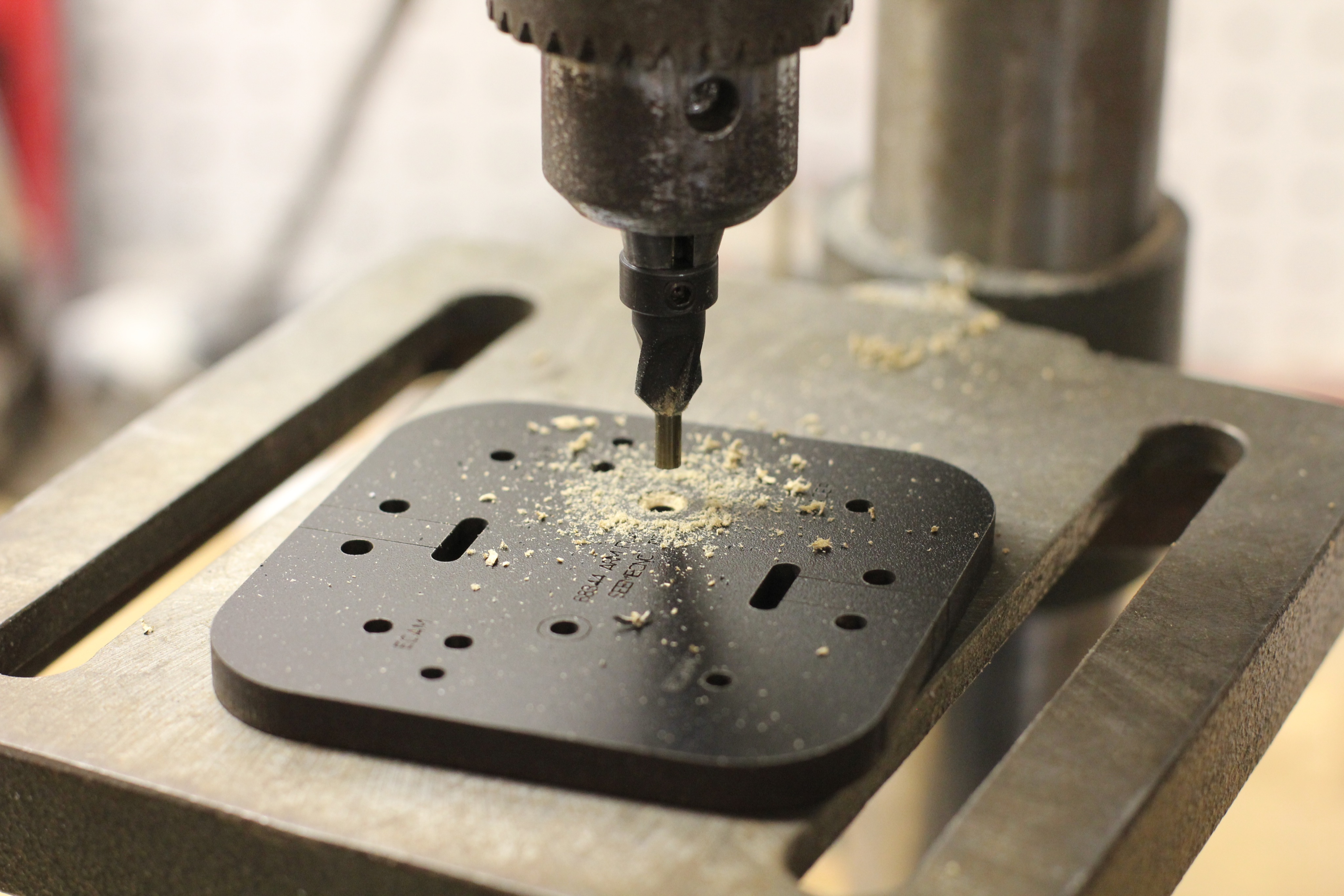

I am going to experiment with some small departures from the official instructions. I.e., I'm going to do it wrong. (-: Or maybe I'll find some things that make it easier for the next guys.
To start with, I used a drill press and countersink bit to countersink all the holes instead of snapping the melamine disk out. One of my tape pulling friends suggested turning the drill bit upside down. That way, the smooth shaft goes into the existing hole and does not remove any more material. Here's the countersink stub.

I set the drill press's end stop so that the countersink stops at the correct depth. Here are two photos of the countersunk hole.

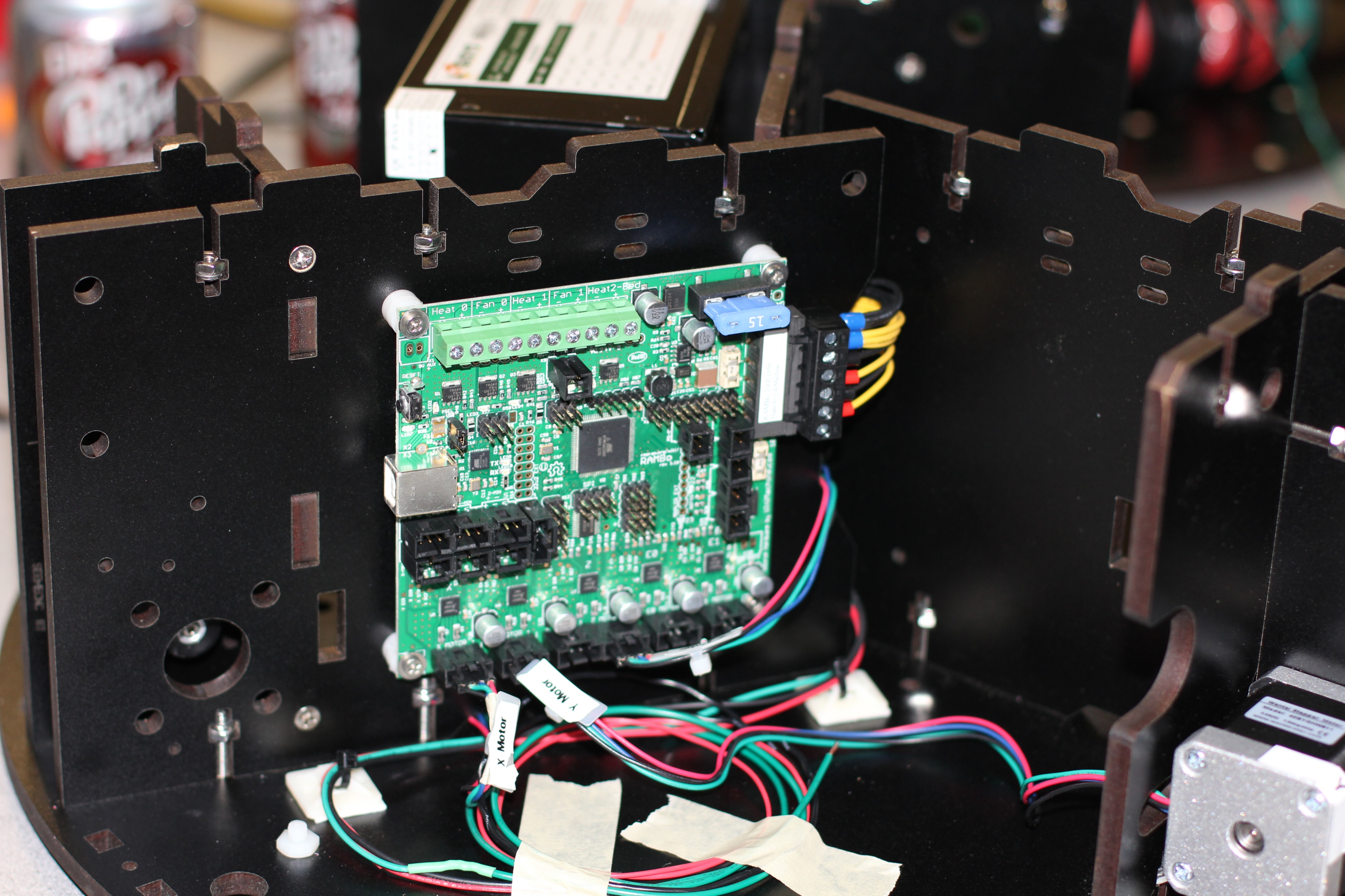

I decided to mount the RAMBo early on. As soon as I finished the first tri-support assembly, I put the RAMBo onto it

Why do it that way?
  • It's easier to screw in. Don't have to reach in through the door.
  • I can trim the motor wires to match the actual distance to the headers on the RAMBo. I'll leave about two inches of slack in each. That's cleaner than leaving big coils of extra wire. I'll also trim the power supply wires with maybe 6 inches of slack.
Why was this a bad idea?
  • Risk of static discharge or damage during construction. My board is hanging out there in a construction zone. As soon as the table is on, it will be better protected, though.
Any other reasons I should not have done this?
Sounds like a smart way to do it. You'll end up with a neater look without all the excess wire all over.
It's also a good idea to run the wire for the end stops down the uprights before you mount them, it's easier.
If you have future plans on a top mounted extruder don't forget the wires for that also.

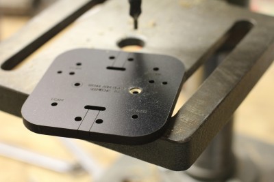

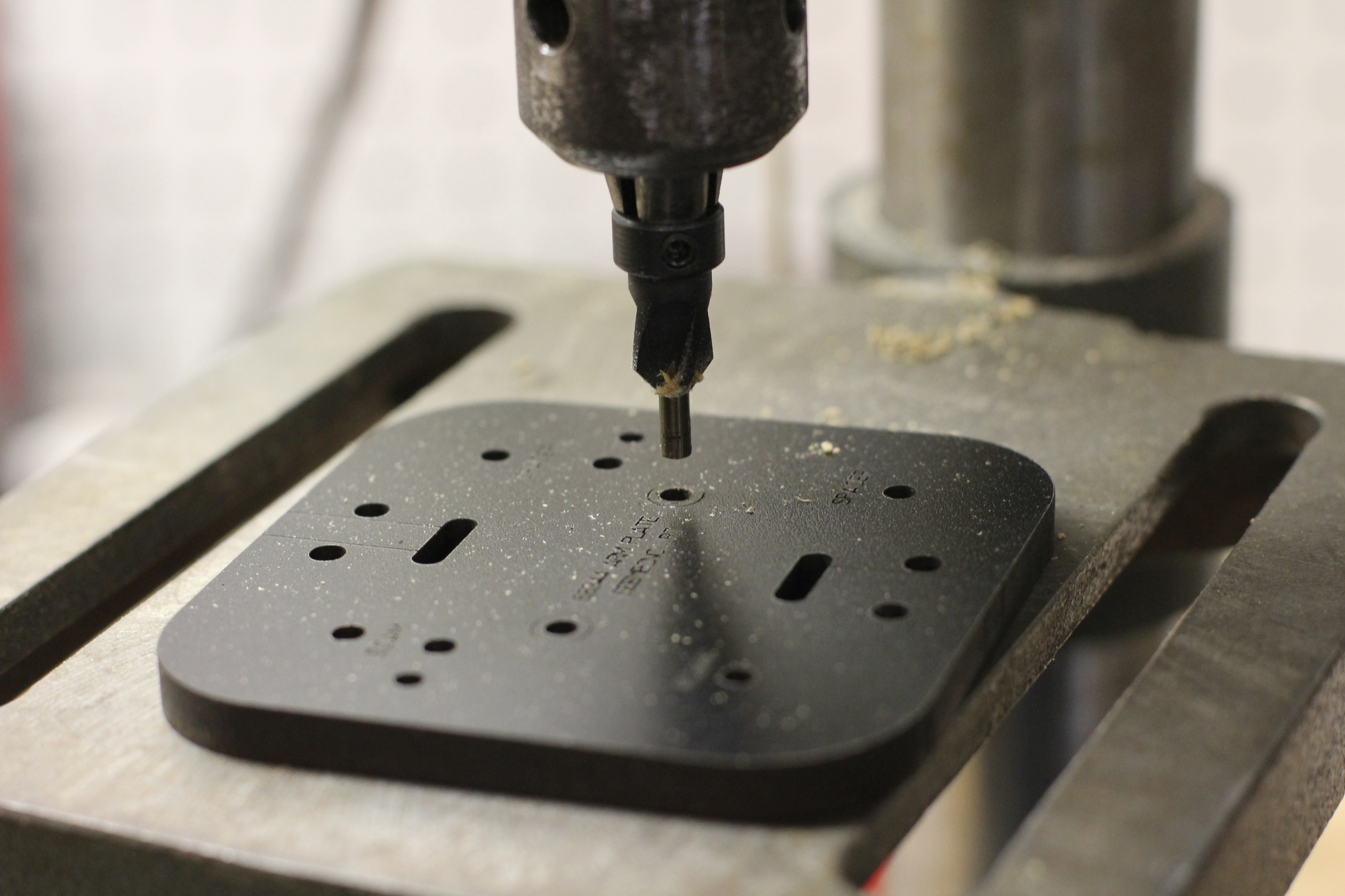

<strike>Last night</strike>Friday night I started building. I had two friends help me peel all the tape off the melamine and press in the nylon locknuts. That part went pretty fast.

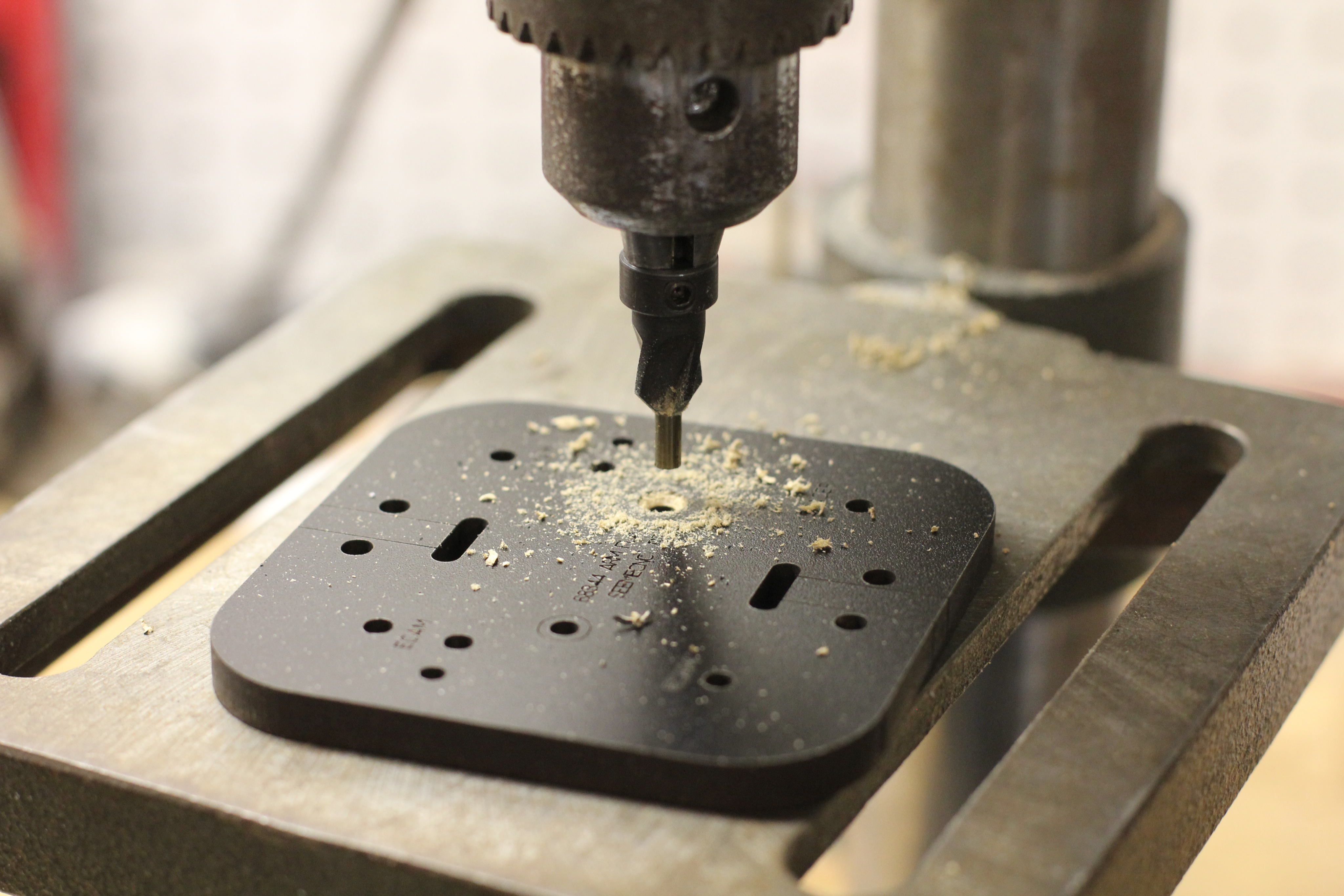

Upside down drill bit does not bore.

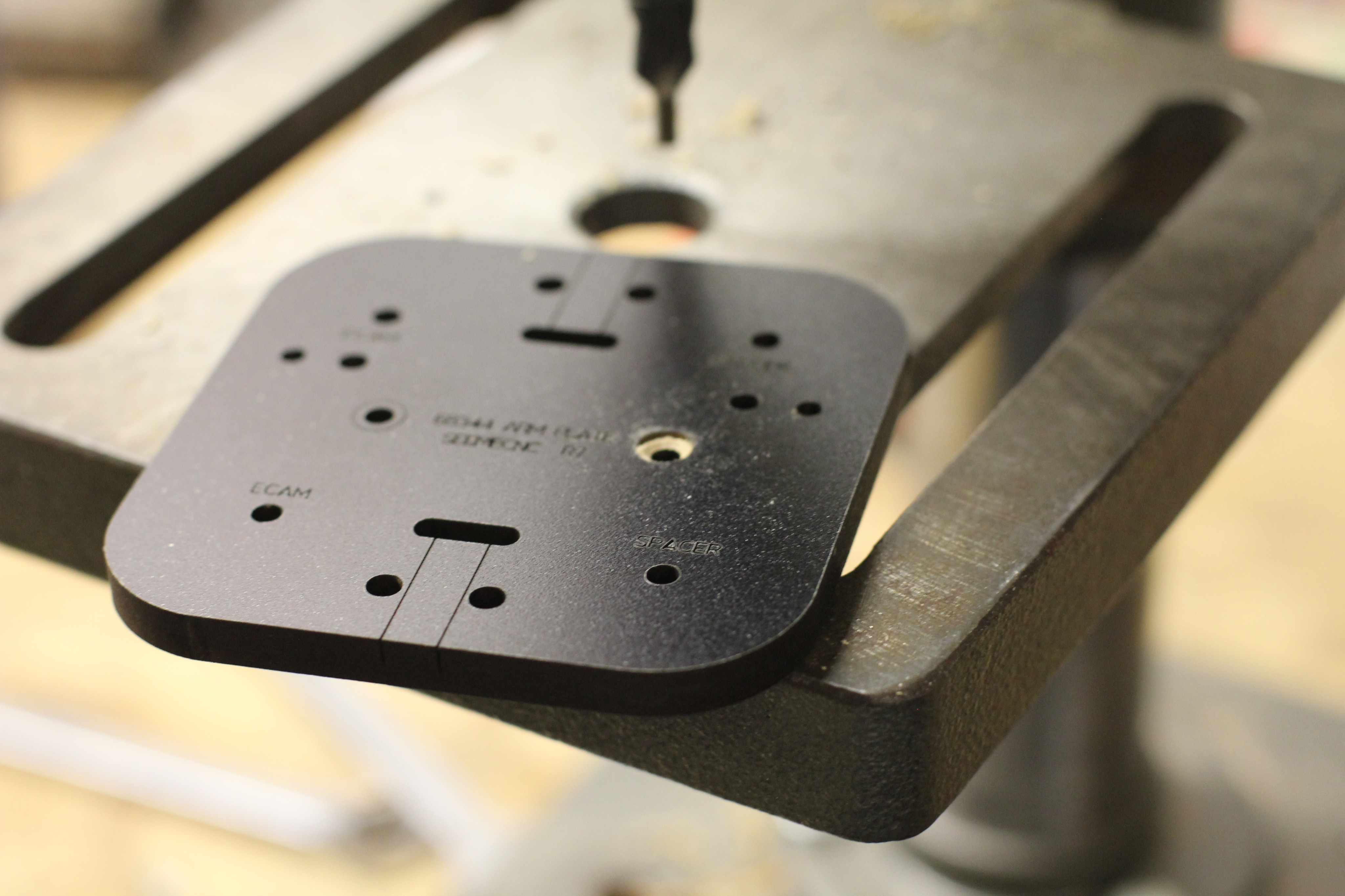

Freshly countersunk.
Sans sawdust.
Sans sawdust.

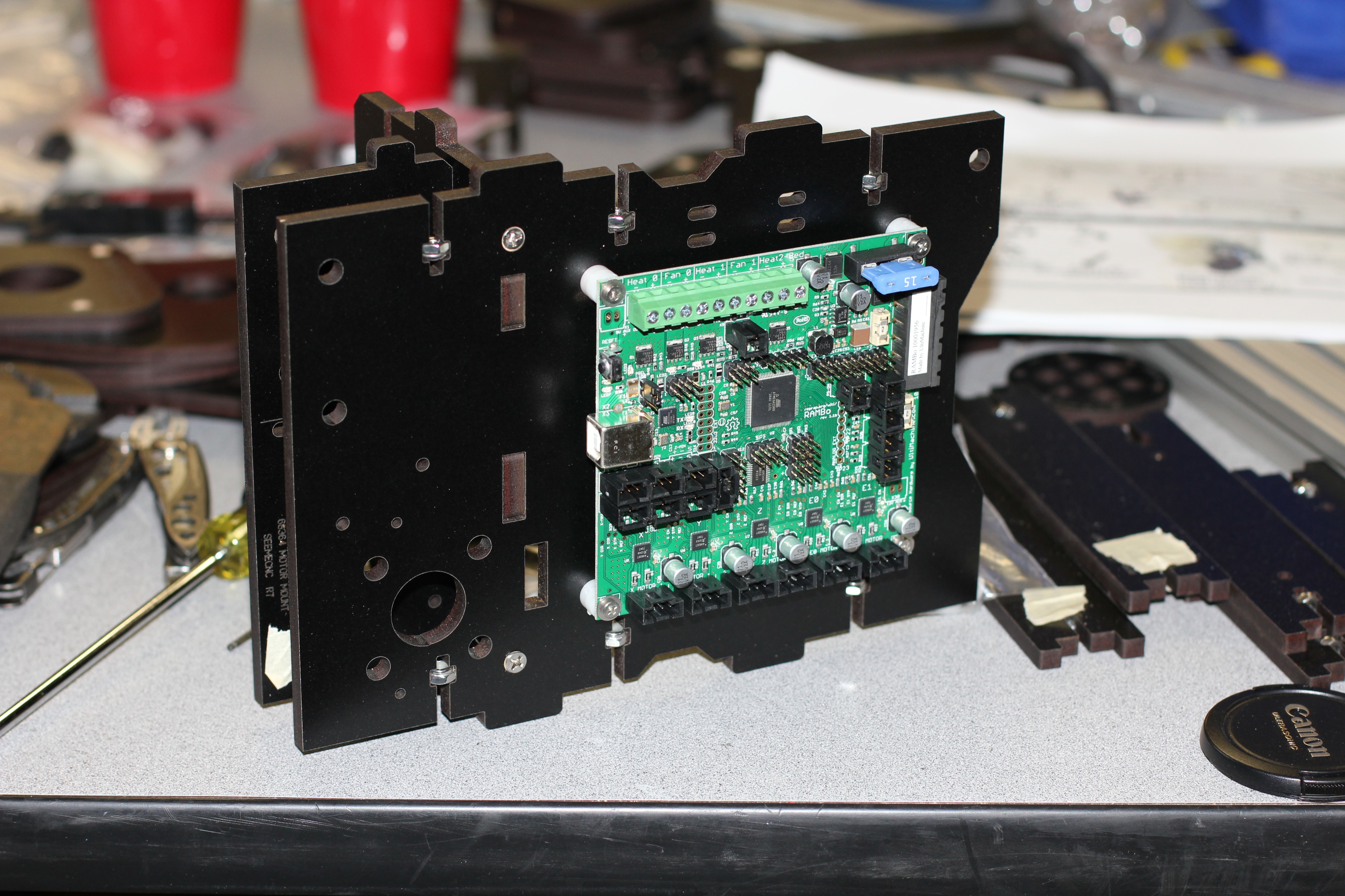

I decided to mount the RAMBo early on. As soon as I finished the first tri-support assembly, I put the RAMBo onto it.
Why do it that way?
RAMBo installed early.

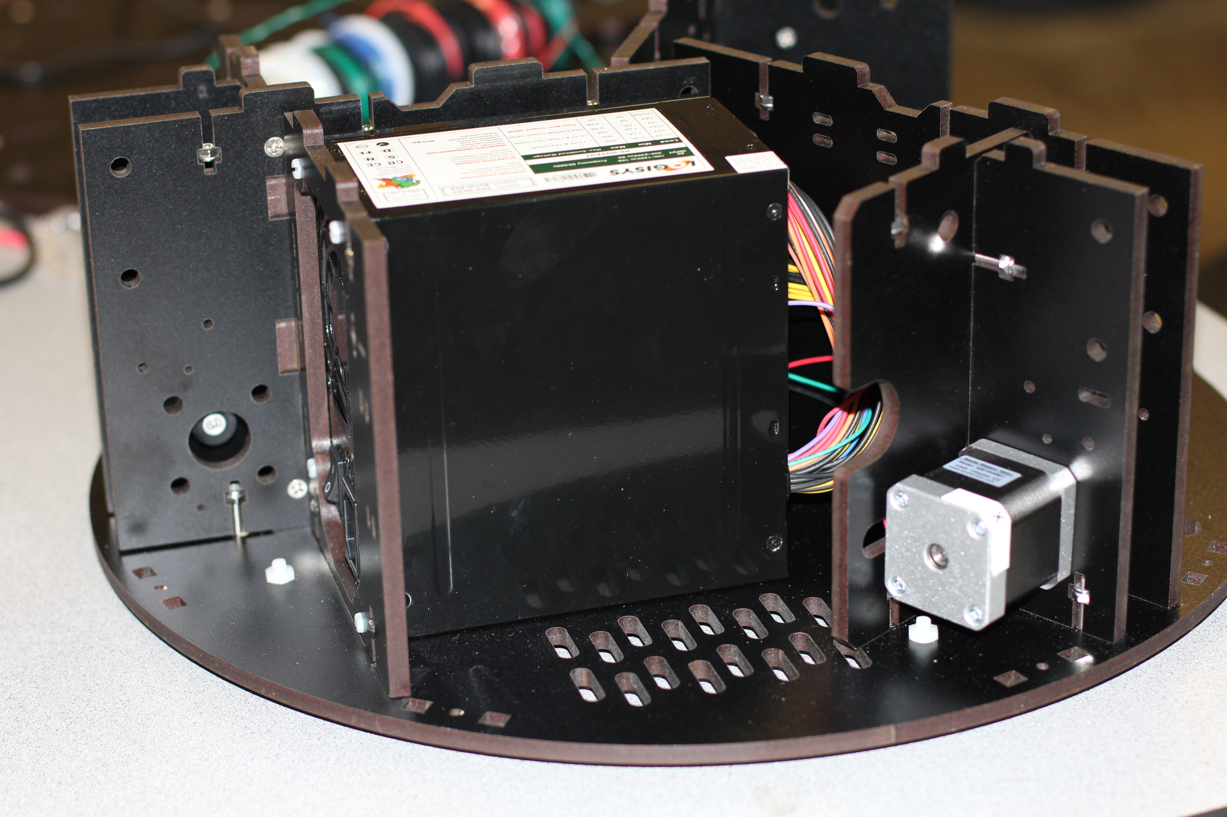

After I got the tri-supports loosely attached to the base, I went ahead and put in the power supply. That made it really easy to run the power supply wires, and it also made it easy to install all four power supply screws. The Cover Brackets (those little vertical pieces) are not obstructing the screw holes yet. I also got all the spare wires tucked neatly away between the power supply and the Z tri-support.
I don't see any downside to doing it this way at all.
Power supply in place.

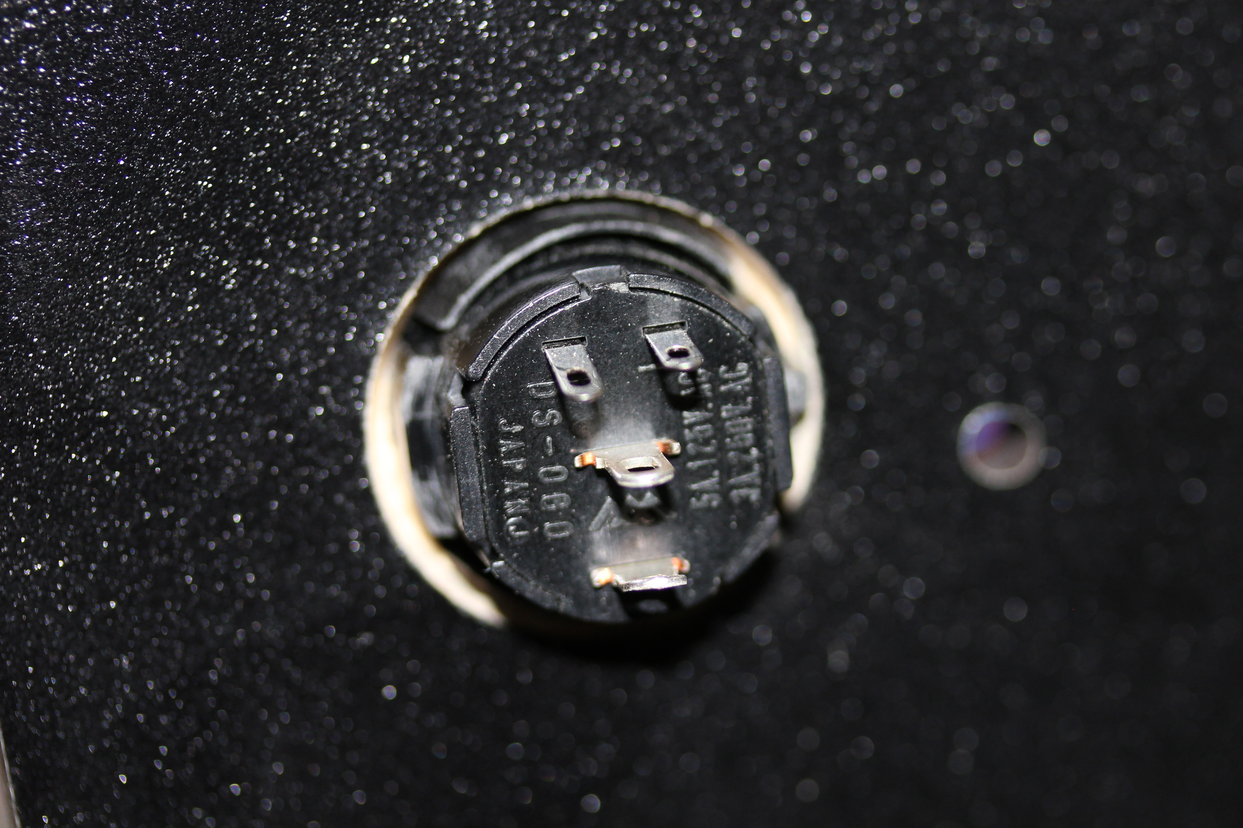

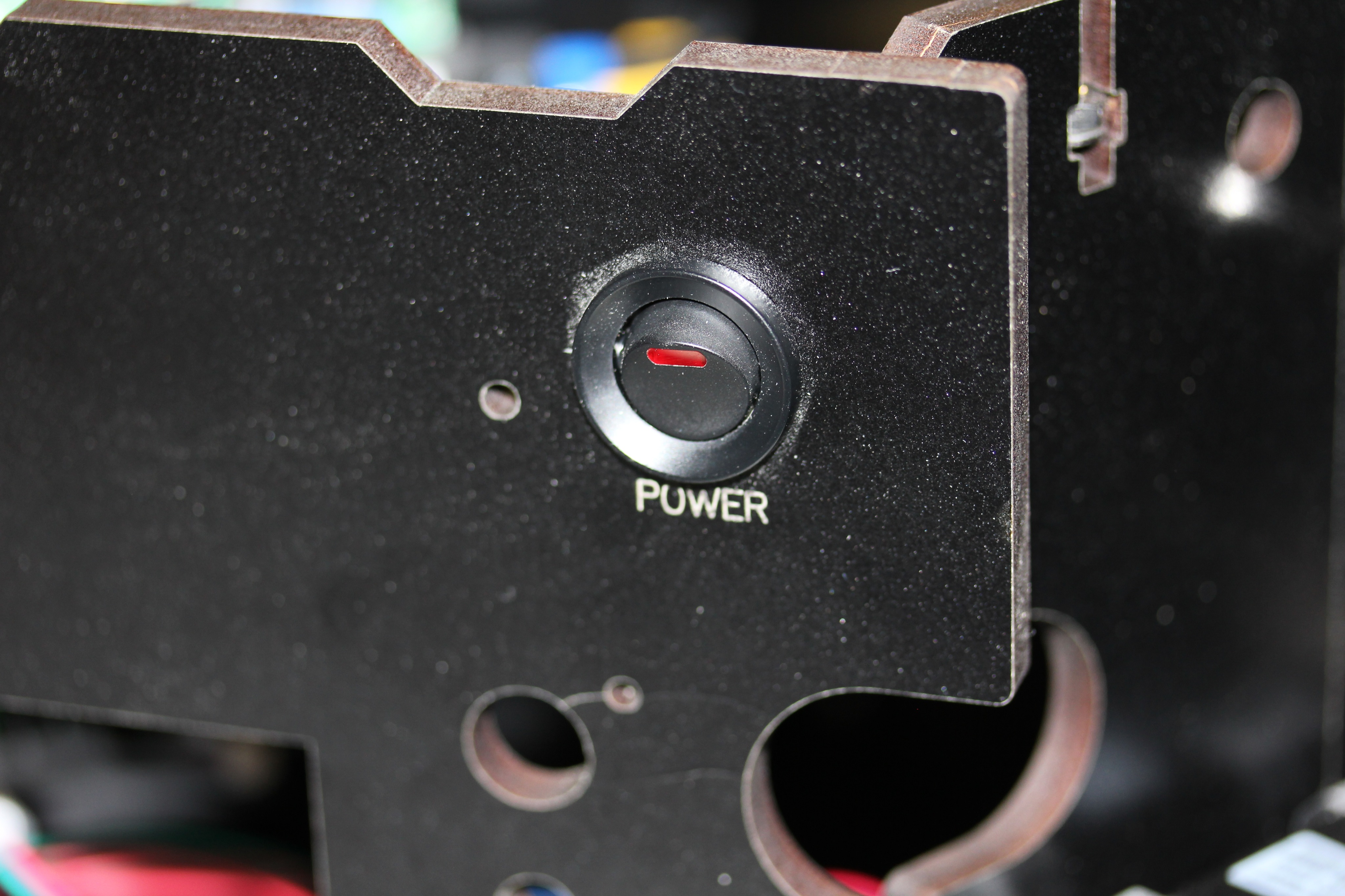

The power switch in the kit is really cheesy. I didn't care for it at all. So when I was at Oregon Electronics last week, I picked up a lighted SPST switch. It's round and black because the Rostock is round and black. It has an LED because the Rostock does not have enough LEDs.
I'm glad I put the switch in before I assembled the base, because I enlarged the hole on a drill press, then enlarged it some more with a Dremel in a vise.
The switch, still a little dusty
The switch was designed to mount in a thinner panel than this fiberboard, so I turned the panel over and drilled a larger hole from the other side. I drilled both holes blind to prevent chipping the melamine, and the first bit poked its nose through to make a pilot hole for the second one. I just love Forstner bits...
Unfortunately, the switch was bigger than 3/4" and smaller than 7/8", so I had to Dremel out the smaller hole to something in between. But the switch bezel hides my sins, so I am absolved.
Concentric drill holes
I did not wire up the switch. Until the base was assembled, the door was not permanently attached. I think I have some spade lugs in the right sizes. If I can find them, I won't have to solder the leads on.

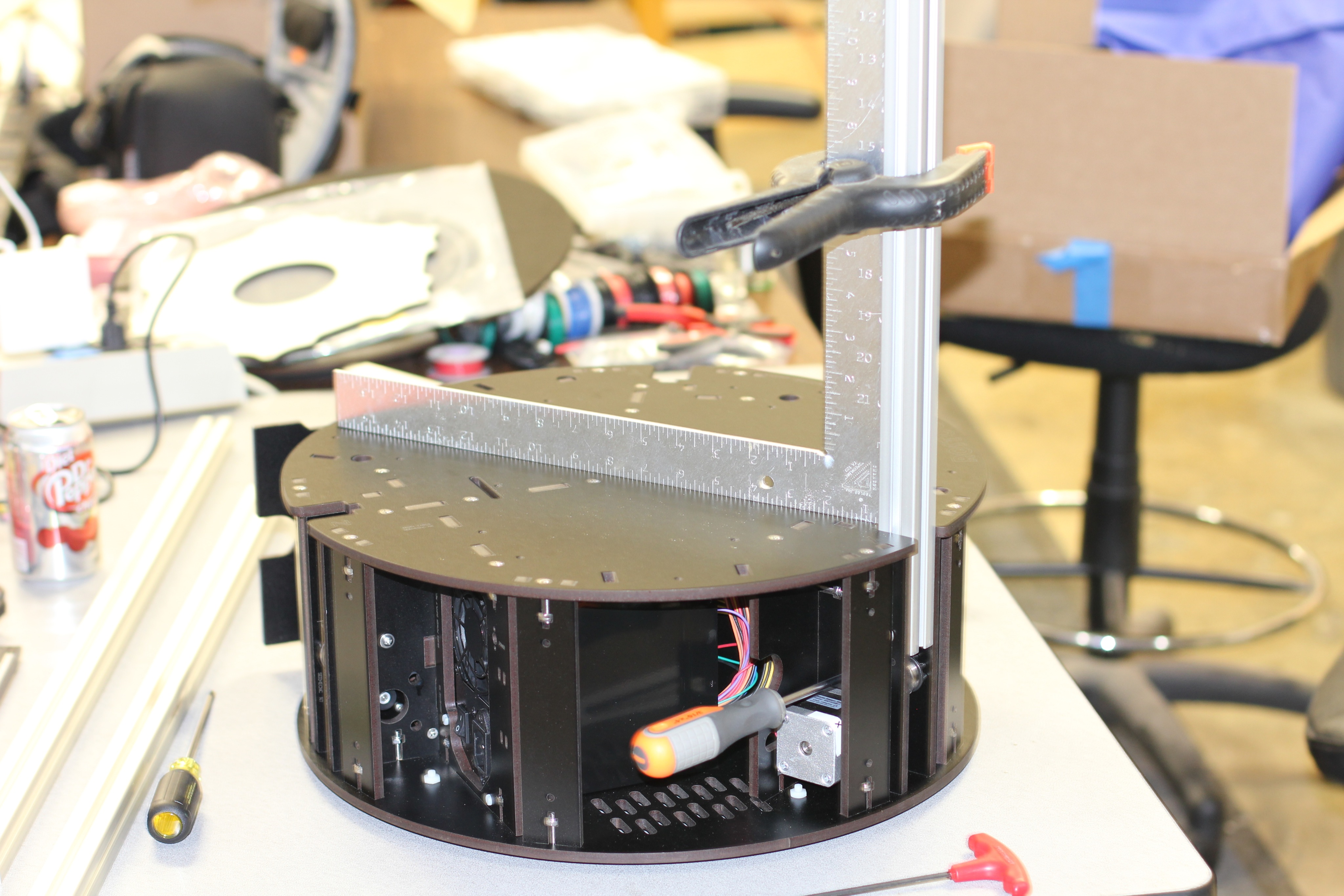

The last thing I did last night was to erect the tower. I happened onto a really slick way to align the uprights. I clamped them to a square. The square is sitting inside the T-slot. The clamp is forcing the upright against the square. Gravity is holding the square flat against the table. Therefore, the upright is square to the table (within the accuracy of the square). I have to push on it to move it to a non-square position, and it comes right back.
Auto-square mode
Auto-square mode
There are still two degrees of freedom, though. There's the height of the upright and how far from the table's center it is.
I adjusted the height with the flat blade screwdriver you see in the photo. The screwdriver acts as a lever with a big mechanical advantage. I could push down the handle and shift the post up with resolution less than the thickness of the etched alignment line. (I hadn't figured this out when I shot the photo, so the post is just resting on the screwdriver there.) Once the height was right, I squeezed the clamp, the square dropped down to the table, I unsqueezed the clamp, and the clamp forced the post into square orientation.
Then the square was holding the post up, and I could release the screwdriver. I pressed the post toward the center of the table as far as it would go with thumb and snugged the screws. It took a few iterations to work out this technique, but I readjusted all three posts once I had it.

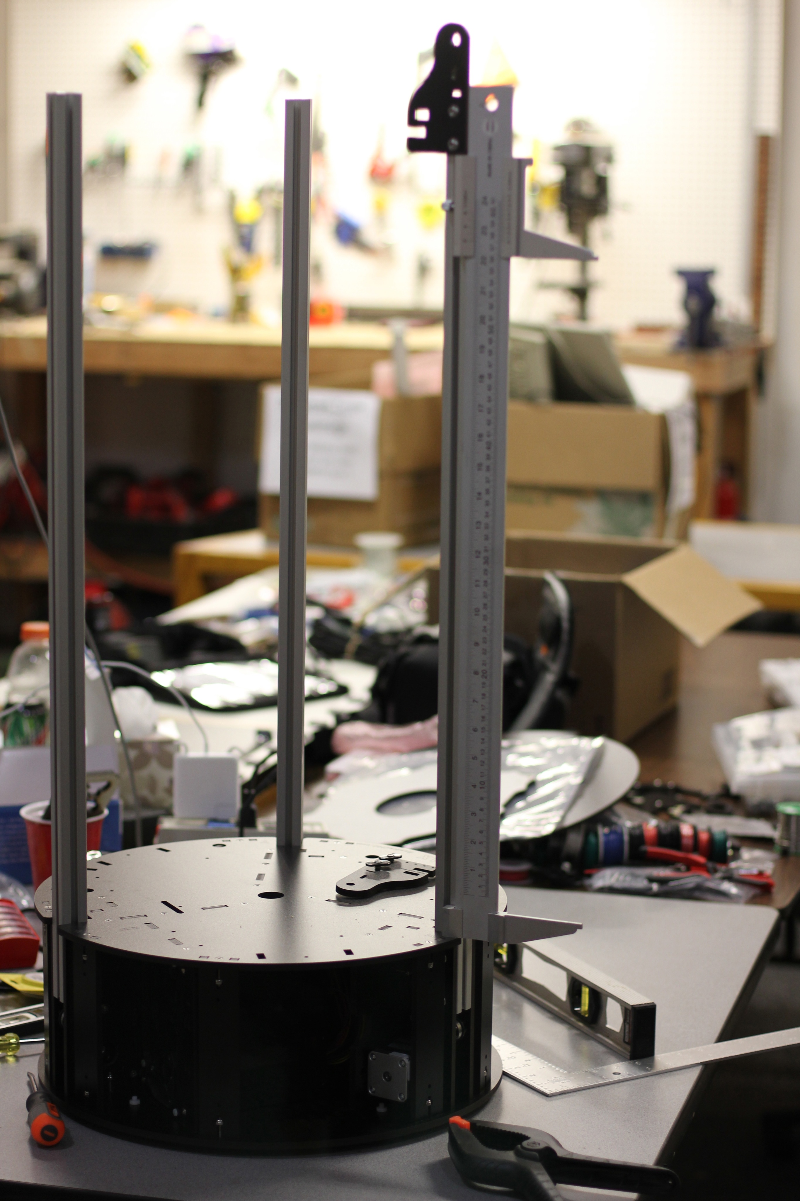

Then I followed the procedure in geneb's manual to measure the top height. Except... I used the Birmingham Substantial Alloy Calliper (BSAC). I just couldn't bear the thought of butchering an innocent yardstick. I also wasn't sure I'd cut the yardstick accurately enough.
I put the first Idler Mount on and aligned it. Then I inserted the BSAC and adjusted it so the table and idler mount were both touching the outside of its jaws. I locked the jaw at that position. After that, I used the BSAC just like the manual says to callously exploit the victim yardstick.
No yardsticks were harmed.
Then I used the BSAC to measure the distance between all three tower pairs, both at the bottom and at the top. I got readings of 381.10 to 301.30 mm at all points. I repeated them, and they were the same. I identified the post that needed to be adjusted, loosened it and slid it out about 375 milli-titches. Then I re-measured. No difference. So I called it good. One of my towers is about the thickness of a bee's wing too close. I doubt I'll be able to make the CheapSkates that uniform.
