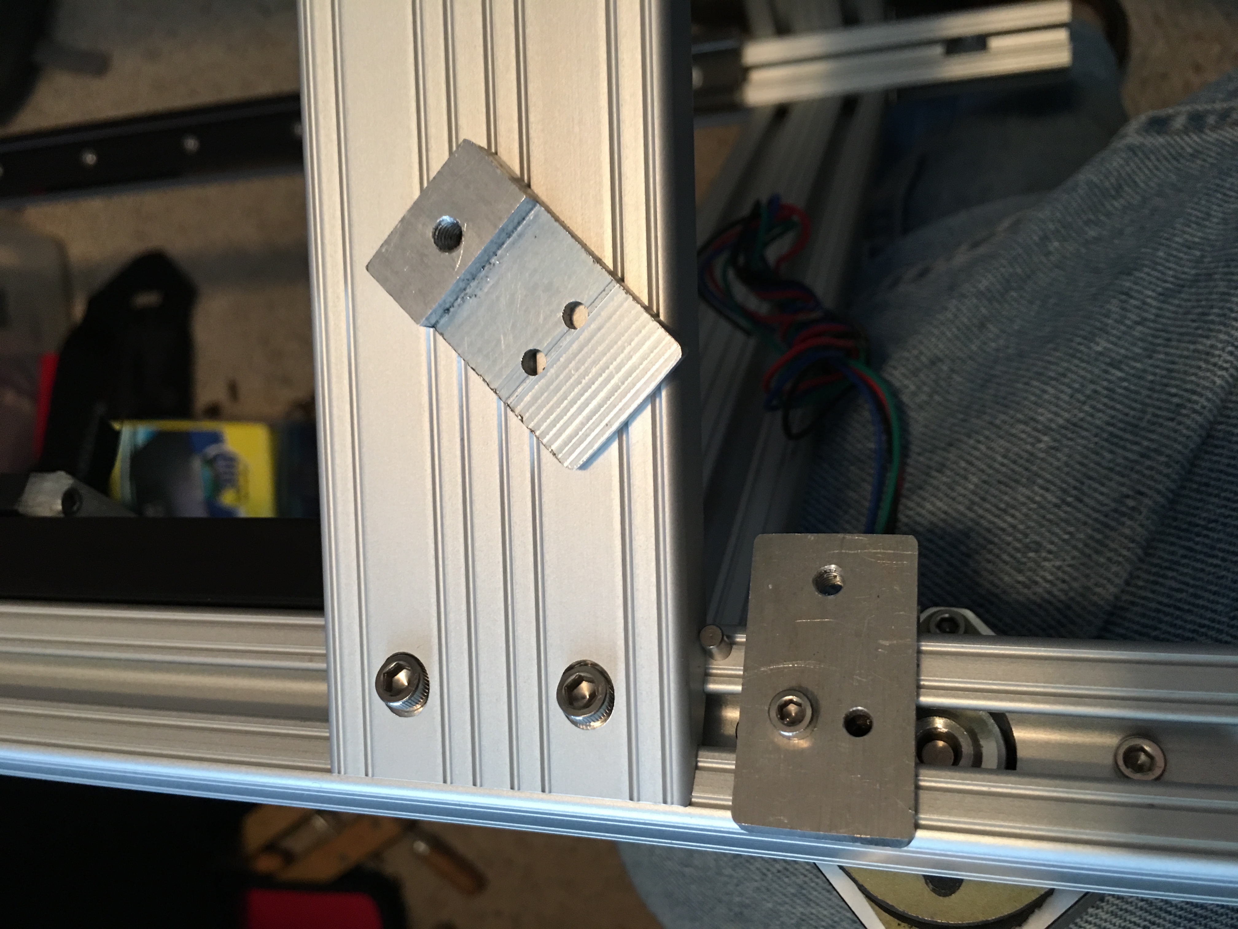

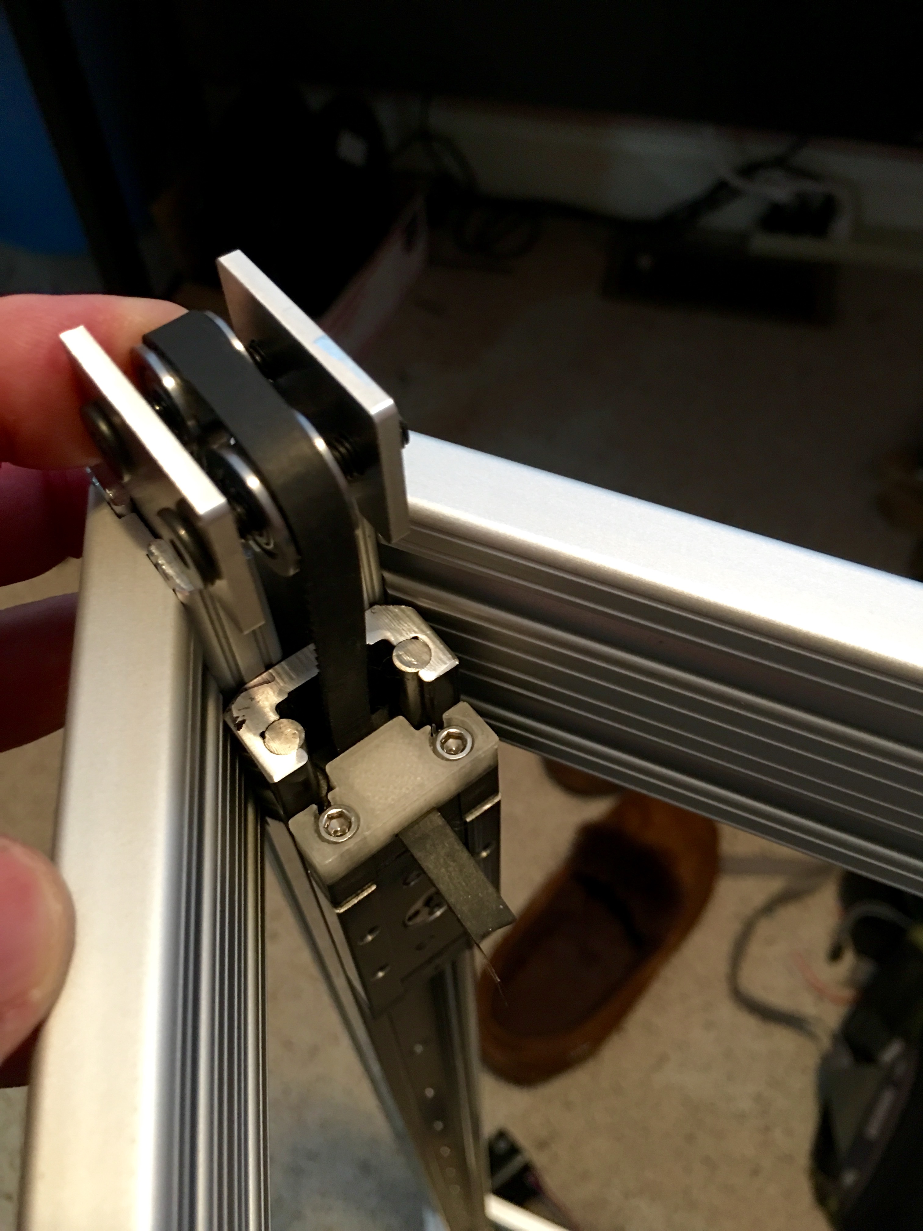

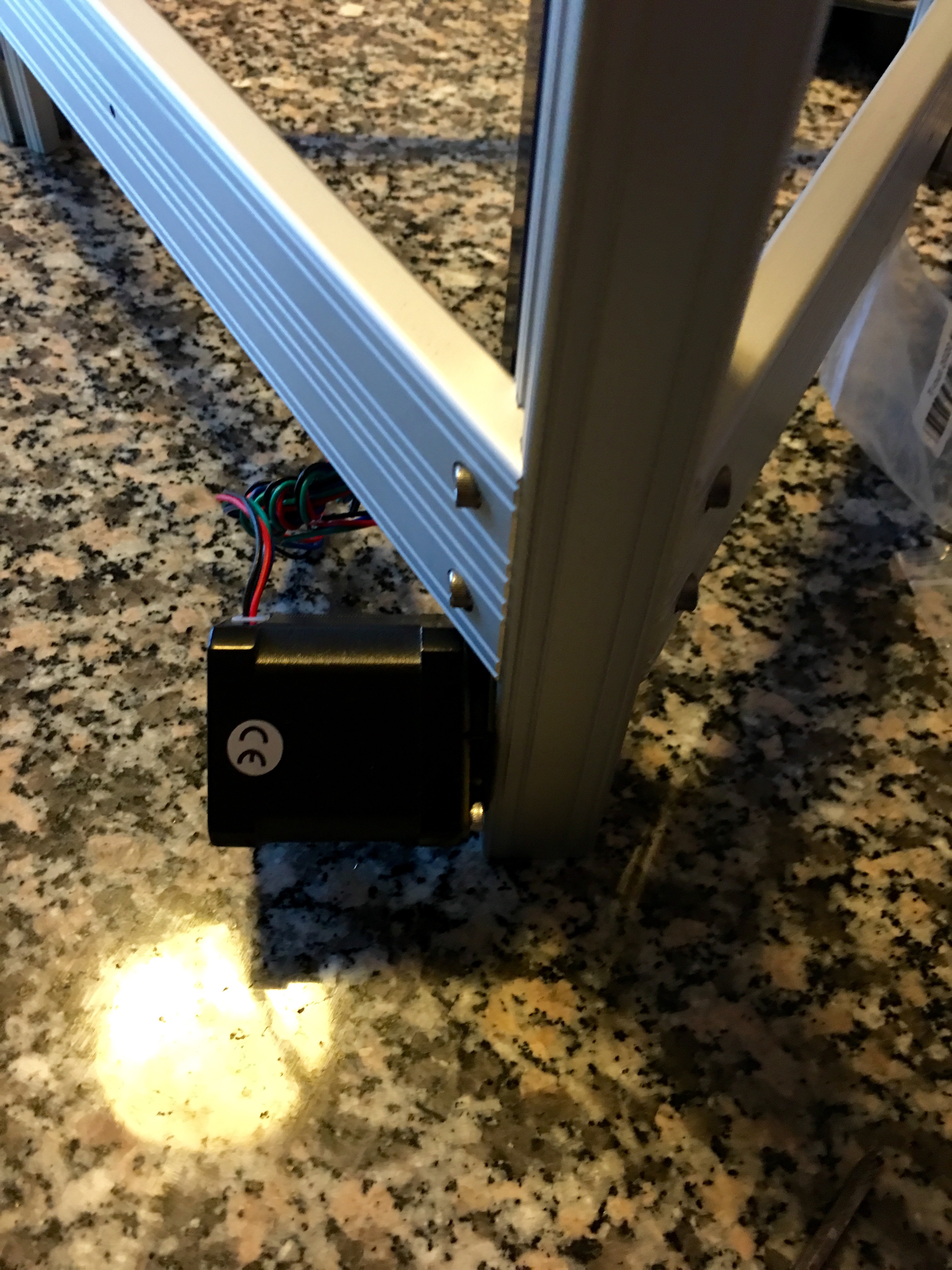

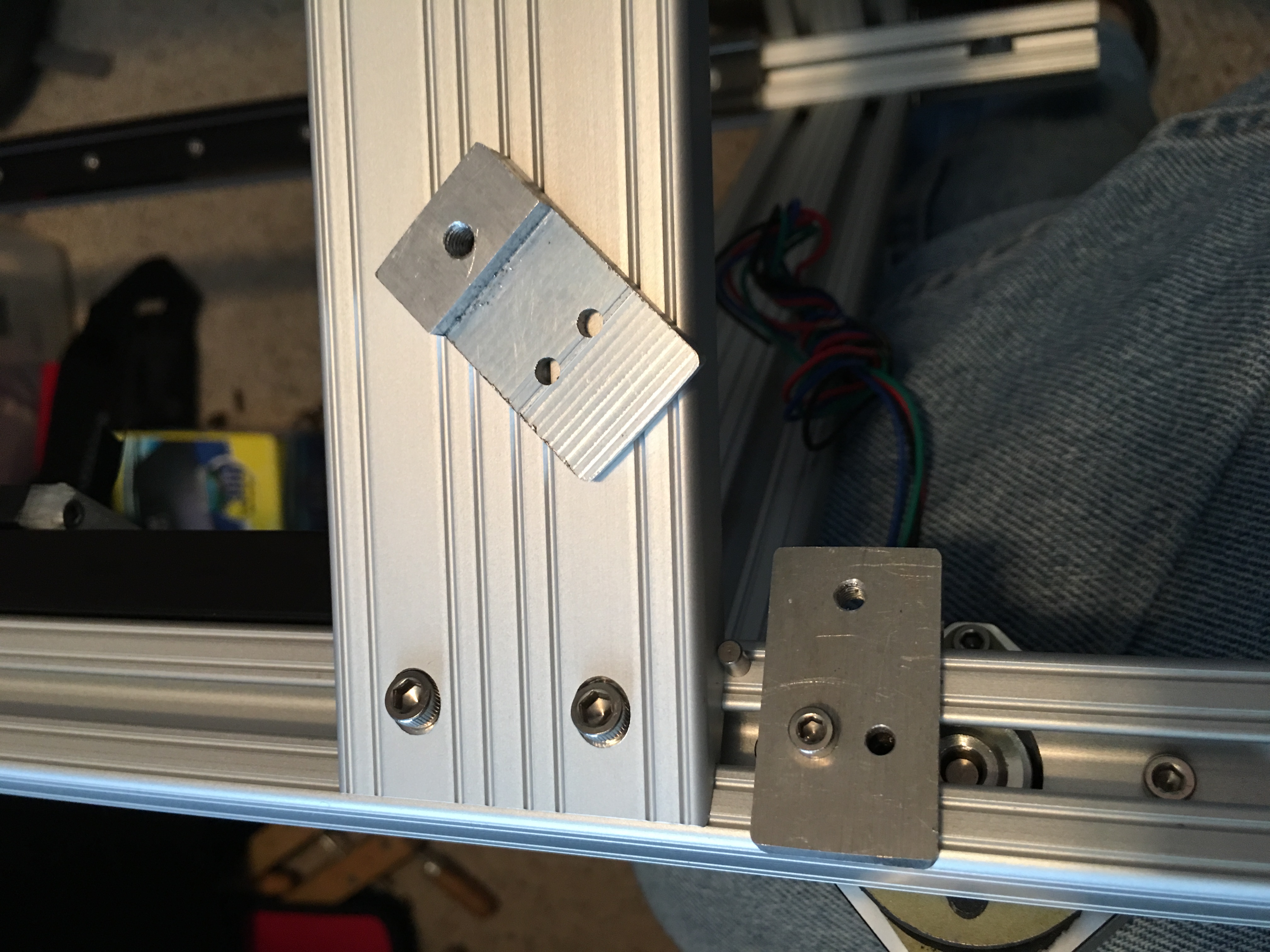

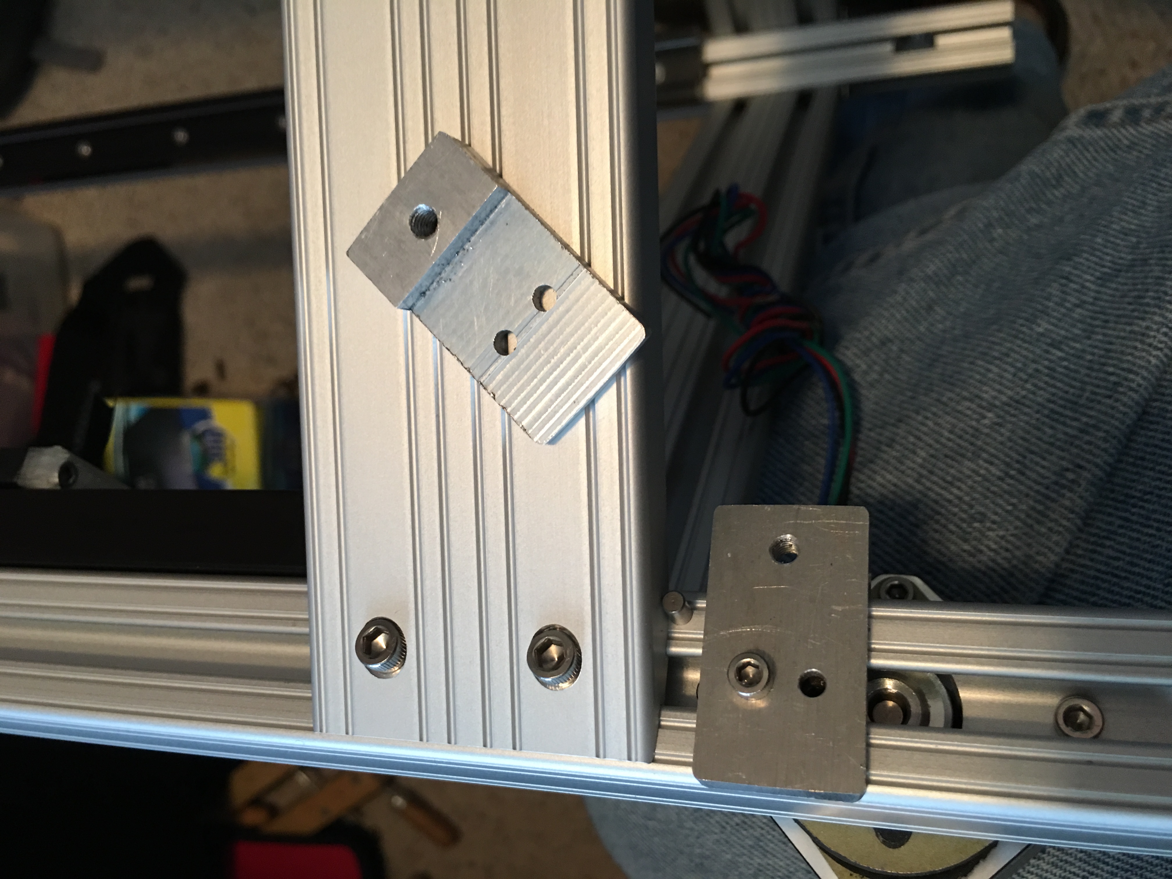

I started assembling the frame - dry run - so I can figure out the linear guide install. Since they sit further out from the uprights, I'll likely have to add additional idlers to position the belt properly so it is parallel to movement. I did run into one gotcha - I ordered 700mm rails thinking I would cut them to fit. I did not realize that they have steel rails inside the channel. I need to call the manufacturer to see how best to cut them as they interfere with the cross pieces now - as shown below.
.9° stepper on AstroSyn damper test fit

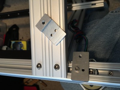

Speed Demon linear rail - just a bit too long. The holes are M3. I have some M4 threaded quick insert T-Nuts that would work perfectly on this uprights that I'd like to use. I only have button head M4 screws and they are too large for the countersink. Mot sure about regular M4 cap screws. I need to order some and see. I might have to bore and counterbore the mounting holes. But the rails themselves are a good match to the 1" 80/20 uprights.
Where the rail extend up past the bottom of the cross pieces it won't sit flush to the upright since it is a little wider than 1". So I do need to figure out how to cut the rails to size.

how do you plan to mount them without interfering with the belt path?
Re: Trick Laser MAX METAL with Linear Rails
Like I said, I will likely have to add additional idlers to move the belt towards the center of the machine and to clear the linear rail. Not sure if the V2s have this but the original V1 has 2 idlers at the stepper that position the belt proper in the track. The other option would be to do a Kossel like stepper mount and belt but I'd rather avoid that.

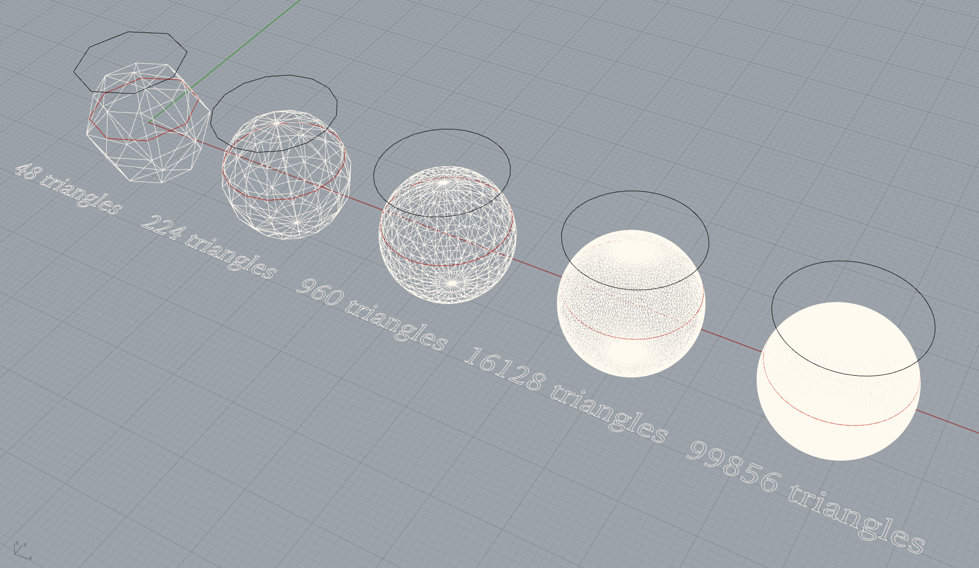

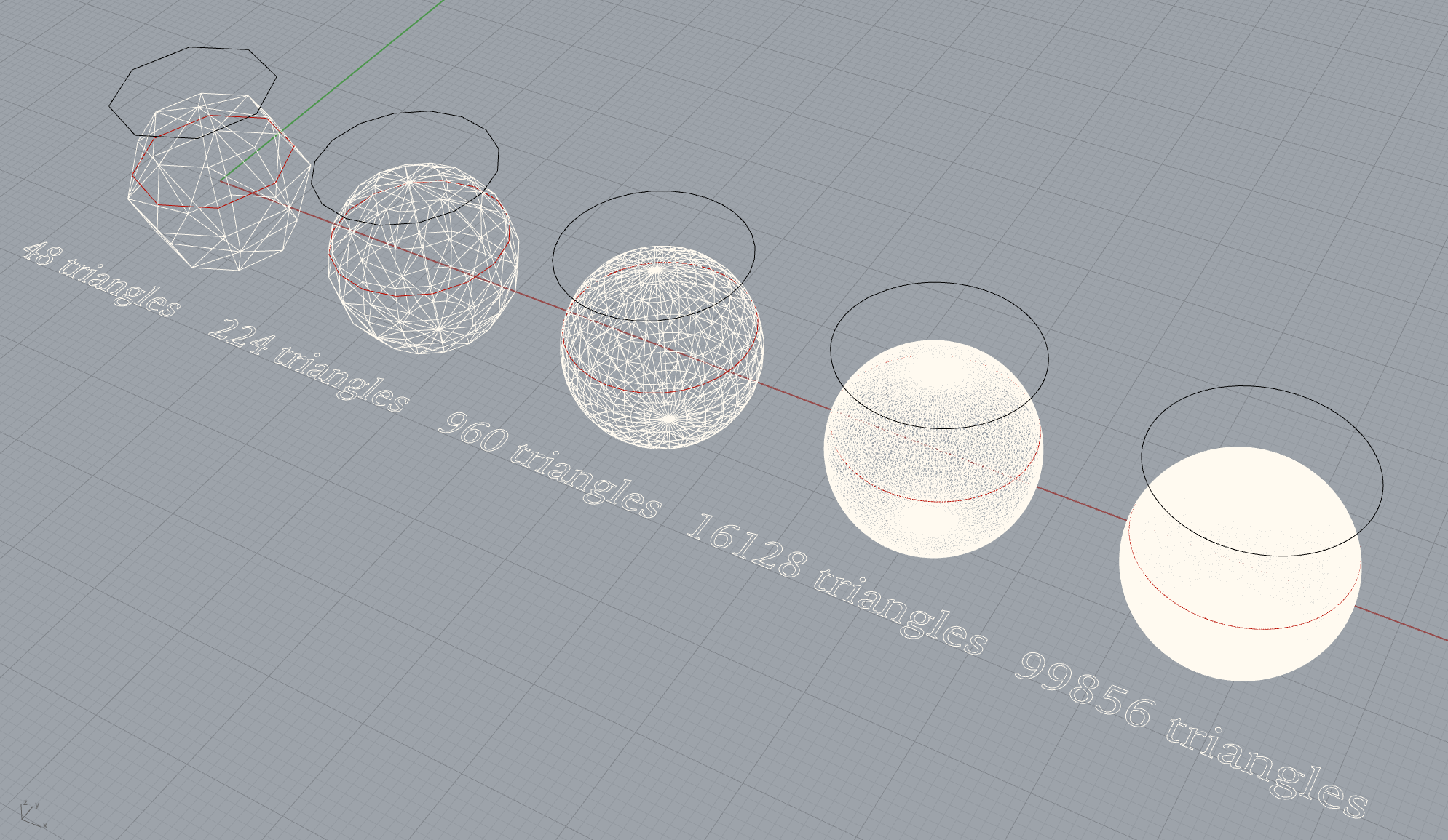

Other firmwares are interpolating movements into short line segments so, in theory, it has an affect on print quality. There are other factors at play too though - hence the reason for "in theory". By it's very nature, 3D printing starting with an STL file is going to sacrifice some resolution depending on how the CAD model was converted into an STL (most profound is the # of triangles in the final model). Here is an example of how this works...
Imagine you have a CAD drawing of a 20mm diameter sphere. The CAD tool uses sophisticated math to calculate the geometry and display it. It looks like a perfect sphere on screen. Now, let's run that perfect sphere through the meshing process to create an STL version. To demonstrate I am using 5 different resolutions that generate a low number of triangles to a high number of triangles. When you download an STL from Thingiverse, you have no control over this, the original author made the resolution choice for you. And frankly, most of the folks uploading to the shared services really don't know what they are doing. Anyway, back to the example - here I've meshed to create a "sphere" with 48, 224, 960, 16128 and 99856 triangles (from left to right). You can see that the far left sphere is course and the one on the far right is reasonably smooth.
Now to take this one step further, imagine your slicer creating gcode from these STL models. I created an imaginary slicing plane at 12mm above the base that is .02mm thick and took a cross section of the model at that plane. This is the red line you see inside each model. I projected these slices up above the models so you can see them clearer (black). The 48 triangle model has a slice with 8 sides - pretty low resolution. You can see as you move left to right, each slice has more line segments. These will result in a finer/higher resolution print all things being equal. But they are not! In addition to the slicer converting curves into short line segments, the firmware also imposes its own line segment on top of that - that is all of them EXCEPT dc42 RepRapFirmware. dc42 draws each point along the way completely tracing the original path it was given. Smoothie, Repetier, Marlin and the others actually break the path up into short line segments and draw those. This does not always match the original path exactly.
As you can see, if the STL had a low triangle count, you are going to get a course print. Increasing the triangle count will improve the print quality until you reach the segmentation threshold of the firmware, at which point, increased # of triangles won't have an effect and might actually make things worse. That is except dc42, which will faithfully trace each of the tiny line segments exactly point by point.

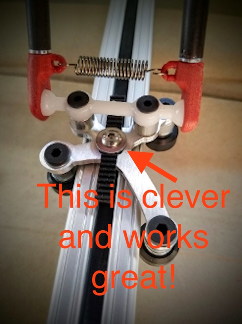

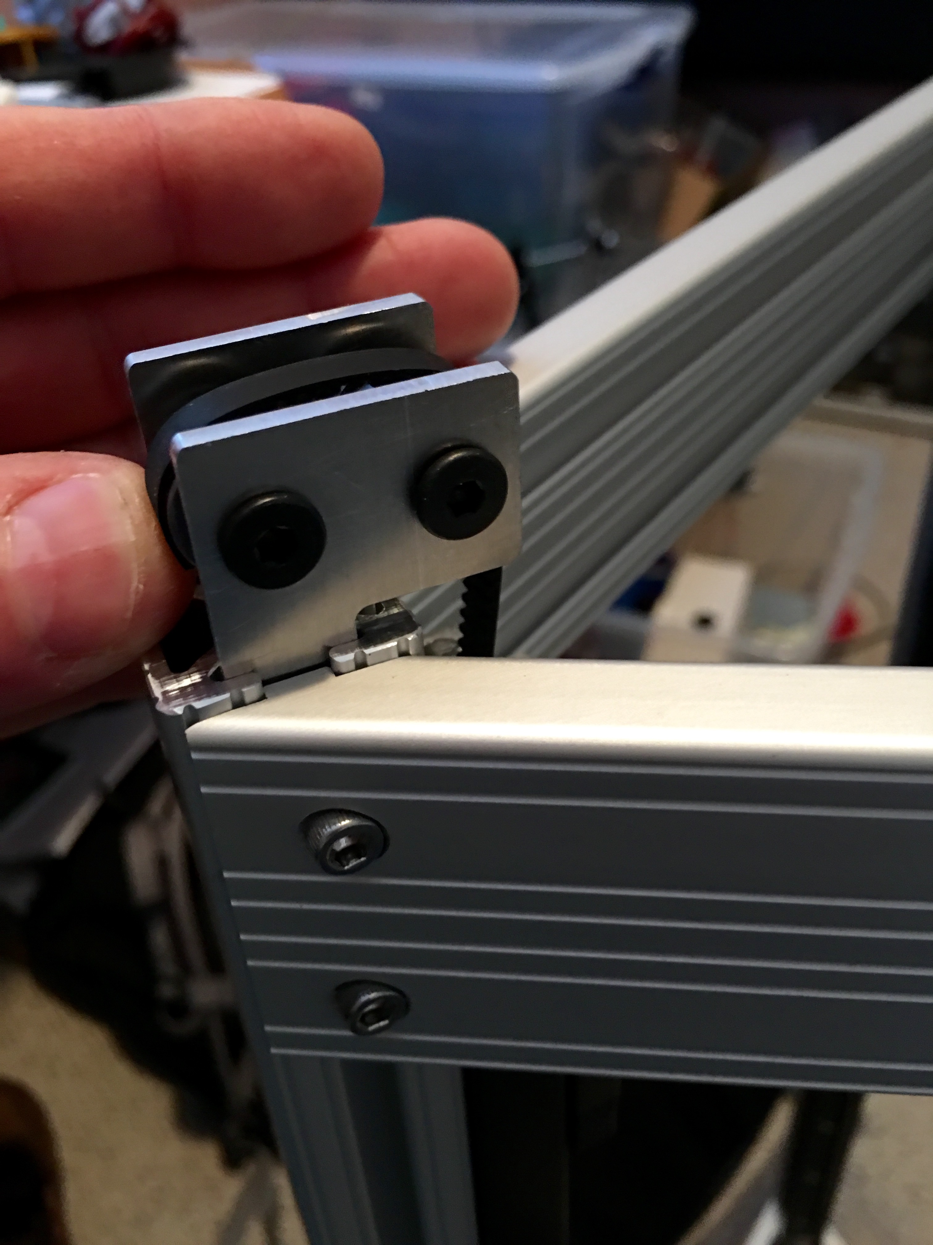

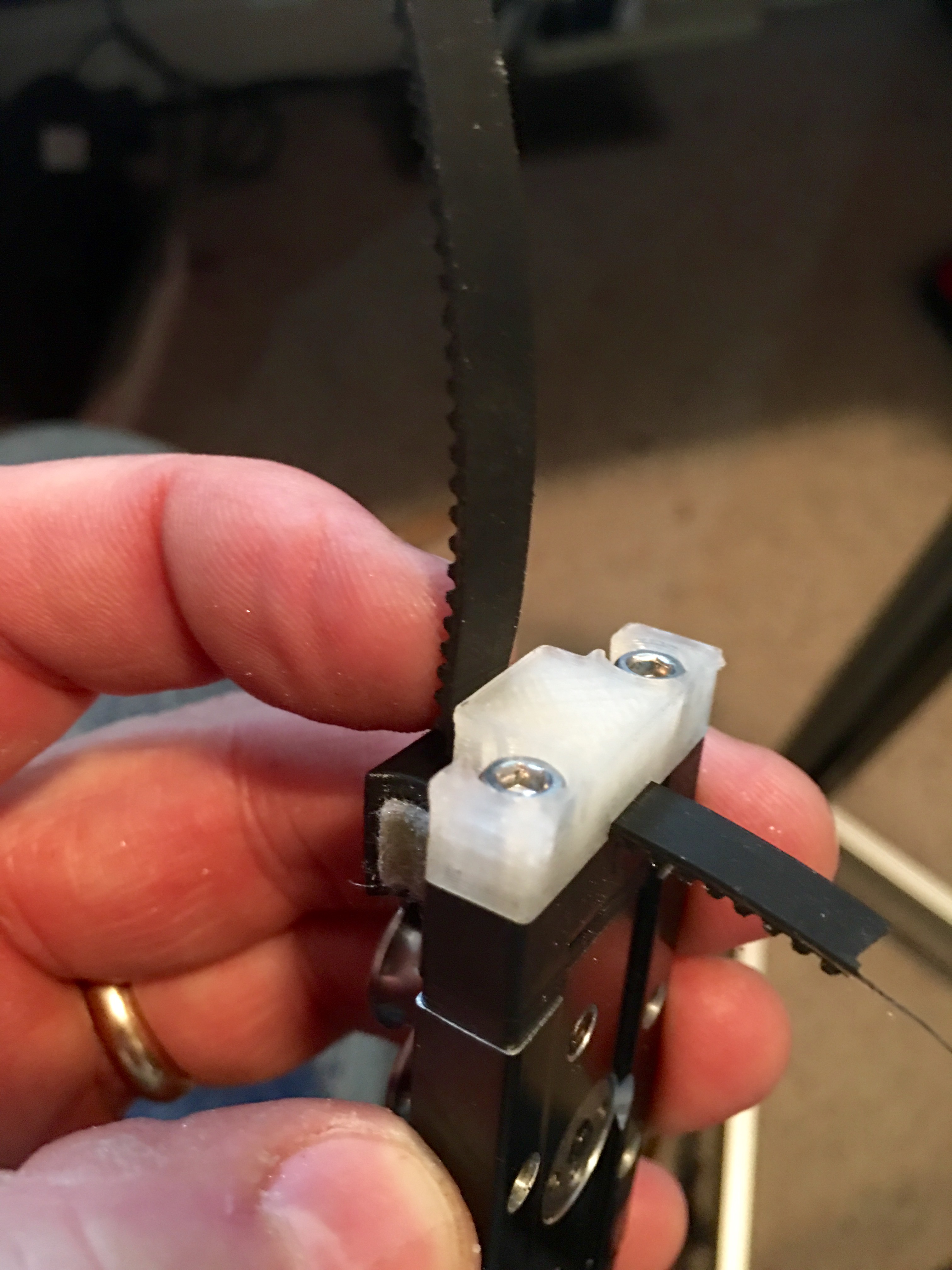

Ok, I have the belt path issues all sorted out. I made new idler mounts for the top and a special one for the bottom.
First, here is the belt mount to the top of the block. I am making a belt tensioner for the bottom side.

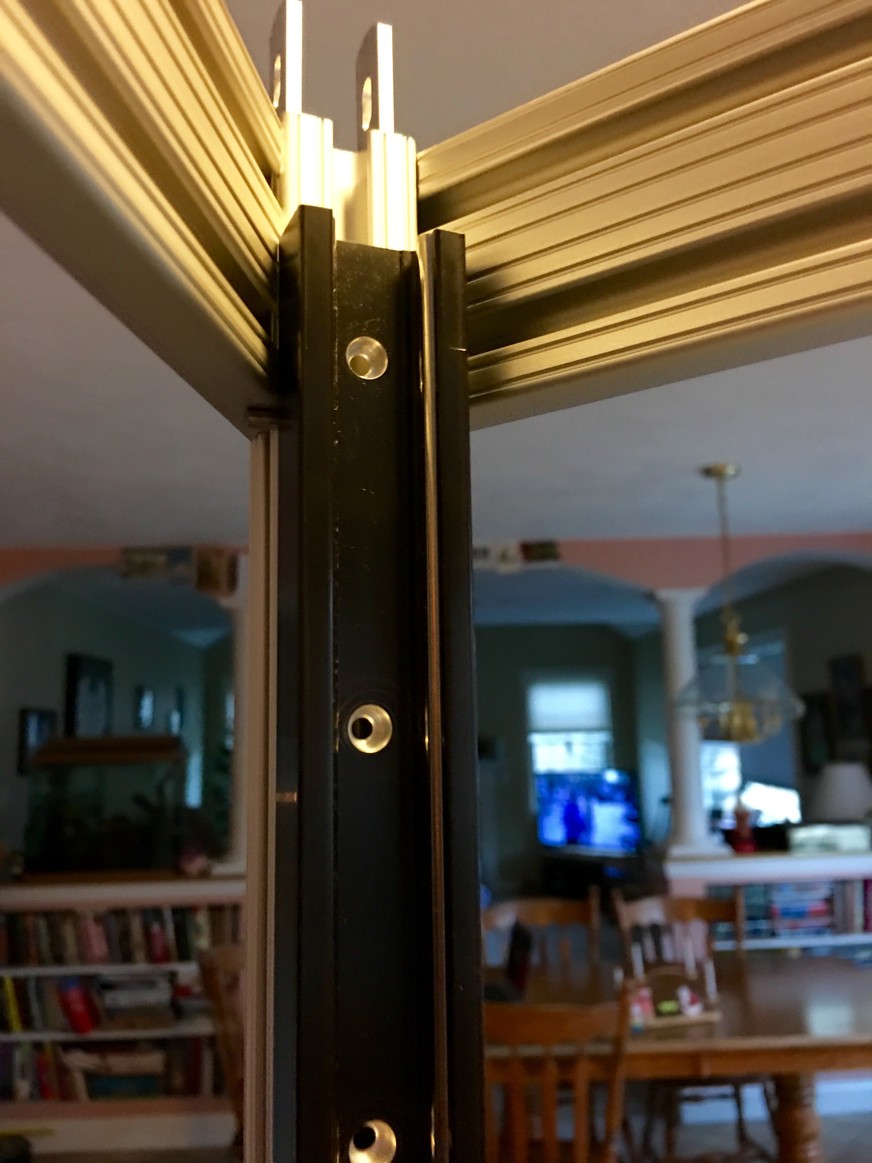

Top now has 2 sets of bearings to offset the belt properly.
A better view of the belt path.

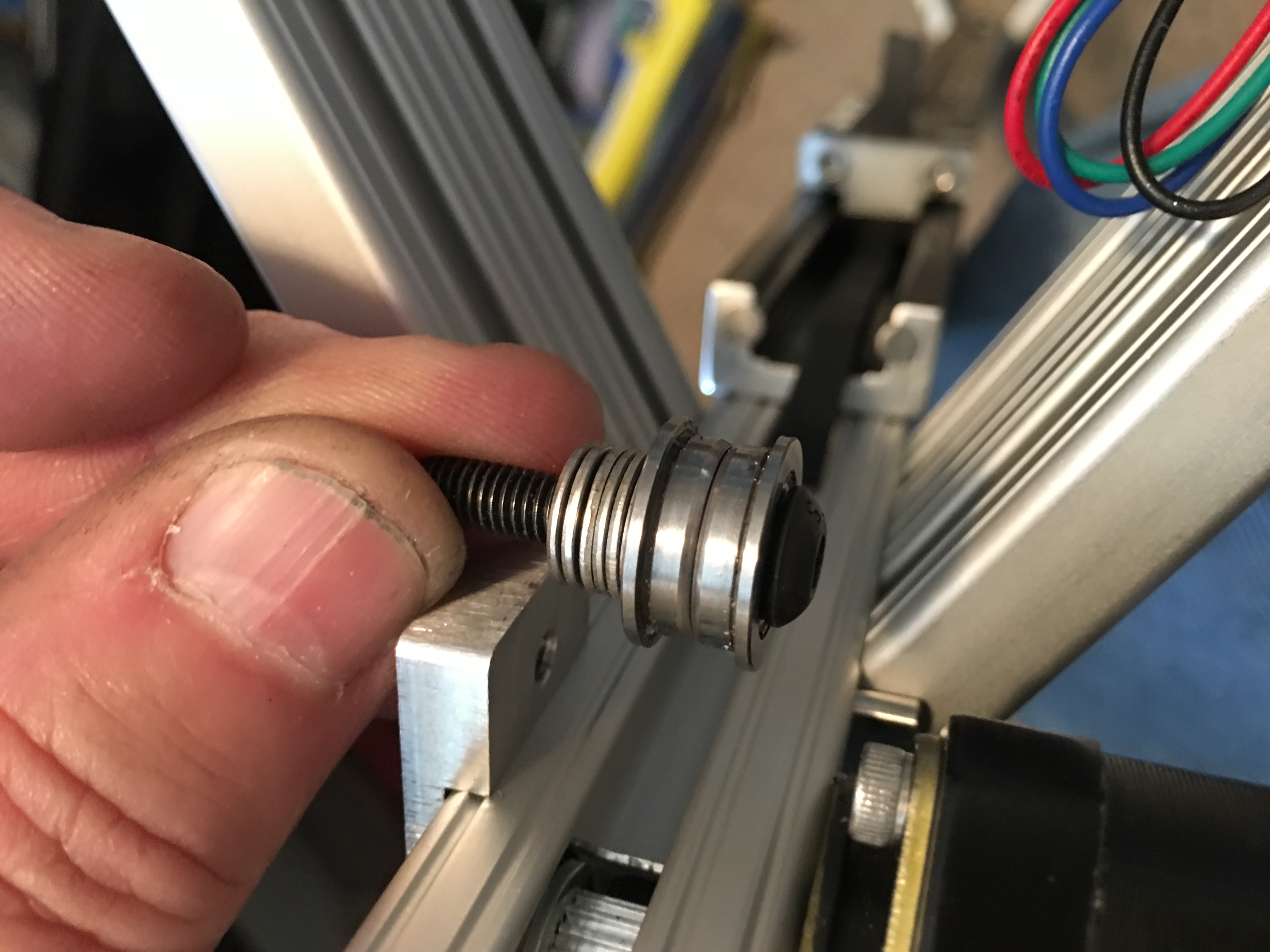

This is the bottom mount to offset the belt. There is not a lot of room to work but this works. There will be two M3 screws holding the bucket onto the rail. As you can see on the back side of the mount laying on the cross rail their is a recess milled into the mount to help align and brace it. The bearings are perfectly centered and there is absolutely no flex in the mount.
I am going to have to open the width of the slot a little bit so the bearings clear. I don't want to take the entire frame apart for this so I'll probably use my Foredom with a small grinding bit to remove the aluminum.

Metric specs for dimensions. The rails I got are just a smudge wider than the 1" extrusions for the uprights. Now that I have my frame together, I can measure the actual length for folks to order. I got mine too long and had to bevel the edges a few inches to get them to fit.
