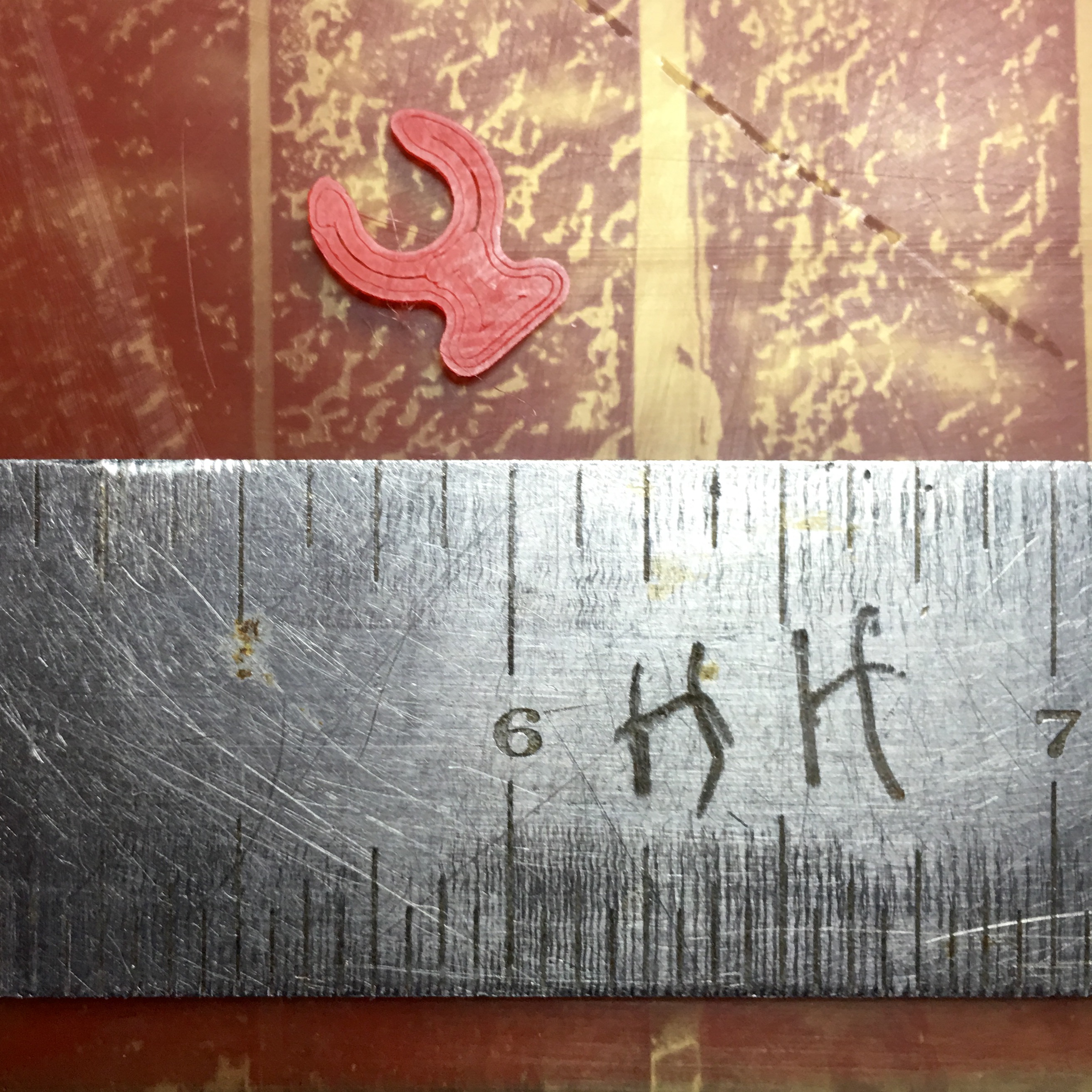

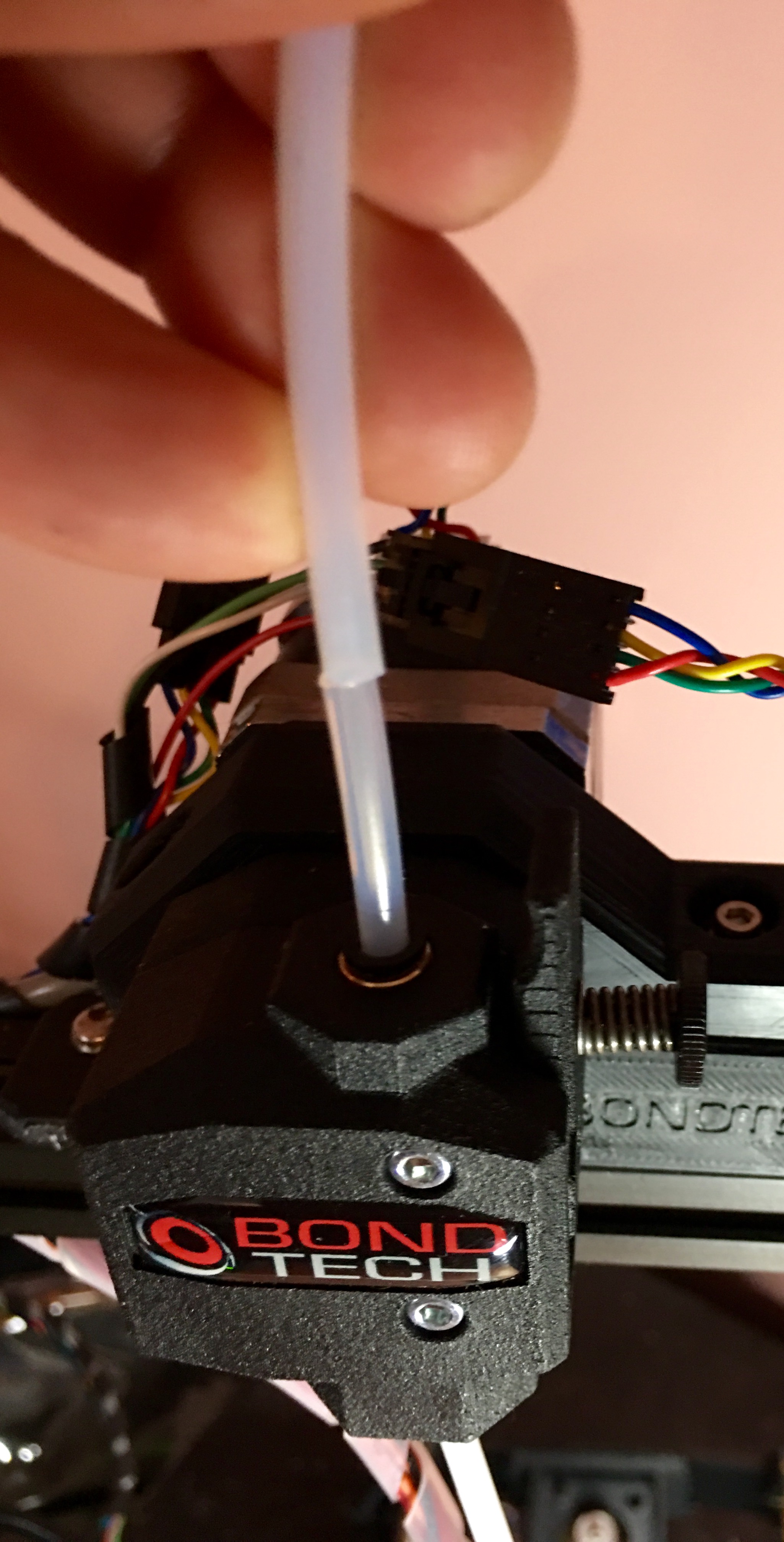

Martin has published some nice Bowden tube clips - print one for each of your extruders:
1.75 mm clip
3.00 mm clip
Here's one printed. These are nice, I now use them on all my PTC couplers.
These insert on the OUTPUT side. Basically, they insert between the little black plastic collar and the brass body of the PTC fitting and remove the backlash of the fitting moving up and down slightly during retracts, etc.

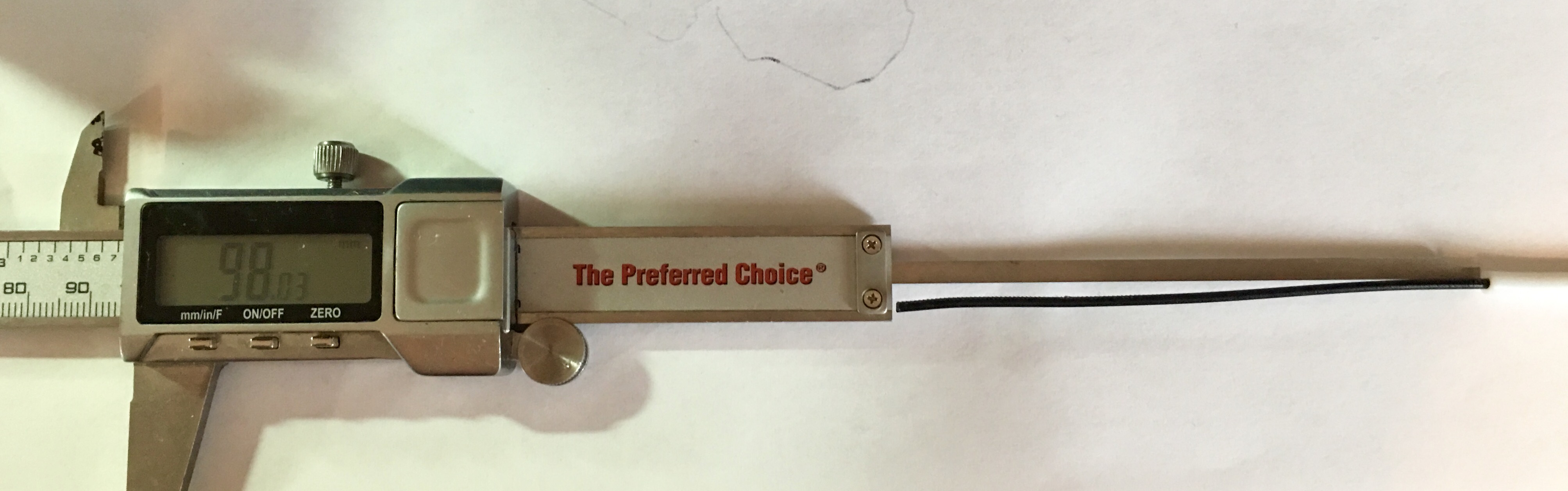

Now measure the length of the extruded filament from the cut edge of the PTFE tube to the cut end of the filament. You can use a ruler or use the depth gauge end of your calipers like this:
Note: it was impossible to photo this myself. In practice, the filament should be much straighter and pressed up against the end of the height gauge. But you get the idea.
I like to do 3 samples and then average them if there is much variability. Once you have the measured length, recalculate the new calibrated steps/mm like this:
calibrated steps/mm = current steps/mm * (100.00mm/measured filament length)
so for this example:
new steps/mm = 490 steps/mm * (100.00mm/98.03mm)
new steps/mm = 499.85 steps/mm

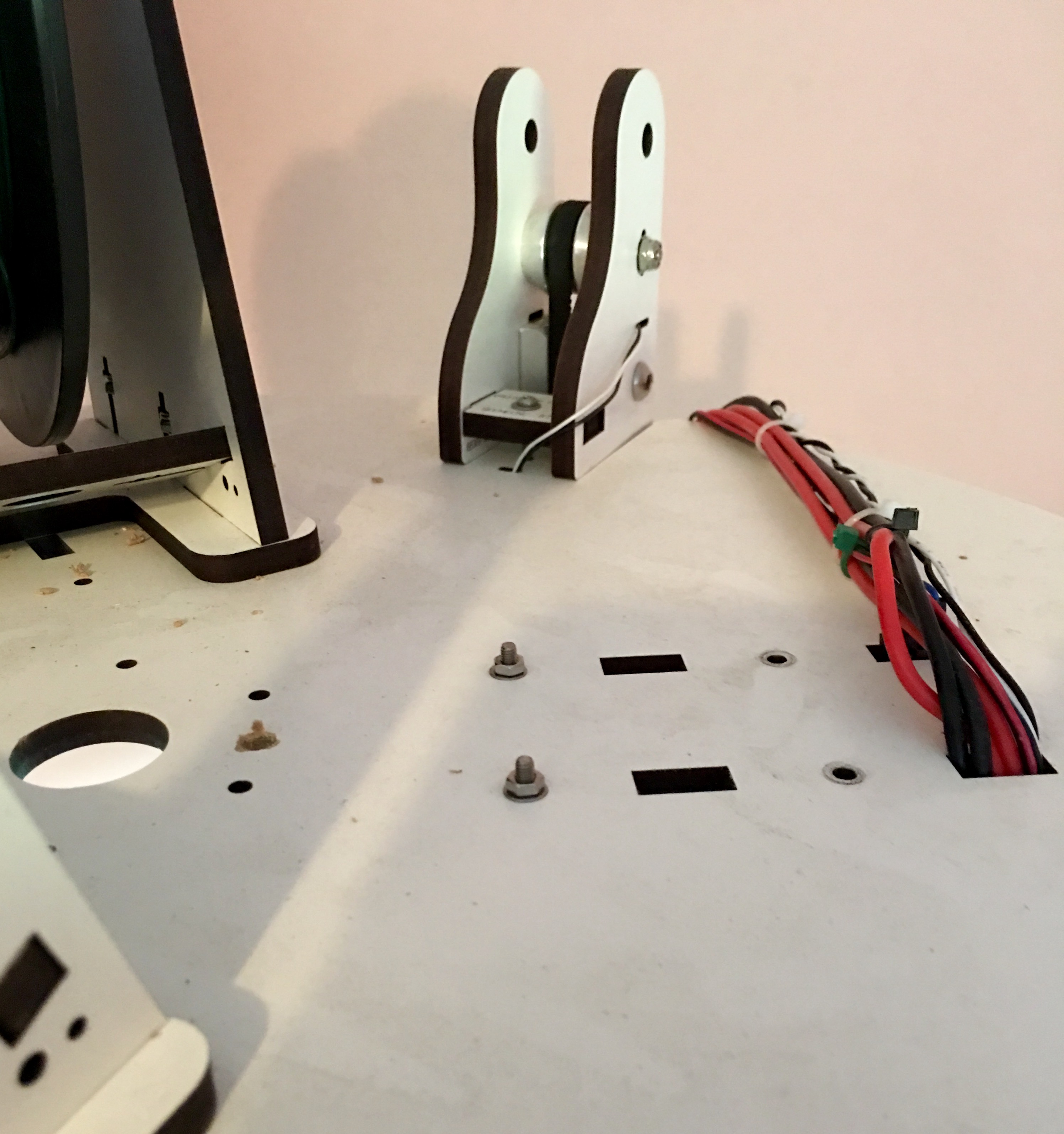

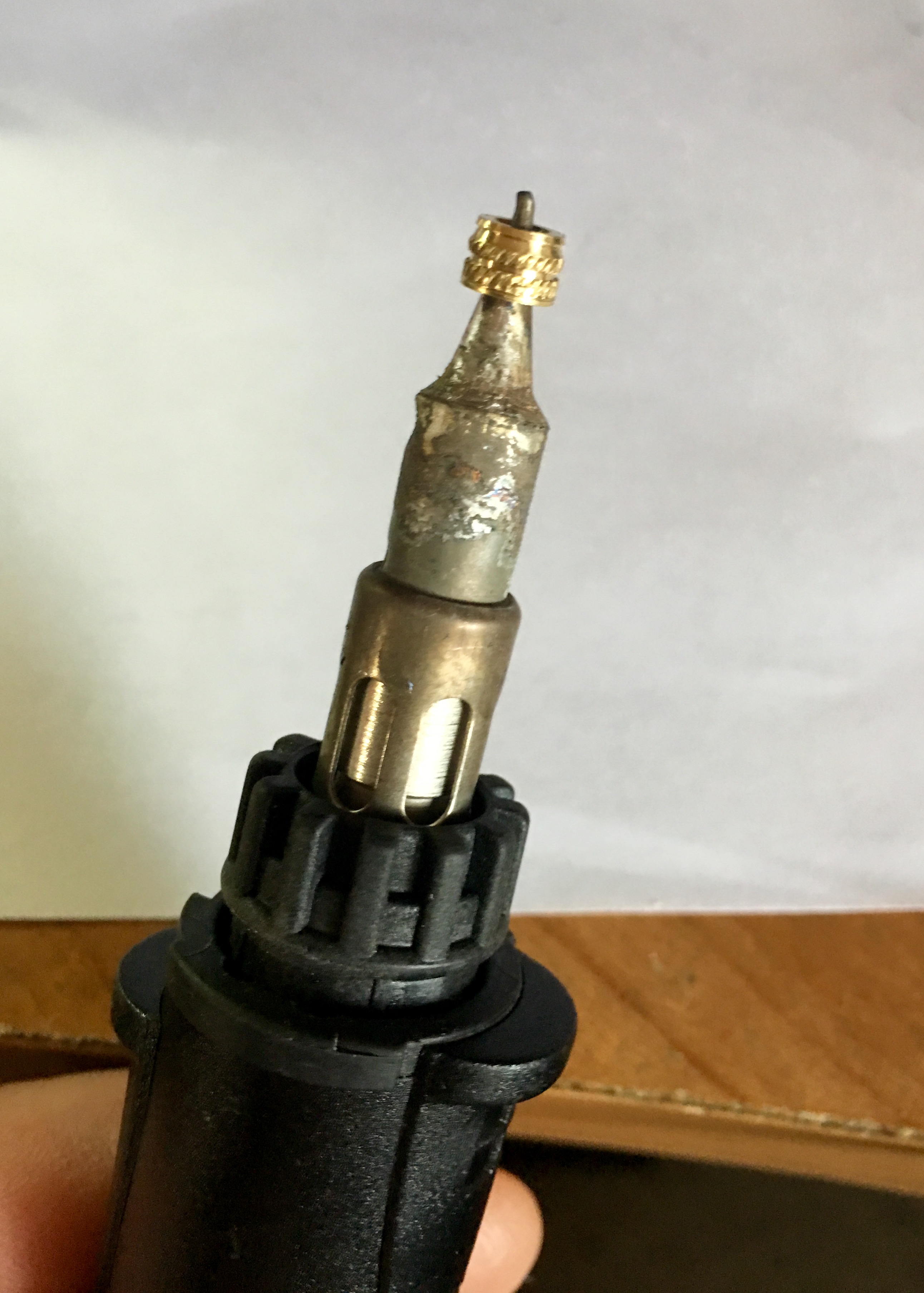

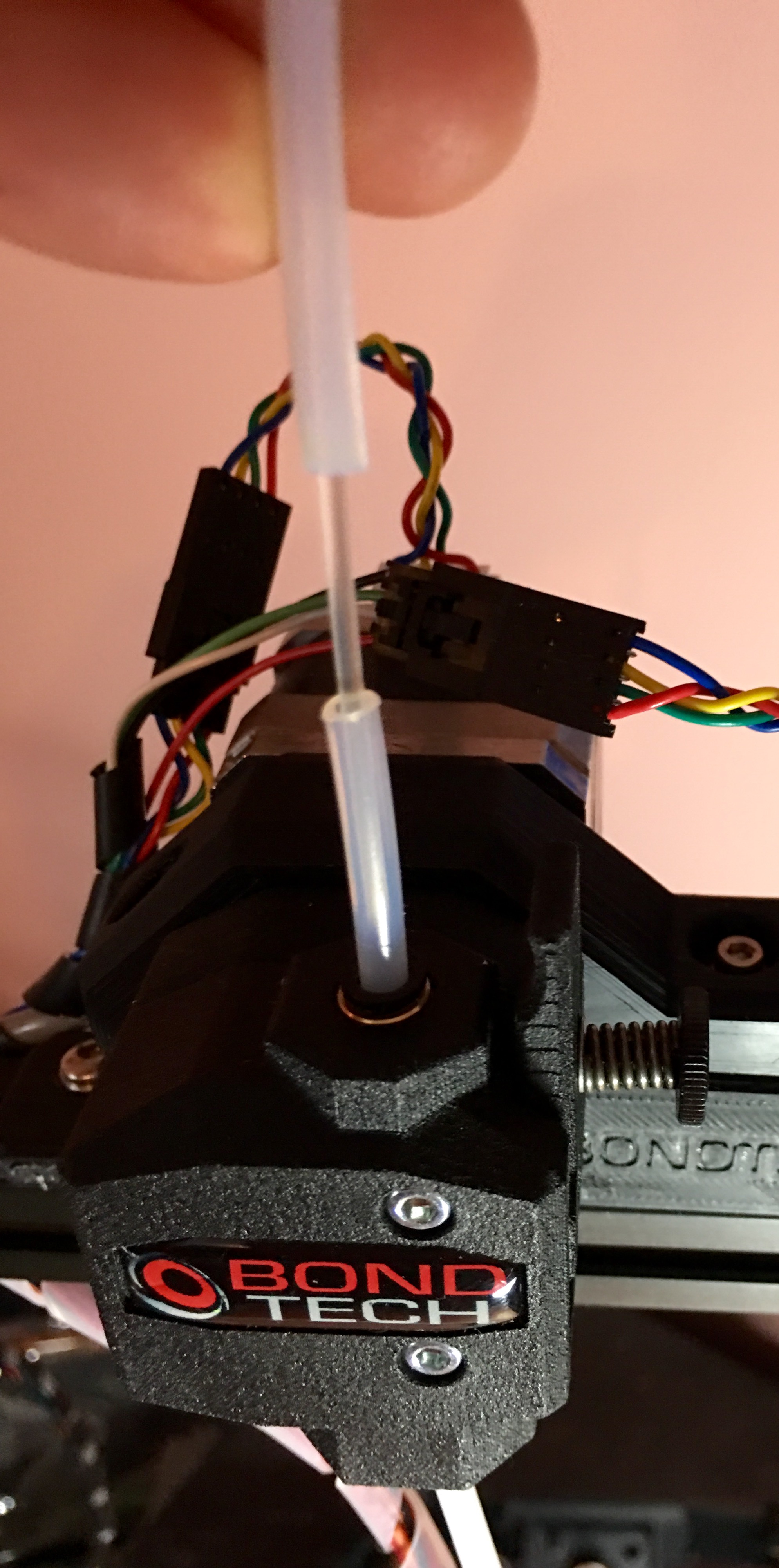

Here's a tip on setting up the filament infeed. The QRs have PTC couplers on the infeed side too so you can either connect a long tube over to your filament spool or do this:
This helps in several ways.
  1. it's easy to feed the filament in, you push it through the long tube from the spool to the end where you can grab it to push through the extruder and Bowden.
  2. during retracts, the top indeed tube lifts the amount of the retract so you get a visual indiction of retract.
  3. you could insert a little felt or other lint free pad (microfiber is what I use) in the space to have a filament wiping system to remove surface grunge. PLEASE DO NOT use this to add "canola oil". I will never post another tip if you do!
For the feed tube itself I use PTFE with a 3mm ID and 4mm OD. The larger bore minimizes friction and the thinner walls allow it to bend nicely from my filament spool to the extruder. I got mine at McMaster Carr.

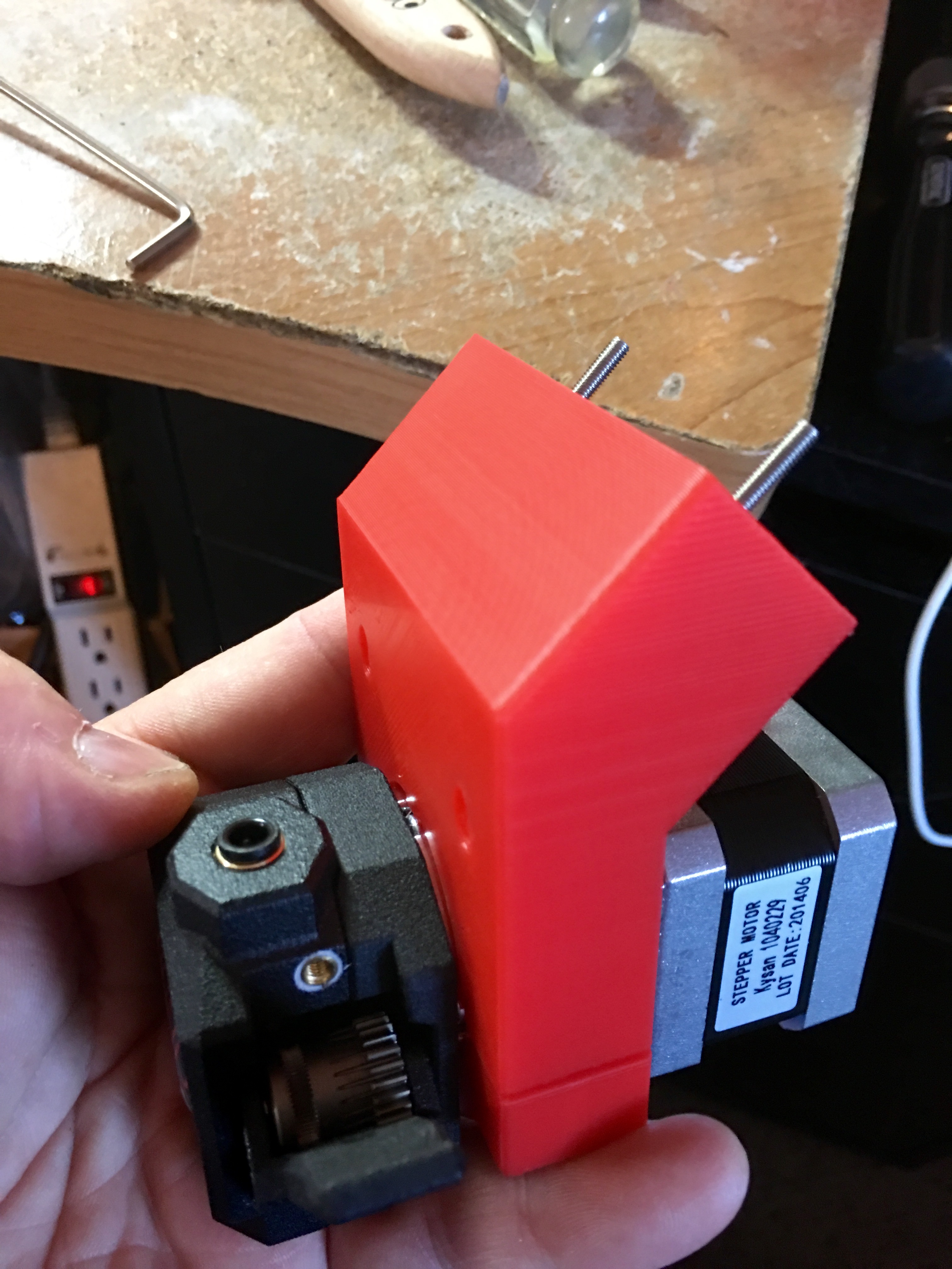

BondTechQR Rostock Max Mount
I tried to design this to be an easy retrofit for the Rostock Max V1 and V2. I have a V1 and it literally just replaces one of the top mounted extruders in pre-existing top plate holes. It will sit closer to the top plate than the stock ezStruder but that's fine, there is still plenty of room to access the lever and feed filament.
Print with 3 shells, 3 perimeters and your choice of infill at 25%. All M3 hardware. You need two M3 threaded inserts the short size works if you have them, if not the long ones are best. Turns out that BondTech sells these on their accessories page so pick 2 up when you order your QR if you don't routinely use threaded inserts and don't need 100! You can use a regular soldering iron with a small point to install, no special installation tips needed. Note that the smaller diameter end goes in first. Another tip is to use low heat. If you go in too hot, you'll make a mess and the insert will likely be tilted and not held in well. Low heat and a nice slow insert does it.

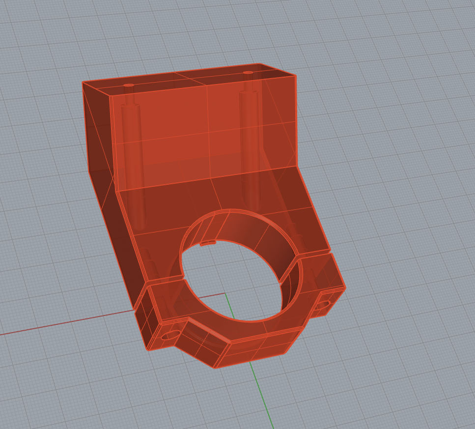

This is a rendering of the Rostock mount for the BondTech QR. Let me know if you print one and how it turned out - especially if you have any tweaks to recommend.

Hey folks, it looks like the mount holes for the V1 and V2 might be different. I have a V1 and the holes in the top plate are 40mm apart. Can someone with a V2 please check the hole spacing for me? Even better, if you could print this mount to do a dry run fit to see if it will even work on a V2 would be great!

mhackney wrote:Hey folks, it looks like the mount holes for the V1 and V2 might be different. I have a V1 and the holes in the top plate are 40mm apart. Can someone with a V2 please check the hole spacing for me? Even better, if you could print this mount to do a dry run fit to see if it will even work on a V2 would be great!
This is a QR Mount modified for a Rostock V2. This has the mounting holes at 50mm on center.
Warning this has not been printed or tried at this point.
Rostock Max V2 Mount -2.stl
(7.04 MiB) Downloaded 514 times

So it's verified that V2 has 50mm spacing?
I'll update Martin so he can make a V2 version on my mount. He is planning to post the STLs for these on the bondtech web site.
Meanwhile, a comment on orientation. It is much better to orient the mount the way I have it in my original STL. The "overhang" part of the base is 45° and prints beautifully in that orientation AND you'll get nice round, clean holes for the stepper clamp. In this orientation, the stepper clamp holes will be difficult to print cleanly.
Clamp printed standing up. Original BondTech received with extruder was printed flat, it has a layer split through one of the clamp bolt holes. I did not want the layers running parallel to the holes. Guess a split the other way is not much better but the section is heavier.

Got it. I usually print with 4 perimeters so the holes are pretty strong. There isn't a lot of force on them in any case. I commented on your post on the google plus group, thanks.

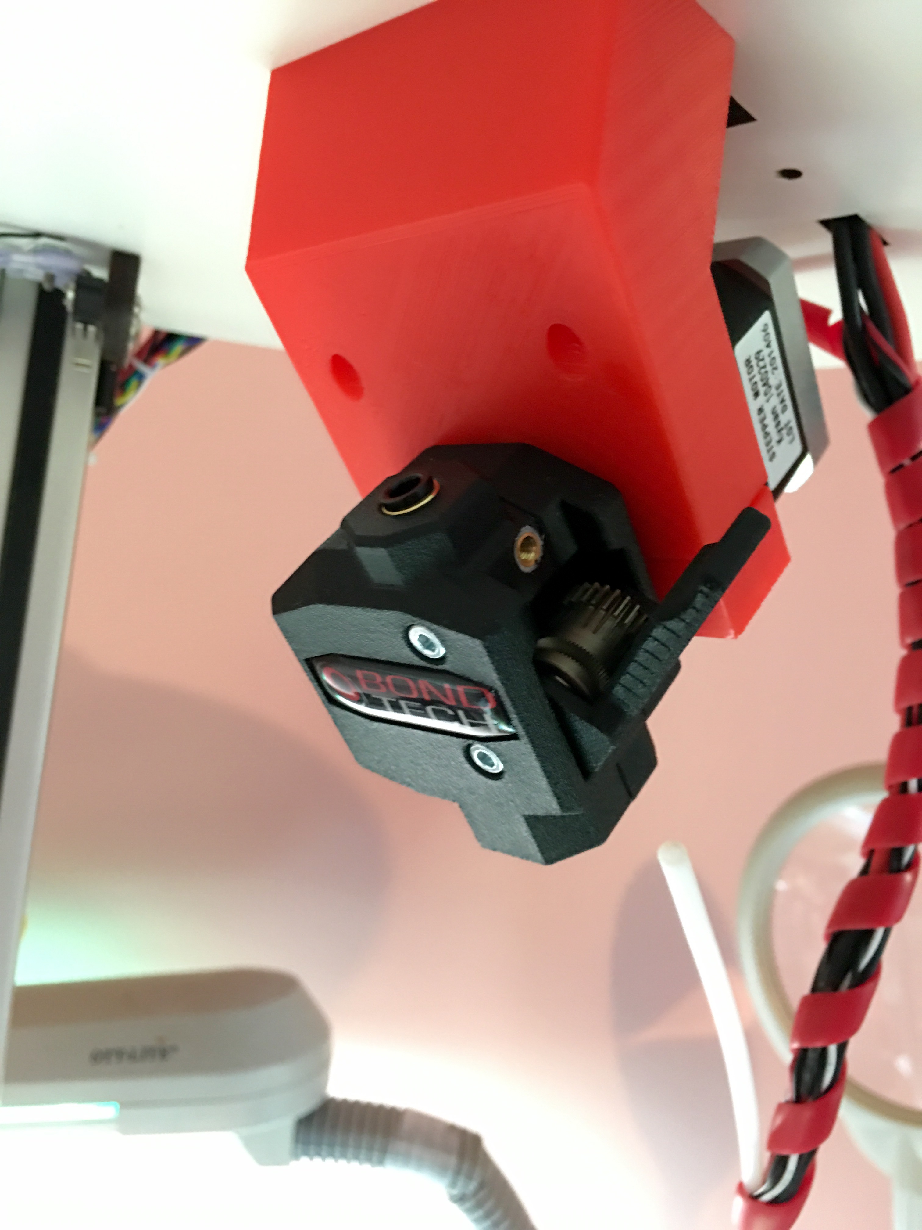

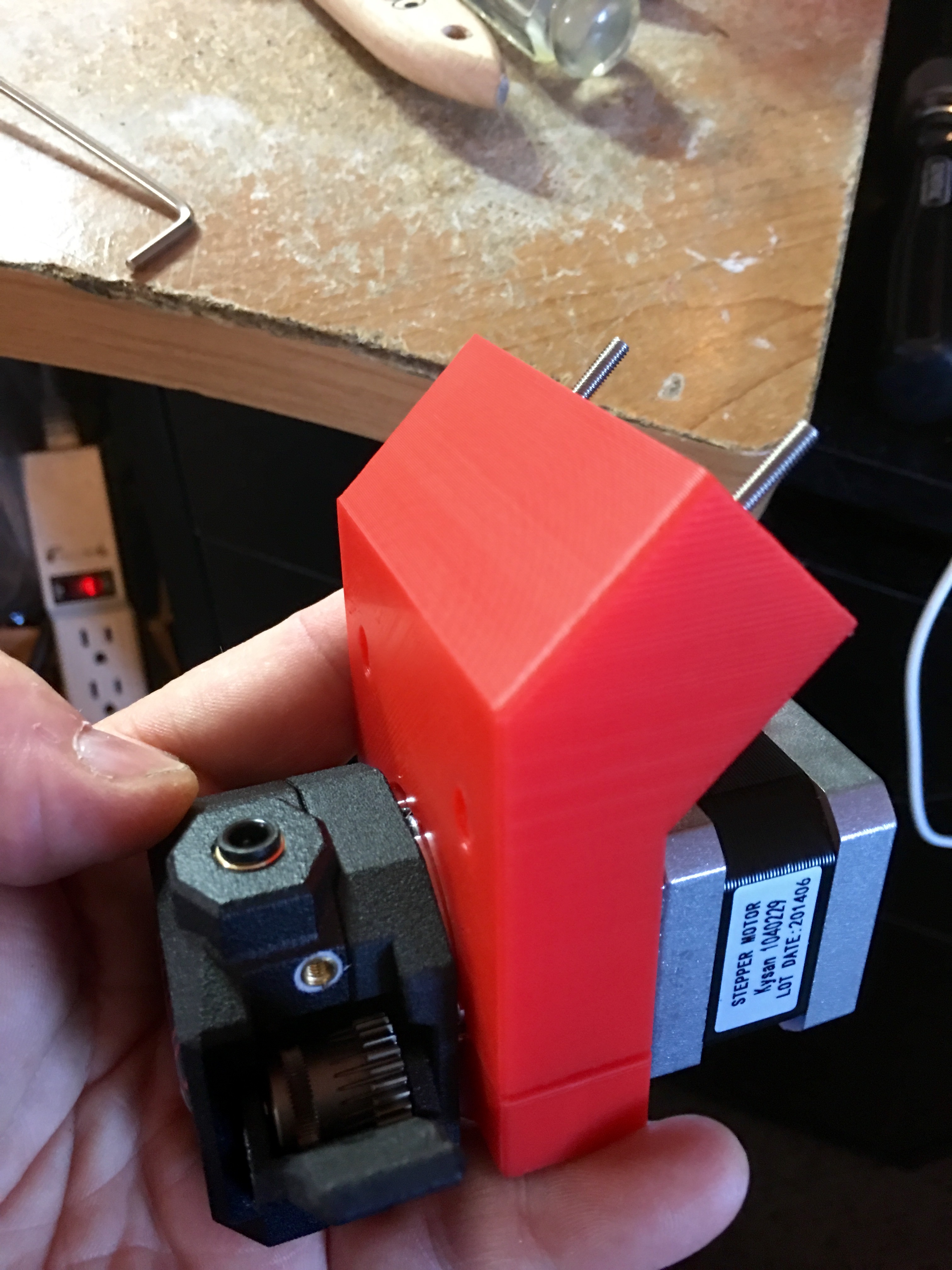

Installing the BondTech QR Extruder
Meanwhile, here's some more info on installing. If you use my mount, you'll need two M3x18mm screws, washers and nuts to attache to the top plate.
I found it easier to install the mount without the extruder attached.

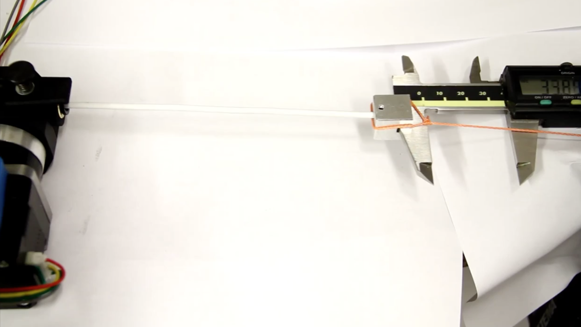

Martin rigged up a cool fixture and shot a video he shared with me to test the calibration and reproducibility. Here is a screenshot of the fixture. The cord is hooked to counterweight so the filament goes both ways. This is neat because it removes all human measurement error and it puts a little tension on the filament to keep it straight.
Martin measured some of his drive gears and they are all 11.35mm +/-0.02mm (measured at the top of the cobbled diameter). He is seeing 476.55 steps/mm for 1.75 PLA and 493.45 steps/mm for 3.0 PLA. He's seeing .01mm repeatability over 100mm.
I am going to create a similar fixture and test all 8 of mine. But some thoughts he passed on:
Make sure the drive gears are clear of any plastic debris.
Make sure the gear grooves are lined up perfectly. If the filament is not exactly in the valley, it can throw things off.
One thing to keep in mind is that 50 steps moves the filament .1mm. If you are not very precise and repeatable, even a .05mm variation would result in a variation of 25 steps/mm. The reason for measuring 100 mm of filament is to improve measurement and minimize errors but a little variation could creep in. I like Martin's fixture because it precisely measures the amount moved to the resolution of the calipers. I do not know how many different filaments and/or QRs he tested, I've asked for that.

Love that test rig. I'm going to be mounting a new extruder system onto my effector soon so I will have to use that to calibrate it.
*not actually a robot
Re: BondTech QR Extruder Tip #1 - Calibration
Yeah, it's clever. Wish I thought of it.
From Martin: it was ABS he tested and only one extruded. He'll do more testing too b
