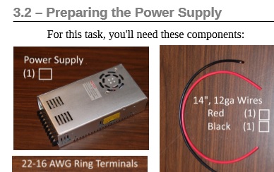

I just started my Max V2 rev3 last night, and started to get confused with placement of the new power supply, so this new documentation was perfect timing -- thank you!!
One comment, I noticed the hot bed instructions flip between refering to 12ga and 18ga wire.
So, I'm assuming it means 12ga.
After building the RAMBo connector with 2 of the pieces of 12ga wire (and short wires too), I have 2 extra pieces of 12 ga wire.
So, I'm using those for the Onyx hot bed. My suggestion is to make the references all to 12ga (if that's correct).

Scott, do NOT use the 12ga wires on the Onyx! I'll make a note to review the text tomorrow and get it fixed.
The 12ga wire will not fit in the compression terminals along the top of the RAMBo. (nor will it fit in the physical space above the board) They'll only fit in the side connector where the power goes into the board.
Use 18ga for the wire.

Can you clarify something for me scottj? Did you get two pairs of 14" 12ga wires (2 red, 2 black) or did you get one pair and cut them down?
I just went through the Onyx chapter and no where does it say to use 12ga wire for the Onyx! What's the version number and date on the front page of the manual you're working from?

Version 4 mentions 12ga wire on pages 35, 37 and 41 and does refer to using 12ga for the Onyx on page 41.
I hope this helps.

Gene, V4 of the manual on page 35 it says :
Now take one of the red and one of the black 12ga wires and insert them into the terminal
block. Insert the smaller 18ga wire first and THEN the 12ga wire. Just like with the smaller wire, if
you can see more than 1/16” of bare wire sticking out of the connector, trim it until it seats fully with
little or no exposure of the bare wire. Figure 3.2-3
Is it correct to put a 12ga wire in the Rambo terminal block?
Re: [11Nov15 - Rostock MAX v2, 4th Edition Manual
Yes, that's correct. The power leads from the power supply to the black compression terminal block are indeed 12ga.
Two different terminal block designs, Eagle. The green plastic terminal block along the top of the RAMBo is sized such that when fully opened, it can take a maximum of 14ga wire. The black terminal block on the right edge is sized for a max of 12ga. The black terminal block is for incoming power and the green terminal block is for outgoing.
Make sense now?

Yes, I got 2 black and 2 red wires, all 12ga. I was able to fan them out and solder them (with extra flux) to the bed.
After reading this, I tried to fit them into the green connector and see the 12ga will not fit.
EDIT: to clarify, I didn't have any other two wires to use on the hot bed, so I assumed (!) that I was to use the extra 2 12ga wires in the kit since I had no other option. Plus, I figured the heavier wire was part of the recent update, which seemed to make sense at the time.
I wonder if I can trim down some strands to get it to fit into the connector?

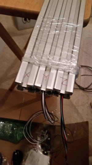

Another comment about the 4th Edition Assy. Guide -- I was confused about fishing the wires through the aluminum extrusion. It mentions preparing the 18 ga. wire, but no mention of when/where to use it. I figured out (from page 84) that it was meant for X axis tower.
But the docs say on page 71:
Now go ahead and pull the 22ga wire for the hot end down
the next tower extrusion and label it “X Axis”.
I think this is an error, and should be "18ga wire" instead of "22ga wire"

For what it's worth, this is a table I used to better understand the goals of wiring the towers...
Feel free to edit/use as you wish...
Tips/techniques I found helpful...
  • I kept the plastic wrap on the aluminum, but peeled back toward the ends to expose the cut ends to get access to the last 1" and the holes.
  • I put clear tape toward the flat side of the aluminum and labeled them X,Y,Z on both ends to keep track easier during wiring.
  • I used a stiff wire from my junk box to fish the wires through, instead of the included wire which seemed harder to fish with.
Tower Wiring Plan
  • X-axis -- 18ga (for hot end)
    Y-axis -- end stop wires (from Rambo Kit)
    Z-axis -- 22ga (4x wires) for extruder motor; 26ga (4x wires, 2 pairs) for PEEK fan, Layer fan.

EDIT: I uploaded a photo to show my setup for the wiring. I felt keeping the plastic on and the aluminum together made it easier to handle.
rostock max wiring in progress

Scott, you'll need to take 14" of the 18ga hot end wire and use it on the Onyx. While you technically CAN use a stripping die to reduce the diameter of the 12ga wire, there's still not enough physical space above the RAMBo to permit it - even if it was safe - which it realistically is not. (chances for shorts between the two terminals)
Don't feel bad - this caught me too while I was building Walter for the new manual. I ended up having to re-shoot the video & a few of the photos.
Essentially what happened boiled down to a communications error. The RAMBo guys were asked about the compression terminals' max gauge. Thinking that SeeMeCNC was asking about the power connector, they replied "12". SeeMeCNC was either having a bad brain day or simply didn't realize that the top compression terminal block was different in more ways than just the color. That's how you ended up with the "extra" 12ga wire. I don't know how many kits got shipped in the narrow window between them changing over to the new power supply and me flipping a desk when I discovered the error. :)
Thanks for the tips & corrections. I'll make sure they're in the next update....which will be VERY soon.
It seems that they've run out of 18/4 wire (18ga, 4 cond.) and have now changed the hot end wiring to be 2 18ga (black & white) and one 26ga white (you cut in half). Now this is much more practical from an assembly standpoint, but now every bloody photo that shows those white & green wires is wrong and either needs to be re-shot, or requires bold-notice text that explains why they've got tiny white wires in their hand as opposed to the big honkin' white & green wires shown in the photo.
I write it off to "Continuous improvement can sometimes be a painful process." :D
