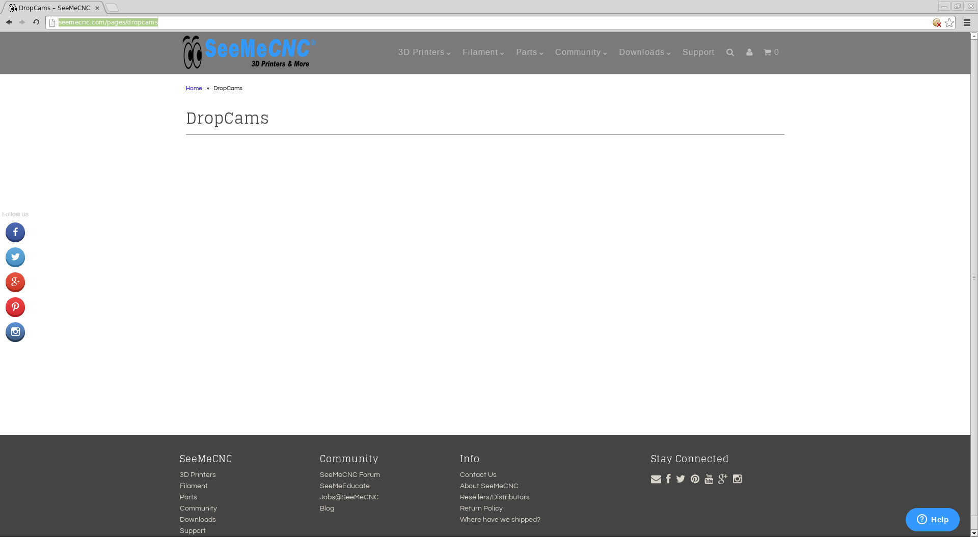

http://seemecnc.com/pages/dropcams
This is all I see... :(
I'd love to check it out though!
Posts: 1407
Re: Printing on The PartDaddy
Post by Mac The Knife »
When Nest bought out Dropcam, things kinda got wonky.

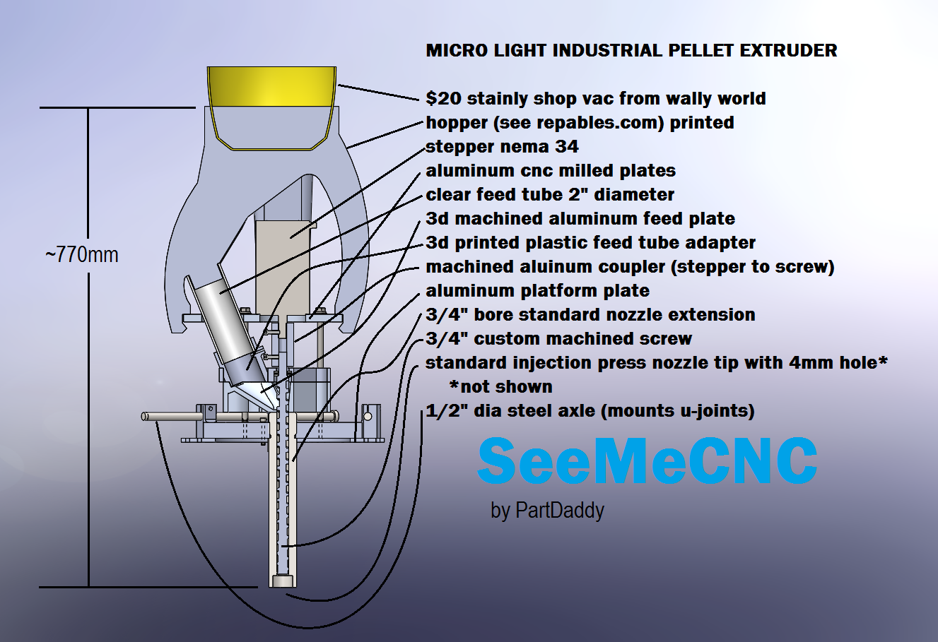

Wow, why is the print head humongous? Do you guys feed it pellets instead of filament or something?
PartDaddy
Posts: 392
Post by PartDaddy »
Here's a cross section drawing. Not too fancy but shows how I did it. Retraction is not designed, however, my plan is to lift the screw and physically shut off the nozzle tip with a wiper.
partdaddy pellet extruder cross section
A circle of NEMA 17 colorant injectors will eventually circle the extruder loaded with colorant resin pellets in process colors. I'll probably won't do this on this medium size printer...
Files here: https://github.com/seemecnc/Partdaddy
The project is a prototype. There is not a BOM. All the files on github are what I machined the aluminum parts from. The upper joining plate holes have a minor miss alignment (just a note if anyone is going to use the files).
