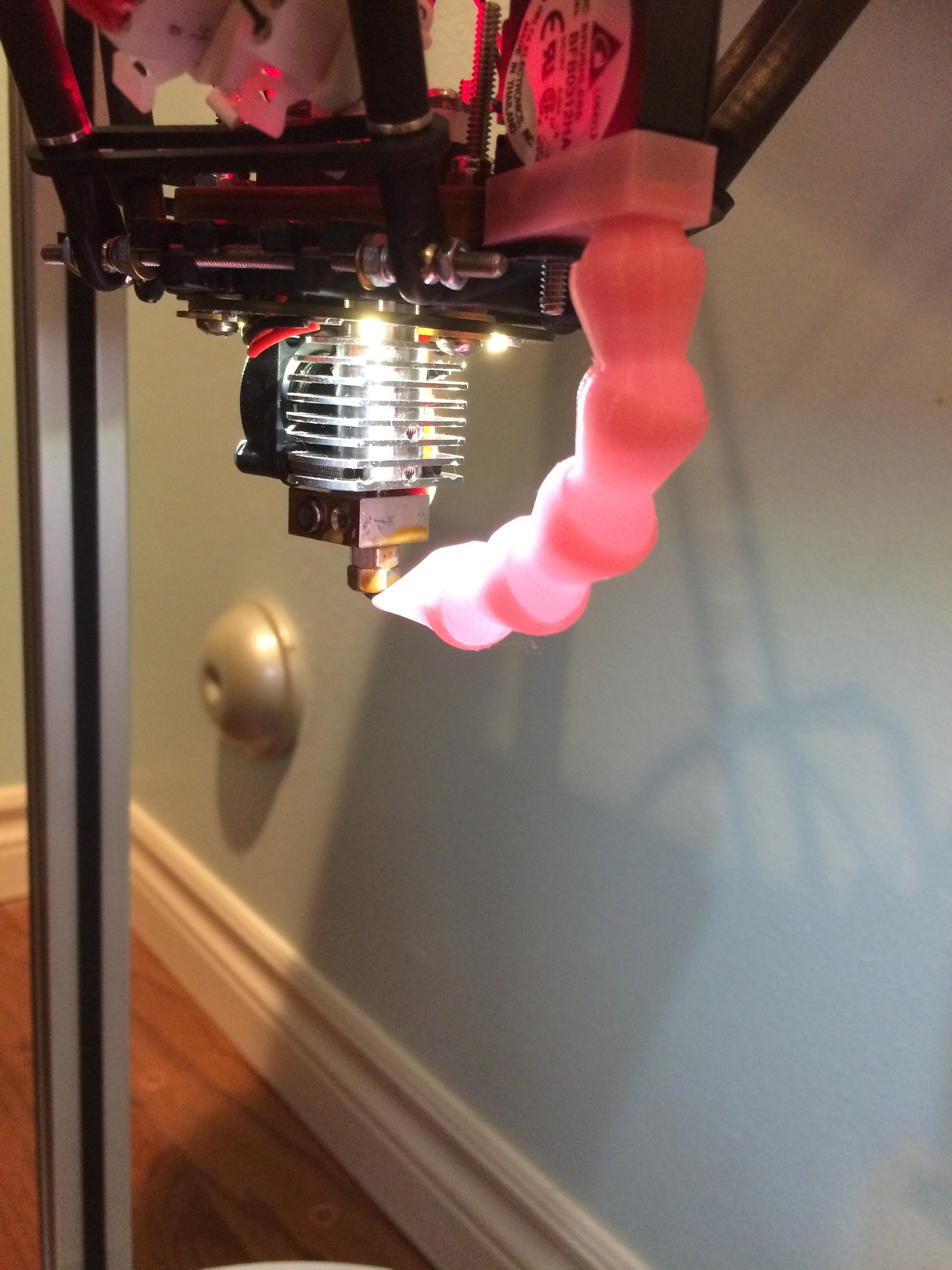

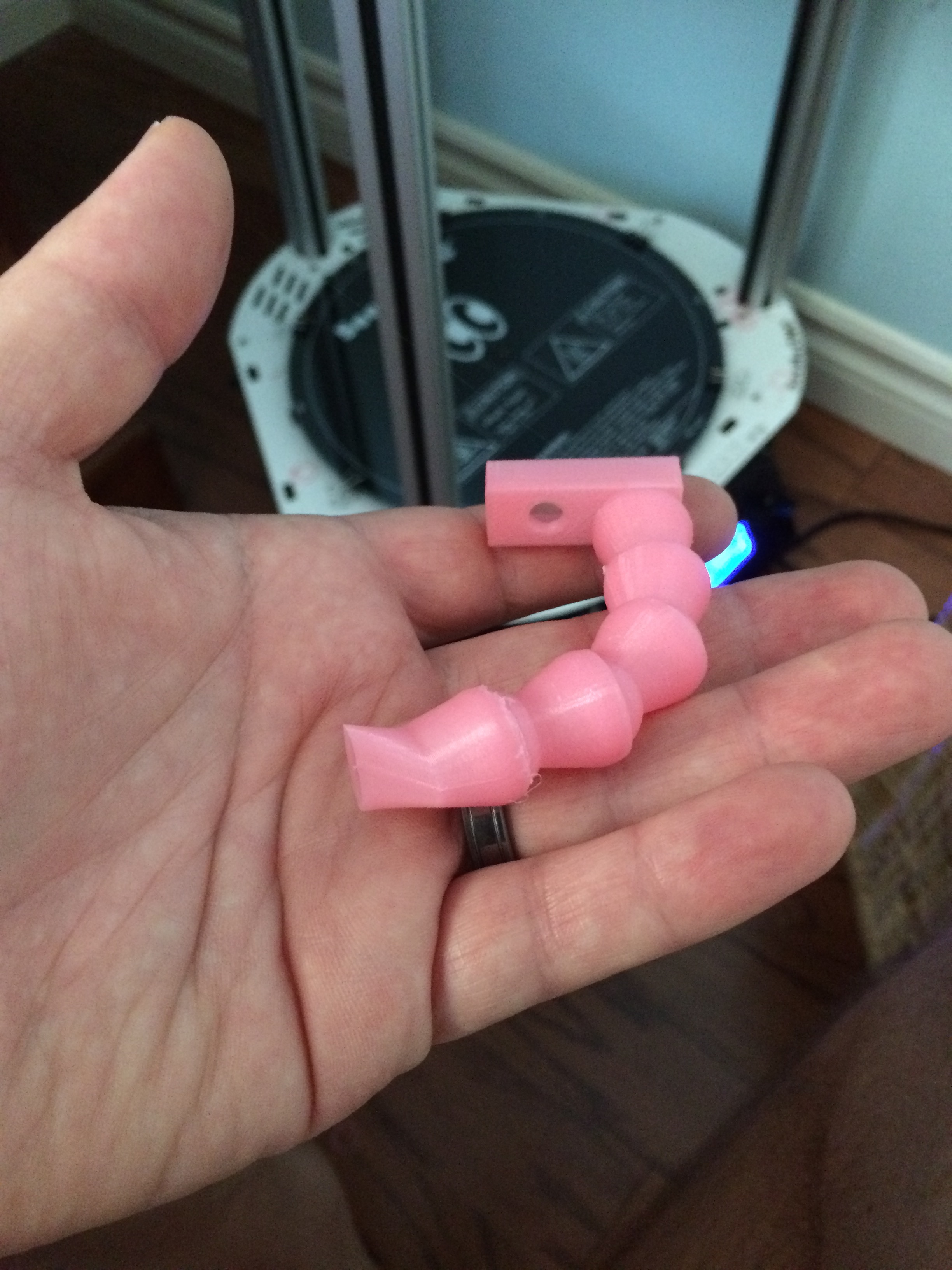

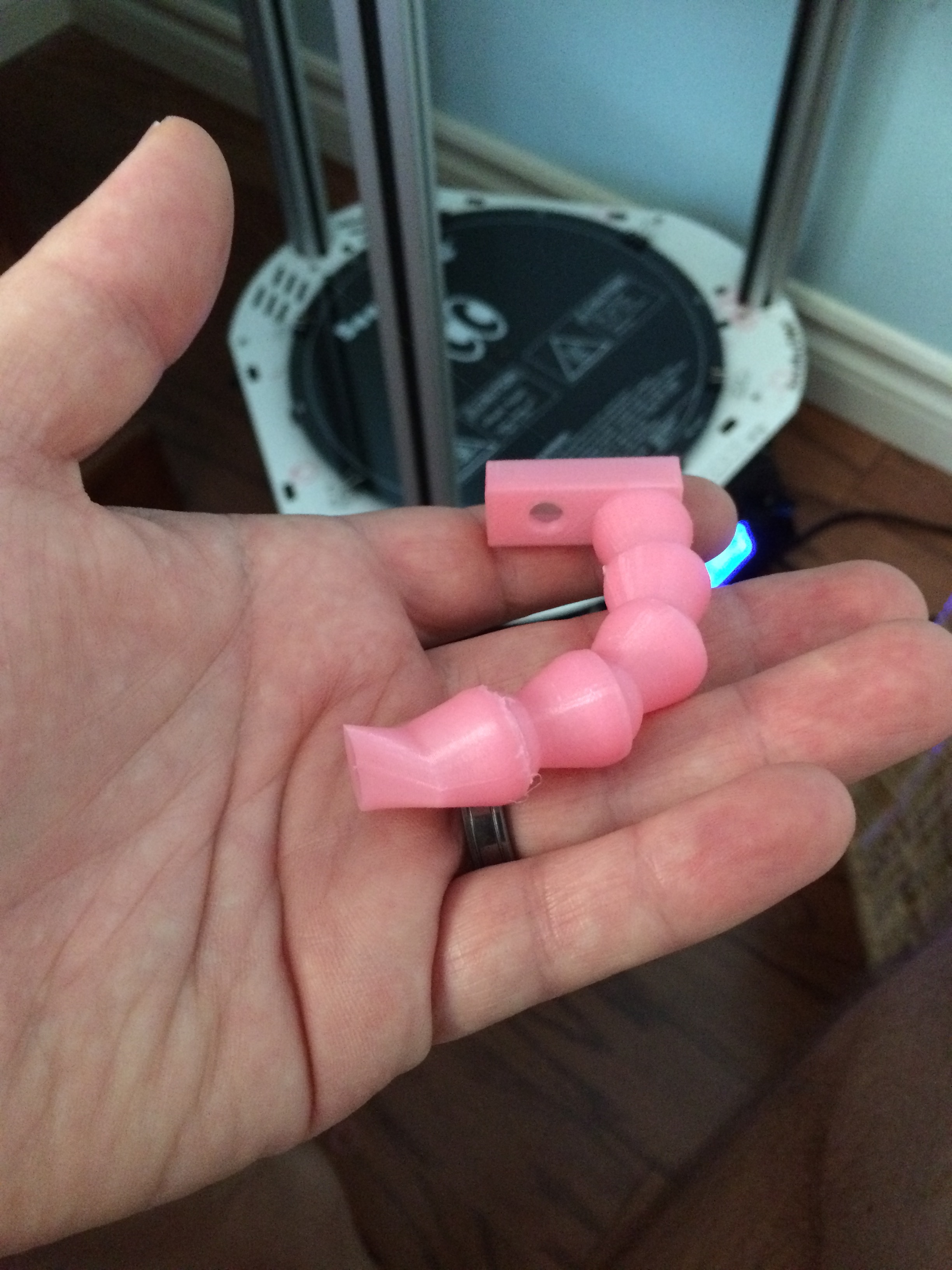

I've been experimenting with different designs for the cooling fan shroud. My latest design I'm calling the Air Scorpion because it sounds cool.
So far, it does work, but needs a little minor tweeking still. Let me know what you think.

Yes I was inspired by the air puffer on my scroll saw, but I thought why buy one when I can print them? This is made up of a holder for the fan, a few links that connect together and a flattened nozzle that connects to the links. I just used PLA since it doesn't actually come into contact with the hot end. I suppose ABS would be better though.

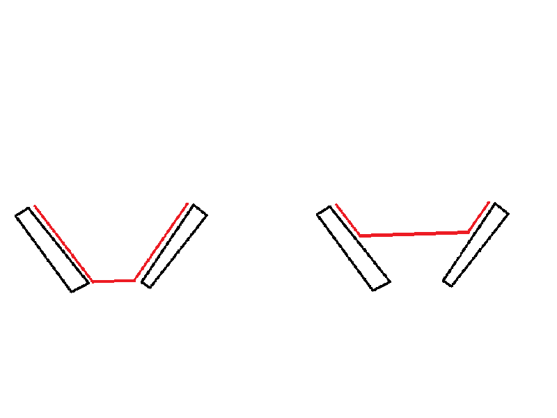

My fan shrouds are all PLA and they never melt, even if the layer cooling fans are off for a long time. I theorize that heating is inverse square or worse once you transition from aluminum to air.
3 fans are better than 1, and you might consider opening some of the "stinger" that points away from the hot end to let more air wash back and away from the hot end. Best not to over-cool it. That leads to stringing, and encourages jamming.

The three fans are because if you only cool from one side, the leeward of the object looks sloppier than the windward. With three, it's pretty even. You just have to make sure not to run the fans on too high a setting, or you'll get stringing/jamming as your hot end boils the filament trying to keep up. It's better to let significant air wash outwards from the hot end, and to try to keep as much fan air away from the block as possible.
It's not feasible to totally protect the block, because the air (especially near the bed) will be turbulent and go everywhere. The better you can isolate the heater block, the better your prints will be.
