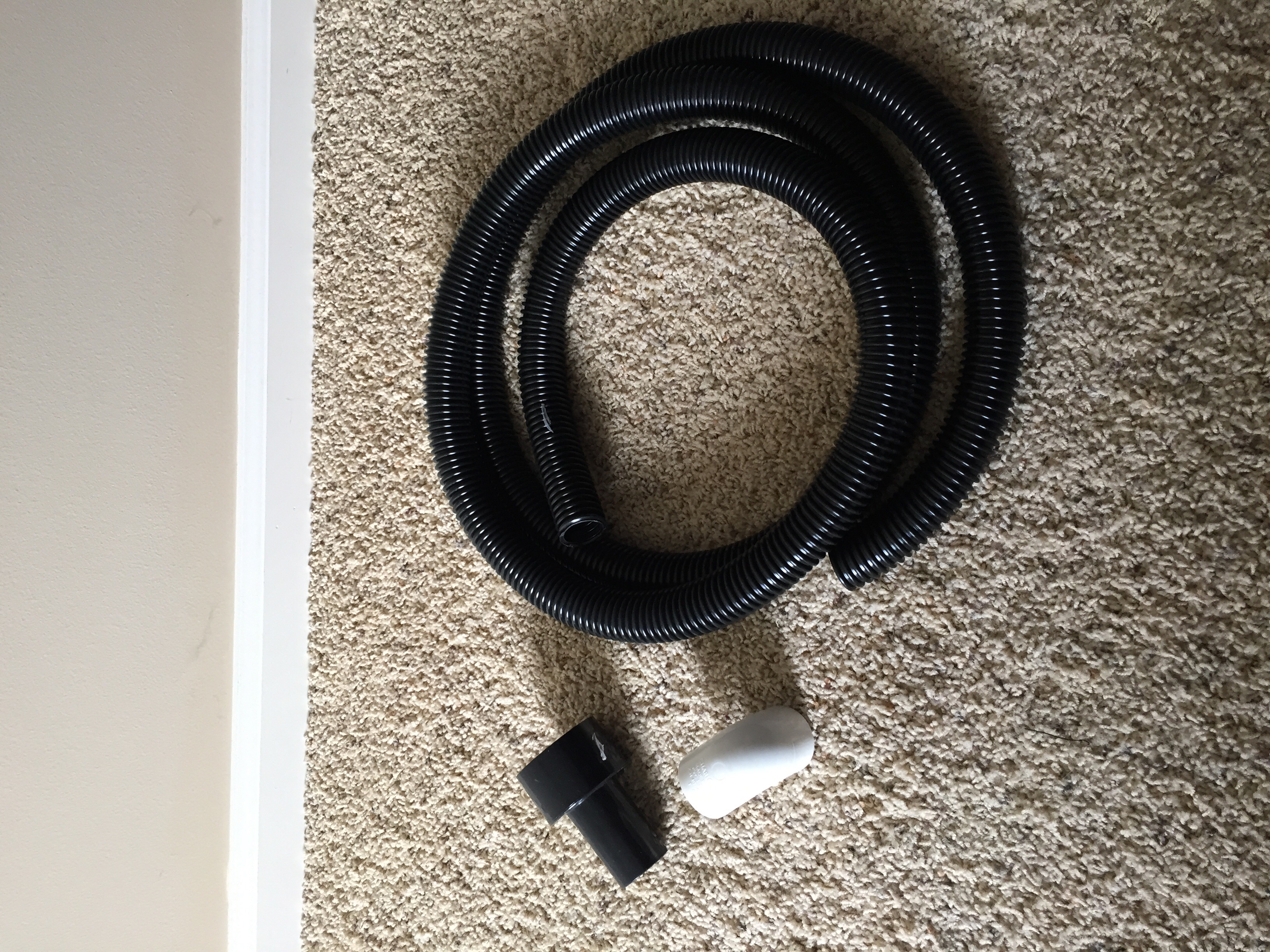

Here is what I ordered from Amazon.
Squirrel Cage Fan (12CFM, 16 mmAg pressure, 42 dBA) : (http://www.amazon.com/gp/product/B00B2A ... ge_o01_s00)
Vacuum Hose: (http://www.amazon.com/gp/product/B00LPO ... ge_o05_s00)
Here is what I bought from Home Depot.
1" PVC pipe: 3 foot
1" 90 degree elbow: Two pieces.
1" PVC pipe: 3 foot

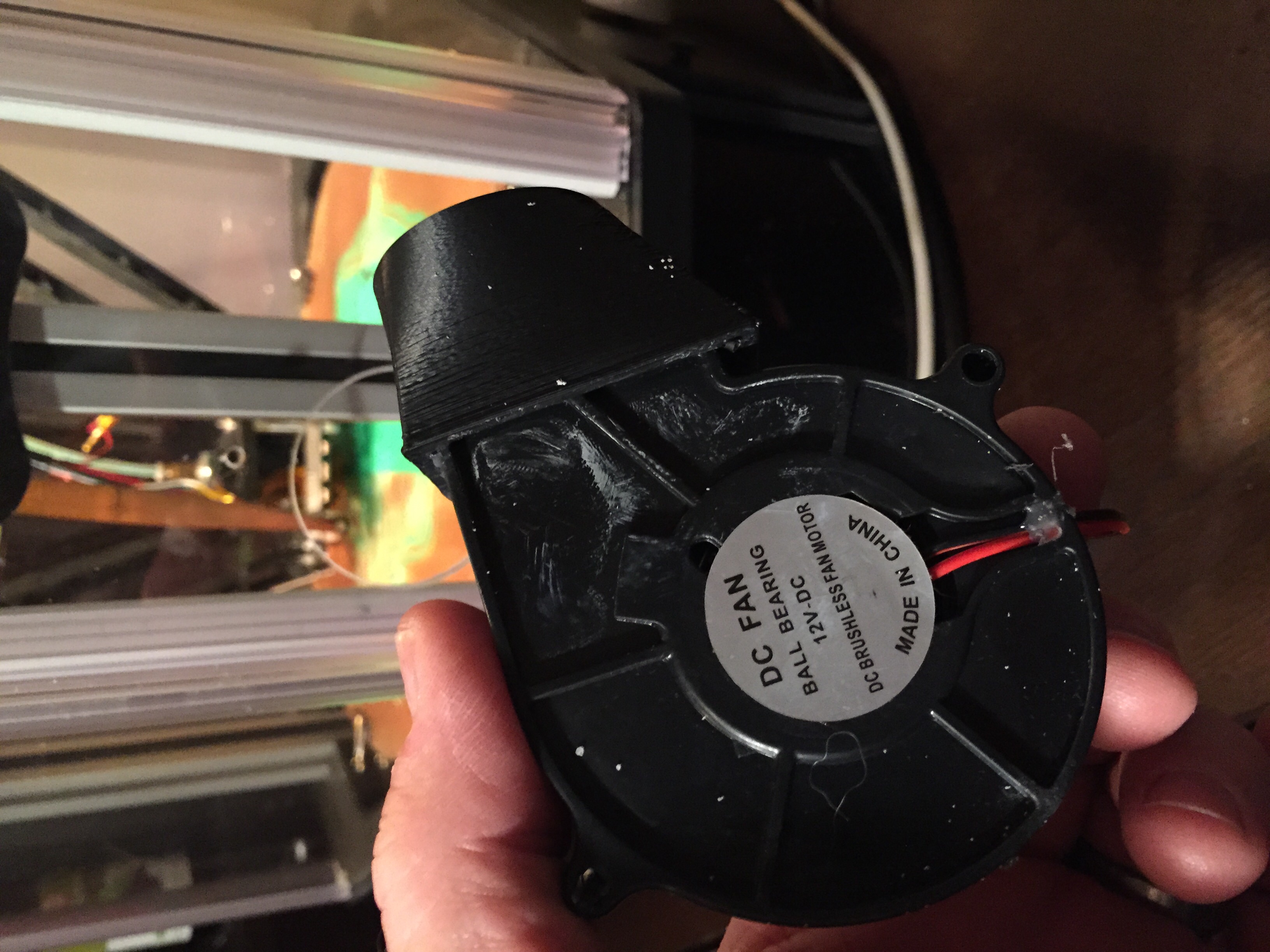

First I printed a spacer for the fan such that it would clear the edges of the enclosure.
Then I printed a connecting adapter to attach the fan and hose connector.

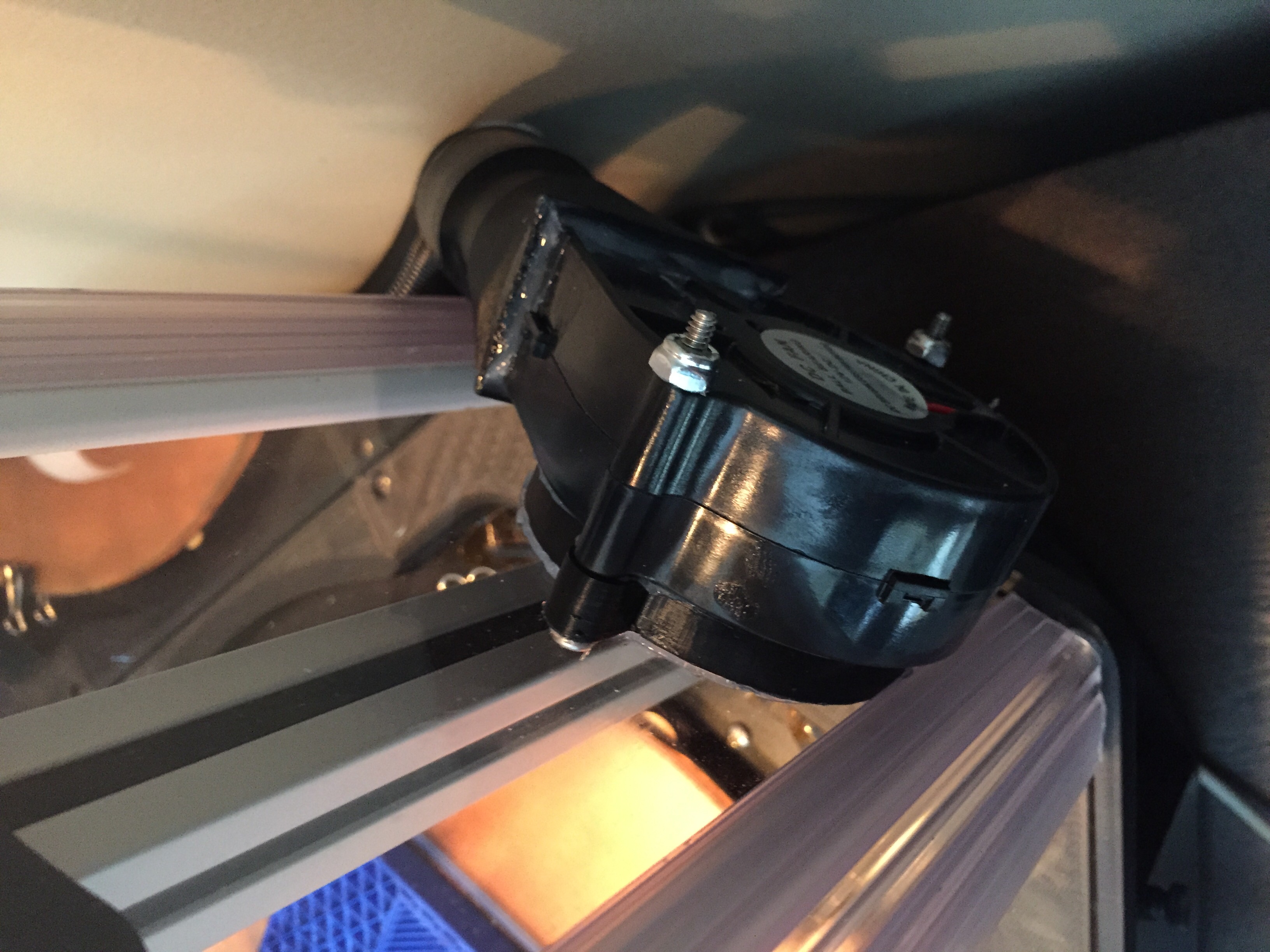

I used super glue to attach the hose adaptor (first picture shown above) to the fan and then silicone sealed the edges of the adaptor and fan. We could redesign this adapter a bit such that it snapped onto the fan at some point.
After drilling two holes into the enclosure for the SS bolts, I attached the spacer and fan to the back of the enclosure with a little bit of silicone to each side of the space to seal it off.
I wired the fan into the power unit such that when the printer is switched on the fan starts. I do still need to secure the wire to prevent it from catching something and damaging the wire.

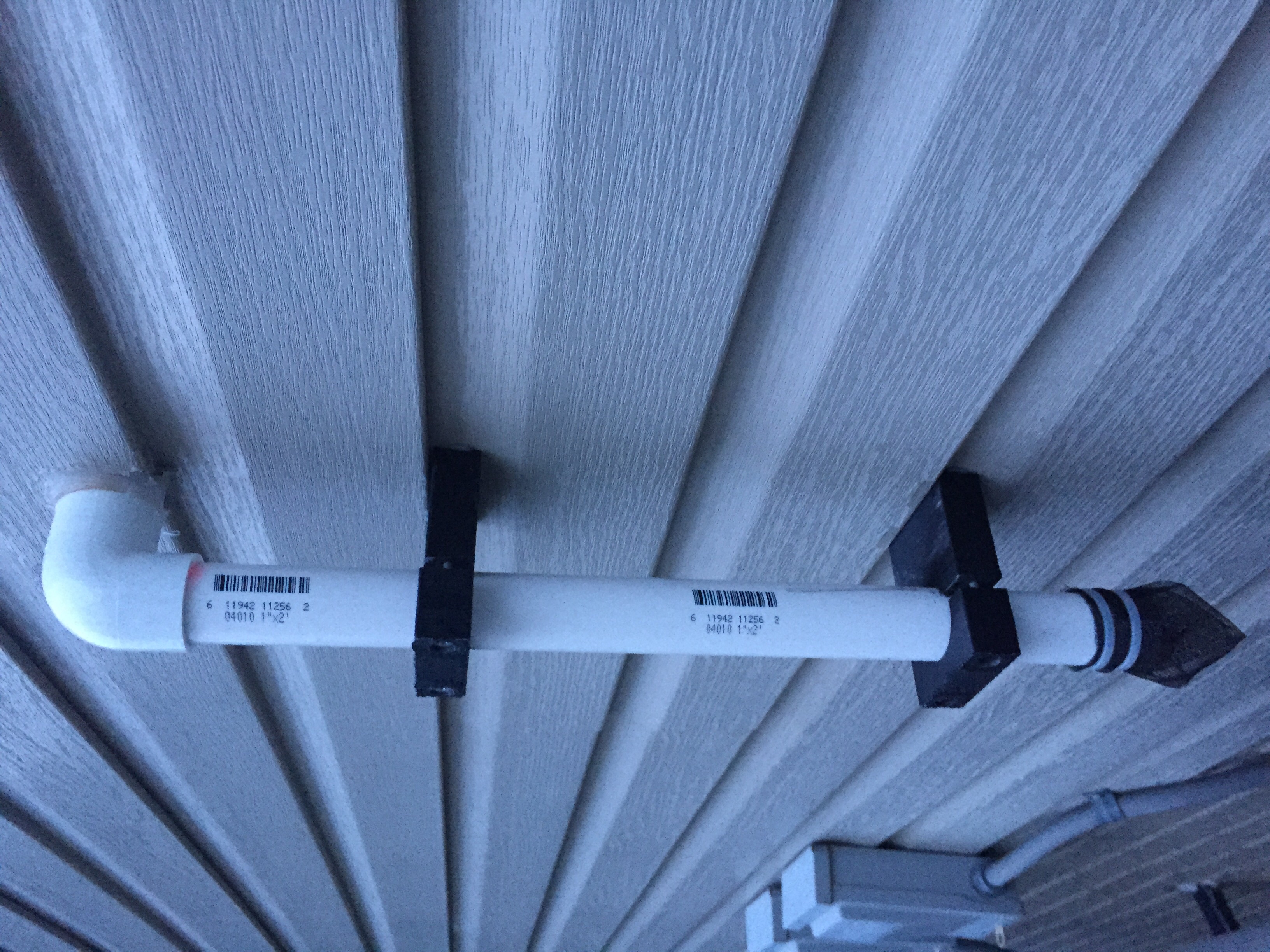

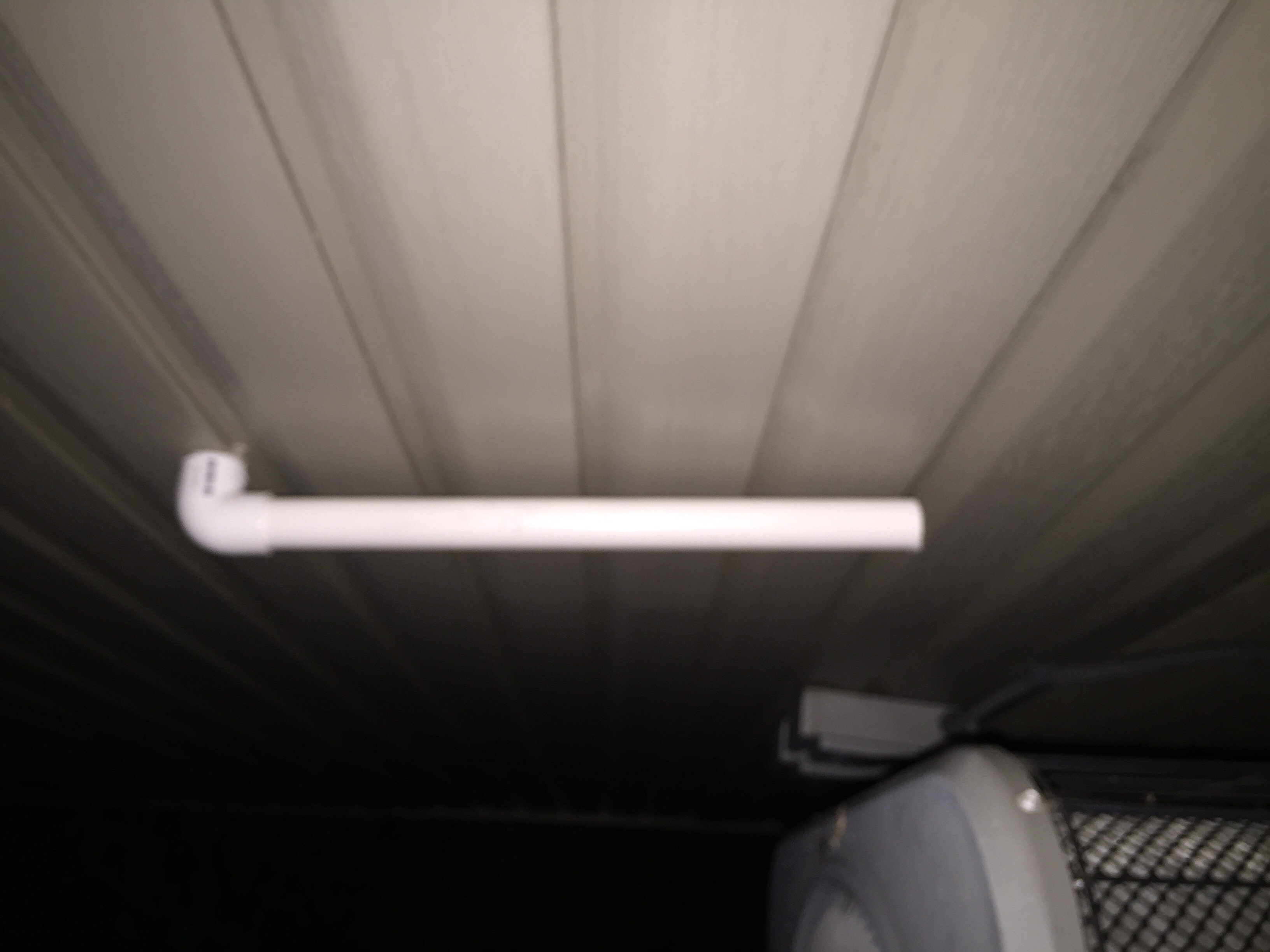

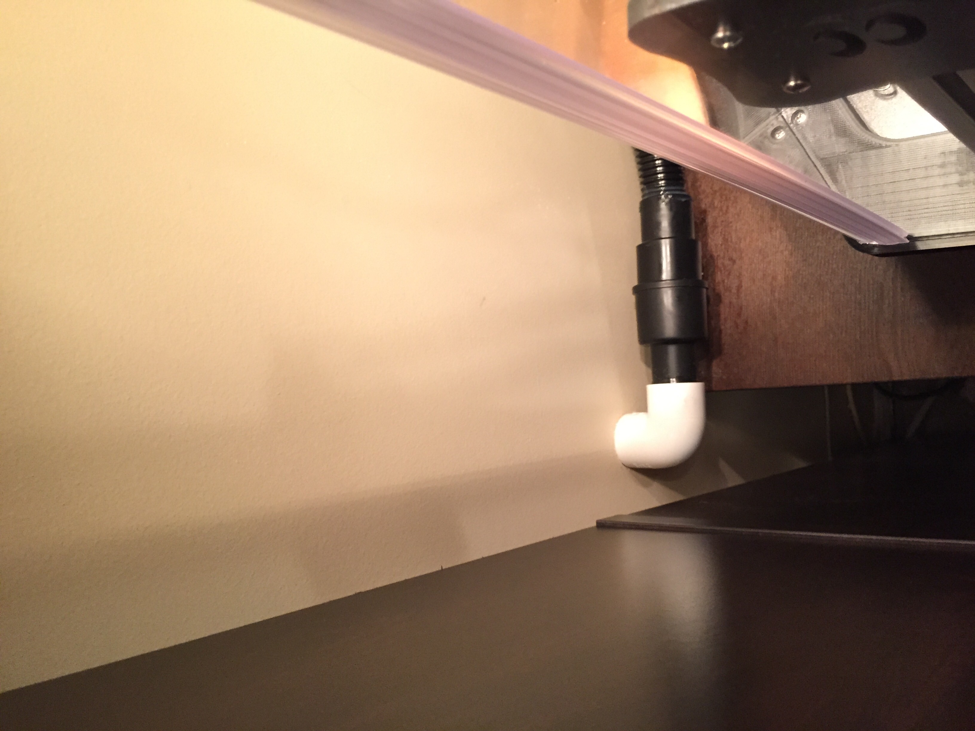

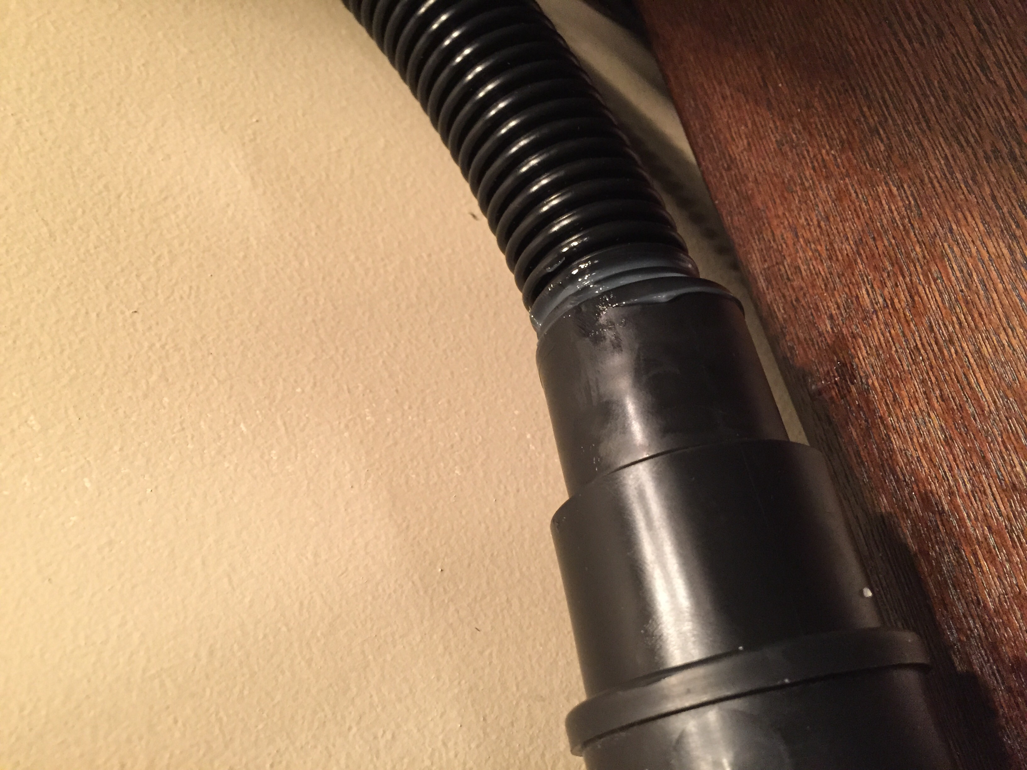

With a 1" hole saw put a hole in the house after making sure to miss any wires or wall studs. Then cut the 1" PVC and attached the elbows. I cut the vacuum hose to fit the space and silicone sealed the hose to the adaptors that came with the vacuum hose I bought from Amazon. Then connected to hose to the fan adaptor and to the PCV pipe.
Of note the vacuum hose connector that came with the kit was slightly smaller than the 1" PVC elbow and I simply wrapped this with black electricians tape twice to get a good seal.
I do still need to seal the PCV pipe and house siding as well as secure it with a bracket to the side of the house. Planning to print that next.

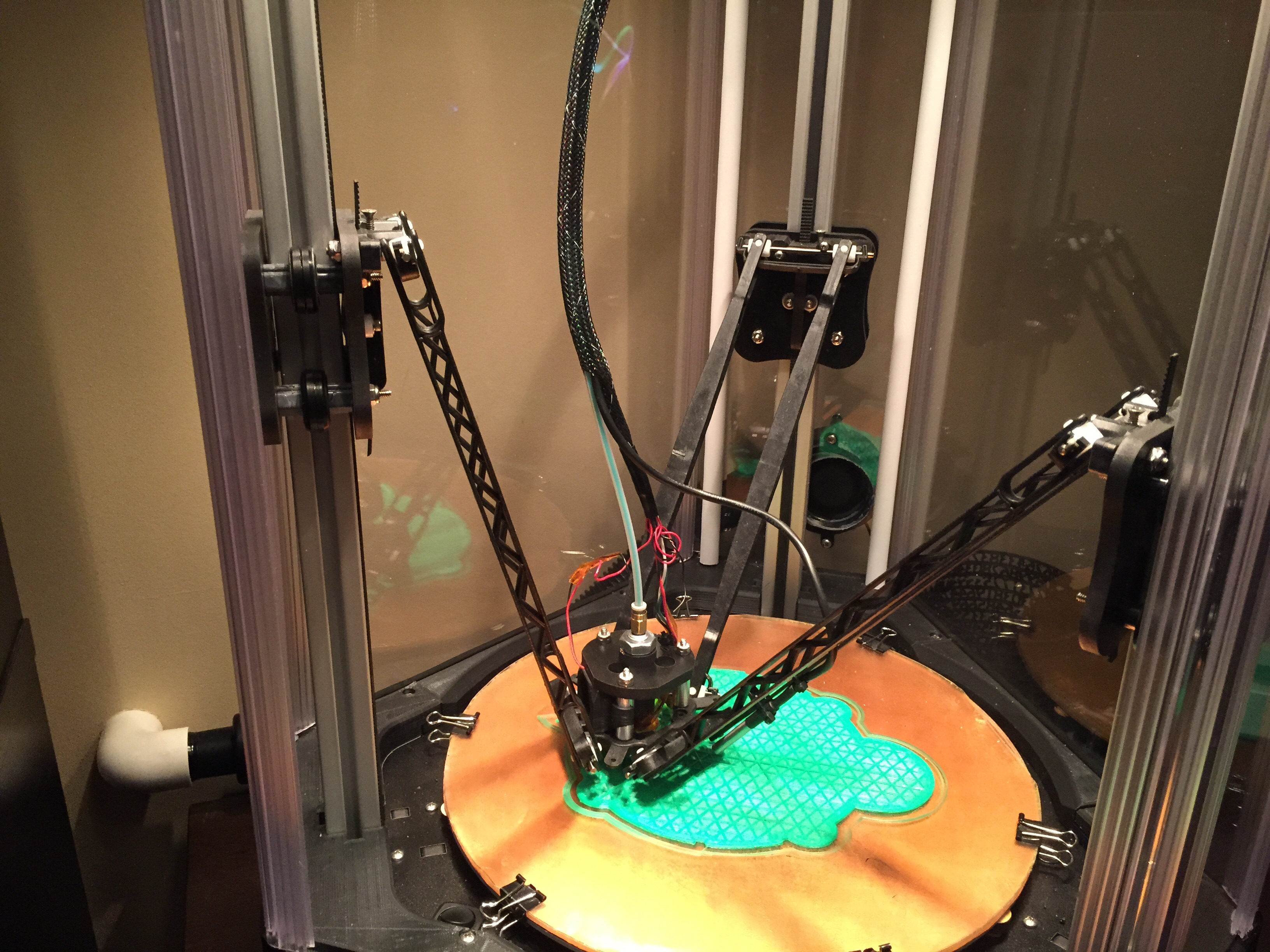

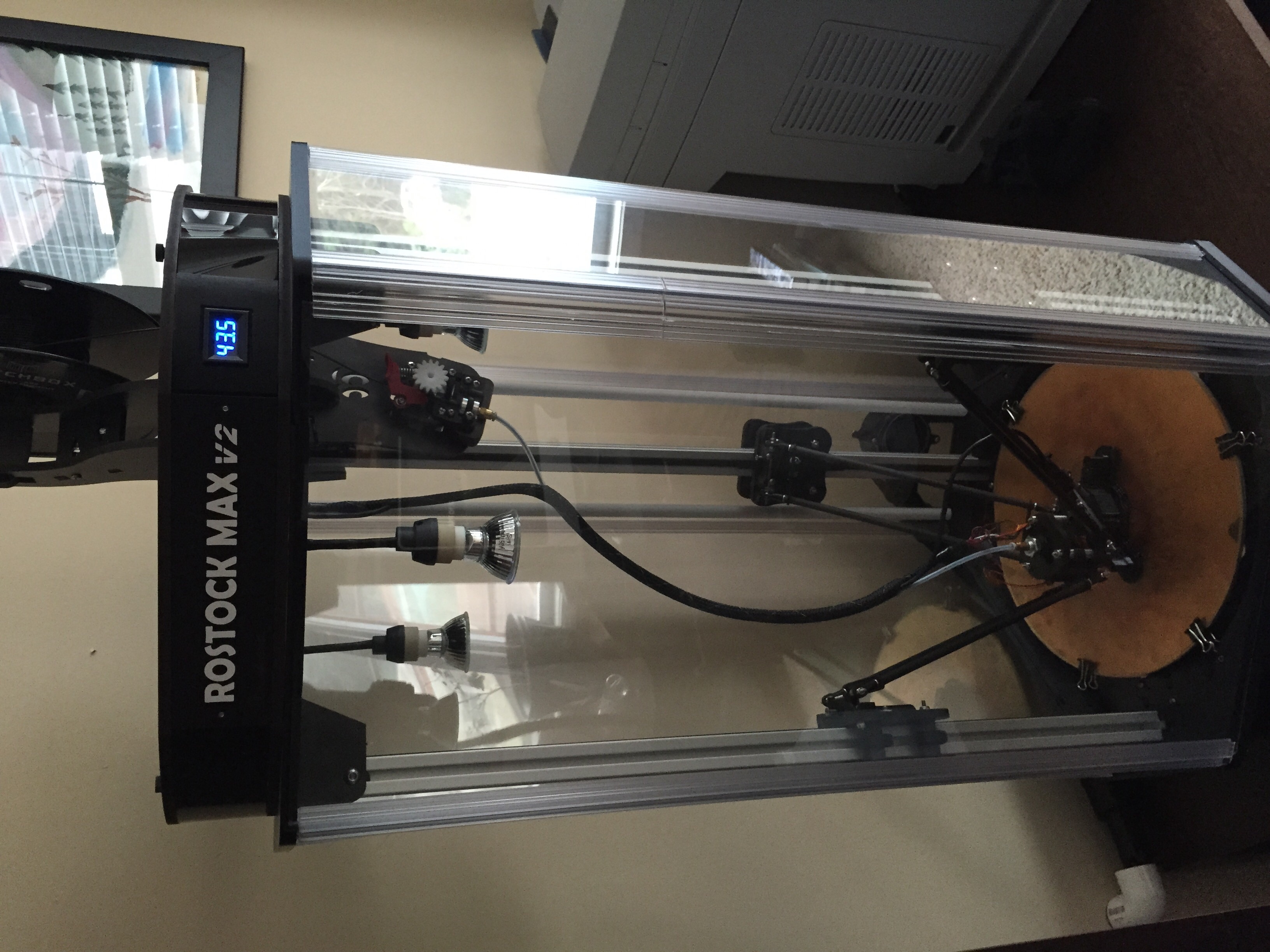

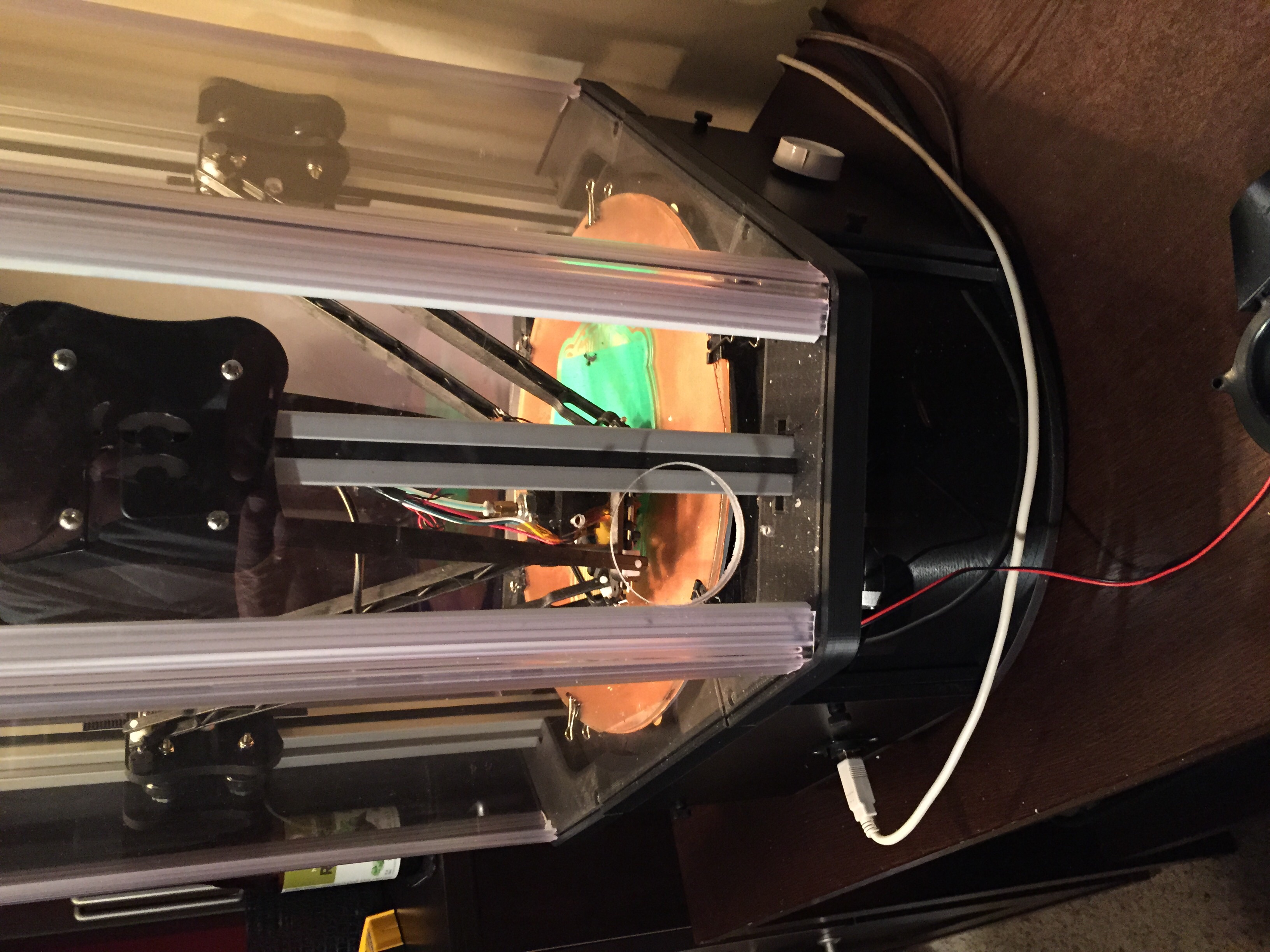

After finishing off the fan, I then sealed off every hole in the chamber including the hole under the hot plate that feeds power to the print bed with Kapton tape. I sealed the small holes at each corner of the enclosure with silicone. Finally I sealed the holes in the towers (non-belt) edges with silicone.
To help keep the power unit vented (since I put Kapton tape over the vent holes along the back side of the base), I opened up the back side of the base.

I've now printed 4 items and there is no smell of filament at all in the house. The enclosure does run about 10 degrees C cooler without turning on the Halogen lights. However, with the Halogen light on low-medium, it does stay right at 45-50 degrees C. The three halogen on high quickly heat the enclosure to 60 degrees.

Don't forget to put a screen on that vent!! You'll end up with critters in your printer.

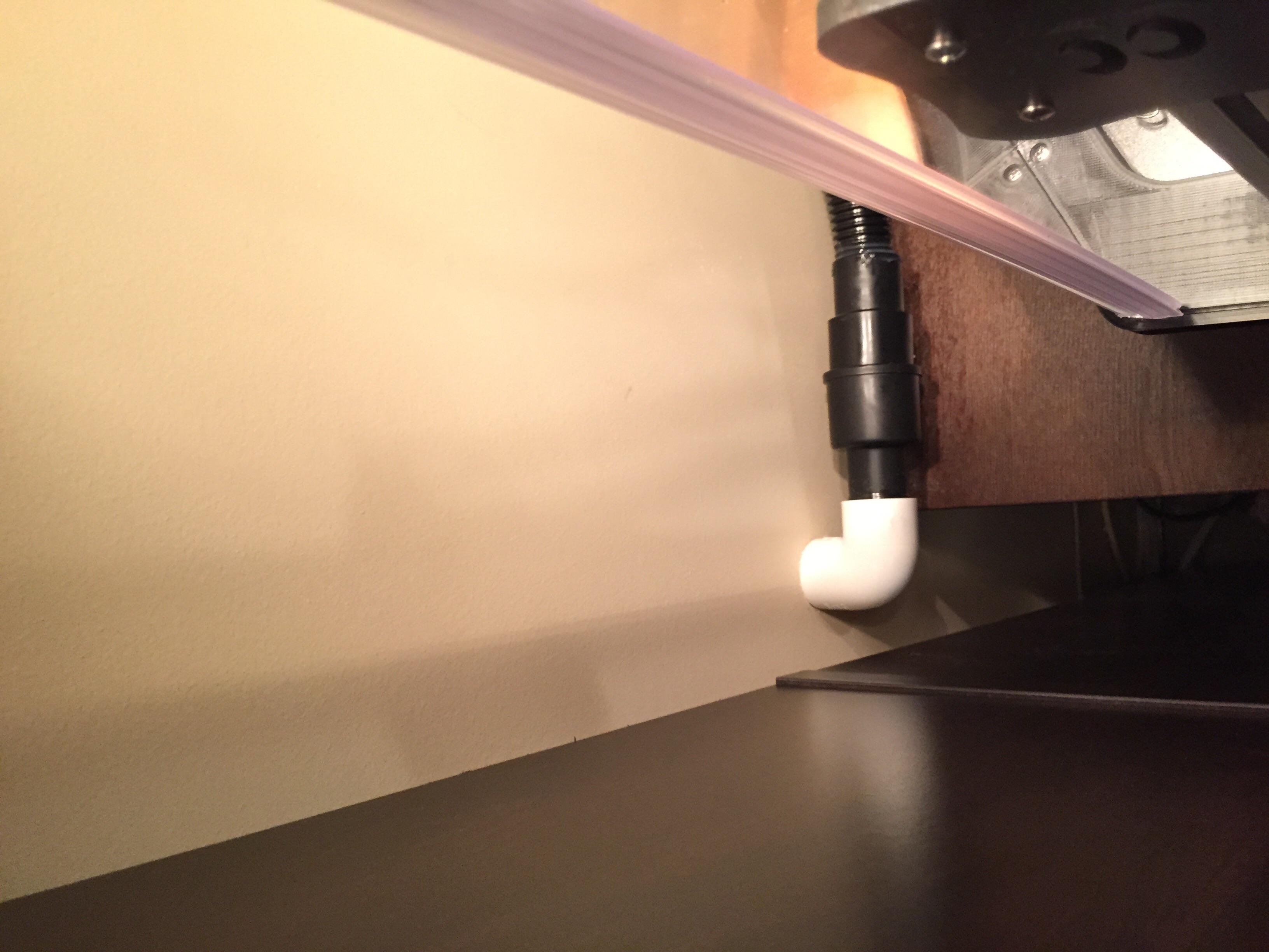

Finally loading up some final images of how I completed the enclosure ventilation. Thanks "barry99705" for the tip to use a screen. I had some extra screen in the garage and simply wrapped it around the exhaust PCV pipe slid it back down the tube and put a couple of zip ties in to hold it it place. Then trimmed off the excess with a utility knife.
Also printed some brackets to secure the vent tubing to the side of the house, then a bit of silicone to seal around the pipe.
It has been an awesome addition and does a great job venting the fumes. If I ever need to replace the fan I would likely go with a slightly higher CFM and consider adding a 12V rheostat.

The only place where I have any substantial air draw is from the enclosure door (I taped up every hole I could find with Kapton tape or sealed cracks with silicon). As well opened up the base such that the powers unit keeps cool.
The enclosure was 50-53 degrees the other day when my office was warmer, the bed was at 100 C and the three 50 W halogens were off. I can increase the chamber by up to 10+C with the lights on depending on how bright I set them with the rheostat.
