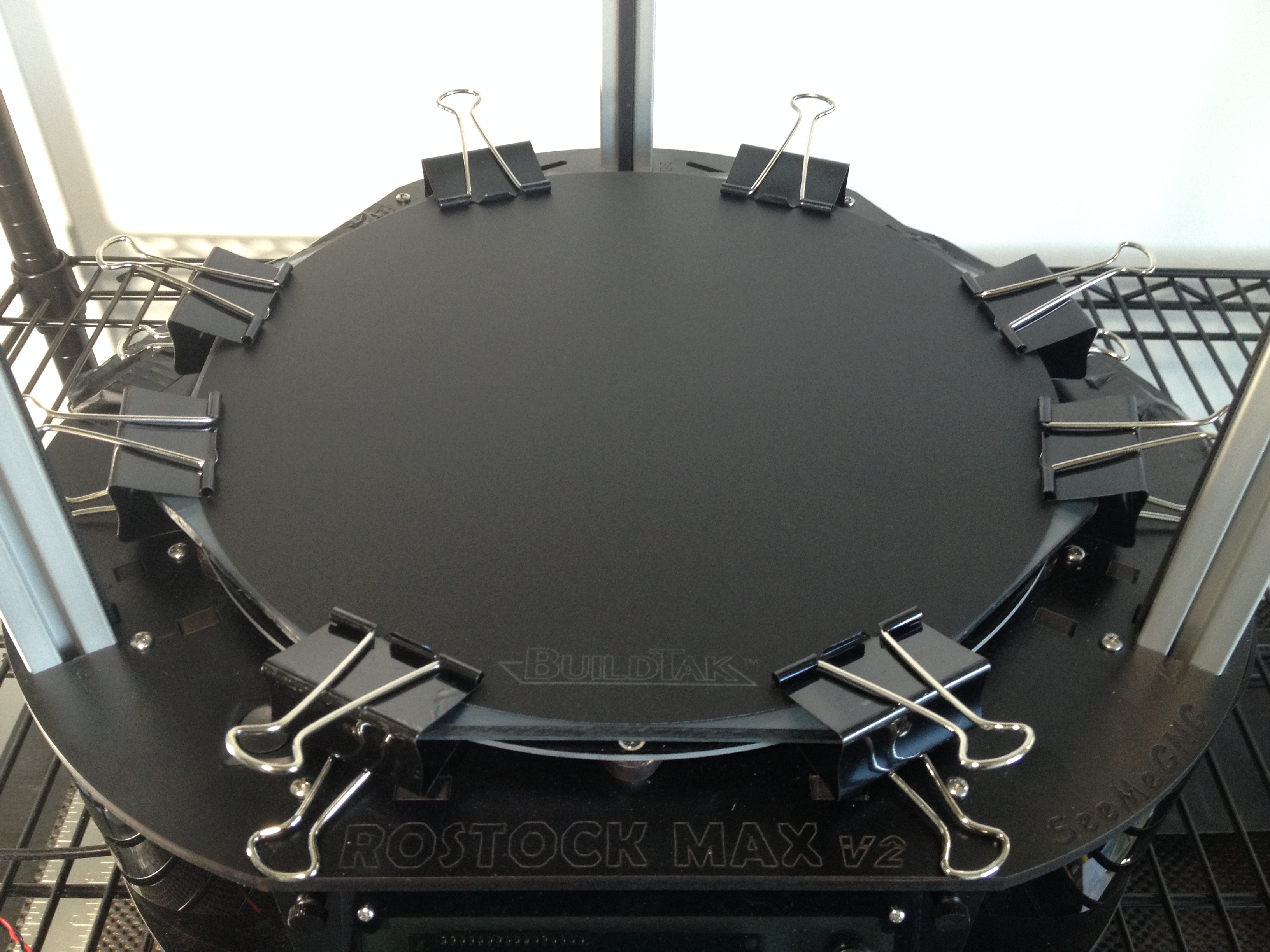

So I love BuildTak (I would probably love PEI, too, but thus far have only used BuildTak).
What I don't like when using BuildTak is that the glass is quite a smooth surface to adhere to, so sometimes the bond isn't the best.
Another thing I don't like is that the prints are hard to remove sometimes, and I end up damaging the print or the build surface when removing it.

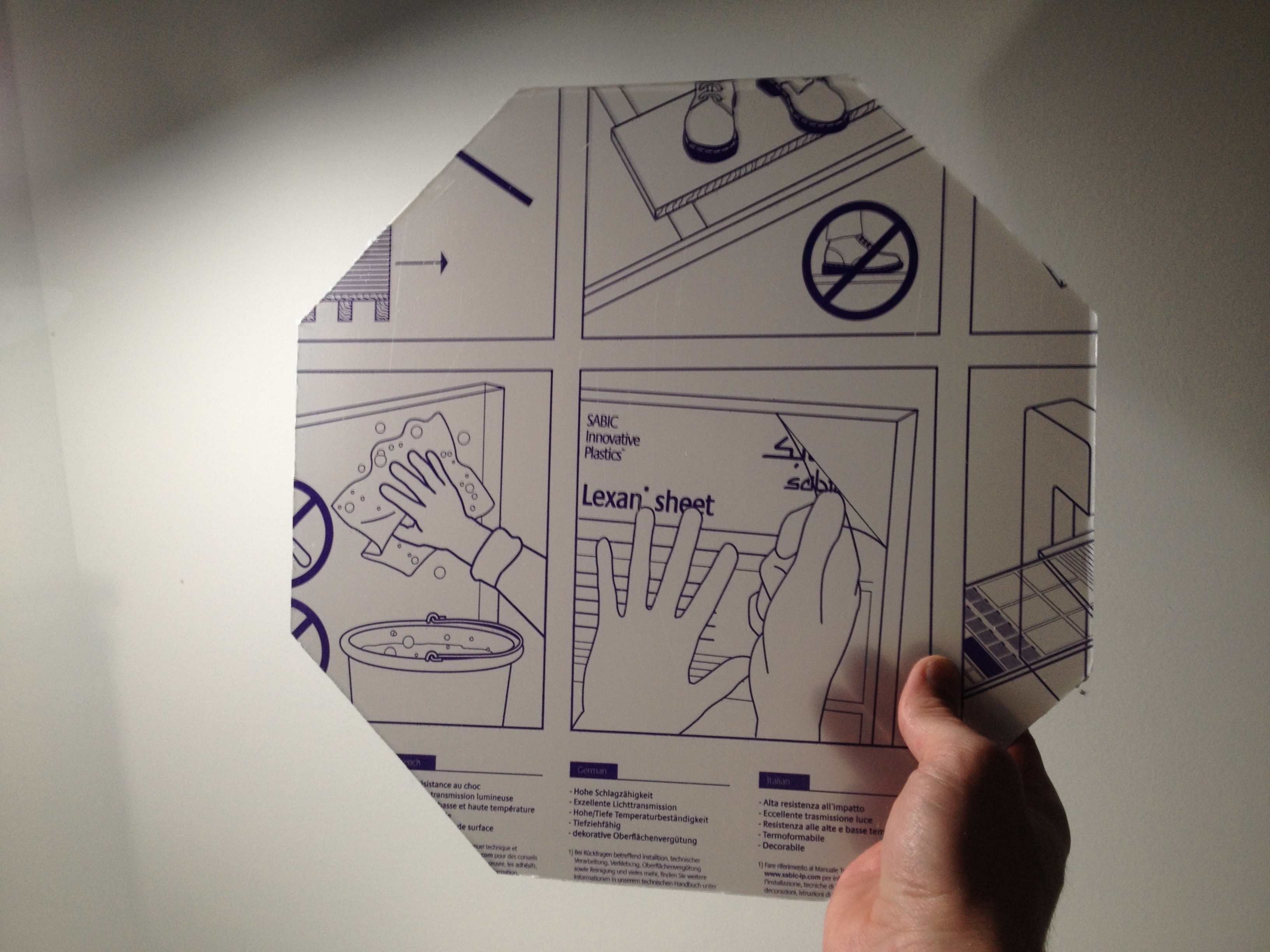

After thinking about the Tiko flexible build plate, and the "Printinz" flexible build plate (fiberglass), I decided to head down to my local plastics dealer and pick up a piece of scrap Lexan for $5.

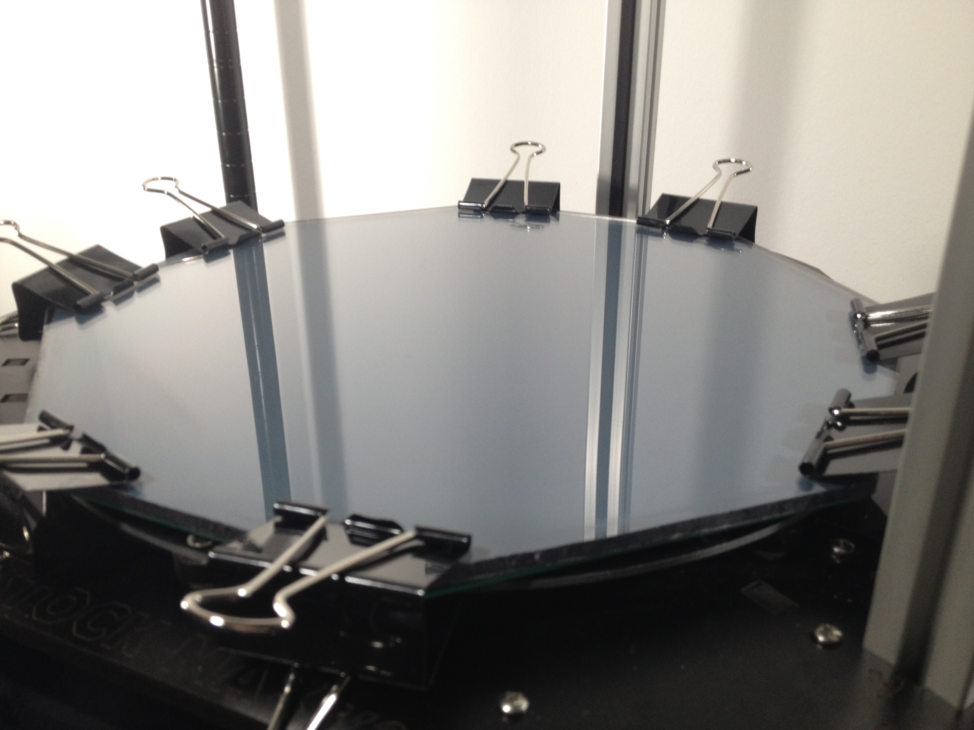

As you can see, I've been using an onctagonal mirror for a build plate after smashing my borosilicate (thanks to the BuildTak
). I used the mirror as a template, and also have the mirror sandwhiched upside down between the heated PCB and the polycarbonate, so I have something flat to clamp it to. The poly was already basically perfectly flat anyway, but this helps make sure it will stay as flat as it is.
The 1/4" polycarbonate isn't THAT flexible, but it will not break, so with enough force pressed against a leg, there is enough flex to get even small parts to "pop" their corners off the surface, so you can get a spatula underneath without damaging anything.
A step that I forgot to take photos of was that I added an eight-way crosshatch pattern of scoring to the surface of the plate with some 600 grit sandpaper, to give the BuildTak glue something more to bite into. I'm certainly pleased with my $5 experiment.
