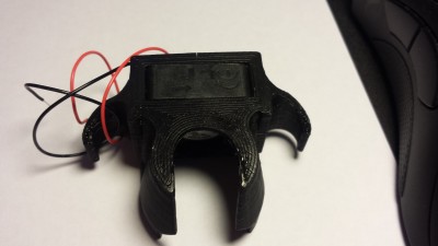

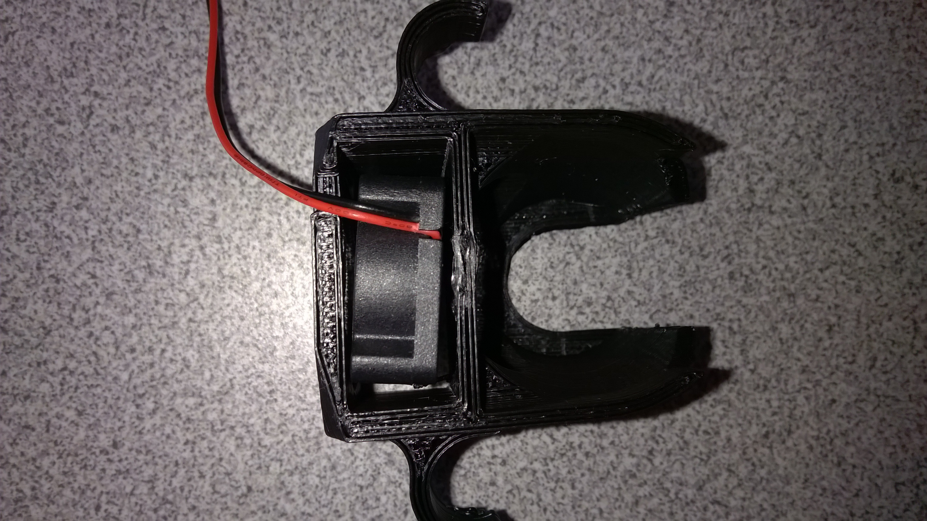

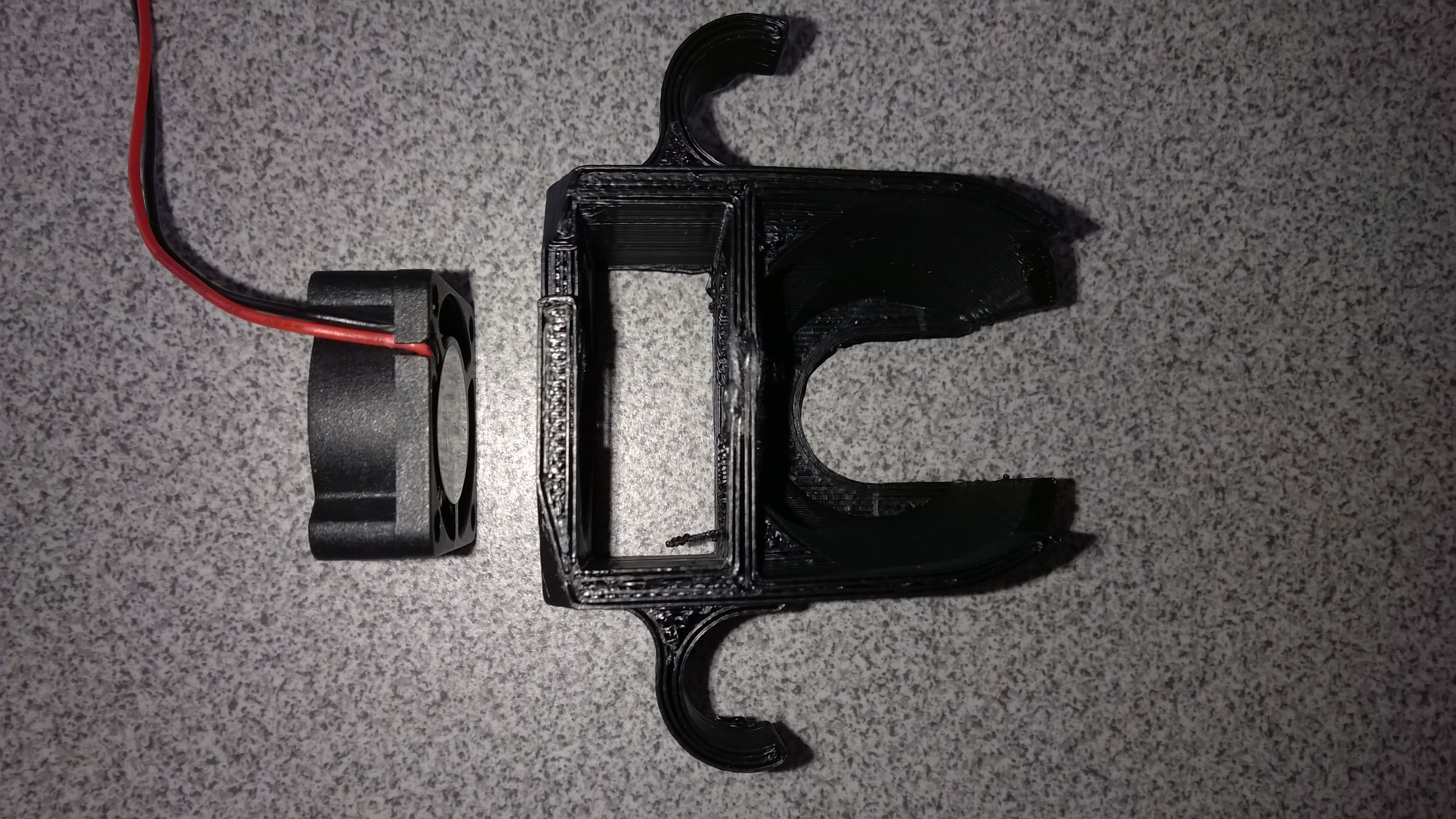

When I printed the fan enclosure.. the "slot" where the fan goes in.. seems kinda big, the fan is loose. Am I not printing correctly or is this how it should be? I'm not sure if the attached pictures show what I'm asking... but here they are.
Thank you.

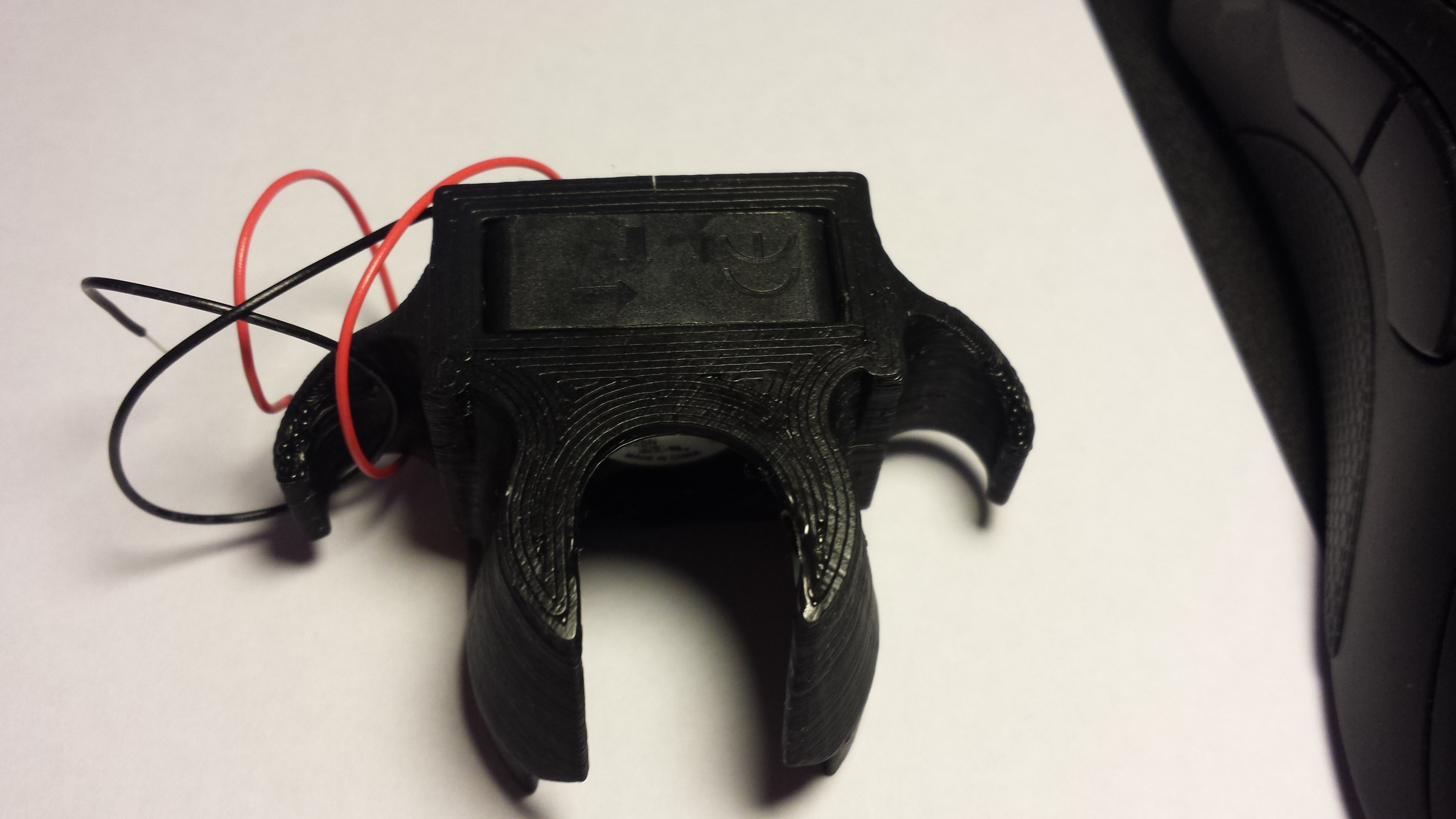

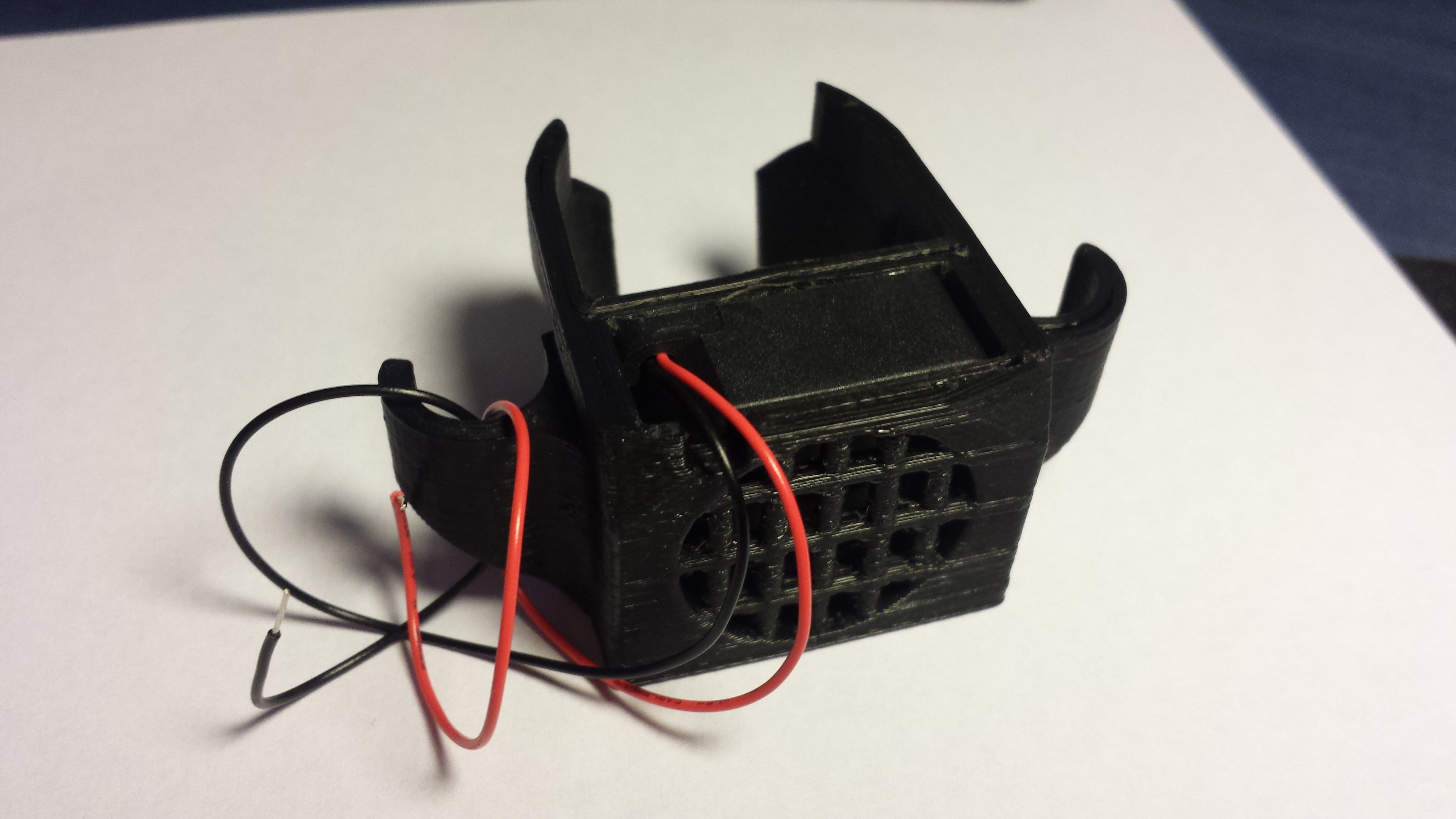

Pics of a spare I've got.. it's not the original fan but exactly the same size.

The right STL on a properly setup and calibrated machine should make the fan very tight, to the point you probably will have to file it. I filed a little too much off mine and shimmed it in with Kapton tape, but even if the slot is the only thing wrong, that would be a lot to shim.

Sorry I wasn't thinking as I'd modified the original STL with a fan guard and that's what my spare is.. apologies for the confusion.
Simple mod but it's here:
peekguardLRS.stl
(152.43 KiB) Downloaded 332 times
If it doesn't fit/slot in correctly to the aluminium standoff bars then you'll know for certain it's the wrong size.
