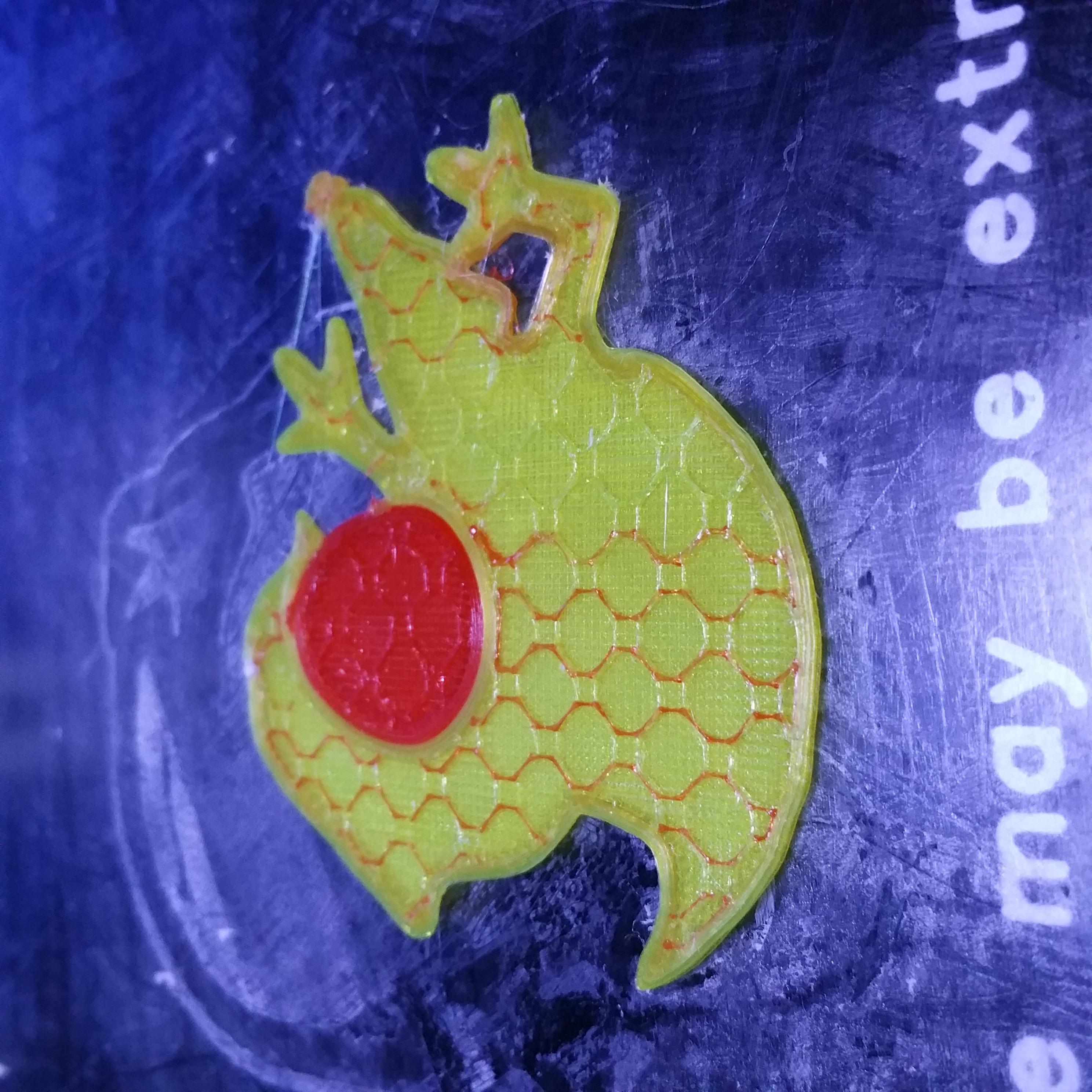

TLDR;
1. The Cyclops requires a geared extruder, because of the force required
2. Upgraded the EZStruder to use the Kysan 5.18:1 geared stepper
3. Also checked the nozzle, and removed a burr from nozzle interior
4. Extruder drive lowered to 1.1 amps, max acceleration of 250mm/s

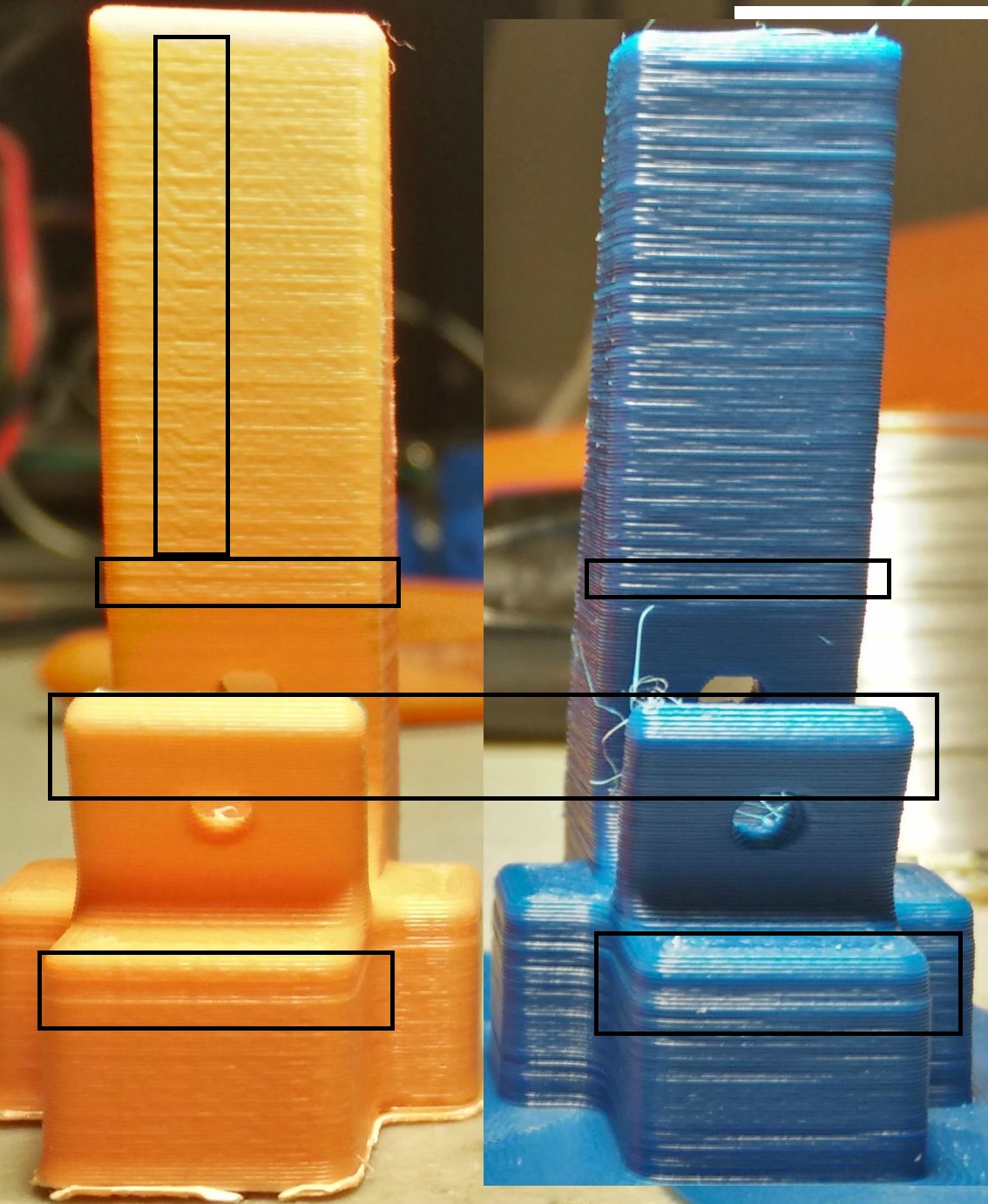

Anyone else out there running a Cyclops?
I'm seeing a reallly rough surface finish for models printed with the Cyclops vs my V6.
In the attached shot, I'm running the exact same gcode file with both the V6 and the Cyclops.
Same Gcode, same filament, same temps, same bowden, same extruder, same everything except for the hot end.
I even swapped out the 25w cartridge for the 40w cartridge in the Cyclops.
Both platforms are very sturdy, no wiggle, everything is tight and secure.
Watching the temps on both prints, they both hold to within a few tenths of a degree.
The print on the left was done with the V6. It's about 5cm tall, and there are some small variations in the surface finish, but overall the print turned out really well. Very smooth.
The print on the right was done with the Cyclops. Notice the angled irregularities. It is quite rough to the touch.
I wish I could say that the lighting is exaggerating the roughness, but it's not. I couldn't release a print like this to a client.
Does anyone have any ideas?

So, that's interesting. the large-ish cube turned out ok.
Here's a comparison shot with the large cube, the original V6 benchmark print on the left, and the Cyclops print on the right.
During reassembly, I wrapped the block in silicon tape, and rerouted the thermister wires and fan wires completely away from the block and in different directions.
I'm running another test print now to see if that was the trick.
Sorry about the Mr. BlurryCam shots, the originals were not blurry at all, but maybe between resizing, imgur, then the forum things got a bit off.
I'll include a link to the original shot on this one below.

You can see some of the same artifacts in the left part only exaggerated in the right part. The layers appear to start inset then gradually move towards the exterior. On the next layer they start on the exterior and move towards the interior. The mounting tab towards the bottom looks decent on both parts. Although you can still see the line created in the base of both parts just below the tab. I'm thinking mechanical calibration, mainly because you can see some of the artifacts on the original item.
Can you print this STL and post a pic?
