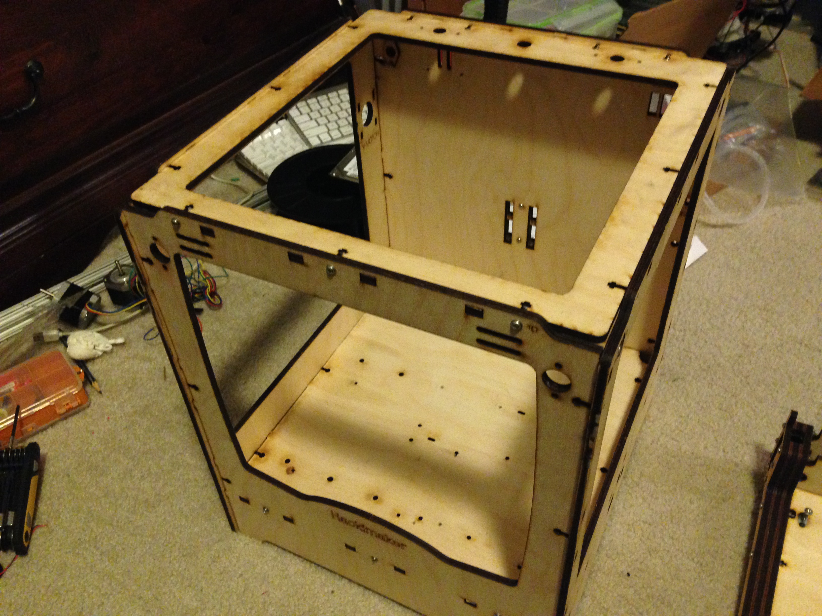

The frame has some customness to it. Its taller than the regular Ultimaker. Its actually not to get additional Z height (though if I was thinking a bit more that could've been something I could've done). I have it so I can fit a RAMPS (while its still a shield like the Ultimaker Electronics, the fuses take up more "height" on the RAMPS), beefier PSU, and a larger stepper on the Z axis. I have hole patterns for RAMPS, RAMBo, the Ultimaker electronics, and PSUs like this http://www.youyipower.com/blog/files/20 ... supply.jpg.
Z Stage
Z Stage

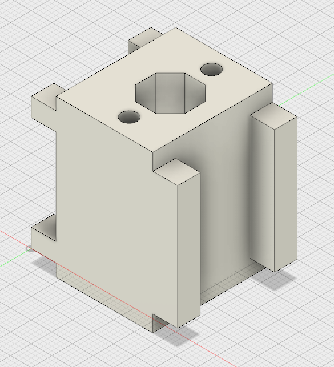

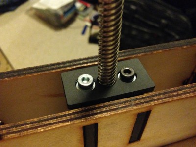

The main bit that I've had to design from scratch was a nut holder. You can buy a nut similar to the one on the Ultimaker Original from aliexpress or something like that, but I'm hesitant to buy something for a place as sketchy as that, so instead I got one of the 8mm ACME leadscrews from OpenBuilds and one of the nuts to go with it and designed a block for it to fit into. Its hard to see in the picture (black filament + nut) but it works. I have some stuff to tweak on the design, and I may have to reposition things (not entirely sure if the nut is positioned in the right spot), but it seems like it will work well when I get it all sorted out.
Nut block (nut is on top, secured with M4 CHS)
Nut Block in CAD
Nut Block in CAD

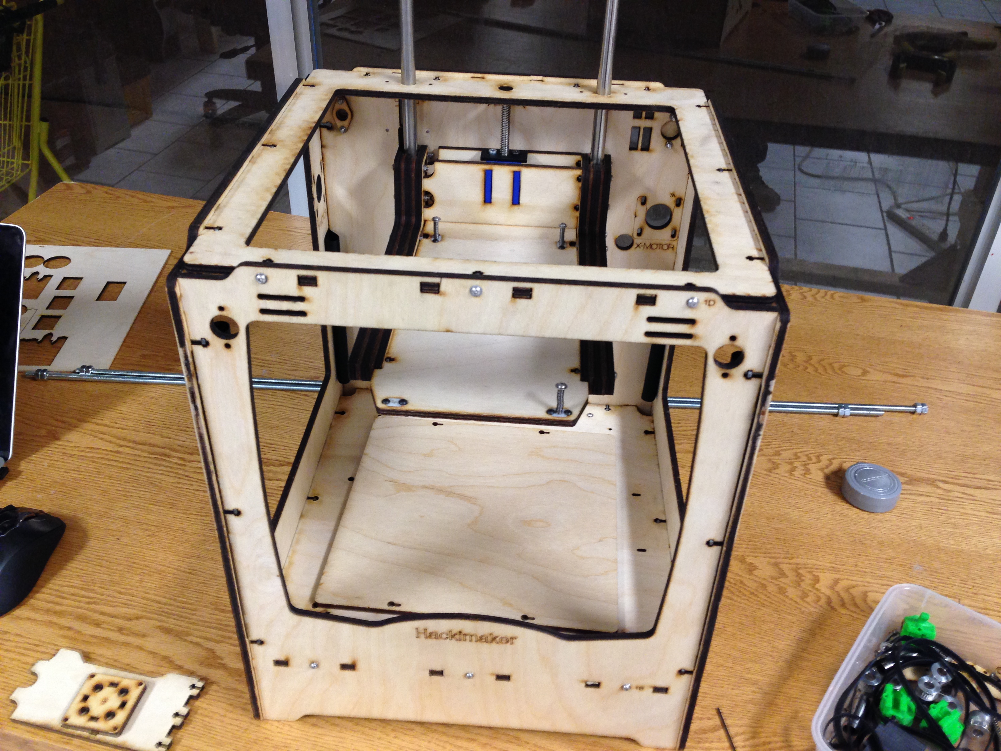

I've made a bit of progress. I was able to finish the frame assembly yesterday.
Frame Fully Assembled
I had to make some changes to the Z axis nut holder, it was about 3 or 4mm out of alignment. It works well and I'm excited to use the ACME screw this time around (last time it was assembled it had a generic 8mm threaded rod).
Z Axis nut redo
Z Axis nut redo

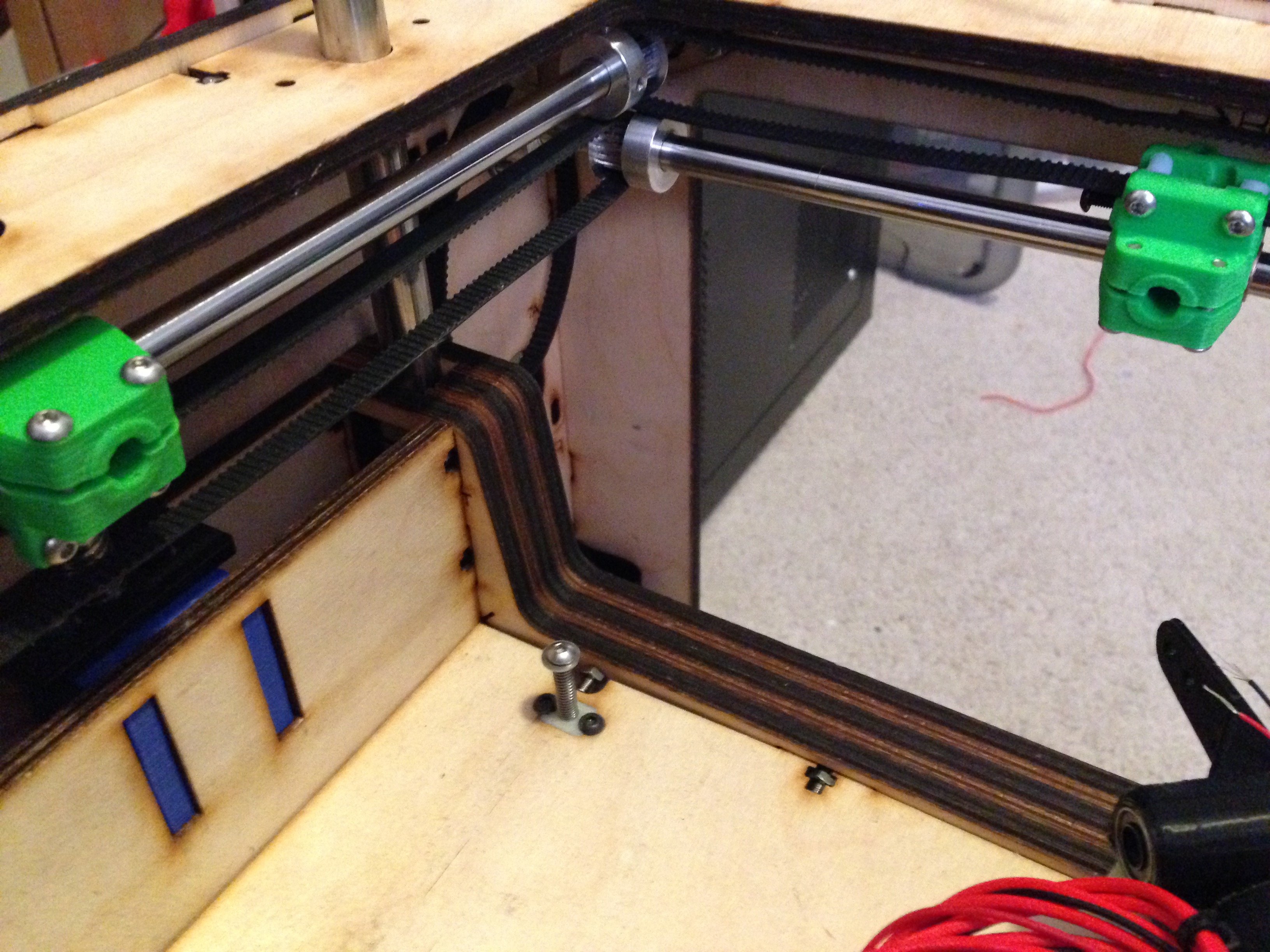

The one thing I've always been jealous of with the stock Ultimakers is the cable ducts that are integrated into the frame. Its just some nylon fabric, so I figured it should be easy enough to make it. I found nylon flag material at my local fabric store, drew the cable ducts in AutoCAD, and cut them out on the 40 Watt laser at my Makerspace yesterday. They look awesome and they are going to work great.
Fancy Cable Ducts
Fancy Cable Ducts
I've progressed to installing the axis rods, probably the most boring part of assembly (I've done it probably 15 times in the past).
Axes Installed
Axes Installed
