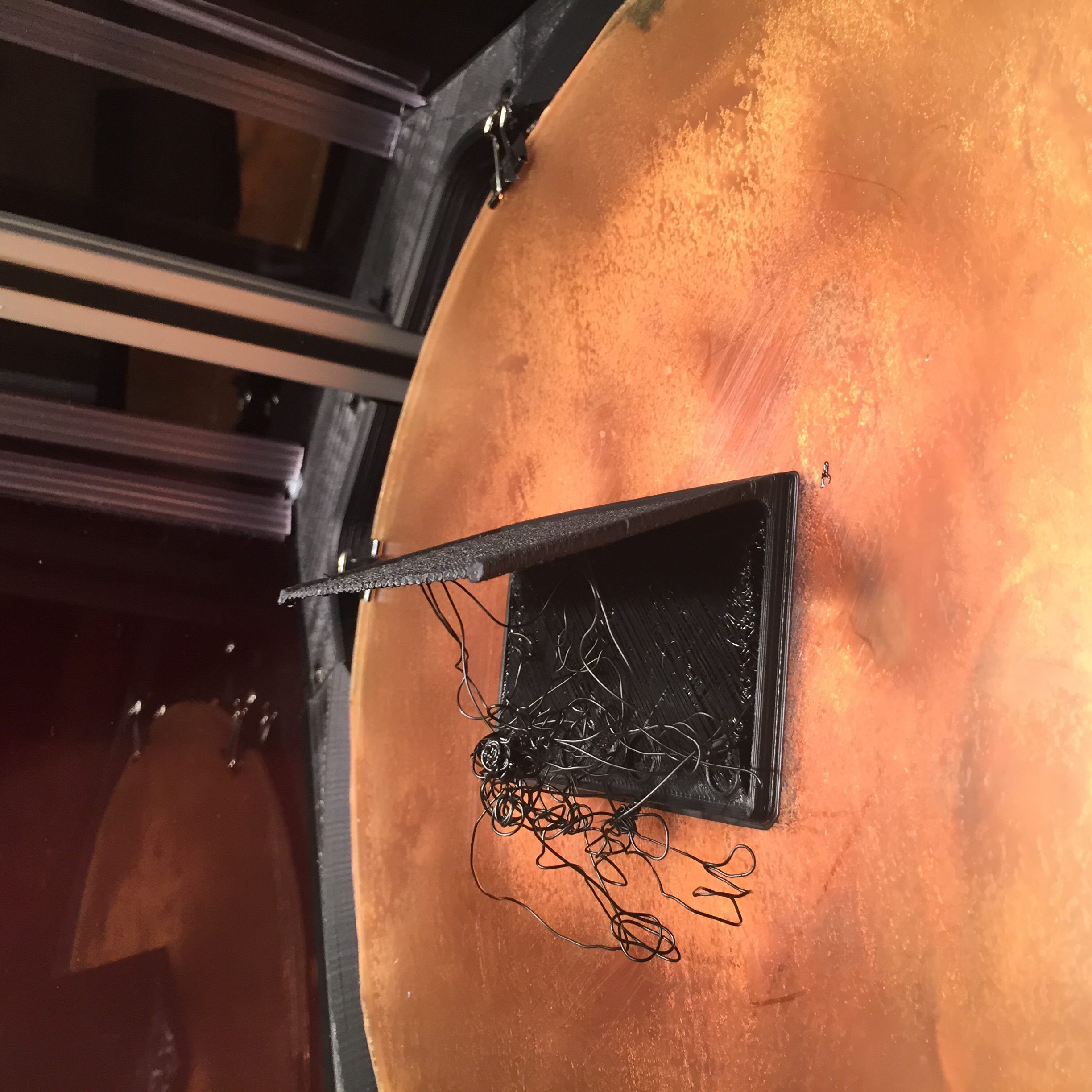

I should have stopped this print earlier. When this print was sliced with MC when using MC slicer and Cura doesn't build the infill which I set at 30%. I also stopped my second and third print again because of no infill which I changed to 40 and then 50%, respectively. I'm not sure why MC does not build the infill on occasion . This has happened to me multiple times even with reprints or different prints. Once MC quits building the infill all prints fail in that regard. When I changed the infill to 80%, it build the infill. :evil: Gremlins or something live there!!!
I've downloaded Repetier and may try that. Havent decided! Anyone with an insight. I have posted this question in MC thread as well but no solution test as to what I may have done or why it happens.
Here is the no-infill fail. Overall it looks terrible. :(

Want to post the model? Maybe there's a problem with the file or something.

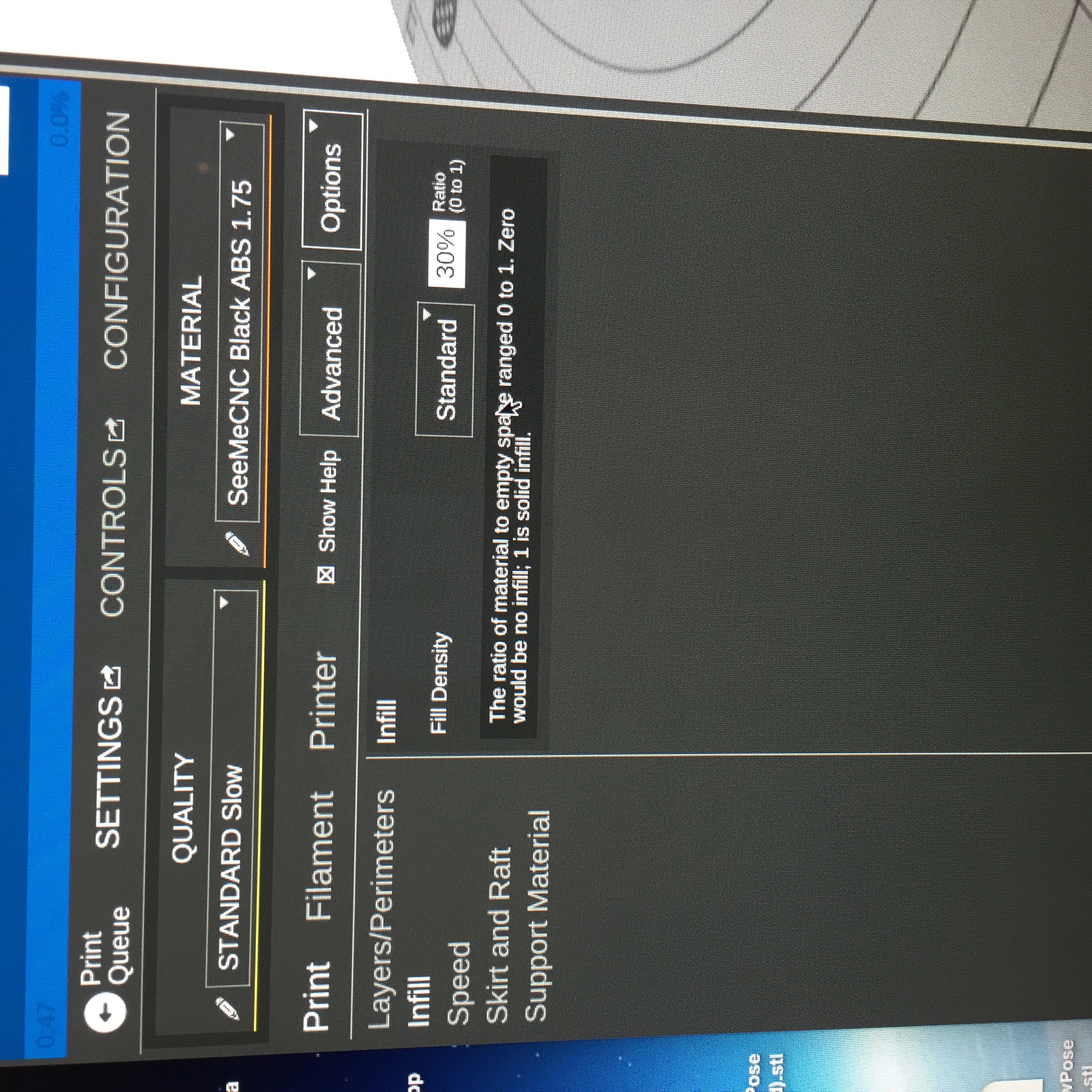

Thanks. I will try that if this comes up again. In rethinking what happened, that the default says 30% infill. When I had trouble is when I changed this manually vs. clicking on heavy. I received an error when entering a percentage and had to enter a decimal (i.e. 30% vs. 0.3). Would that have caused problems?
Re: MatterControler and MatterSlicer Fail to Build the Infil
I don't know that the input would handle the "%" sign. Typically in 3D slicing packages the percentages are entered as a value from 0.0 to 1.0, so 30% would be .3.

geneb wrote:I don't know that the input would handle the "%" sign. Typically in 3D slicing packages the percentages are entered as a value from 0.0 to 1.0, so 30% would be .3.
What's odd about MC is that if you have it set to "CUSTOM" for the infill have have say .2 entered. If you change the drop down to "STANDARD" it will change the infill to display 30%...not .3. I wondered about that but I always overwrite it with a decimal rather than using a % because it seems odd. So maybe MC is causing the no fill because it's using the %?
This weekend I will run some test prints with different settings of default vs. custom and see if that is what is the problem.

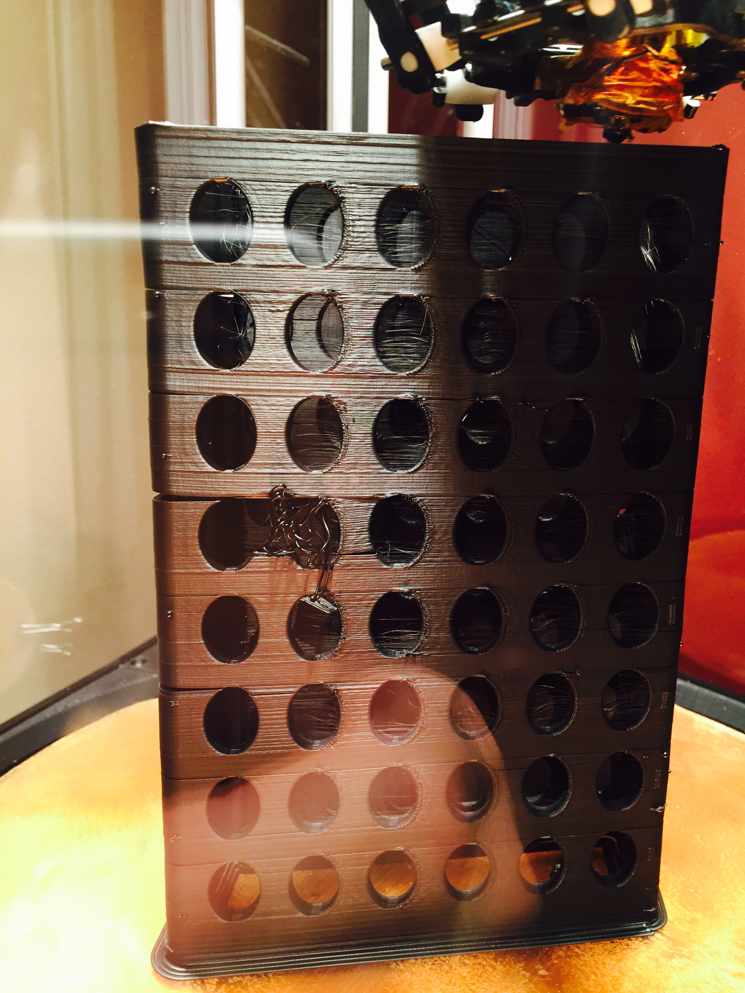

After printing the prior shown Copic pen holder (attached STL) at 80% infill (custom setting entering 0.8) I printed the ear ring holder which I repaired with Netfabb (attached). I did not change any setting simply wiped the bed with isopropyl and started it. Using Cura, MC did not build the infill.
Thus, I stopped the print and tried the little alien which was also repaired (attached STL). Cura slicer in MC again failed to build the infill. :?
Thus, I changed the infill from 80% to minimal to "Standard". I did not enter the fraction simply clicked on the standard button. With that Cura slicer in MC did build the infill. :D
Then, I set a custom infill to "0.4". Cura slicer in MC did build the infill.
Then, I set the custom fill to ".5". Cura slicer in MC did build the infill.
Then, I set the custom fill to ".4". Cura slicer in MC did build the infill.
I will now reprint the ear ring holder without changing any settings.

I didn't change any settings and printed the Ear Ring Holder and it Cura Slicer failed to build the infill.
Again, didn't change anything and reprinted the alien. This time Cura slicer in MC did build the fill! :o
It doesn't all quite fit since this is exactly the sequence of prints which failed with the alien. I am beginning to think it is the ear ring holder STL file but will keep updating this treat as I continue to print.

I downloaded the T-Rex skull and started the print of the jaw. I didn't change any settings . I left it only to find it a couple of hours later with no fill. Dang. Not sure what is happening. Works for a number of prints then fails.

After canceling the T-Rex Jaw print I simply reprinted it again and Cura slicer in MC did not build the fill. Canceled it again!
Changed the fill to 0.5 and tried again. No infill.
Changed the infill to heavy (i.e. 90%) without entering in the fraction. No infill.
