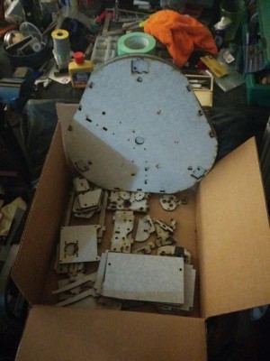

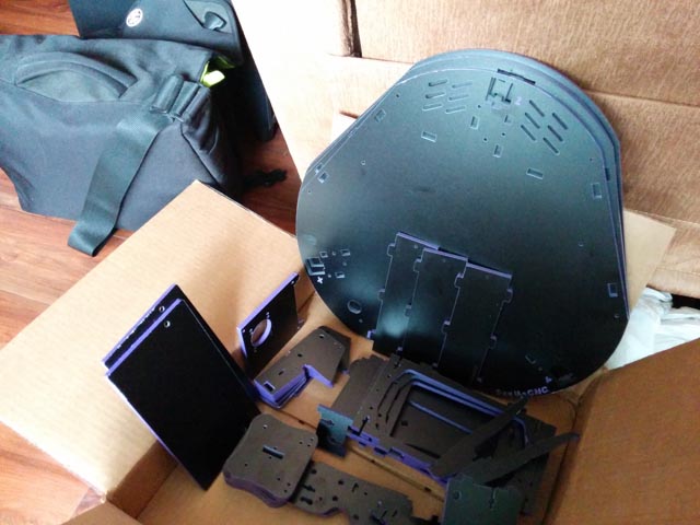

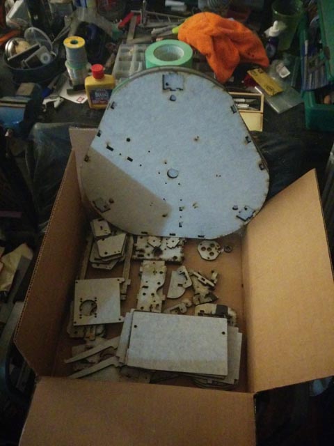

First thing to do was remove to free all the melamine parts and admire them.
Look at all the pretty pieces

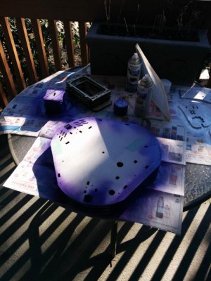

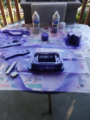

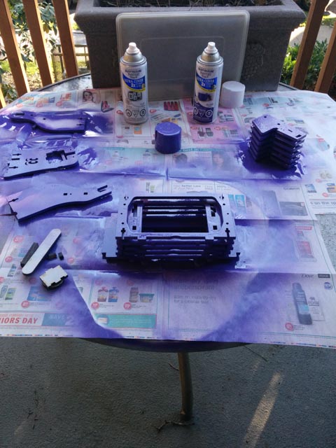

The next thing that needed to be done was to get the edges of this beauty painted up, if only to rid the apartment of the smell of burnt melamine.
It's worth mentioning here that the melamine will soak up a ton of paint so it really does make allot of sense to use a primer coating to seal everything up.
(now my apartment smells like fresh spray paint)

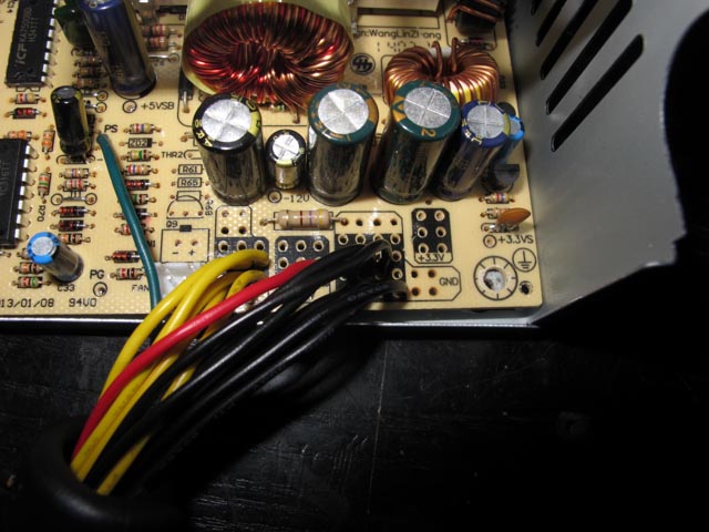

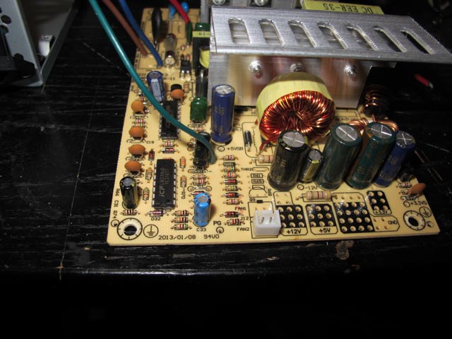

I've opted to clean up the power supply leads, I'm a little OCD and I like to have my cable runs be as neat and organized as possible.
such Tabula Rasa    Much wow!

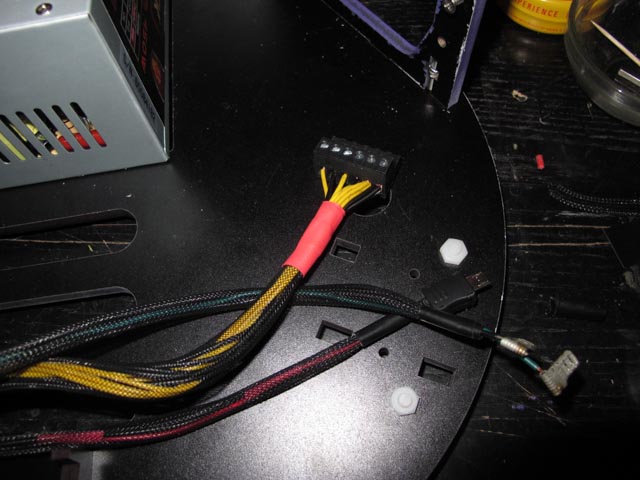

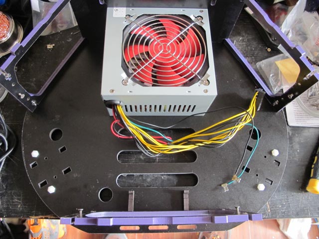

Once fully cleared I reattached only the leads that I'll be requiring for the printer. This should make for a much cleaner interior. Notice the red lead coming off the 5V rail. I'll be using that to power a Raspberry PI running an Octoprint server.
I reassembled the power supply and installed it into the base.

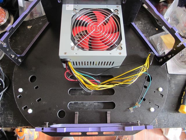

After testing all my outputs and ensuring all my connections were solid it still looked a little too messy for my tastes so I decided to use mesh sleeve to enclose my cable runs.
Now that's looking better
