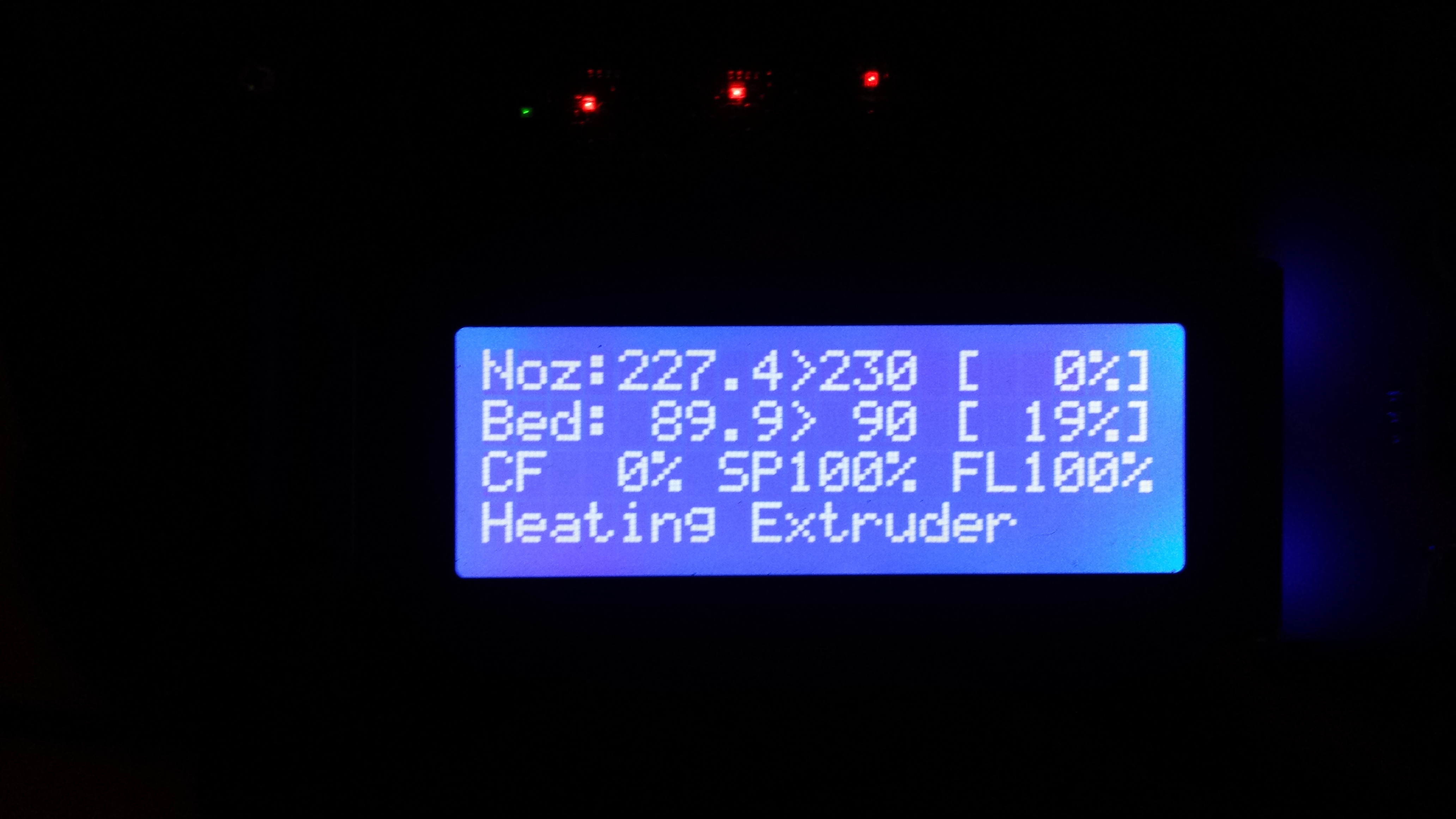

so I modified it to be the same as Slicer (cut out that pointless agonising crawl to 15mm, prefer the nozzle at height with a warning its starting.. if it could heat simultaneously then ok but not sequential).. however it wont attain nozzle temp.. it keeps cutting the heater about 1 degree below target so wont reach and im having to manually set it to 1 degree above target then starting the print to get it to start.
Clearly it's trying to prevent overshoot but it's being too aggressive.. any ideas how to tune it better or what G code I need to replace

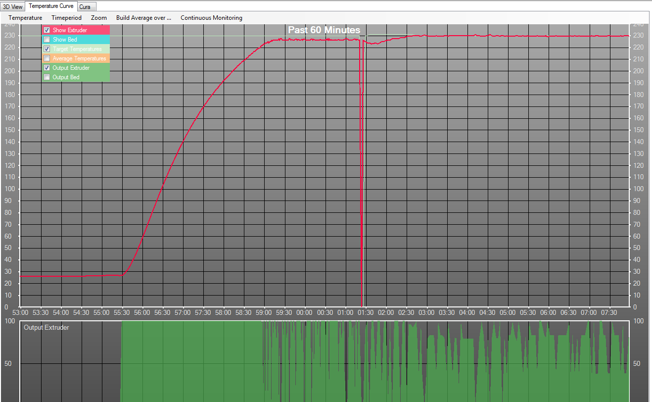

No its cutting the power to the nozzle as can be seen below as I've got the UI modded to display % Power to the Bed and Nozzle
and incidentally Layer Fan %age which is Cf @ 0% btw se below:
Cutting Nozzle power prior to setpoint
TempTrace
TempTrace
Anyway as can be see above its cutting it to Zero at ~227 with a target of 230 so never gets there.. if I manually set it to 230 it gets there ok.
So yeah it's a slicing software issue, probably the start-up G Code is at fault... this bit IMO ({IF_EXT0}M109 T0 S{TEMP0}).. btw I'm using repetier host and with Slicer it works fine.. so it's a Cura specific issue. Maybe it's

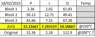

Its your pid auto tuning that is causing it to cut power, I have manually adjusted mine for one of my extruders.
Posts: 2417
Location: Redmond WA
Re: Wont reach Nozzle Temp
Post by Polygonhell »
Agreed this is what you get if I or D are too far out of whack.
Sometimes autotune comes up with unusable values and you are reduced to manually tweaking the PID settings.

Finally got round to doing this using MC Autotune and it did fix the issue somewhat. Not sure but there was a wide variance in each P I & D individual values over the 3 data sets
Is this normal or should they be +/- an acceptable variance?
PID Values
PID Values
PID Values.png (5.75 KiB) Viewed 24590 times
Presumably my original values already in the machine were set at 200°C during SeeMeCNC build? .. As I almost exclusively use ABS I performed mine at 230.
Really odd but it's been fine for several months. Should I be concerned that something is going faulty and I'm compensating for it or is drift normal?
