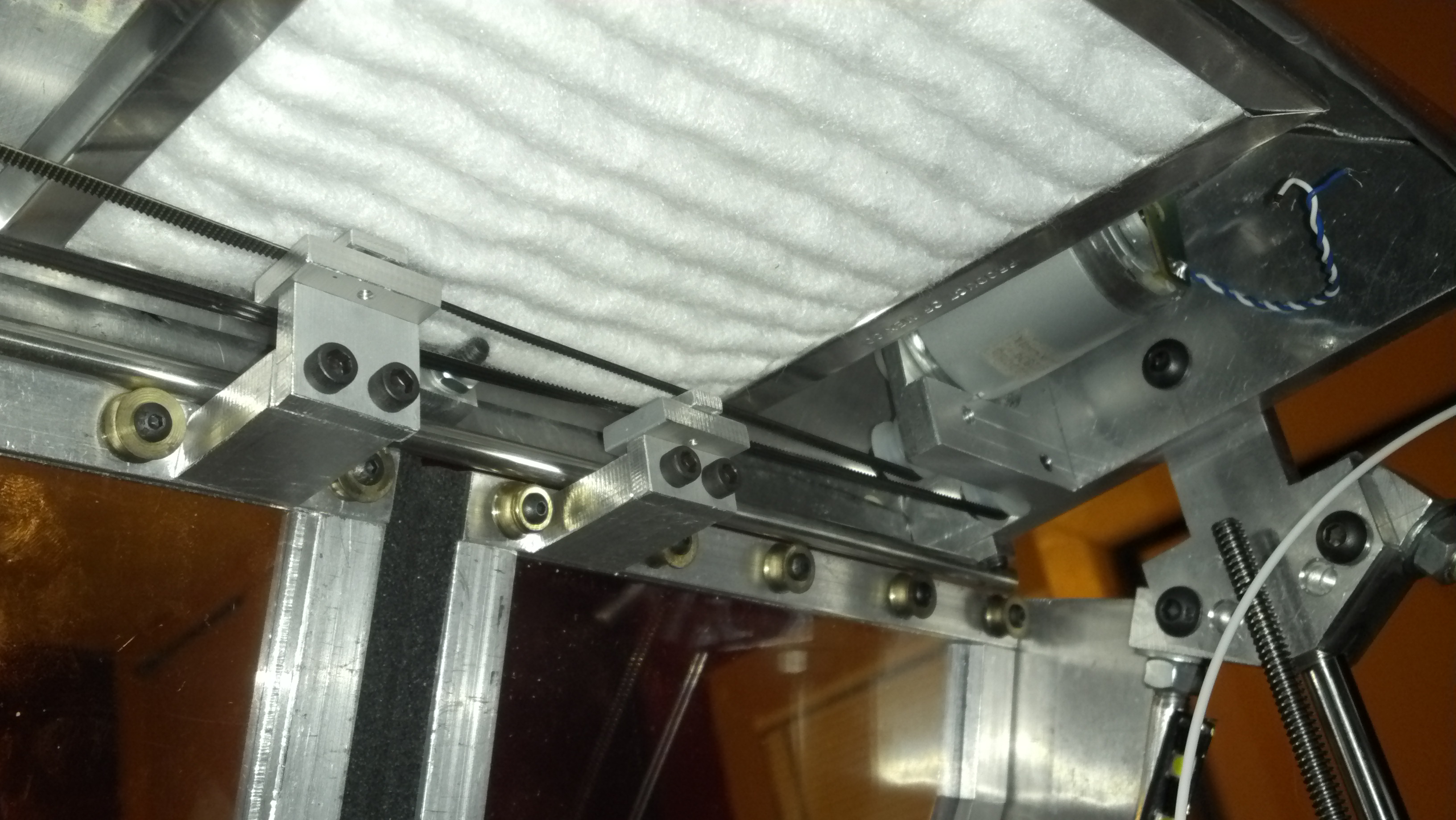

by kilroyo
So I thought I would show what Ive been working on. Well since adding the hood, thought I might as well just enclose the whole thing. Started on building the doors, wanted something different, its a pretty far out there design. They slide out sideways, I have a dc motor and timing belt mounted up under the hood that move the doors out and in, re-purposed the motor from an old printer. I still need to add some limit switches. I'm thinking I would like to add one button to control opening and closing and also tied into ramps, so when it gets done printing ,the doors open up and the table comes to the front. Still tweaking it here and there, and need to start to work on enclosing everything. But I want to do something unique and different for the rest of the enclosure. I'll post a movie once everything is working good.

Re: SeeMeCNC H-1 Ultra
Posted: Fri Nov 02, 2012 10:32 am
by kilroyo
Here's a pic from the inside looking at the door mechanics
I am having a few issues with the bronze rollers and its not quite as smooth as I would like it, might have to change or improve a few things
as far as the space I do get the full length available, but the doors are at a 70 degrees slant, so if I did print a box the full length of the table 6" tall it would hit the doors at the front, but then I could just open the doors for the print.
