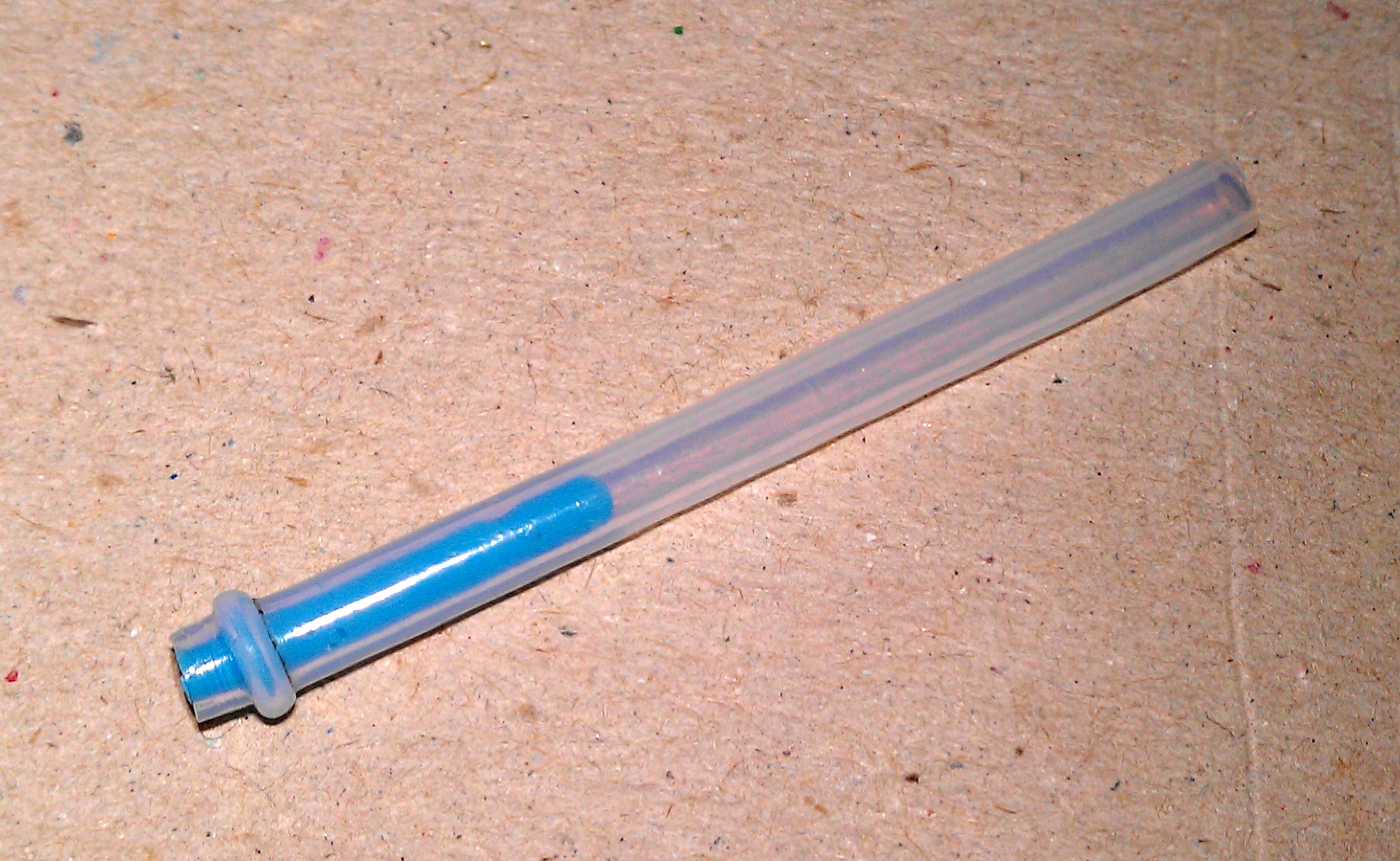

I lowered my temp on the extruder to about 365 - 375f. All was good, I was happy till about the 6th layer at 0.3mm. It quit extruding. :evil:
I tore out the nozzle and the teflon tube and found that the filament was all hosed up in the teflon tube. I cleared it out, put it back together and tried again after changing some settings in Slic3r. Well again, about the exact same spot it stopped extruding... I was cursing up a storm and trying not to wake the kids up.

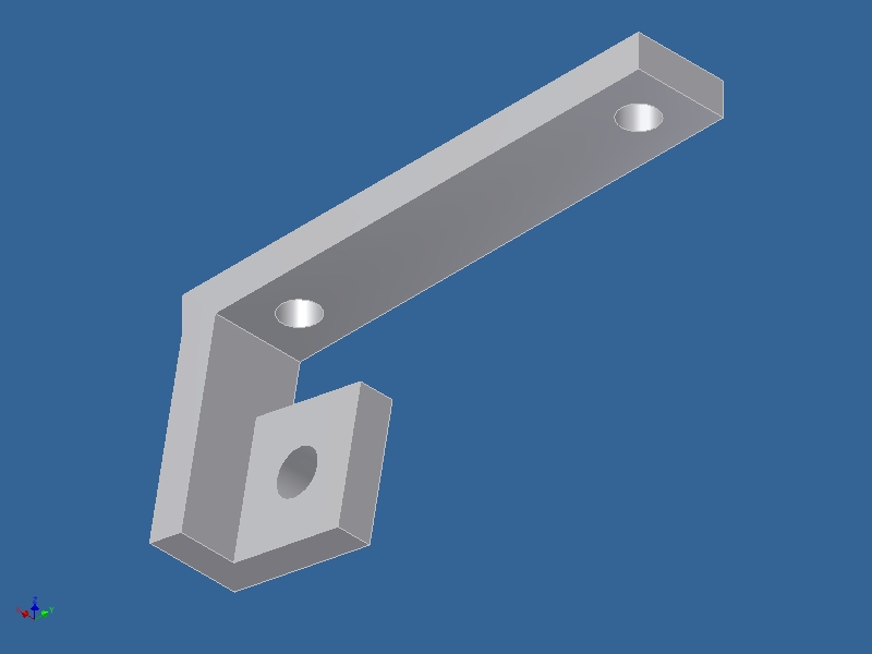

This morning I started thinkin about the issue and thought, well just maybe the dang filament is too hot in the barrel. I lowerd the temp a bit more and no go, same issue. Thought about it a bit more again and thought, well maybe the barrel needs to be cooled a bit.

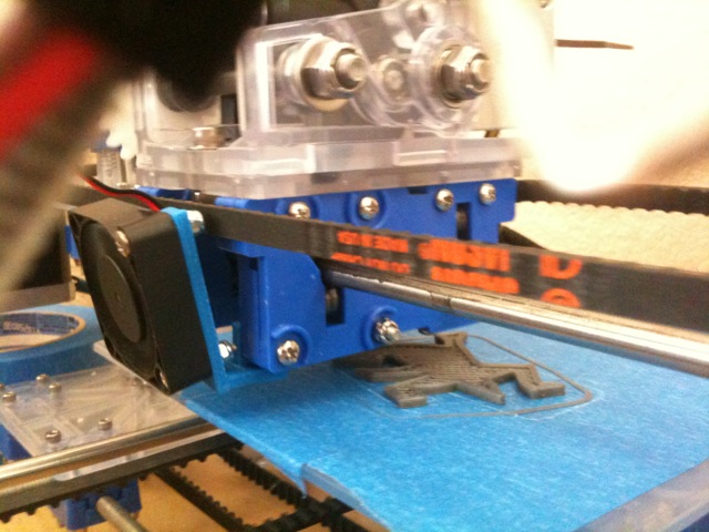

I opened up Inventor (used it like twice in my life) and started to design a 40mm fan holder to blow air onto the extruder.
I came up with this cheesy part.
Had to drill out the holes with a 1/8" bit to slip the 3mm bolts thru but not big deal.

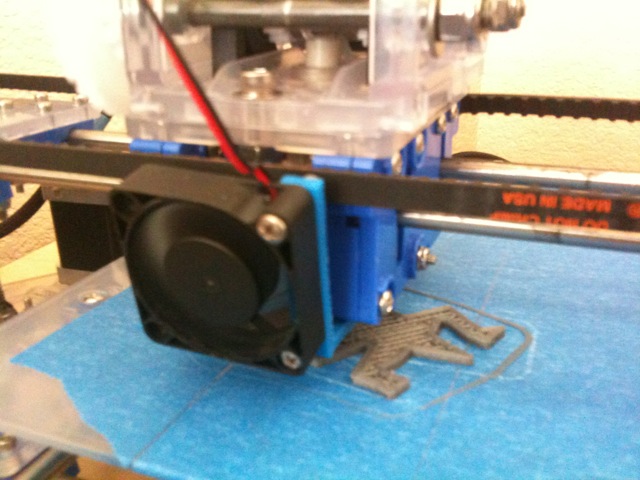

Mounted it up, cranked the temperature back up just under what I print ABS at (about 400f) and let it rip.

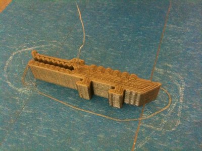

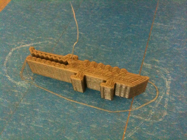

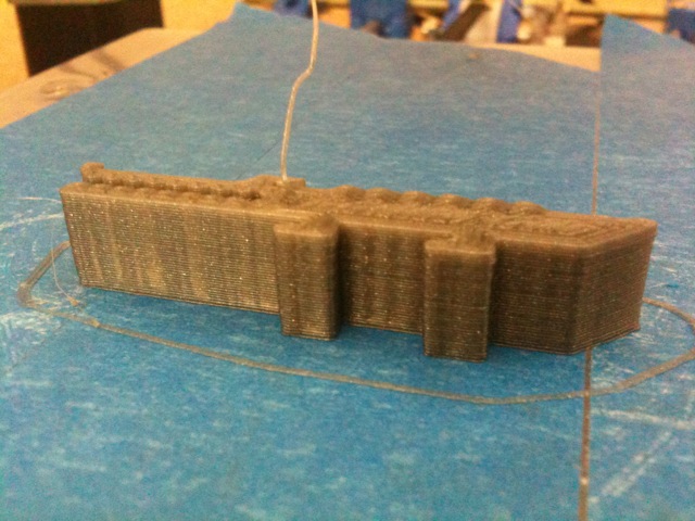

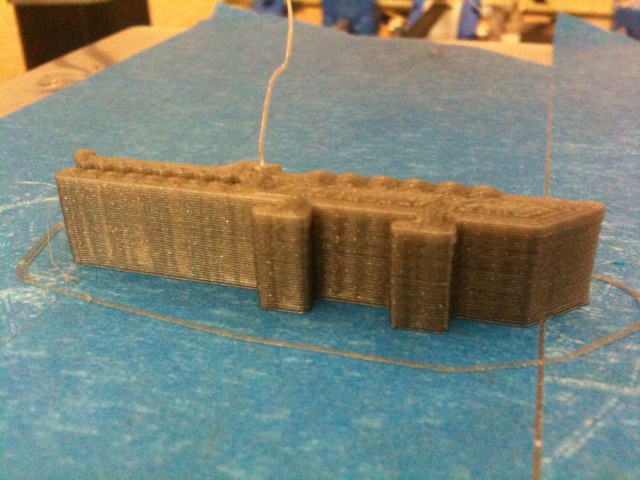

Dang if a part didn't print!!! Just a little air is all it took. Here is the second print I did.
I am now trying to make adjustments to Slic3r as I am getting more ooze out than with the ABS. I think I about have it, once I do I will post screen shots.

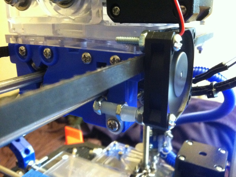

Nice fan holder Peter. As you discovered, PLA does need to have the extruder barrel cooled or it will plug up as the PLA melts up the teflon tube. Since I wasn't able to print at the time, I made my fan mount from a pice of copper wire!
[img]http://mhackney.zenfolio.com/img/s3/v38 ... 6255-3.jpg[/img]
It actually works well but I'd love to print yours. You should be able to upload the STL to this thread.

Printed in ABS with 0.3mm layer height, 1 Perimeter and fill density set to 1. Takes about 8 minutes to print. When you get past the bottom layers and you start to build up the narrow sections you will want to reduce your feedrate down to about 60% to keep the part cool and prevent goobers. Nothing like adjusting speed on the fly!
I notice your fan is on the backside. Maybe I should do that since the thermistor is protected by sealant. Hmmm....

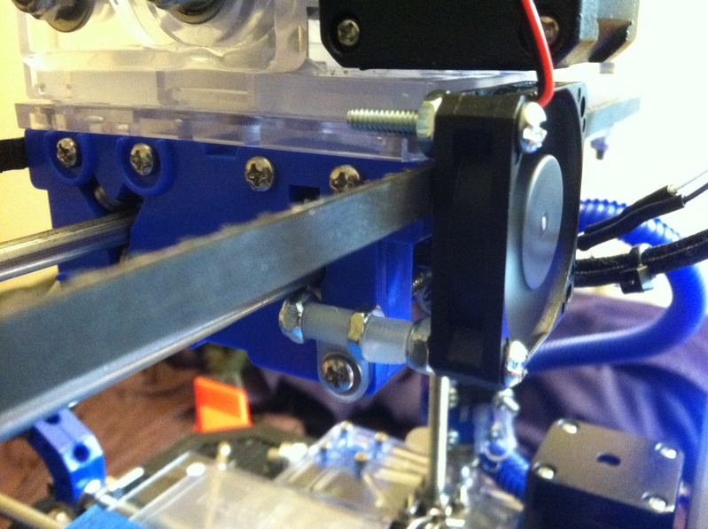

That's great I like your bracket... I had the same frustration as I am a PLA guy as well.. Mine was out of a couple bolts and a wiring anchor. Although I need to move it to the inside to center the flow more. I kinda get a swirl going which is ok than having one side get a hot spot.
