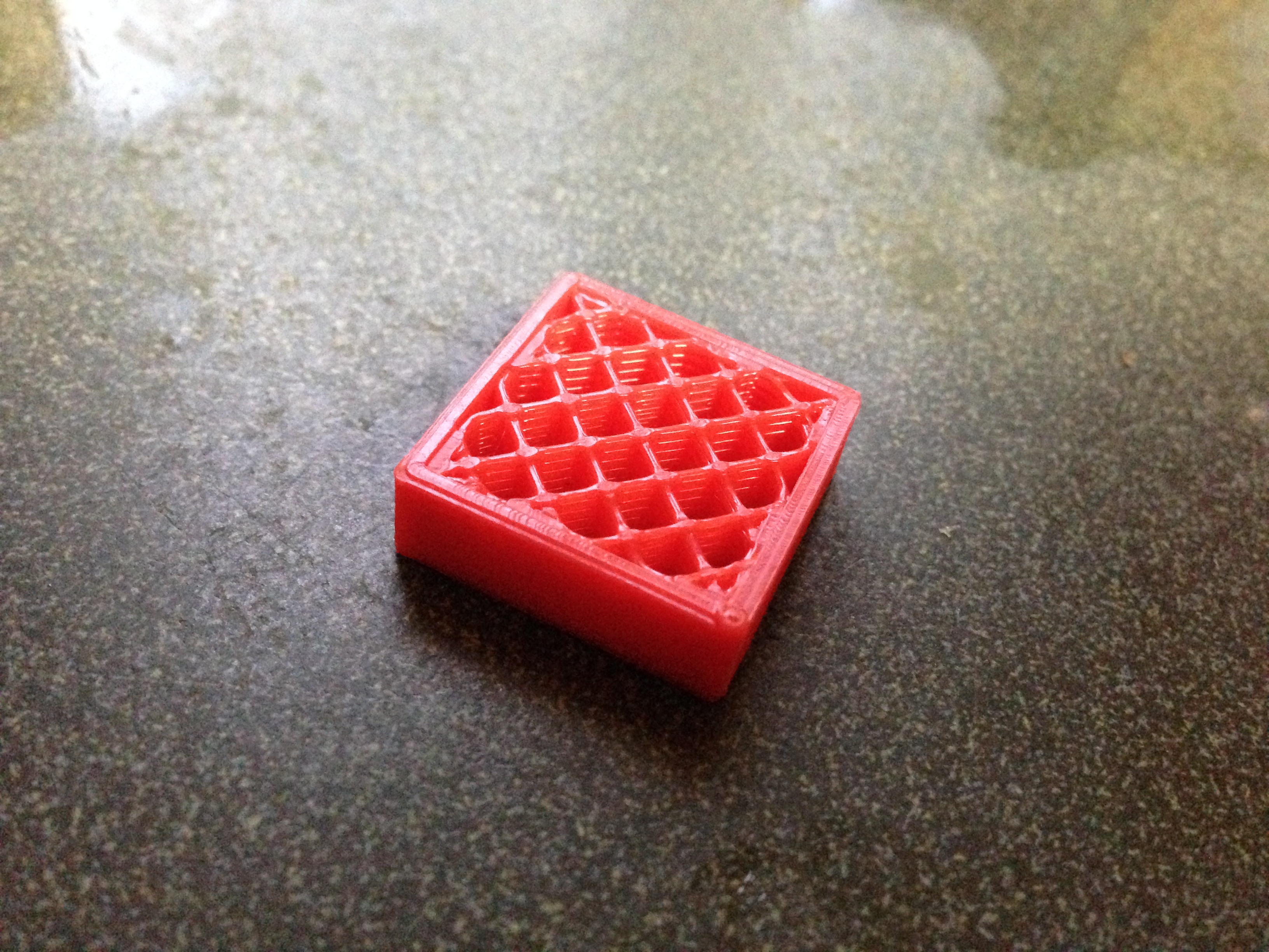

I purchased the license about a month ago and I like it. Very quick, economy of movement and the support can be edited or manually changed, deleted or placed.
Biggest weak spot for me is in the infill. I would like to see a honeycomb and different patterns available for top and bottom layers.

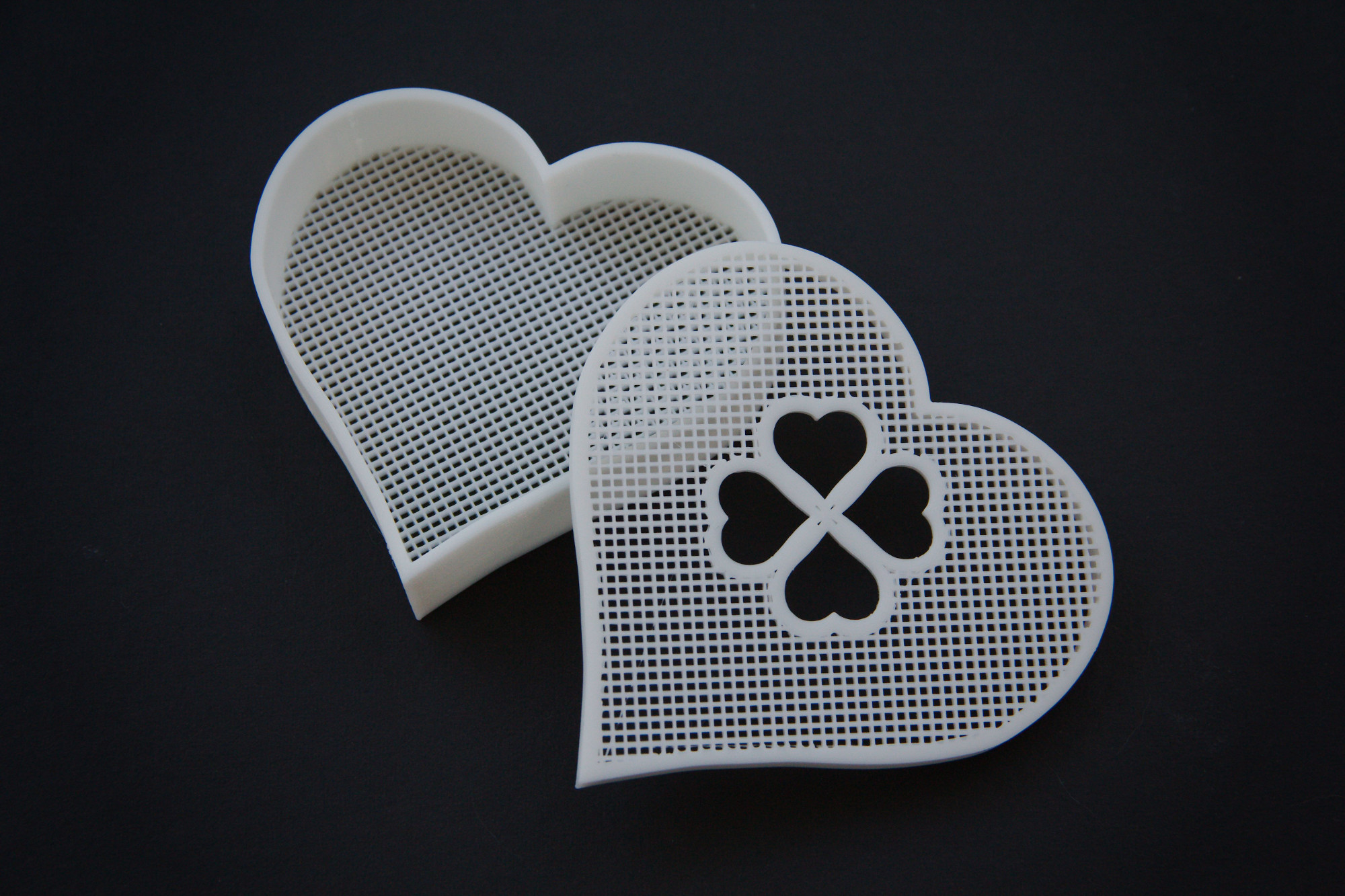

Re: Broke down and bought a license...
This is exactly one of the issues I had. With a round part that is seen from 3 or all 4 sides, there is no place to hide the seem. No one, including me, that I had test some of the fly reel parts (see my avatar) was able to print the back plate without an ugly seem right through it. Like I said, it may be fine for some users but this is the type of thing I continually ran into. The single perimeters at a time was a show stopper for these parts:
[img]http://mhackney.zenfolio.com/img/s5/v12 ... 0688-3.jpg[/img]
[img]http://mhackney.zenfolio.com/img/s1/v49 ... 4732-3.jpg[/img]
Not to mention that I could not come close to doing an "open weave" pattern like this. I even went so far as to slice in S3D and KISS and then graft the gcode files together in an attempt to get concentric shell fill (which KISS does not do) and open weave like this (which S3D does not do).

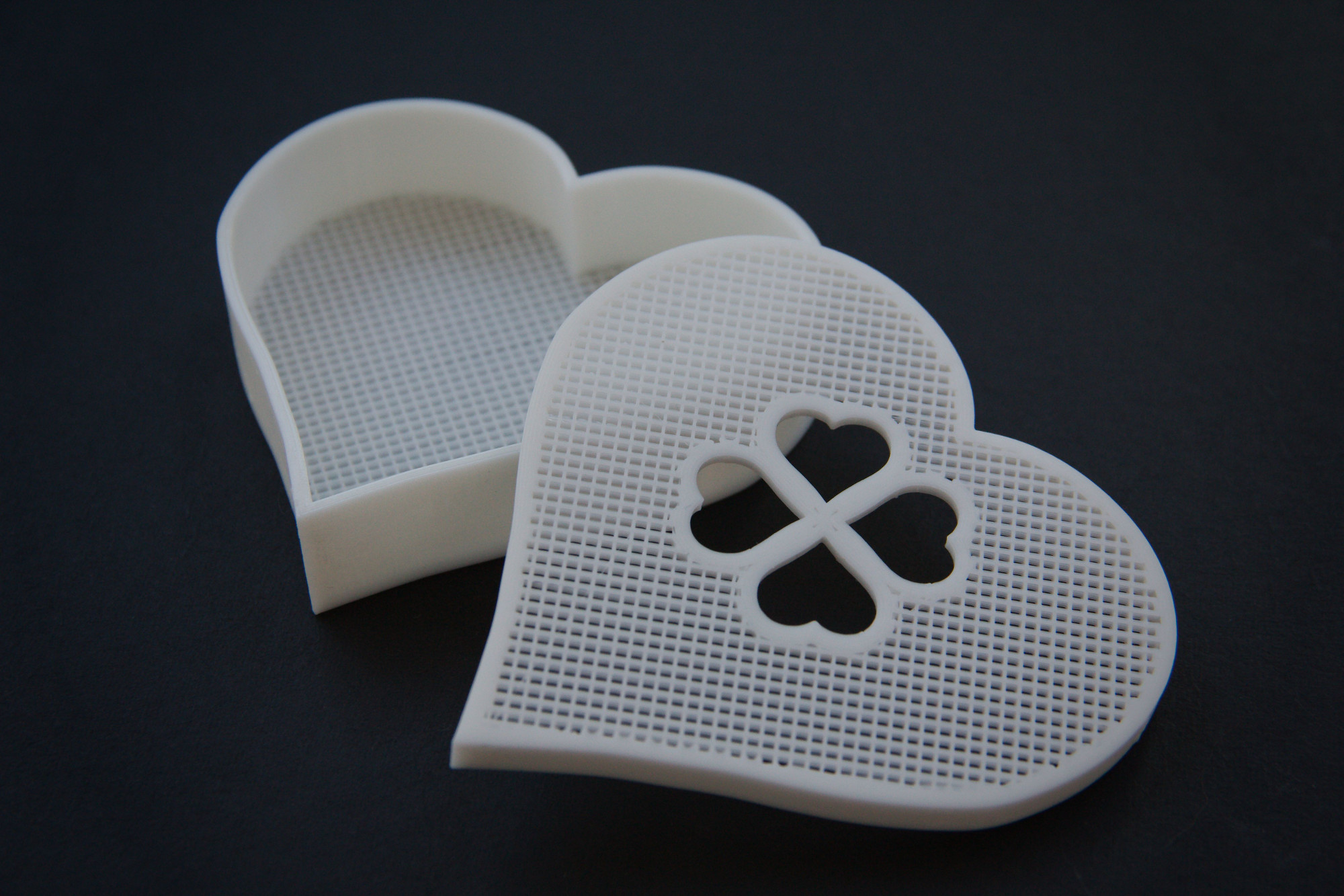

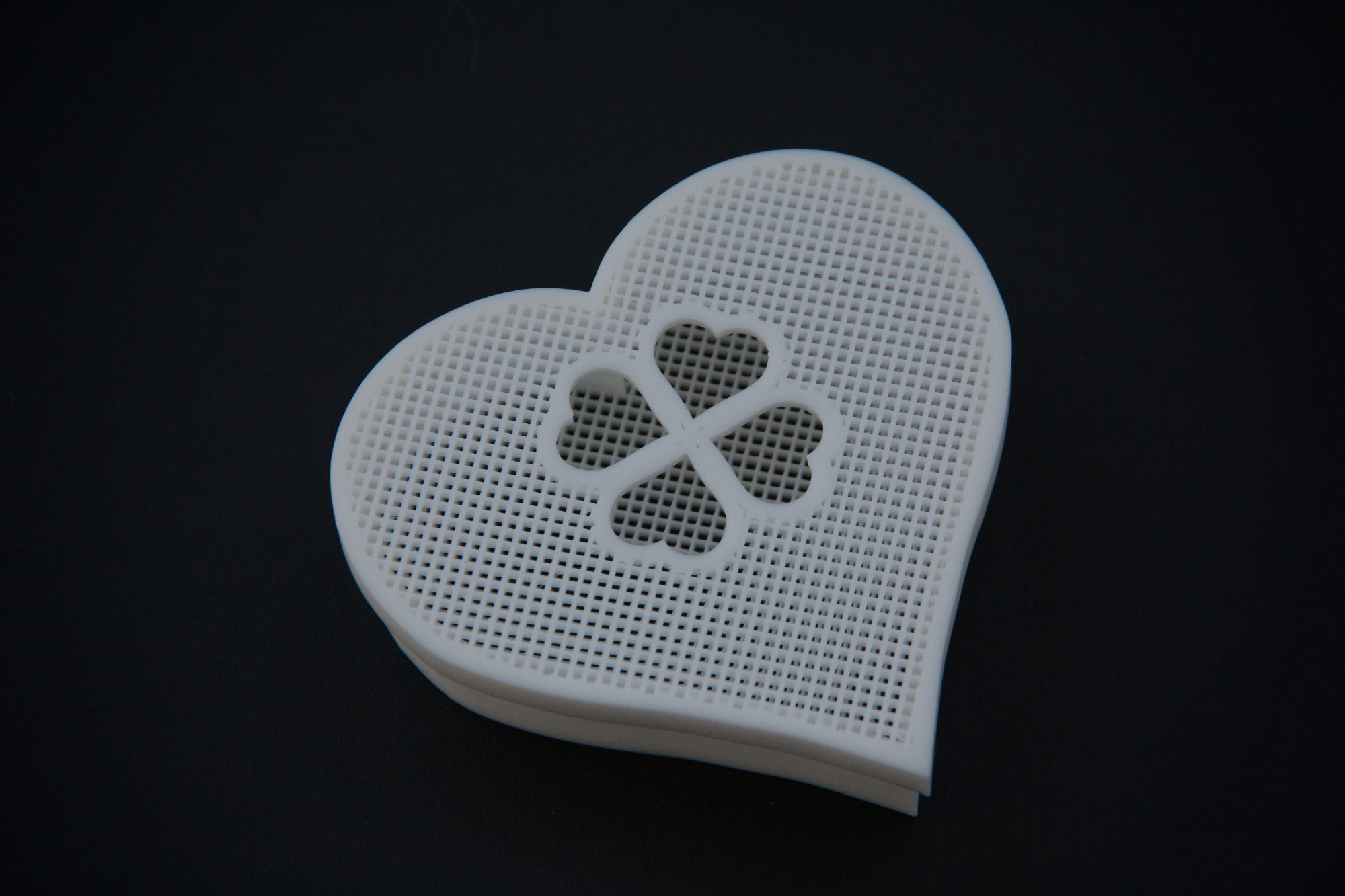

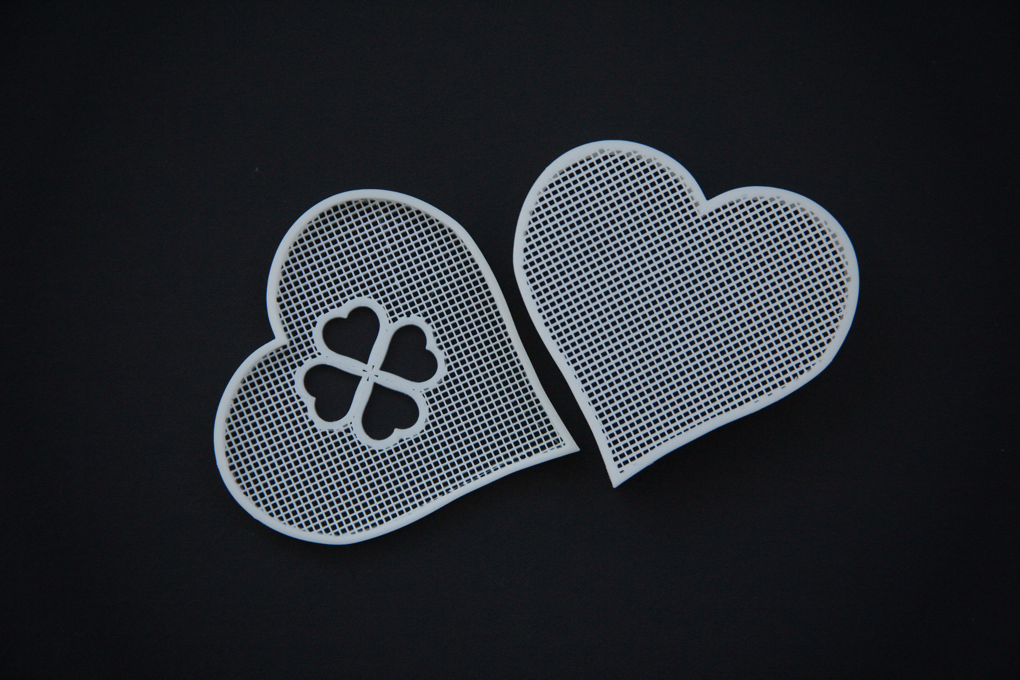

I took a stab at the heart today (pun intended) just for the hell of it. Unfortunately, I was no where near my RMaxV2 so I printed it on my FlashForge with the latest version of S3D. I have no reason to believe that my RMax would have printed any differently (except maybe for a little extra retract stringing). 35% infill at 60mm/s. Wife is happy with it.
Thanks heathenx for taking the time to print this. Please do not take this personally, as it is not intended that way! The print looks good and many would be delighted with it, but to be honest, even in these photos I can see exactly the type of issues I experienced with S3D. I spent many, many hours tweaking and testing and studying (with a magnifier) and was never able to do as good as I can get with other slicers. I don't think your printer or slicing parameters are the primary contributors, in fact, your print of this box looks as good as the best I could do with S3D - kudos on that! Realizie that the following comments are based on your photos and my looking specifically for the problem areas I experienced, here's what I observe:
The other major problem I had, and since you printed the box with an open fill bottom I can't verify it with your print, is that the first layer has a pronounced seam line from the shell fill. I know it looks like the box bottom on my photos has exposed infill but it actually has 2 solid shells top and bottom - the PLA is translucent to expose the fill pattern, a subtle and attractive effect). The problem was even more pronounced with my fly reel back plate, no amount of tweaking eliminated this problem and every one of the other folks I had test this part with S3D had the same issue (and one of them had been an S3D user since it first released). I'm happy to send you the STLs for the reel if you want a challenging print! And even f you don't fly fish, it is a great stress reliever. It makes a pleasing click when you turn it.
Cheers and Happy New Year and thank you again for your work.
Michael
- around the small hearts in the top, the perimeters have gaps where they should touch. You can see this clearly in the center section where the tips of the hearts meet in the second and third photos
- the lower box sides also show incompletely bonded perimeters - this can be seen in photo 3 if you zoom in - on the left side of the box as it hears the point it is most clearly visible.
- this one is stretch but perhaps you can scrutinize the lower box sidewalls (on the outside) and describe or photograph the quality - it looks like there are areas of blobs just visible in photos 3 & 4 if I zoom in, but again its a stretch.
