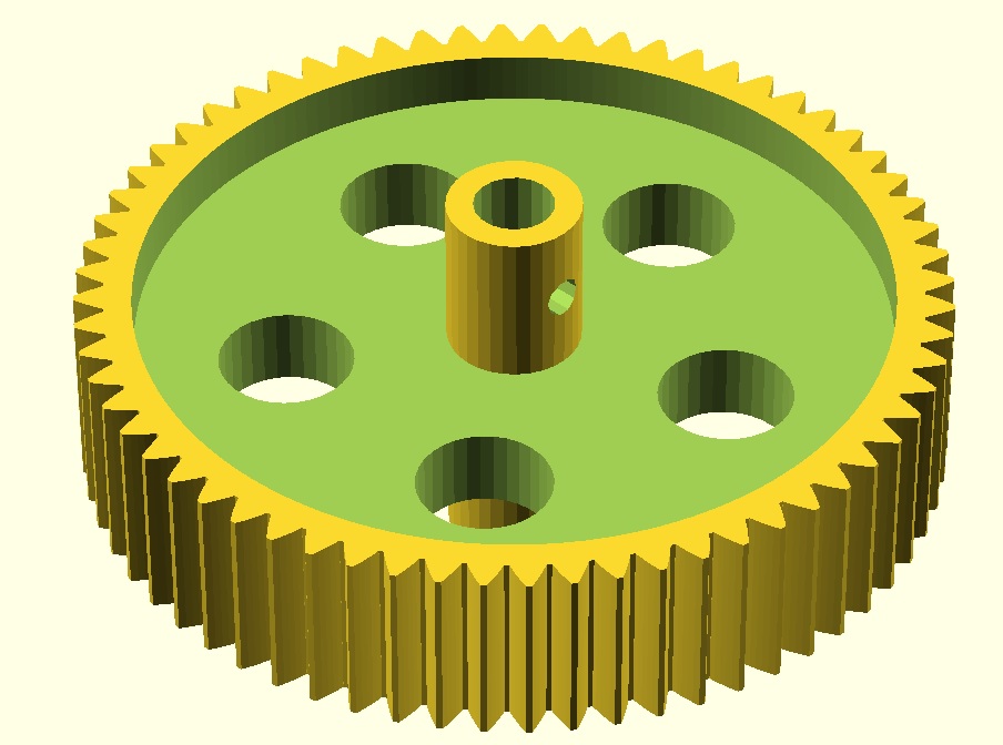

I wiped up a gear generator based on the MCAD 'involute_gears.scad' libarary
Hopefully, this makes creating gears very easy since all you have to do is plug in some numbers and press F6.
Options include:
- recessed sides (single or double sided)
- gear hub (single or double sided)
- set screw in the gear hub
- relief holes
Example to make a gear with recess sides, double-hubbed with set screw and relief holes (see attached image):
gear (circular_pitch = 88,
number_of_teeth = 64,
gear_thickness = 7,
bore_diameter = 3,
recess_thickness = 2,
recess_diameter = 28,
recess_double_side = true, //default false
hub_thickness = 6,
hub_diameter=5,
double_hub = true, //default false
hub_set_screw_diameter=1.5,
num_relief_circles=5,
relief_circles_diameter=5
Download the attachment or go here; http://www.thingiverse.com/thing:608062

You should also check out http://www.gearotic.com - Art's gear software is just amazing. It's from the same person that wrote the Mach3 machine control software.

I use gearotic to cut metal gears on my Tormach Mill. I have cut and hobbed a lot of gears and this software generates a gear that is as accurate as I can measure. It is based upon a process called gear shaving and generates a geometrically perfect gear tooth.
