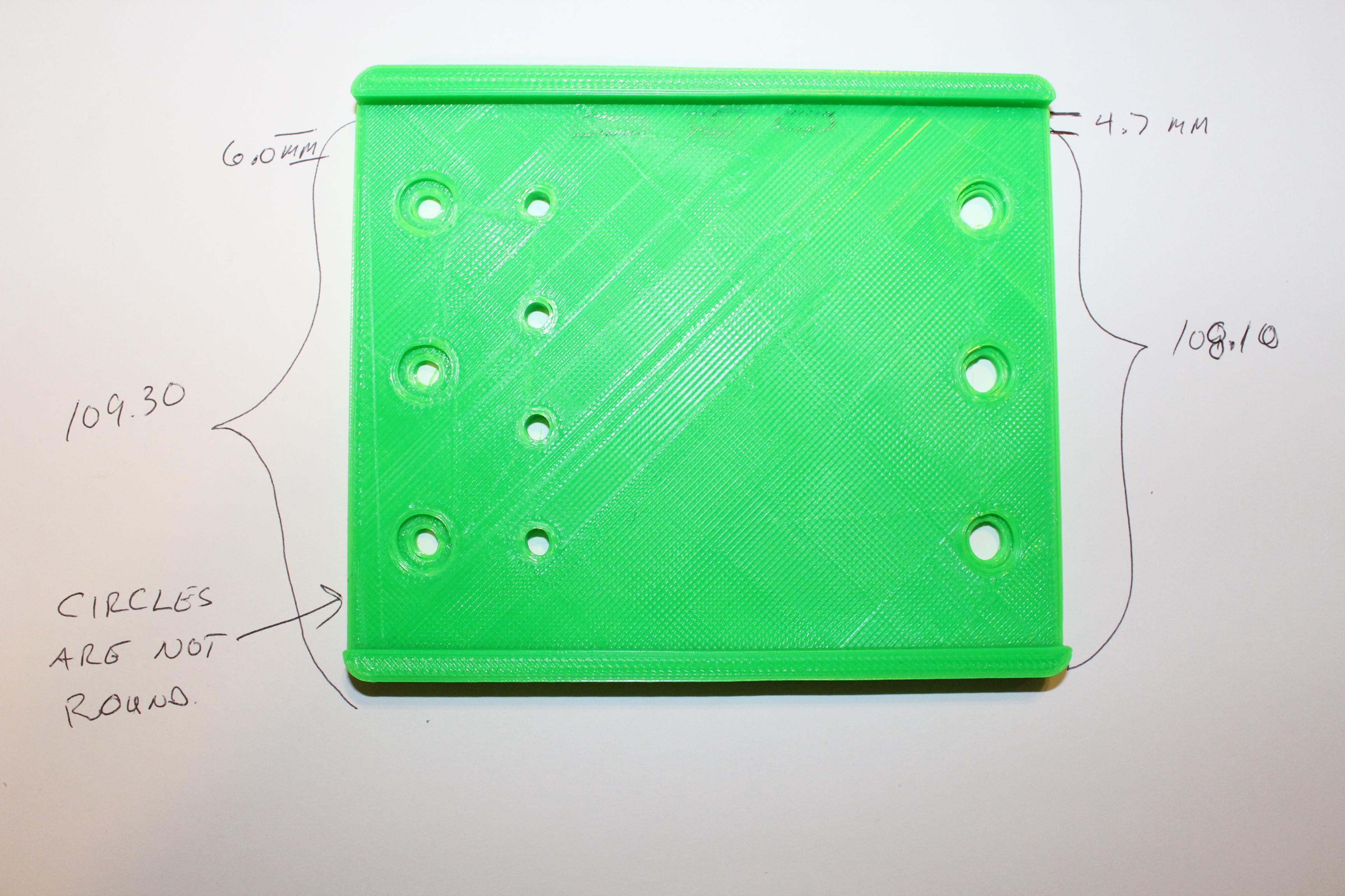

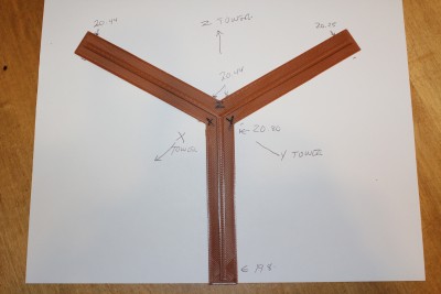

I need some help here. I am having a problem where a straight part will narrow or taper in within its length. The 2 photos show 2 different orientations . The first where the "spokes" each point to a tower. In this orientation the width, which should be 20mm, is a little wide but consistent. The second photo shows the model printed with the
spokes between the towers (60° from the tower). The one facing "south or down" is a full mm skinnier at the tip.
The third photo shows some of the same wonky stuff.
While this doesn't seem much it causes problem when I want squared parts. The model is only 1 mm high. It is the
same regardless of how tall I print. It is printed in pla @200. bed @ 50.
The printer also cannot do circles worth damn. They are squished or out of round.
Here is what I've done or checked
1, The cheapskates are nice and smooth and belts are good. I even removed the belts and checked each wheel on the cheapskates and adjusted them to a nice light roll. No shimmy or shake.
2, I am using Trick laser arms. The effector is pretty solid. I have checked the arm length in the eeprom and it is set to 269. I played with that setting a bit but the problem followed.
3, I cleared the firmware and reloaded and recalibrated with a dial indicator to within .001 inch. The effector tracks nicely.
I've had an Orion since last winter and built the Max this summer so I am pretty familiar with the workings. I get good prints just not accurate. I have got to do some rectangular prints for work but the wider the print the more pronounced. I need rectangles not wedges. I understand about shrinkage but this is not the problem.
Any help would surely be appreciated.
Please excuse the poor representation on the photos. Not my strong suit.
Tony
This one is good. The spokes point to each tower, each spoke is 110 mm
this one is off , rotated 60°
130 mm  long
130 mm long

Here's an example of another person talking about the circles issue and why that sometimes can be an issue with the slicing and the way the RAMBo interprets and interpolates the gcode. In your case it appears to also be a result of your irregular build shapes...
As far as your scaling issues, many members here suggest checking your steps per mm on each motor in the Repetier firmware. Tweaking those just right can usually get your arms to cooperate more in sync with eachother.

Thanks for the reply. I should mention I have used 3 different slicers to the same result. I'm not sure my build shape is irregular, a 3d printer is capable of the oddest of shapes. ;)
I am not worried about circles coming out undersized, more that they are not round.
How would one go about changing the steps per mm for an individual motor? I've looked through the configuration h file and there seems to be only one general spot to change this for all the motors not just one.

Ya know, come to think of it, is your effector platform tightened all the way down? This includes the hotend and nozzle itself.
It seems like nozzle wobble could cause some of the scaling issues to me...

I had a bit of this type trouble along with overshoot on corners and looked at a lot of things with no result. In the process of moving the effector I notice that while the skates and arms were tight, I could wiggle the nozzle a bit. Apparently the black plastic "springs" that go over the u-joints (mine are aluminum) could be a little stronger. I placed sever taunt rubber band across the arm pair and positioned these at the center of the arms. It is amazing how much tighter and stiffer than made the nozzle and effector plate.
My problem largely went away maybe because this worked, maybe because I wanted it to. I still find holes a little undersize but this is due to the polygon effect. When measured across the "flats" or "corners" they look pretty good.
