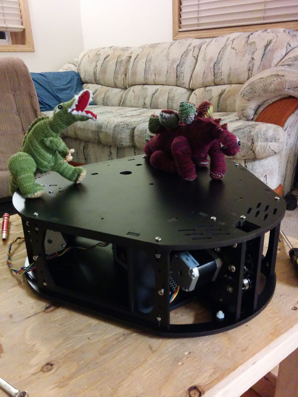

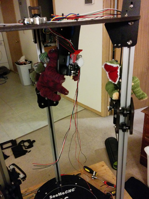

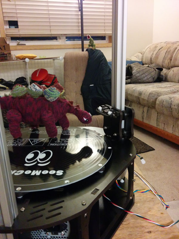

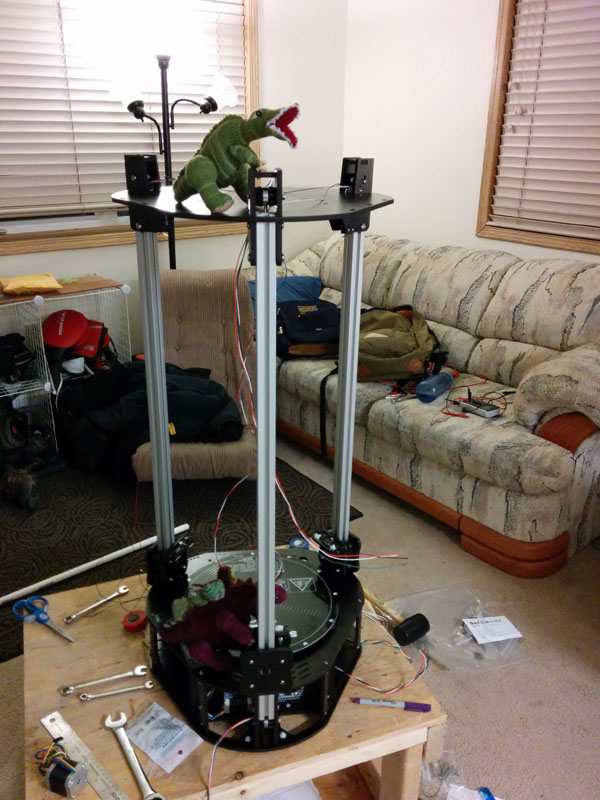

The uprights and carriages got put together.

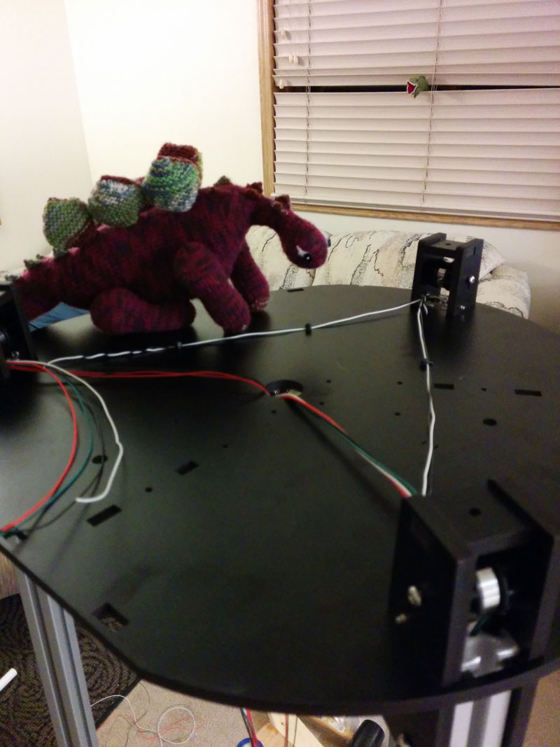

The wire runs were a little tough to pull through, but the top got assembled just fine.
Stega checks the wiring length for the hot end and fans.
And then carefully finishes the wire routing on the top plate.
Stega installs the EZStruder while TRex makes sure the carriages are fun to ride.
This isn't a 3d printer, it's a carnival ride!

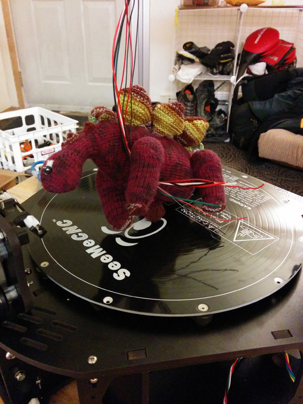

Z-axis adjustment and bed leveling took a couple hours of careful checking.
