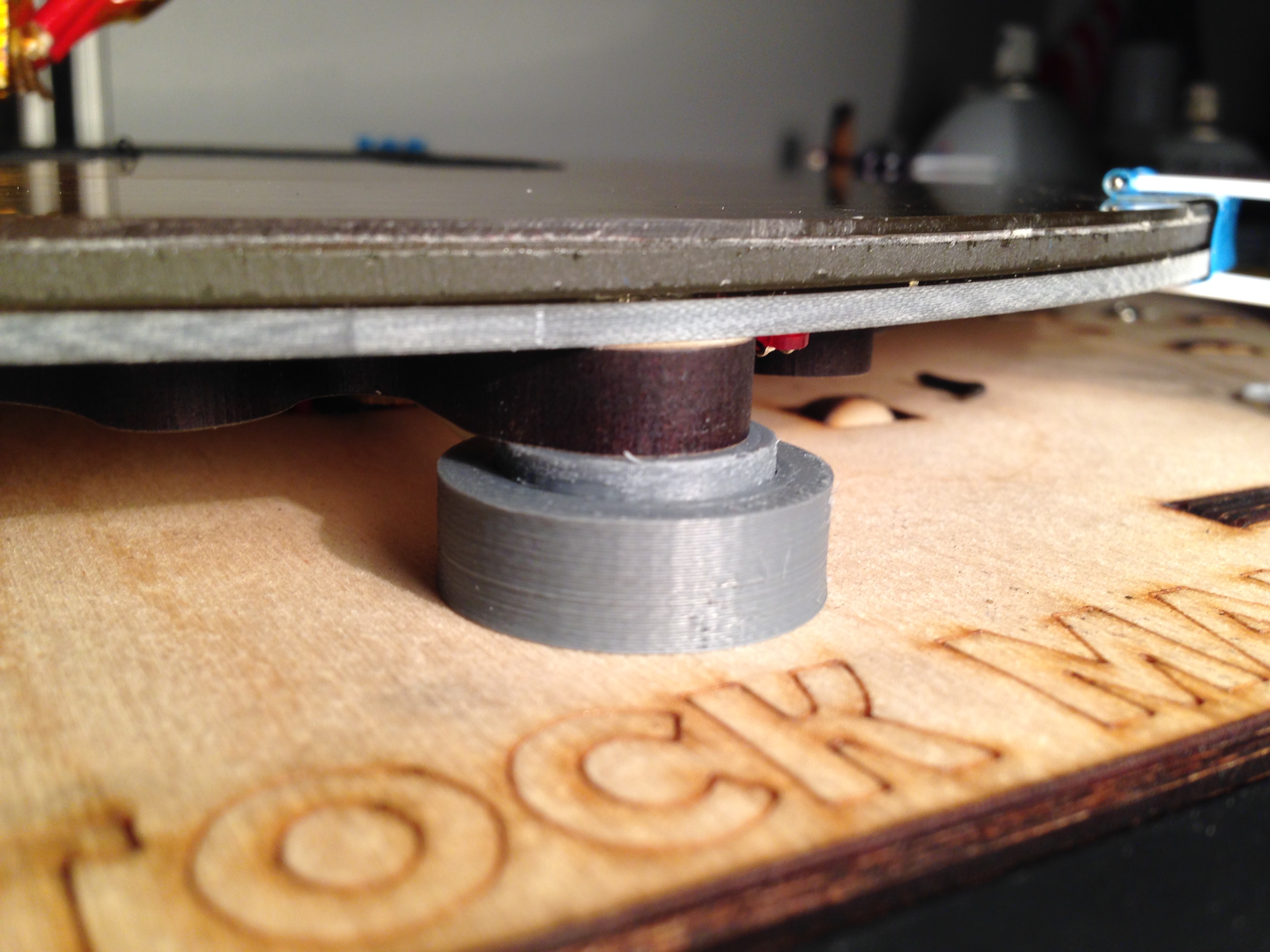

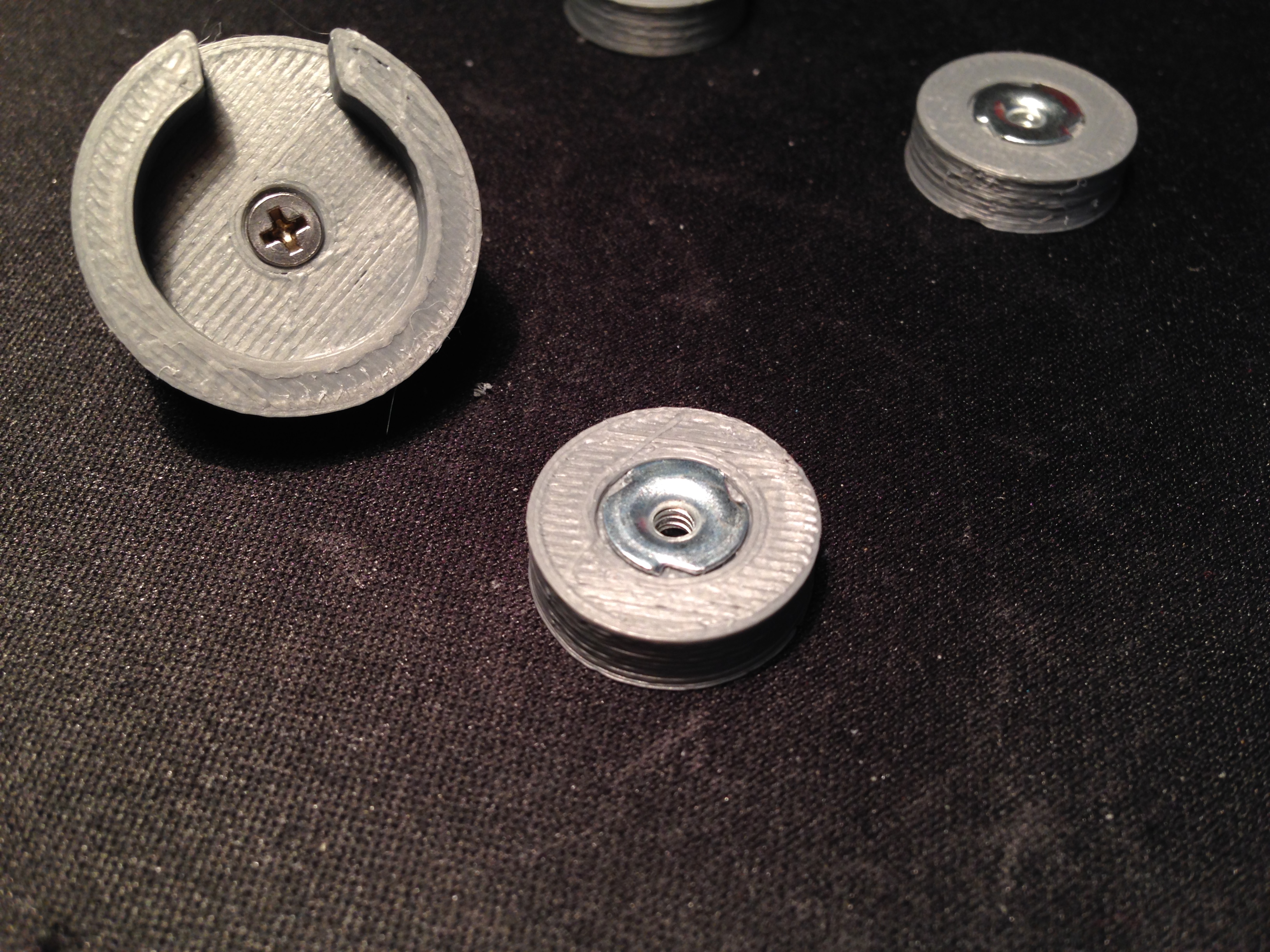

They are a lot like rpress's mount in aluminum, but I made mine to be printed. The mounts should be in ABS, the puck should be in PLA. The upper mount is designed to have one of the tee nuts used with the wood kit keeping the screw captive.
Example
Example
If you want .ipt, STEP, or F3D files let me know. I can design the upper part of the mount to be threaded directly into, or whatever really. Installation is pretty obvious, but I can take pictures if needed.

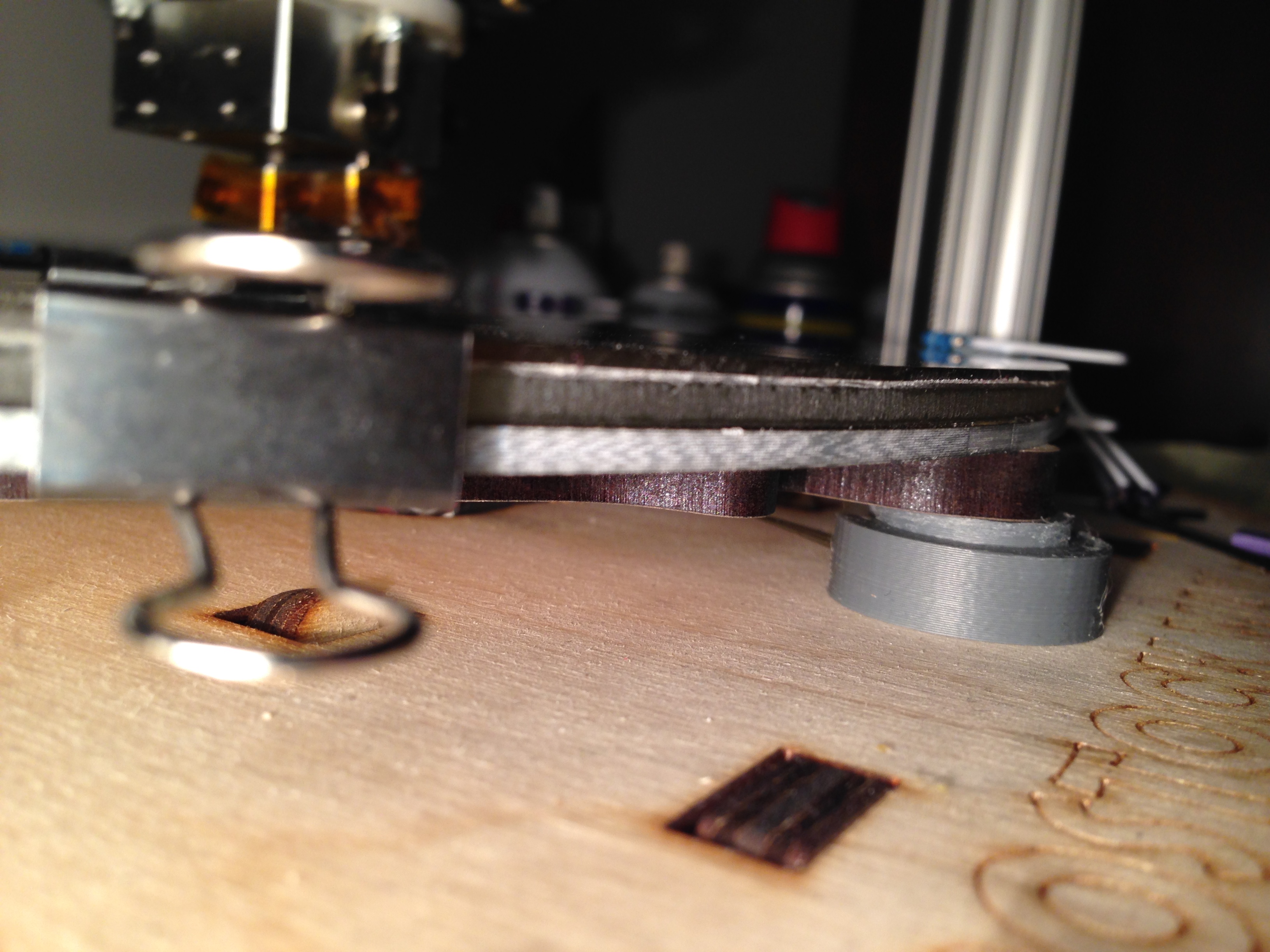

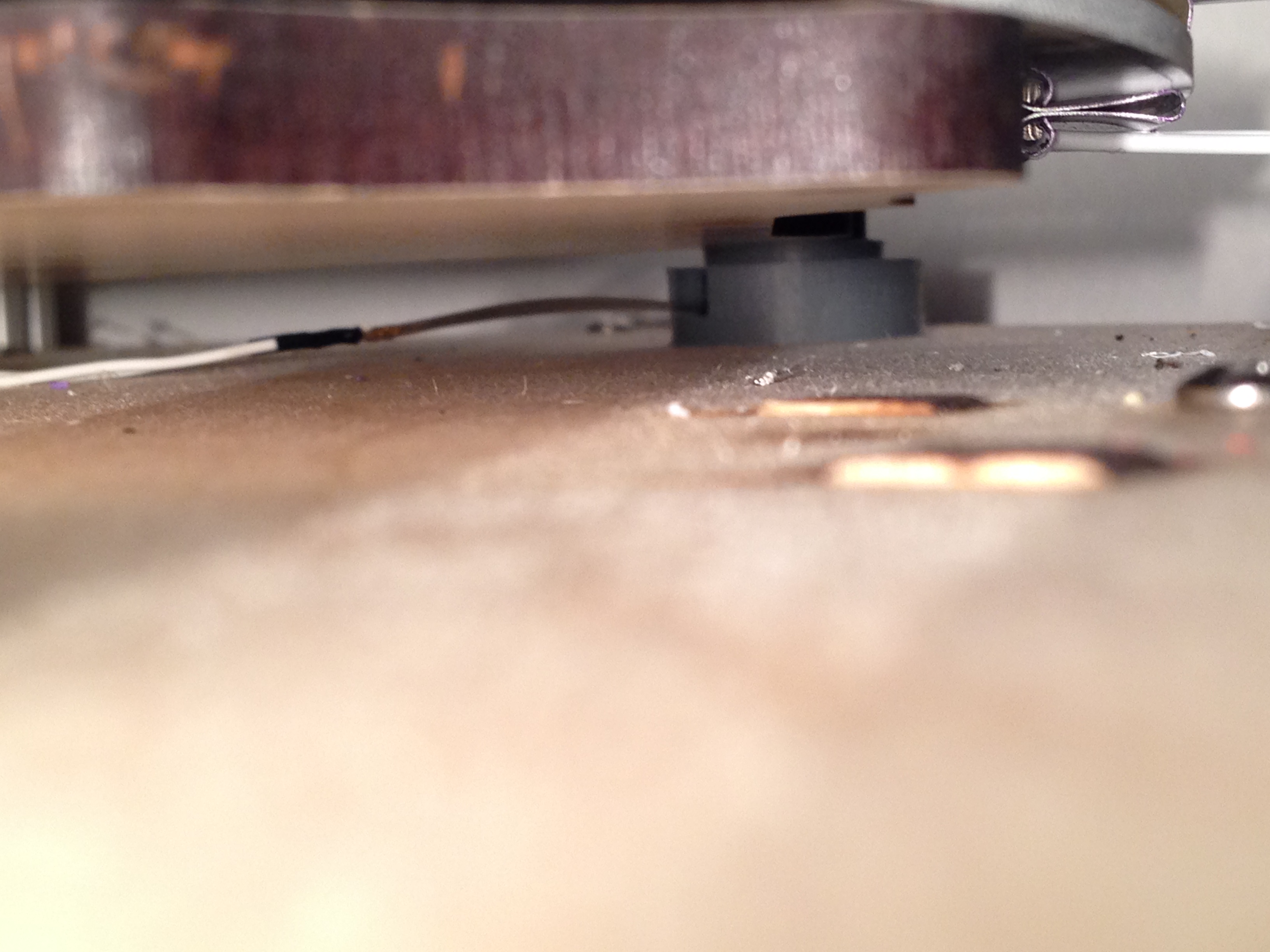

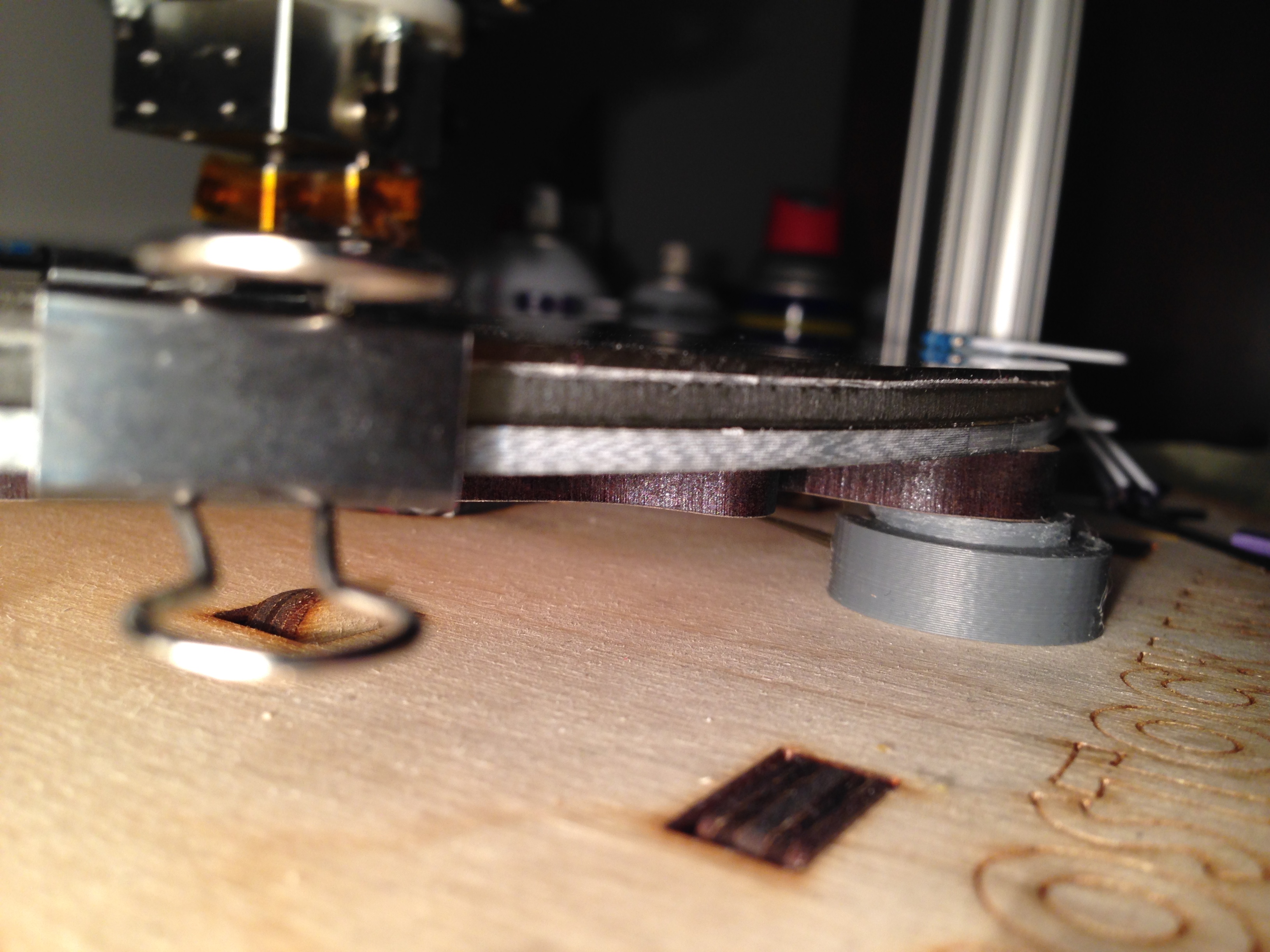

Yeah sure, but I can't get super indepth with everything, I have a print going atm. Basically those 6 small white Nylon(?) roller bushings used as spacers under the bed are replaced with 3 of these. Sorry for the sorta poor lighting. I have them positioned under the Melamine heat insulator in the same positions at the Mini Kossel has them I think.
Put in place
Put in place
Side view
Side view
This last one is an attempt to show how the FSR wiring comes out the cutaway part of the lower mount. Its back in the depths of the bed, so its hard to show properly.
Wiring hole
Wiring hole
Basically it all forms a sandwich, the lower part of the mount gets mounted to the base with countersunk #4 screws, the FSR goes on top of that, then the PLA puck goes on top of the FSR (to even out the less than flat surface of the upper part of the mount, it won't work without the puck). Then the upper part of the FSR mount goes on top with one of the Tee Nuts used to mount the bed on the base and the belt clamps on the cheapskates embedded into the bottom (make sure its either flush or slightly deeper set than the bottom of the upper mount). Then the whole rest of the bed assembly goes on top of that with one of the countersunk #4 screws holding the bed to the upper mount (you may have to trim the screw so it doesn't extend too far).
I hope that clears things up a bit. I was thinking of doing a guide of sorts but there aren't really that many steps. I might create a post in my build thread for installing these that goes into more detail though..
