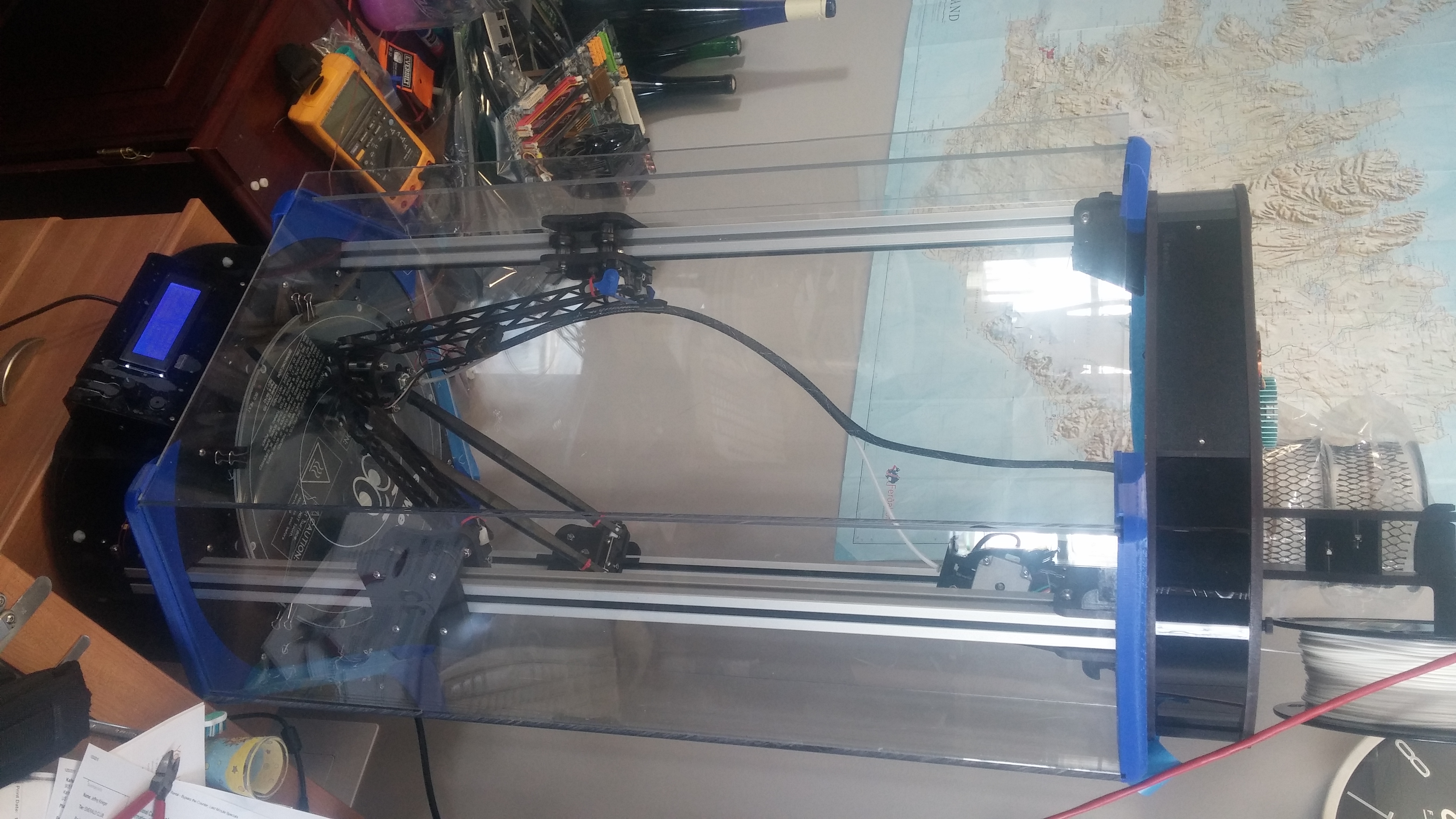

Nice looking enclosure. Have you had any problems with large prints ? I have a simular designed enclosure, and the panels come close to the heated plate. I was printing a piece of my halloween costume, and kept hearing a thump. Inspecting the item that was being printed I noticed some digits in the front of the item. After watching for a few min I realized that as the hot end was moving towards the front of the machine, the layer fan was hitting the door. Had to leave the door open slightly to avoid the bumping when printing large diameter parts.
Re: V2 Upgrades
I noticed the same thing on my first big print. I've re-designed the brackets to space the large panels about another inch away from the heated bed to provide more clearance. I'm not sure if the stock layer fan mount will still work, but I plan to design a new one in case I ever decide to print PLA (which I doubt). I'll post my models once I've ensured all the parts work up to my expectations.
Re: V2 Upgrades
I've uploaded the .stl for the clip I made to eliminate harness snags while printing large objects. If anyone is interested in the original file, let me know and I can upload the .prt file. I will also upload my larger enclosure brackets that prove enough clearance allow full build volume prints. The only thing that needs to be done is the layer fan needs to be moved in to provide a little more clearance between the X and Y towers.

Attached here is the lower enclosure bracket I created. It's quite long so you'll need good control of your build area. I printed the enclosure brackets two at a time. The lower brackets are an interference fit with the melamine and also require the bottom covers to be notched.
- lower_enclosure_brackets.stl
- Lower Enclosure Bracket (press fit)
- (3.39 MiB) Downloaded 452 times
Re: V2 Upgrades
Attached here is the upper enclosure bracket. These require small wedges to be printed in order to hold them in place. They will be included in my next post. I will update this thread to include a picture of what the finished enclosure looks like.
- upper_enclosure_brackets.stl
- Upper Enclosure Bracket (requires locking wedge)
- (10.2 MiB) Downloaded 613 times
Re: V2 Upgrades
Attached here is the small locking wedge that is required to secure the upper brackets to the top of the tower.
- upper_bracket_lock.stl
- Locking wedge for the upper brackets
- (72.93 KiB) Downloaded 607 times
Re: V2 Upgrades
Here's a picture of everything assembled. I still need to come up with something to seal the rest of the plexi to the bottom sheet of melamine. I also need to cut the last piece of plexiglass so I can get some temperature readings with everything assembled.
