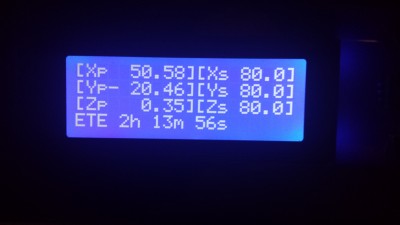

I've replaced my Totals Page with XYZ positions on my orion.. I didn't see the need for instant access to time printed and filament used totals (which is calculated incorrectly anyway... well on mine it's miles out) and you can access these values in Repetier Host and MC easily if you want to. Actually XYZ is really useful info to have to hand....
So this is what I've got so far: just spent 20 mins so got some place holder text/values next to the X,Y,Z positions (placeholder stepper values all reading 80mm atm) but I think I will repeat
Bed/Nozzle and layer fan on this page also in place of them.. not sure yet. I also repeated the Current Status on the bottom line.
XYZ Replaces Totals Page
Code for the above is in the uimenu.h (line 192 or there abouts)
I changed it to:
UI_PAGE4(ui_page4,"[Xp%x0][Xs%Sx]","[Yp%x1][Ys%Sy]","[Zp%x2][Zs%Sz]","%os");
Or without the place holders for XYZ stepper mm and just the XYZ positions it's:
UI_PAGE4(ui_page4,"[Xp%x0]","[Yp%x1]","[Zp%x2]","%os");
%x0 = X Position
%x1 = Y Position
%x2 = Z Position
%os = Status (e.g Orion ready, Heating Bed etc)
Original Code was:
UI_PAGE4(ui_page4,UI_TEXT_PRINT_TIME,"%Ut",UI_TEXT_PRINT_FILAMENT,"%Uf M")

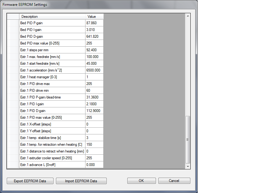

I've personally had difficulties in setting Eeprom values from within the firmware and resorted to setting them from Repetier Host: (Press ALT-E or select from menu):
Eeprom Values - Change at your own risk

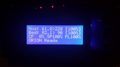

I've had a tinker this morning and finalised what I want on my Second Menu. Seemed sensible and logical to display Bed / Nozzle Temps & Layer Cooling fan on the same info page as Z position (height) as these are variables you can change wrt which layer your printing... even though it's repeating info from the main menu screen
New Info XYZ Pos Noz/Bed Temps and Layer Fan % page - replaces Totals Menu
Modified replacement Code for this on or about line 192 in uimenu.h is:
UI_PAGE4(ui_page4,"pX%x0 Noz :%ec","pY%x1 Bed :%eb","pZ%x2 CFan: %Fs%%%","%os");
