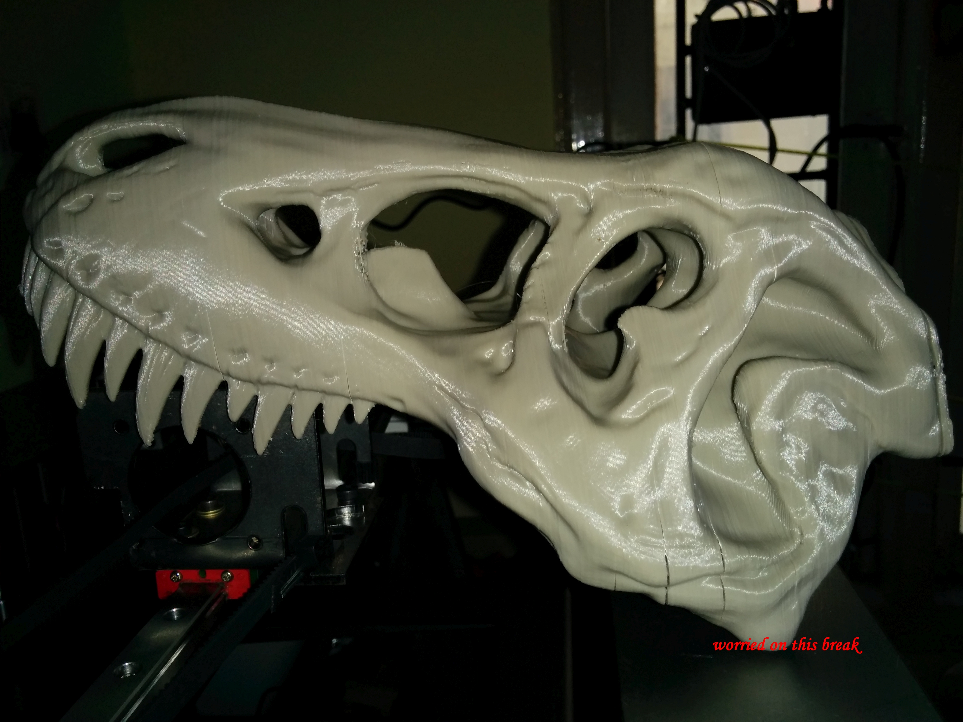

Hello Experts Here,
I did my bigger print today after calibration, Im happy to see, it came well, while I want some your expert suggestions for any more improvements.
Also, Im worried about the breaks in between.
Its Printed on ABS
Bed :90 degree
Hotend: 228 degree
Adhesive: Glue Stick
Slicing with Slicr3 and SeemeCNC profile.
Regards
Pingnagan P :)

If your ABS is delaminating (cracks between layers) you need to bump up the temp a bit. Probably around 235 or so should be alright.

A wally-world shower curtain enclosure worked miracles for me when I had similar issues. I do agree though I usually run my prints at 235-240.
