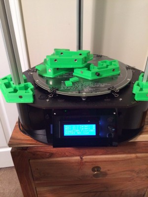

Some pictures of the first printed parts....(it looks pink in some of these phone pictures, but it is actually quite red)
[img]https://farm4.staticflickr.com/3951/150 ... c25c_b.jpg[/img]
[img]https://farm8.staticflickr.com/7505/155 ... 1507_b.jpg[/img]
Getting some weird banding as Z-increases.
[img]https://farm8.staticflickr.com/7511/156 ... 0c94_b.jpg[/img]
Printing the top mount...
[img]https://farm6.staticflickr.com/5610/155 ... cdd9_b.jpg[/img]
[img]https://farm6.staticflickr.com/5604/155 ... 5e83_b.jpg[/img]

Those are already great looking parts. Interesting ridges in that 3rd picture though.
Can't wait to see how your prints improve with the build chamber!

What are those vertical ridges from? They look to be repeating every 20 or so layers which seems like a strange thing to occur in a machine without a lead-screw. My v2 has some very small ridges every 10 layers ever since I took it for a ride in my car :/
Re: Enclosure build to print ABS and Nylon bigger and faster
ive seen ridges like that in inconsistent filament diameter...
Do you have a "bump" in one of your cheapskate wheels?McSlappy wrote:What are those vertical ridges from? They look to be repeating every 20 or so layers which seems like a strange thing to occur in a machine without a lead-screw. My v2 has some very small ridges every 10 layers ever since I took it for a ride in my car :/

I changed a lot in the past month. Full recalibration of my machine to achieve better bed flatness and 20mm test cube dimensions (bed/hotend PID values, tower rotations, arm length, belt tension, cheapskate etc etc), updated firmware from 0.83 to 0.91, updated software to v1.0.6, changed from Slic3r to KISSlicer, and moved to new filament (IC3D 1.75mm abs). Due to all these changes I am now printing much bigger objects with much denser infill than ever before. Also due to all these changes...tracking down this issue is going to be difficult but I'm working though it.
To muddy the water even more....here a few close up pictures of parts that tell a story that basically goes nowhere in my mind.
Here are two lower enclosure mounts...both were printed on different days with different slices where the only difference in slice settings was perimeter goes from inside to outside on one and outside to inside on the other.
[img]https://farm6.staticflickr.com/5613/150 ... f2bf_b.jpg[/img]
Here are two pictures of the upper enclosure mount...notice there is vertical banding on the thin section that is at a "finer pitch" than what is seen on the thicker lower mounts, BUT there is no banding at all on the upper section of the part.
[img]https://farm8.staticflickr.com/7463/155 ... 344f_b.jpg[/img]
[img]https://farm8.staticflickr.com/7514/150 ... 8b37_b.jpg[/img]
Now lets muddy the waters even more...the second lower mount was printed after the upper mount, so I'm not sure variance in filament diameter tells the story.
I posted this issue to the KISSlicer google group thinking it was a slicer problem, but most people don't seem to agree.
https://groups.google.com/forum/#!topic ... o86SEuZ17w
My cheapskate wheels have always had several small bumps in them, but have never seen any performance issues because of it. Also I highly doubt there is any damage to my machine since it has literally never left my desk since I built it a year ago.Jimustanguitar wrote:Do you have a "bump" in one of your cheapskate wheels?

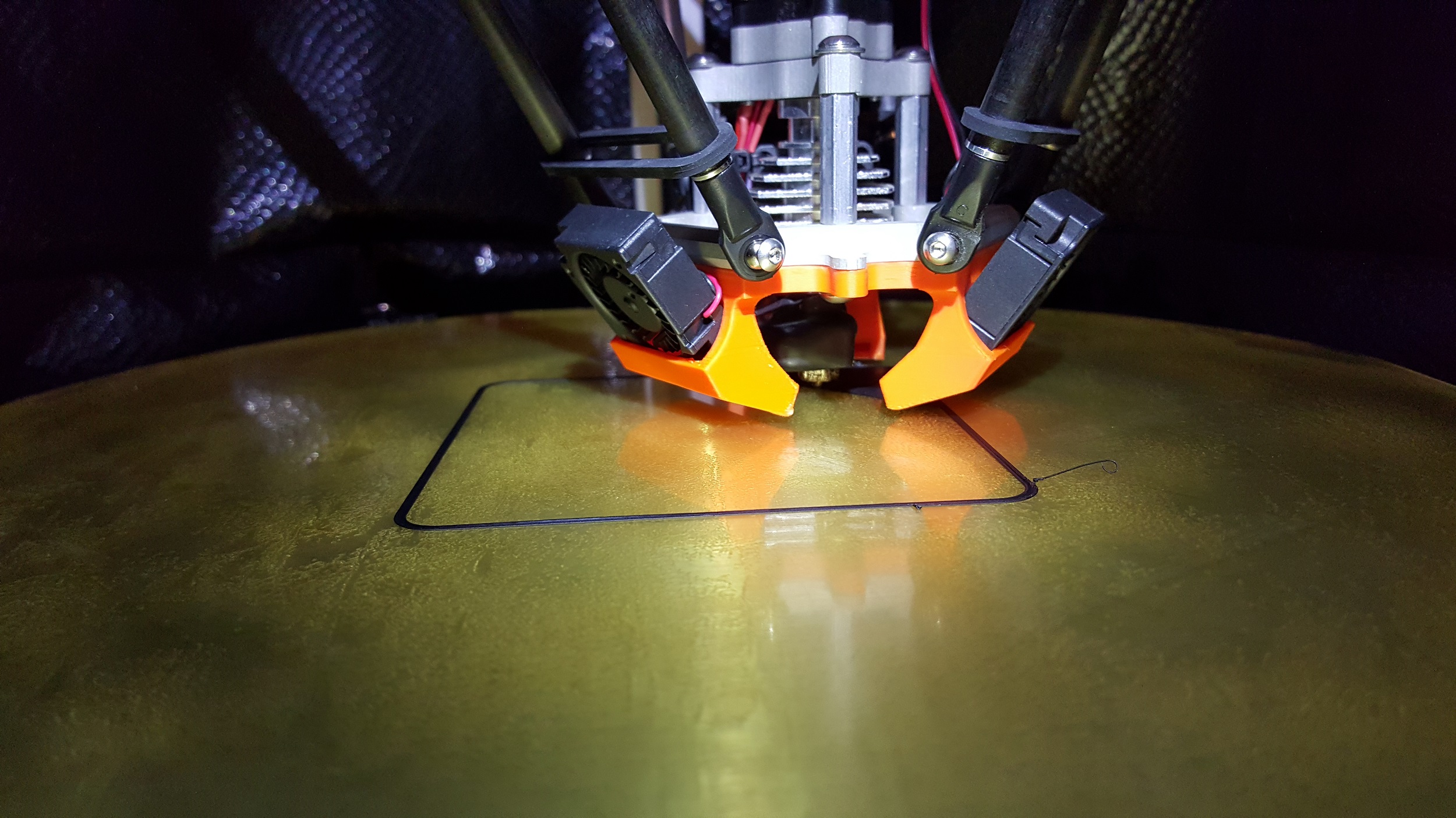

Finally got all 3 upper and lower mounts printed...all are looking pretty good with just a bit of banding. I'm 95% sure at this point that it is something to do with my heated bed having difficulty maintaining 90C.
[img]https://farm8.staticflickr.com/7493/155 ... b587_b.jpg[/img]
Getting close in on the details....
[img]https://farm8.staticflickr.com/7562/155 ... 9e85_b.jpg[/img]
[img]https://farm9.staticflickr.com/8257/157 ... 1b8d_b.jpg[/img]

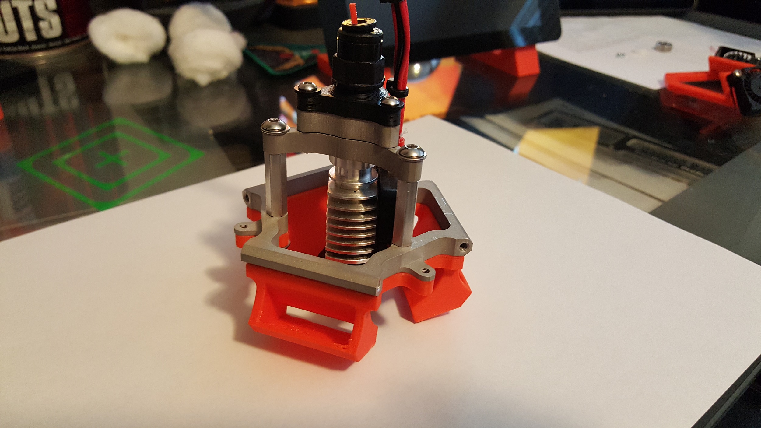

Got all the heat-set inserts installed and will hopefully be finishing it up this weekend. Still trying to decide if I want to spend the money on 1/4" acrylic panels for the entire enclosure or if I want to do painted wood with acrylic windows (would be MUCH cheaper).
Anyway on with the pictures...
Heat-set insert installation tip installed in my 40W soldering iron. Setting "4" on the iron seemed to work well.
[img]https://farm8.staticflickr.com/7580/151 ... c98f_b.jpg[/img]
Pre-loaded inserts into the first top and bottom mounting bracket. Holes are a little undersized for these inserts, but a bit of extra heat fixed that problem.
[img]https://farm8.staticflickr.com/7466/151 ... 2096_b.jpg[/img]
First set of inserts installed....really gives printed parts a more professional look.
[img]https://farm8.staticflickr.com/7580/155 ... e632_b.jpg[/img]
All mounting brackets complete with heat-set inserts...
[img]https://farm8.staticflickr.com/7570/155 ... a515_b.jpg[/img]
