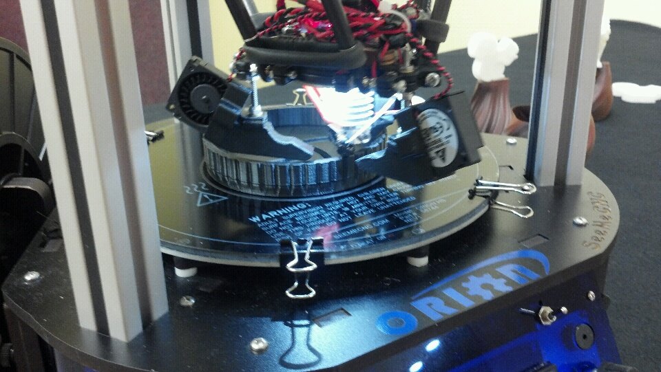

by bvandiepenbos
nice fan shrouds.
Another option is extending the stock SeeMe blower shroud down with a piece of M3 threaded rod or long bolt.
That is what I did one my Orion as a "quickie" ...but it works good, so it will likely stay that way.
I also like the ability to turn fans side to side to direct air in just the right location and to avoid cooling heater block.

bvandiepenbos wrote:nice fan shrouds.
That looks like an interesting concept Brian. Which of the many layer shrouds did you end up using?
EDIT: Are you running the E3D V6 on the Orion? It is hard to tell from the picture.
