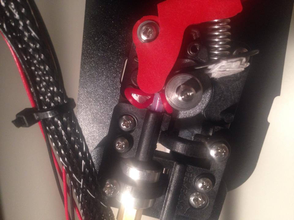

15mms is what i'm trying to run it at. I'll see if I can post some pics.

Anyways don't mind the ghetto rigged temporary fixes like the paper stuffed in random places and scrap filament shoved into the extruder LOL.
I started out with just the single mod talked about in the thread linked above. That didn't work so I did a few more things to solve more problems and now my latest problem can be seen in these pics.
This is killing me...
Should I buy a different extruder?

Looks like you don't quite have the tube right up against the gear, perhaps if you get the tube a bit closer it will work even better. Also you seem to be over tensioning the filament with that paper spacing, you might be squishing it (and since the motor/gear gets hot, it gets softer) to the point where it is thin enough to squeeze out of the path.

not sure if its something you can see in my pictures but the tube was actually up against the gear and idler, i couldn't believe how close i got them, they were actually rubbing but it didn't affect the drive gear so i left it rubbing.
somehow it STILL buckled like that which really surprised me.
it doesn't do it during normal extrusion speeds but 1/4 or 1/2 through the print it will do it definitely.

I was looking at the first picture, didn't notice your finger pressing the lever down. I looked at the 3rd picture and I see how close the tube is now. What speed are you running at? I think the recommended normal speed is around 10-20mm/sec, I know its slow but maybe start there (if you aren't already there). Do you have the stock hotend that came with your printer? What retract settings are you using?
