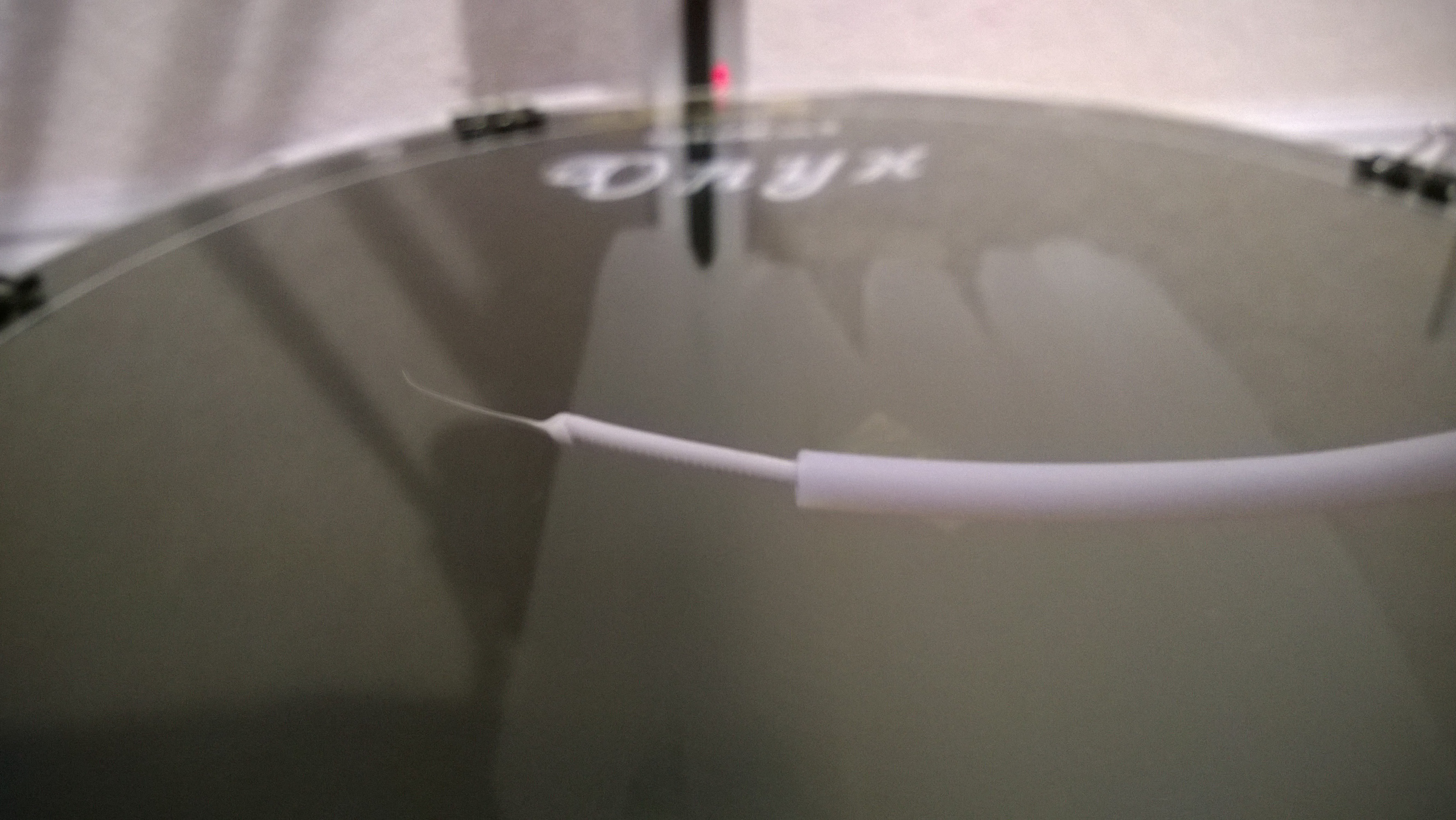

After getting it to extrude for a brief moment before it started grinding on the ez struder I pulled out the filament and it looked like this
For those curious that filament length is ~20mm from the PTFE tube to where the filament tapers.
I measured how long my Tube is extending down into the extruder and measured it to be 36mm. I measured this by taking a marker and drawing a line on the first exposed part above the small black plastic bowden fitting on the extruder. I then removed the tube and measured the length from that line to the end of the tube. At that time the filament was unable to extrude at all, and stuck out of the end of the tube by ~10mm.

After further testing it looks like that nozzle might have been a little on the small side, or possibly clogged still. I noticed that if I cranked up the heat to 247C with my ABS in the nozzle it would extrude about 50% of the distance expected and then have a ton of oozing after. This was indicative of pressure building up but the filament having nowhere to go.
After switching the nozzle with one off the second extruder it has printed fine. I have done two prints, the second of which I did no prep etc to the nozzle before starting the print, just set it up and let it heat up, so I am cautiously optimistic that it is fixed.
