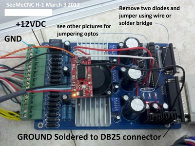

Anyone updating the RepRap wiki page, is welcome to transfer any of this information. As of this posting date, we have begun shipping 4 axis control boards to make connection easier.
Using the 3 axis board with EasyDriver (4th axis), copy this file to the mach3 installation directory on your computer:
http://seemecnc.org/assembly/Slic3r%20Profile.xml
After putting this profile in the Mach3 installation folder, start Mach3 using the "Mach Loader". You will see "Slic3r Profile" in the list, click on it, Mach will start and all the settings will be correct.

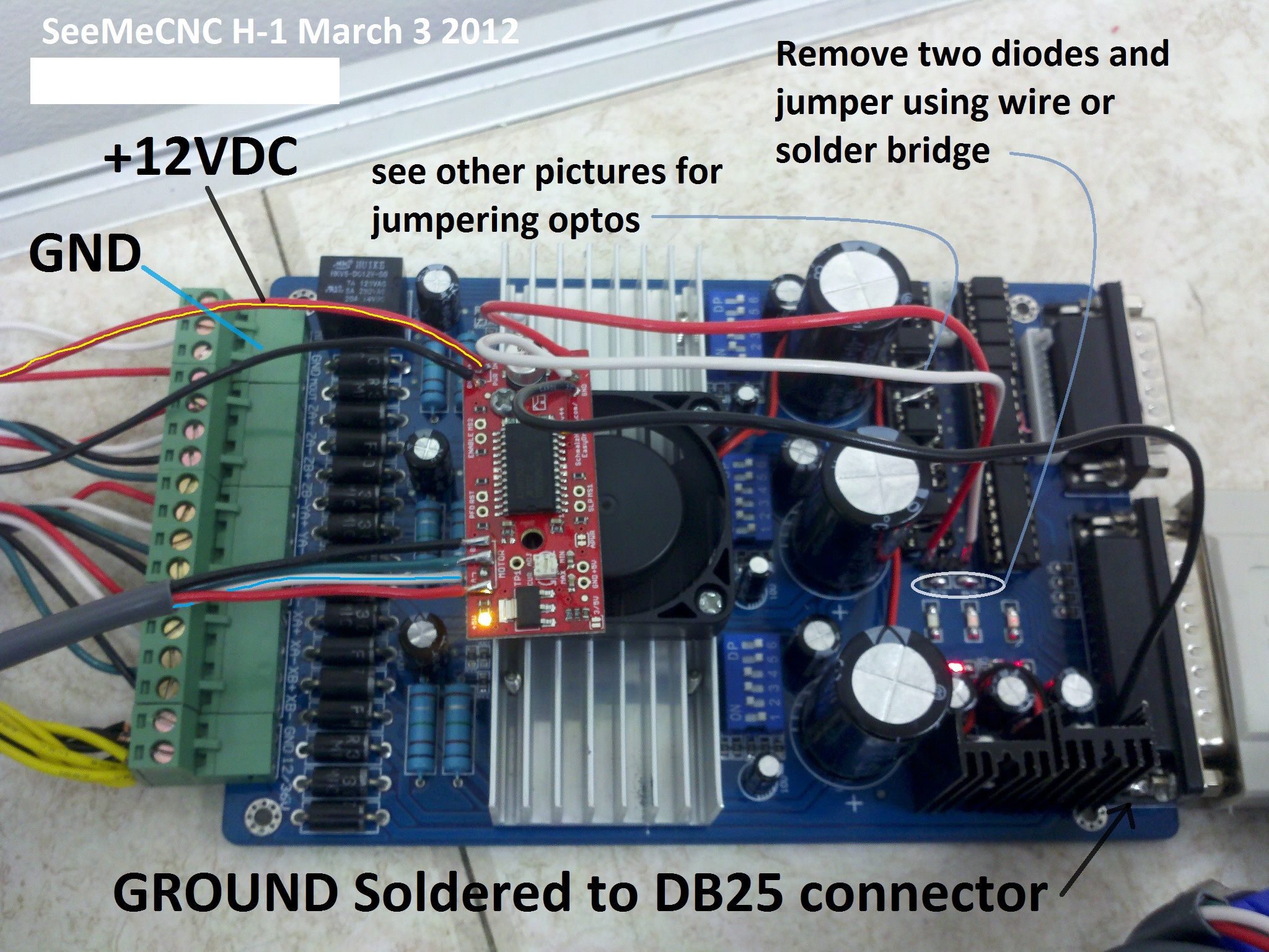

Here's a photo of the 3 axis board with easyDriver and wiring. This photo is also at http://seemecnc.org/assembly
SeeMeCNC H-1 3axis board with easyDriver wiring

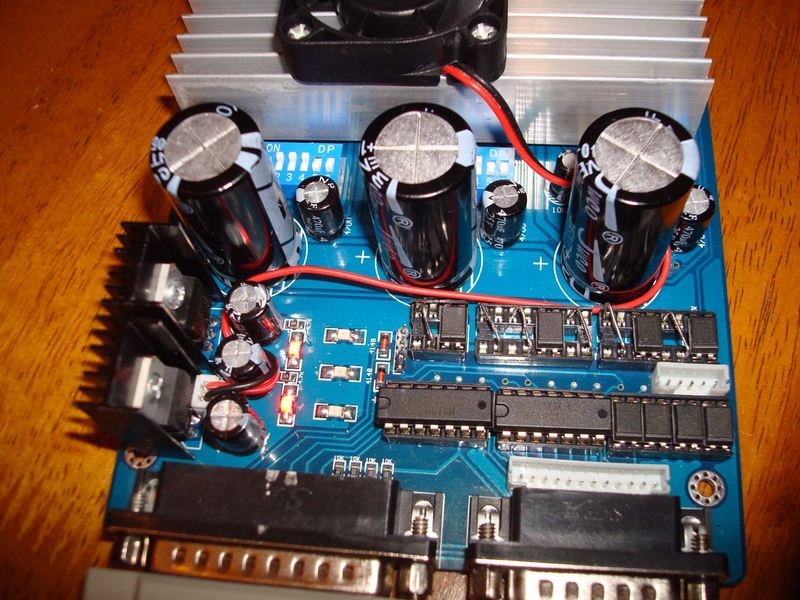

ElectronRanchers photo of jumpered opto-isolators. Reference to Matt's Misc Photo album on the "SeeMeCNC YaHoo Group".
ElectronRanchers "SkewFixMod2" 3 Axis Board Jumpers
