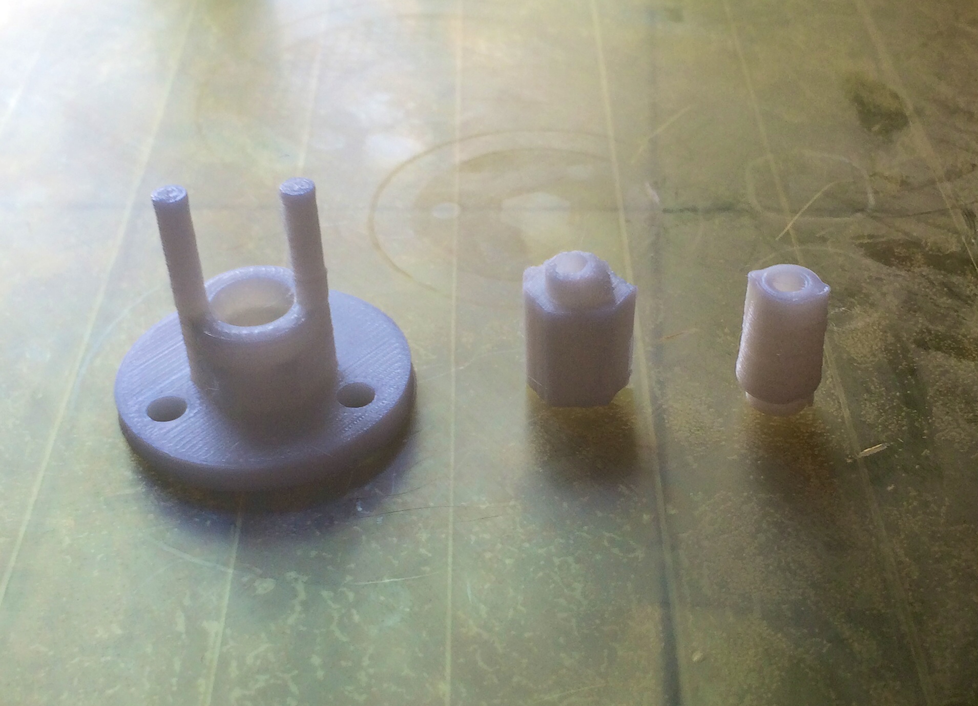

Ok, first up is the parts we need to print. There are 3 of them on the GitHub. I just confirmed with John how many we need of each:
Anti-backlash nut: 1
Bearing Bushing: 6
Eccentric Bushing: 4
John recommends printing a few extras of each of the last 2. I'm printing at 50% fill in PLA and they are coming out great. I'll post a photo when complete.

YES, MAKE SURE you print the parts in PLA not ABS, as the resin can break down ABS parts if it gets soaked in the resin.

Printed the parts. They look tiny but hey!
https://cdn.mediacru.sh/b2lnwYRpoAw1.jpg

Folks, I initiated a discussion in the email list of beta users on a problem with one of the STL files we need to print.
John, I noticed that there may be an issue with the STL for the eccentric bushing. It prints a small "pad" for the first layer and then prints a longer layer for layer 2 that extends out over air.
I opened the STL in my CAD and discovered that the bushing is not laying flat on the X-Y plane. I've corrected the STL and it is attached here.
FIXED 78704 R4 Eccentric Bushing.STL
(82.6 KiB) Downloaded 880 times
