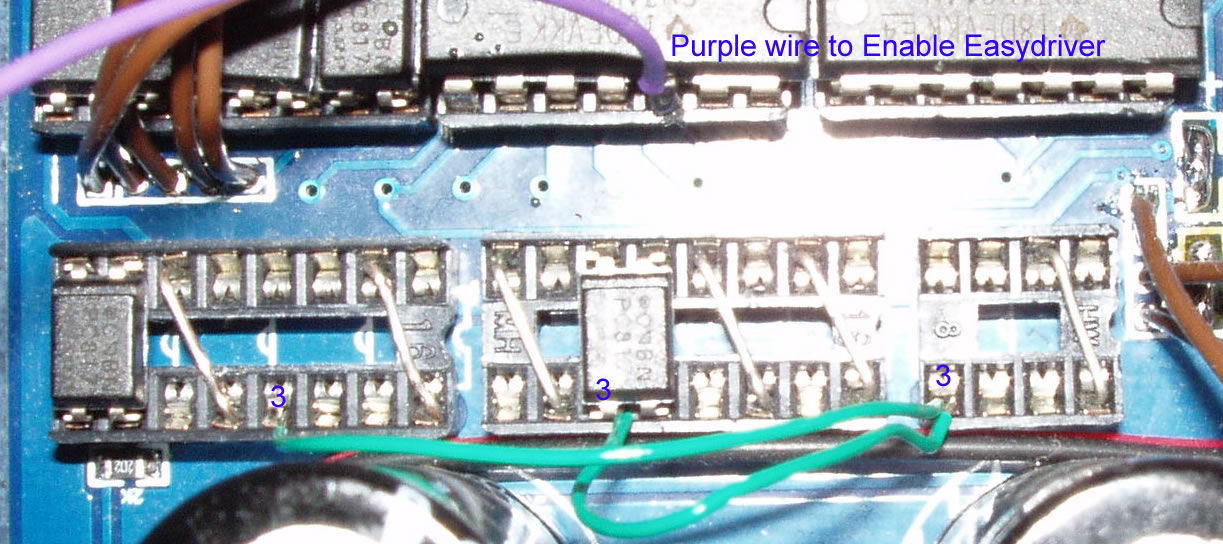

I just made a fast and dirty modification so all the steppers will be enabled with the "Amplifer" output from CNC2. Only pin 2 is now in use - the other two enable pins can be ignored. Now all the steppers is turned on and off with the "power button" in CNC2 - even the easydriver. Nice to get rid of that noise from the steppers when they are not in use.
