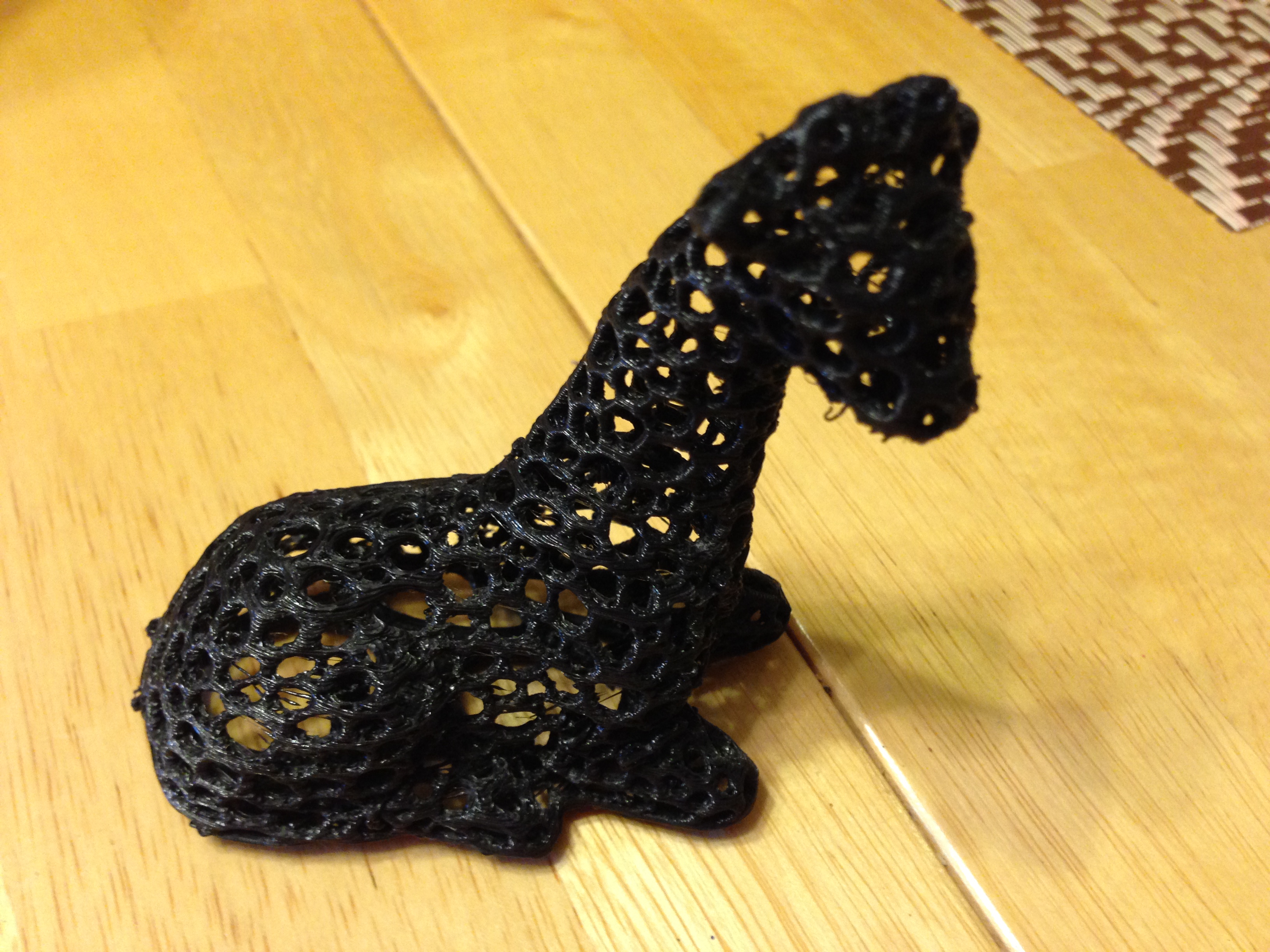

First to get the upgrade was my V1 Max. As a test print I did this little giraffe. http://www.thingiverse.com/thing:149311
While not the greatest print the fact that it printed on all as my first item with the new hot end was impressive to me.

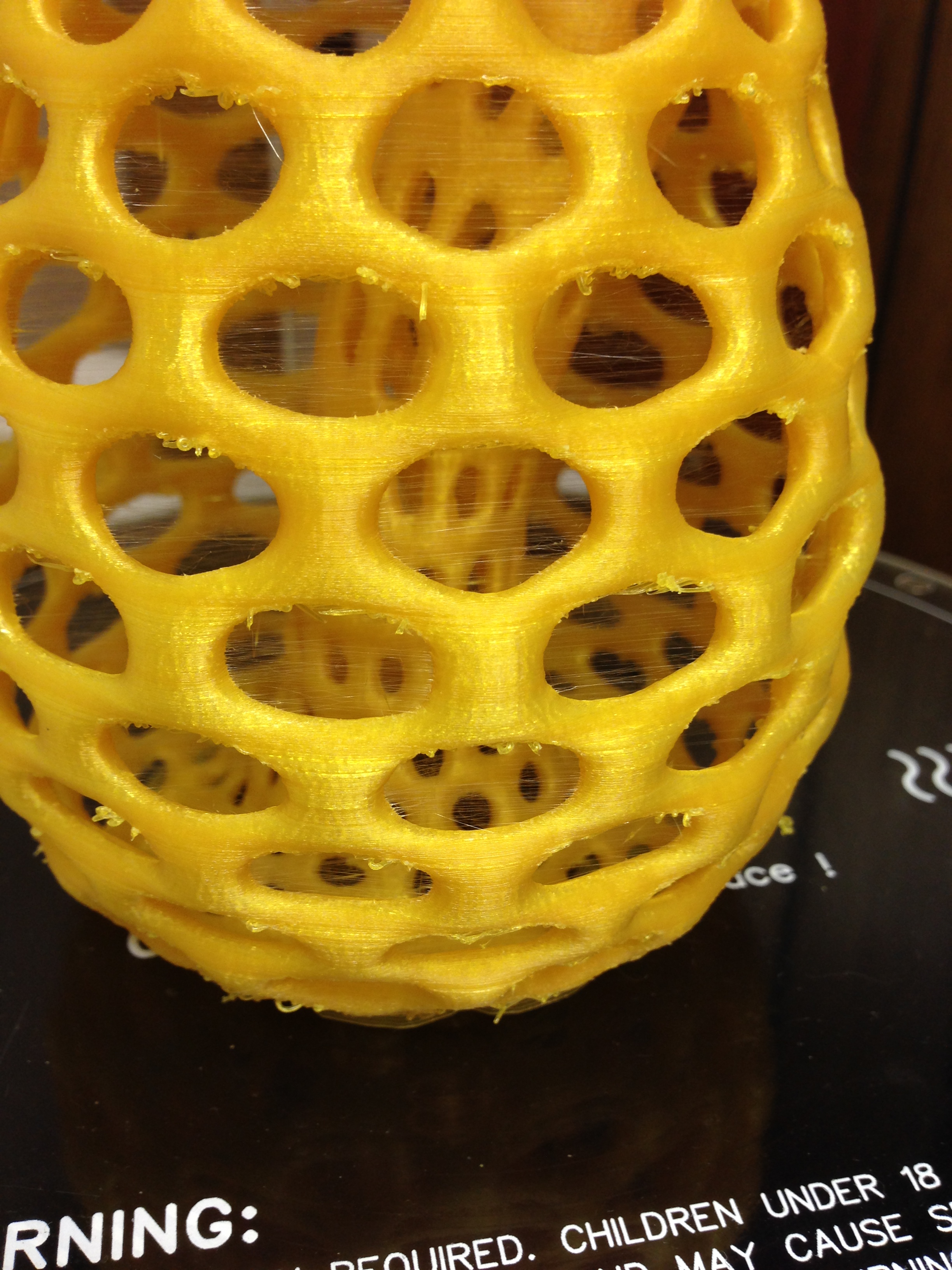

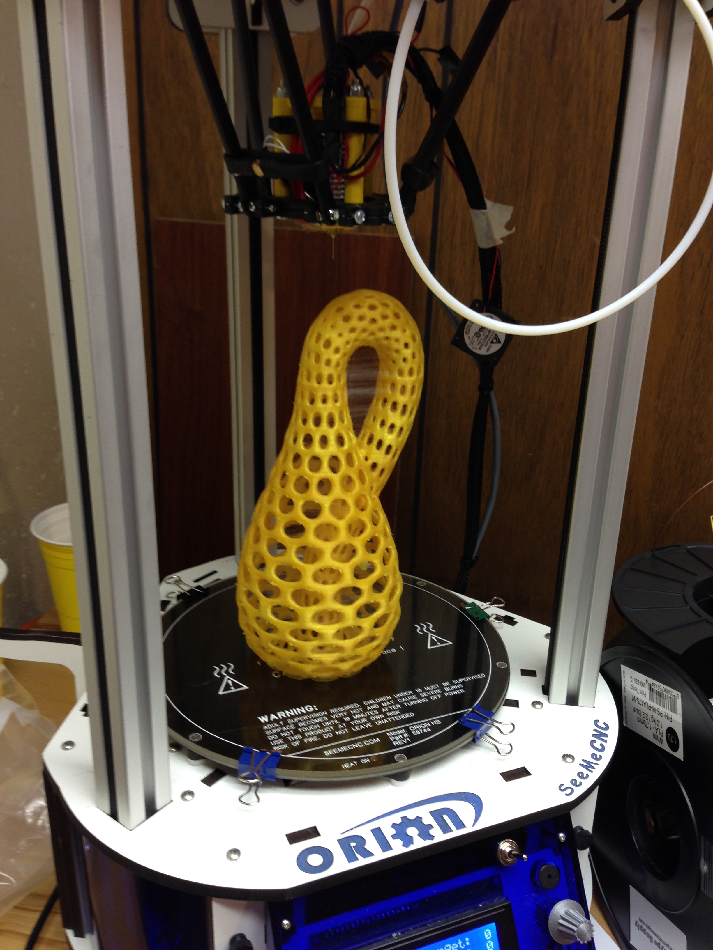

Next came the Orion upgrade. I had printed this Dizingof Klein bottle on my Rep2 on my first try about a year ago. I had tried a good 20 times to print the same model on my Orion with complete failure. While I had many issues the stock hot end was definitely one of them, it would just start air printing after a while. With the E3D V6 this is what I got an attempt #2 (attempt 1 had a slicing mistake).
This in general is a brutal print with the retracting/overhangs and I was very pleased how it came out, especially without a layer fan. This print took 20 hours so no heat creep issues.

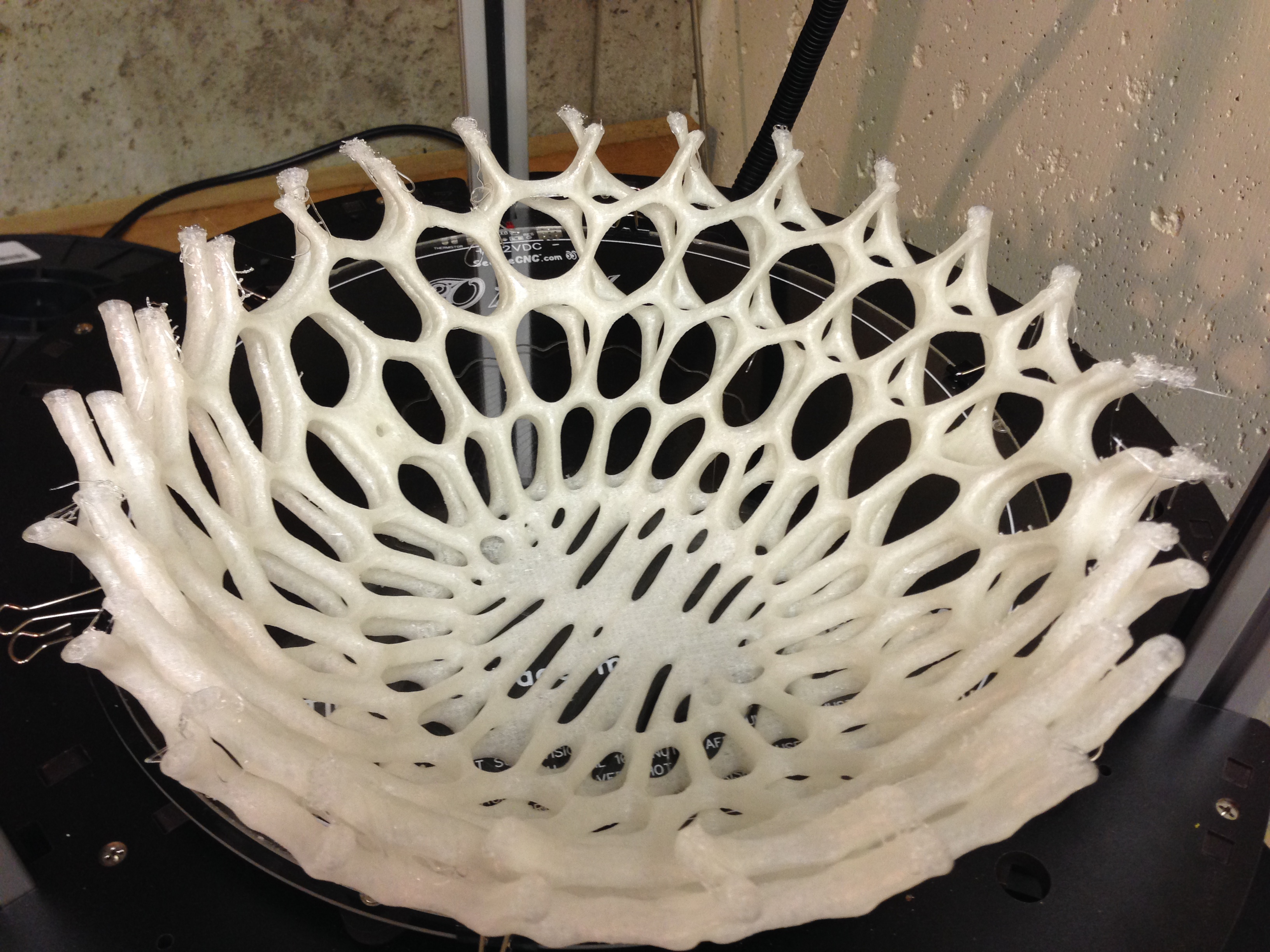

Final example is a failed print but not because of the hot end but because of it detaching from the build plate (was supposed to be a mega Dizingof sized cell bowl).
This print had been going for over 24 hours when it detached. Again a very challenging print that was printing great, and with natural which tends to be a little more difficult to print.
