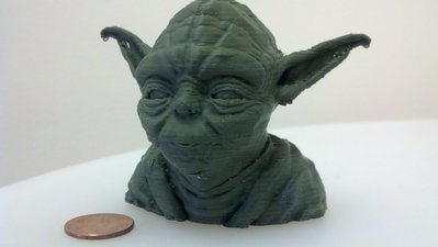

0 infill, 4 perimeters no support, I just ran it through Slic3r and printed.
Printed surprisingly well considering some of the overhangs, when you watch it print it's clear that support would be nice and at least some infill would correct some of the flaws.
I couldn't get Slic3r's support for this model to stick to the table, it's so small, and skeinforge generated extremely odd infill, so I printed it without.

That looks really good for no infill. I may try that on my next large print to see how it goes.

The only places that really suffer for lak of infill are the very top of the head, and the top of the shoulders, and the inside of the ears, but I was stunned how well it came out considering
He even has nostrils, and without the infill it was a relatively "fast" print.
Certainly the biggest thing by volume I've printed.

What flaws? for no support of infill that looks fantastic.
