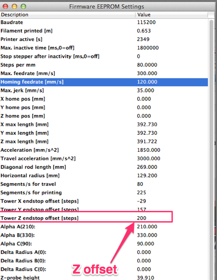

4. Get current value placed in EEPROM "Tower Z endstop offset [steps]", then, and add this to the value from step 3. For the first iteration, the original offset value would be ZERO. However, in the following calibrations, this value would be the previous offset entered. I was in my second calibration, then the original offset was 200 steps
current Z offset value in EEPROM
The new offset value would be:
200 steps (original offset value) + 17.6 steps (current offset) = 217.6 steps (new offset)
Store this new offset in the EEPROM variable, overwriting the original value.

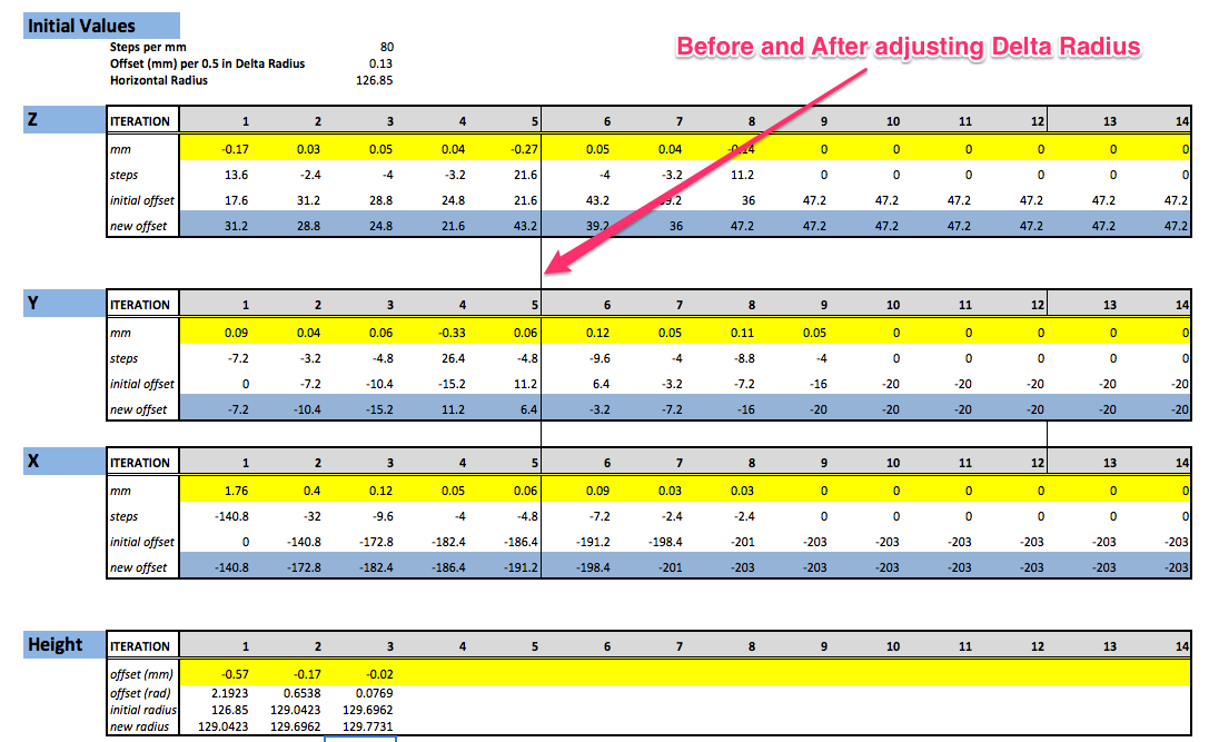

5. Re-run Script for Tower Z, and re-asses the offset. It should be zero, or very close to zero. If it is not zero, then get the offset value in mm (as in point 2) and then convert it to steps (as in point 3) and re-calculate the new offset value, as in step
After Tower Z is OK, repeat the same points from 1 to 5 for Towers Y and Z.
6. Now, run the Script 4 (or simple G28 followed by G0 Z0) to get the Z-height. As you know, it could be above or below 0 (NEVER zero :-) ). Use the "Z position" from Advanced Settings menu to get the offset value in mm. Write this value down, will be used in step 8.
Now, as explained in Geneb's manual, you have to modify the value in the EEPROM for "Horizontal Radius [mm]" by 0.5 (adding or subtracting it to the original Horizontal Radius).
7. Get back to re-calibrate the towers, but this time, you do not need to adjust one by one. You can get the three offset values first, and then enter all of them at once in the EEPROM (remember to invert the sign and to add this value to the original offset value in the EEPROM). You can do it one by one, but if you do it at once you can time.
8. Get the new Z-height (G28 + G0 Z0 or script 4). If not zero, then get the current offset (again, using "Z position" option). Then, get the variation in offset from the original one (from step 6), and the new one.
Delta = Z offset Step 6 - current Z offset (Important, get the absolute value => NO SIGN!)
Use this delta to calculate the new new Horizontal Radius:
New Horizontal Radius = (0.5 * current Z offset) x Delta
NOTE: this DELTA value is the mm that your nozzle will move with 0.5 variation in "Horizontal Delta Radius", it is important to write it down, as will help you to speed this process in the future.
9. For me, it was all, at this step my bed was flat.

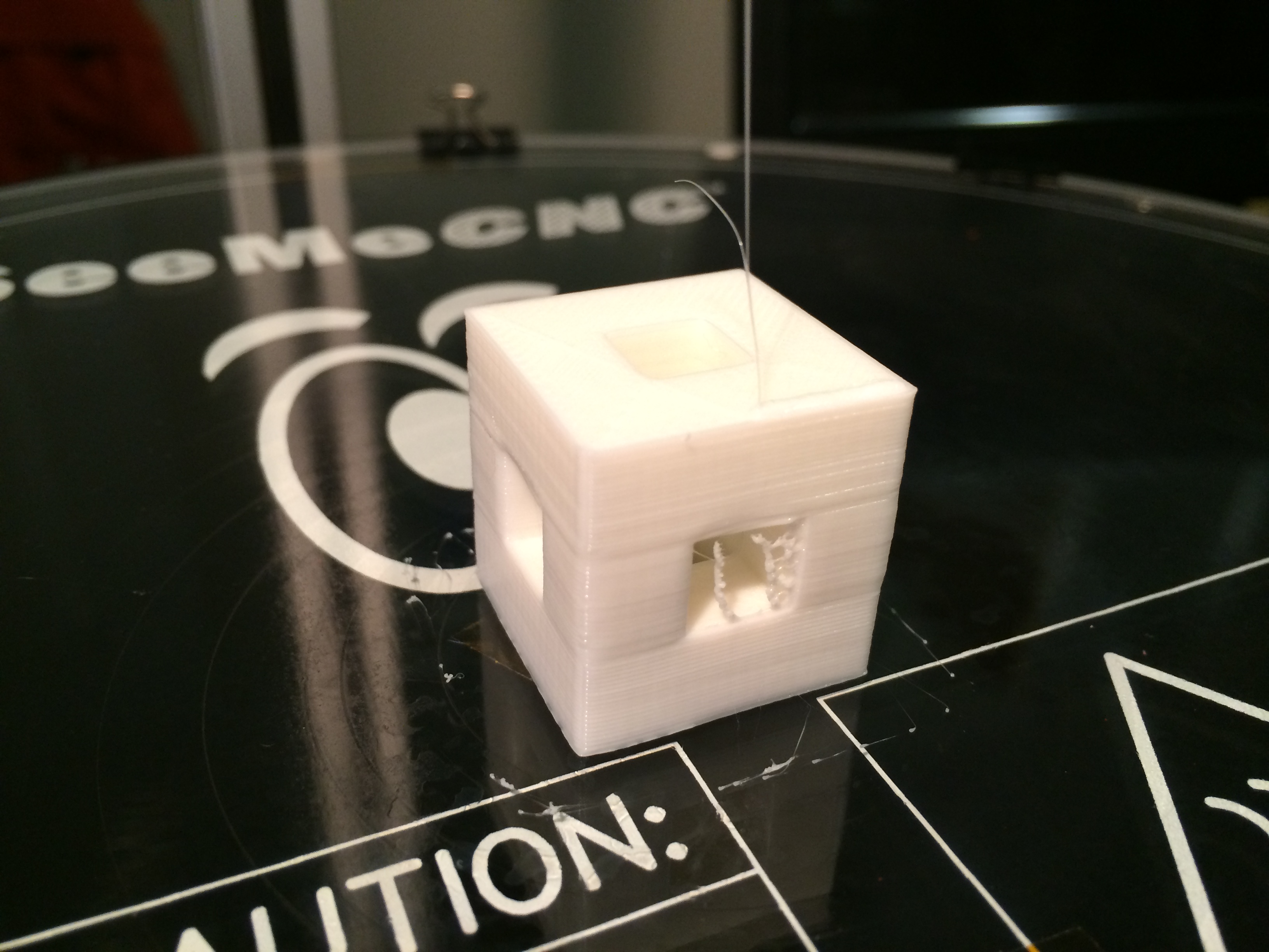

I just finishing a second print (actually, the third, as the second ended when I tried to read the EEPROM to while printing :-) ). This calibration print was the larger one, not only 200mm as the first posted. You see two points were the print is messy, but believe me, it was due that I didn't spray enough aqua net, as the first layer (0.2mm at 100%) was printed perfectly over the entire bed!
New print calibration
and, here is the calibration cube -third print!- (25mmx24.95mm x 25.06mm):
Holly Cube!
Holly Cube!
Not bad For sub 30 mins calibration. I am loving my Night Fury!! ;-)

Check your X tower offset.
I am still checking but it may be that it ignores negative values.
*** EDIT.
I used your method to calibrate my Rostock. Something had gone terribly wrong with my initial calibrations. The z height was off by 5 cm. Yet it still printed but proportions were off by %1 in x and Y and %10 in Z.
On my machine, the offsets only accept positive values. Putting in negative values is perceived as 0 by the software.
THANKS A LOT!

teoman wrote:Check your X tower offset.
*** EDIT.
THANKS A LOT!
Glat that it helps!
It is weird that your machine does not accept negative values. It should be the firmware, for sure. I am using (as I wrote in the previous post) Repetier Firmware, 0.91. Probably you are using 0.8x
Re: Easy "Manual" ZProbe Calibration
Posted: Fri Aug 01, 2014 12:34 am
by artexmg
*** EDIT.
THANKS A LOT!
Ah, by the way, I said I would share my spreadsheet, here it is.
Rostock Calibration Spreadsheet V0.1.xlsx
(18.15 KiB) Downloaded 1055 times
Is silly, nothing complicated to do, but it helps me to get the thing calibrated very fast, 30 mins max, if I want to get fancy, down to the 0.01 mm :-)
You will need to change the initial values for your printer (Steps per mm and Horizontal Radius). My both printers have a "ratio" of 0.13mm per every change in 0.5 in Horizontal radius, so, you can start with this value. This is how it looks when you start
Before calibration, all offsets are zero.
Then, you just have to enter the offset in mm, you will get the "new offset" value to set up in the EEPROM, script, get offset and repeat :-) This is how it looked in mine after the last time I used it
Screen after calibration is done.
As you can see in this pic, I have a line in the spreadsheet. I put this only to get to know when the towers were aligned BEFORE I started changing the Horizontal Radius.
Once you get the three towers aligned and ready to modify the delta radius, you will use then the offset in mm in the "Height" section. It worked for me :-)
Cheers!

by artexmg
teoman wrote:I should have the latest version of everything. Printer bought in June and I started assembling it on the 15th of July, downloaded all software on the 20th or so. Still printing the fan shroud.
It puzzles me that you cannot use negative values, if the firmware is the same, then the behavior should be the same.
Anyone there who knows if there is a setting to allow negative values?
