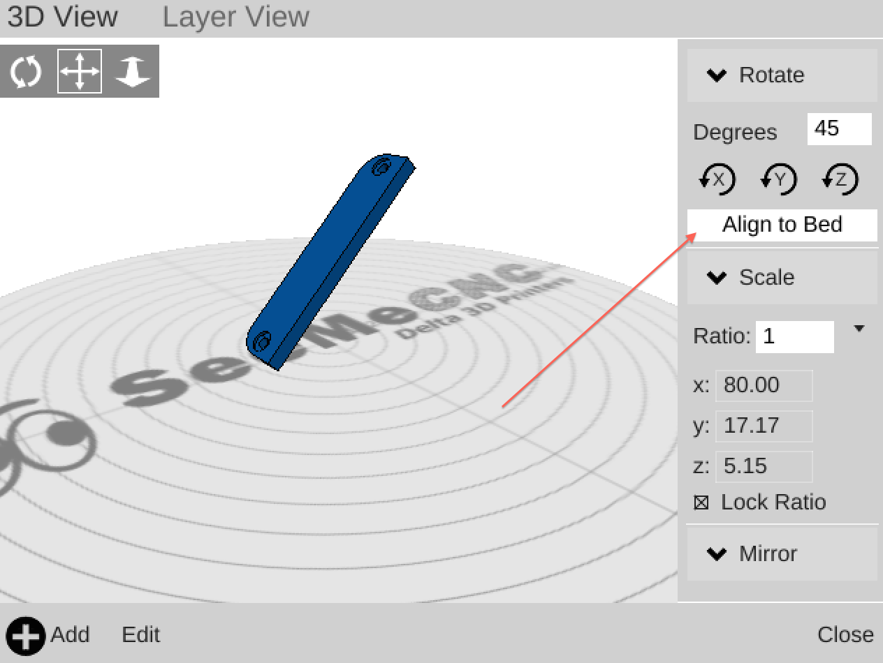

I am trying to change this print so the long neck lays on the print/heat bed to save on the need for support material. I don't understand how to do it. I am trying to rotate it but I can never get it there. Can someone assist and walk me through it. I would actually love to print this out through Matter Control since I am trying to do it in PLA for the first time after numerous ABS fails.

You've probably sorted this out by now but I had a look out of interest and the object was drawn at a 45 degree angle hence
why in Repetier changing X and Y Degrees under the Object placement tab [Rotation] icon caused it to spin around this plane
hence why it seemed to not orientate logically.
I imported it into Tinkercad and it was easy to reorient it, download as .stl and opened in Repetier in the correct orientation
(or whatever orientation you want to make printing easier).

I tried it last night but couldn't get it right but another look and within a minute I had one combination that works: X = 270, Y = 45, Z = -90.BONE wrote:Try using -45 instead of 45. I've found that by placing a negative sign flips the way the part is rotated. Or you could try different versions of 45 degrees, like 135, 225, and 315. Make sure you rotate about the correct axis, and if you make a mistake, undo that last move. Making a series of mistakes will only make it harder to get back to the way you started with.

Re: Changing position on heat bed
The rotate buttons on MatterControl work rather nicely.
There is also a align to bed feature. And that is like "dropping" the part on to the print bed so that that side lays flat on the bed.
