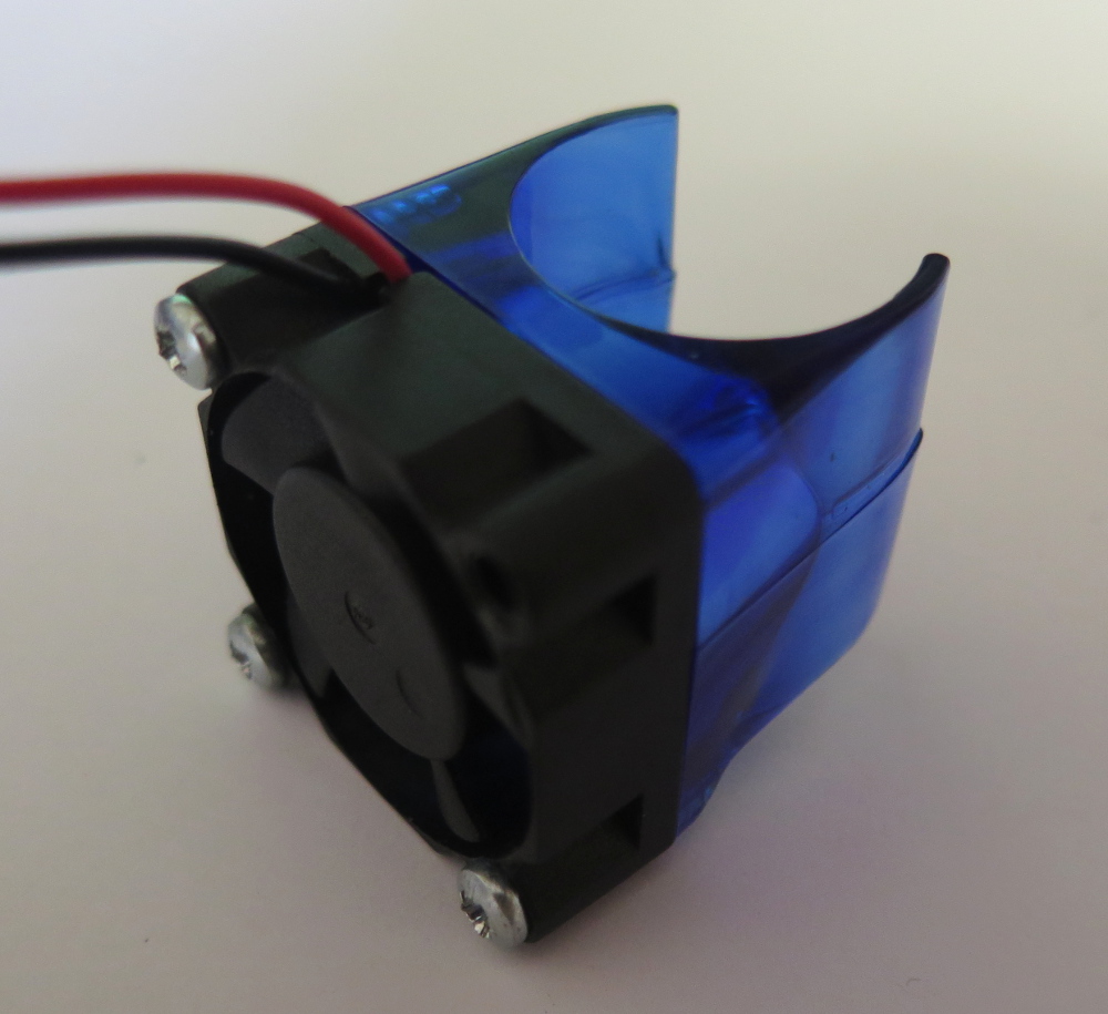

The one negative that I can report has been true of all the E3D models and other
HotEnds. Because of the "peek" fan, the hotend does not extend very far from the
bottom of the effector and to use the effector mounted layer fans it the HotEnd
needs to extend further down. This is not the fault of the HotEnds, it is something
that needs to redesigned on the printer.

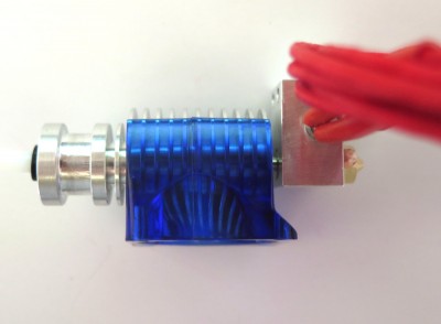

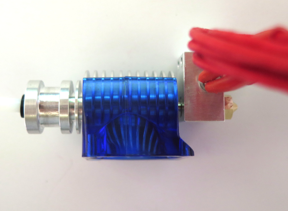

I have included as attachments some pdf files that are mechanical drawings of the V6.
Also included are a few pictures of the V6. You will probably notice the V6 is
shorter than the V5 and here are the numbers.
V6 Direct HotEnds are 7mm shorter than V5
V6 1.75 Bowdens are 20mm shorter than V5
V6 3mm Bowdens are 23mm shorter than V5
If the other Beta Testers experience what I experienced with the E3D V6, E3D has
a clear winner on their hands and is the best HotEnd I have ever used.

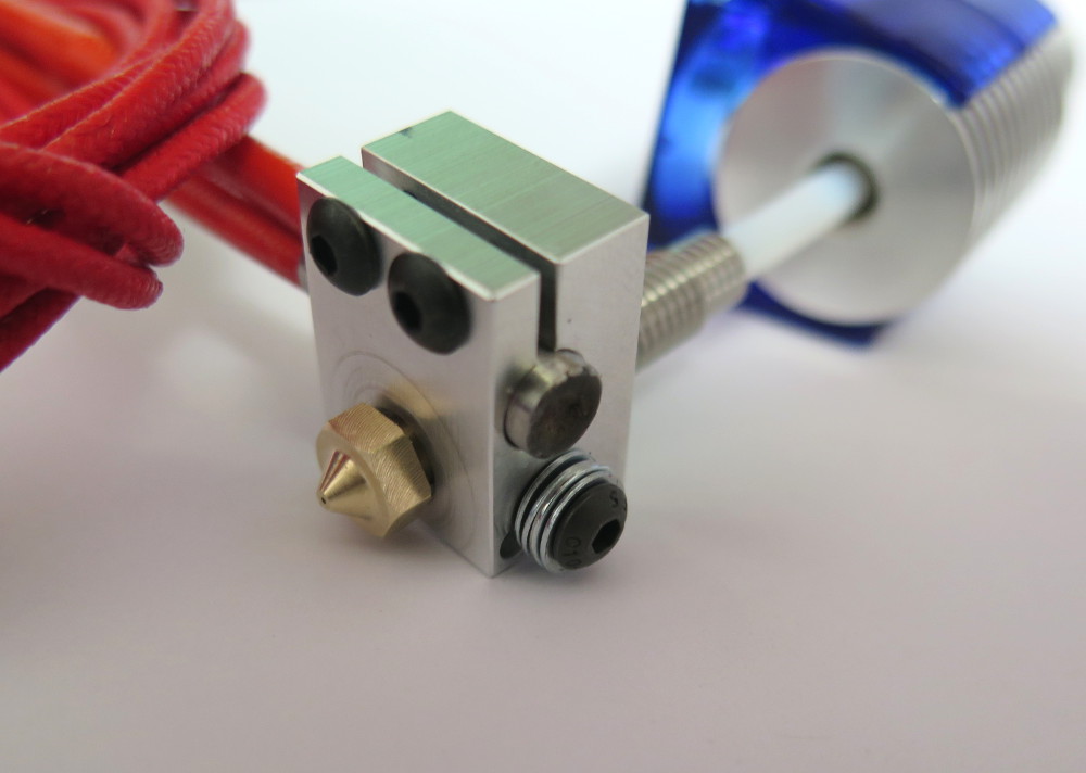

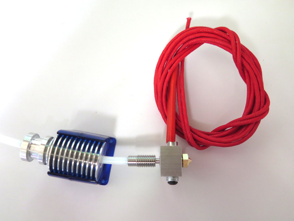

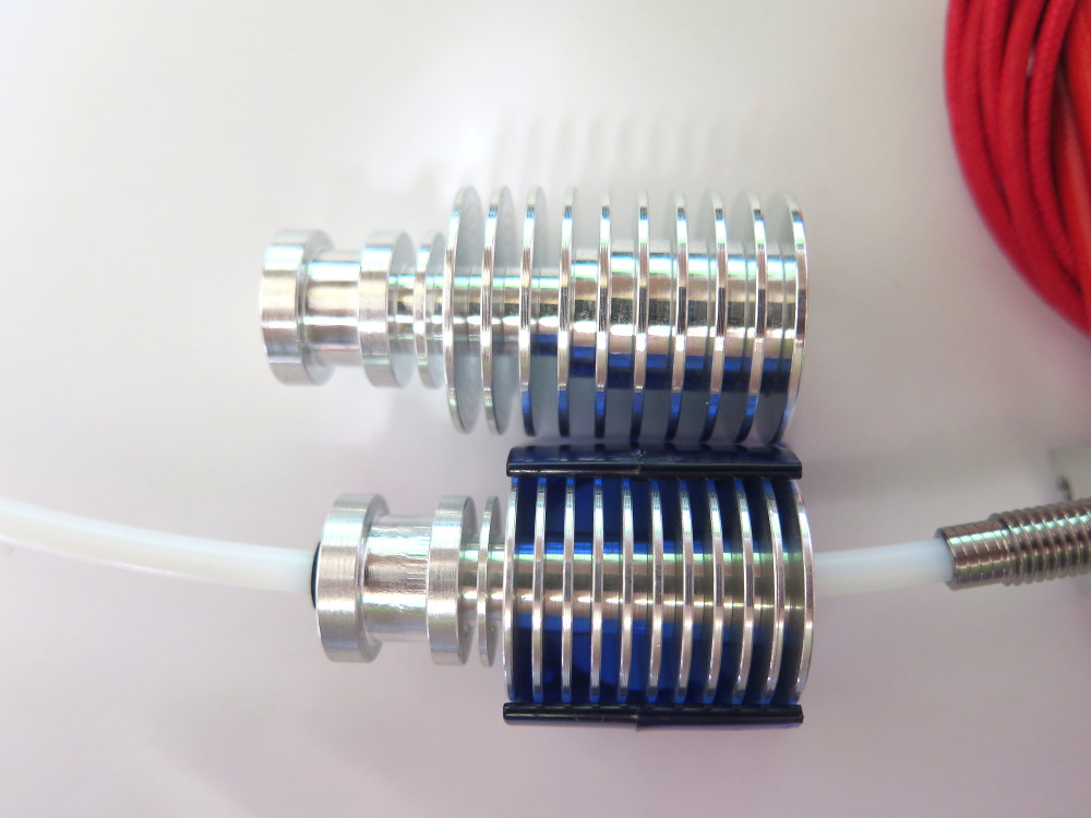

Re: E3D Release New Version 6 of HotEnd.

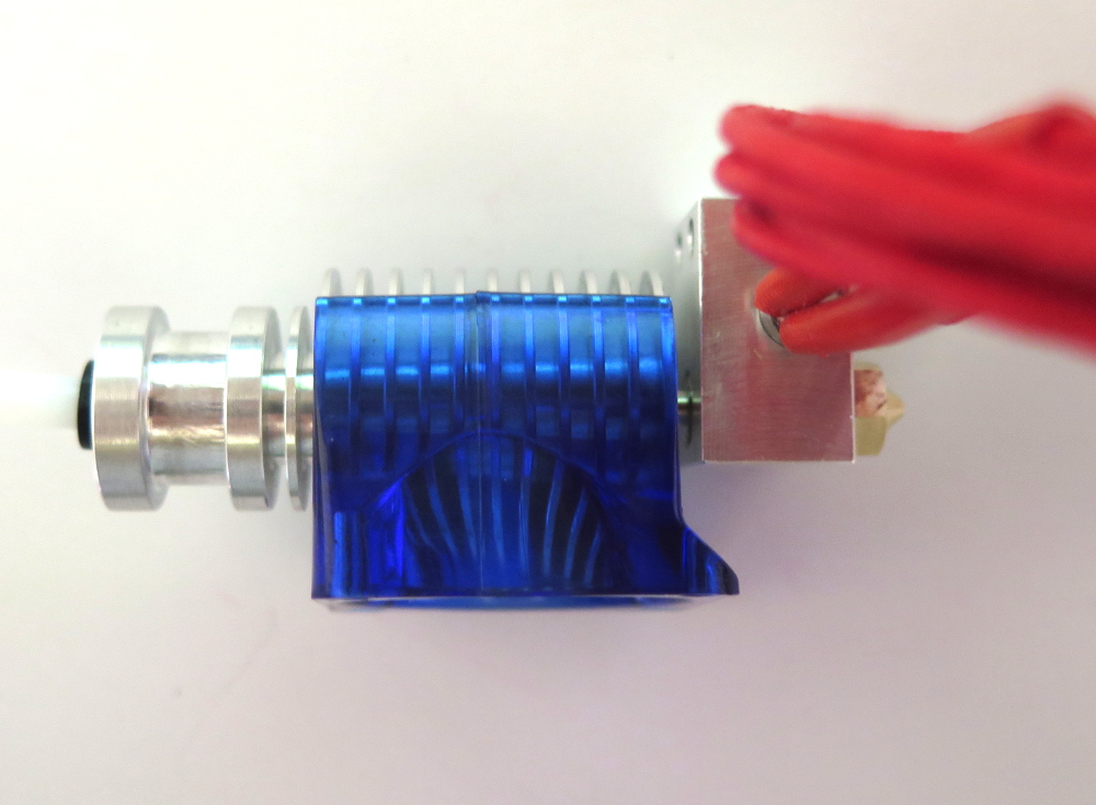

Some pictures to go along with the text.
You notice there are two small screws to tighten and hold in the ceramic heater.
The other small screw is to hold the insulated legs of the thermistor.

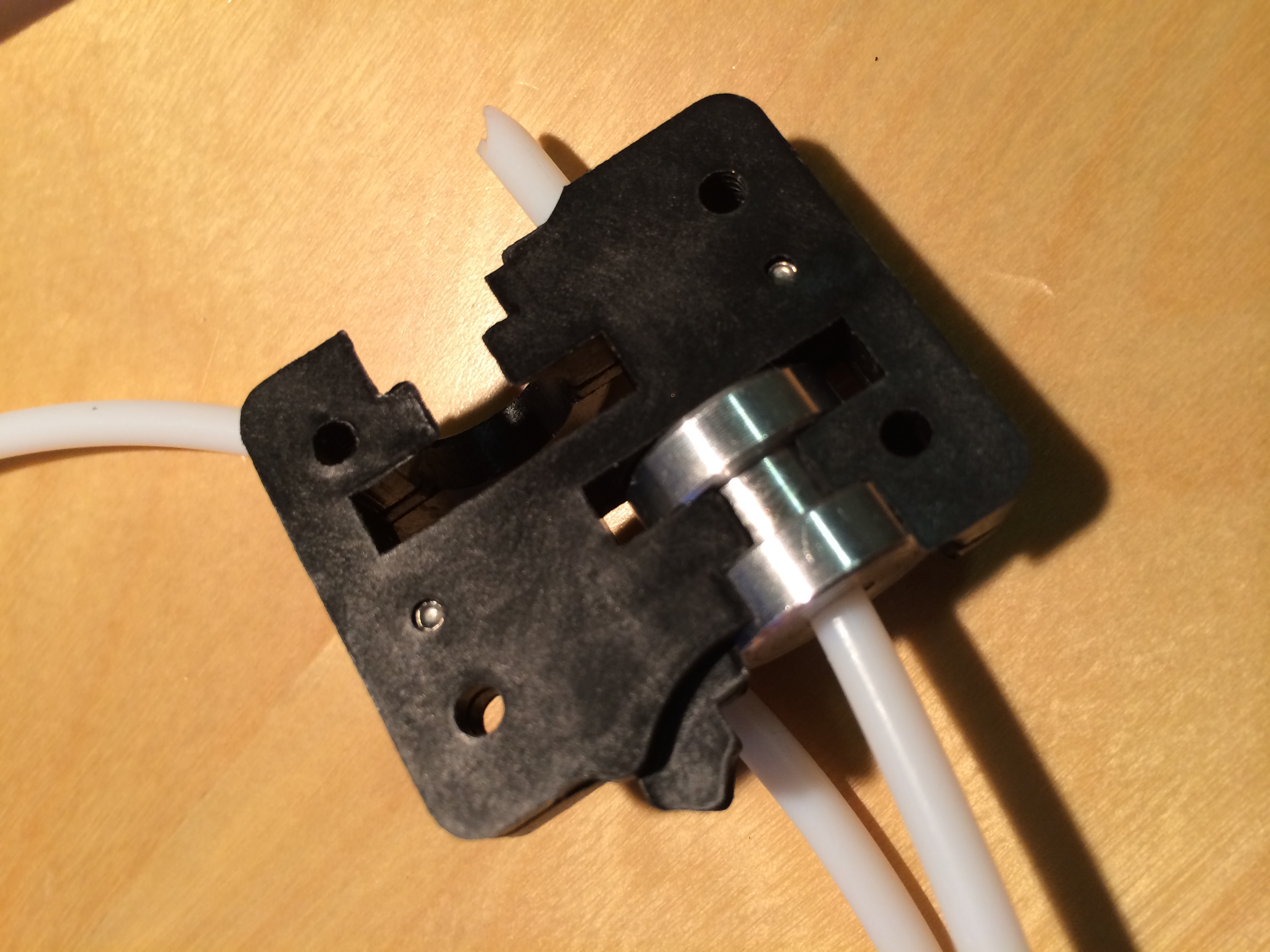

Yup the PTFE tube goes right into the HeatBreak, but the PTFE passes off the filament to the break while it is still in the cold section of the hotend. This means that you're getting all metal high temperature performance with no chance of PTFE meltdown or cooking, but still PTFE lined for the vast majority of the filament travel. There is no heat anywhere near any plastics, the only hot parts are all still metal. Call it what you will, it works!
Much of the reason for the increased ease of extrusion is down to the HeatBreak finishing process which is completely changed. The next big factor is the change in nozzle geometry to reduce pressure needed to extrude. This was discovered and researched by Michael Hackney, so much credit to him here. The two factors of the HeatBreak finish and the Nozzle pressure actually interact with each other in interesting ways that I'll elaborate on in the future.
The Bowden couplings are now completely internal - you can see a total run down of design changes here: http://e3d-online.com/index.php?route=e ... blog_id=21 which details the internal couplers. The new internal couplers use the same fantastic plastic collet with the steel teeth that grip the tubing as the old couplers, so grip and durability are the same, size is just smaller.
We still supply the plastic couplers for the other end of the tubing in bowden kits, and you can order them separately through the site as an individual item if you have another need for them.

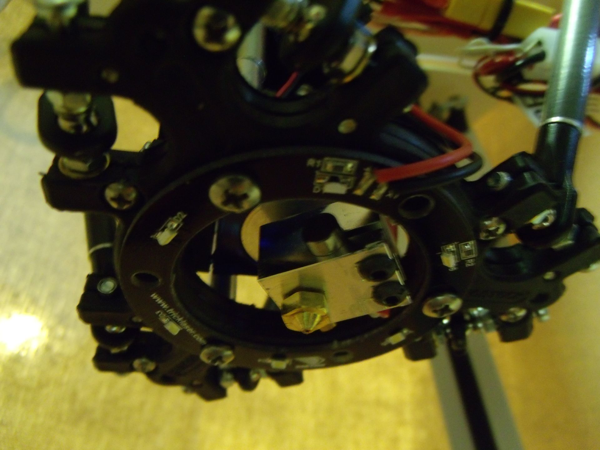

jmpreuss
Posts: 182
Post by jmpreuss »

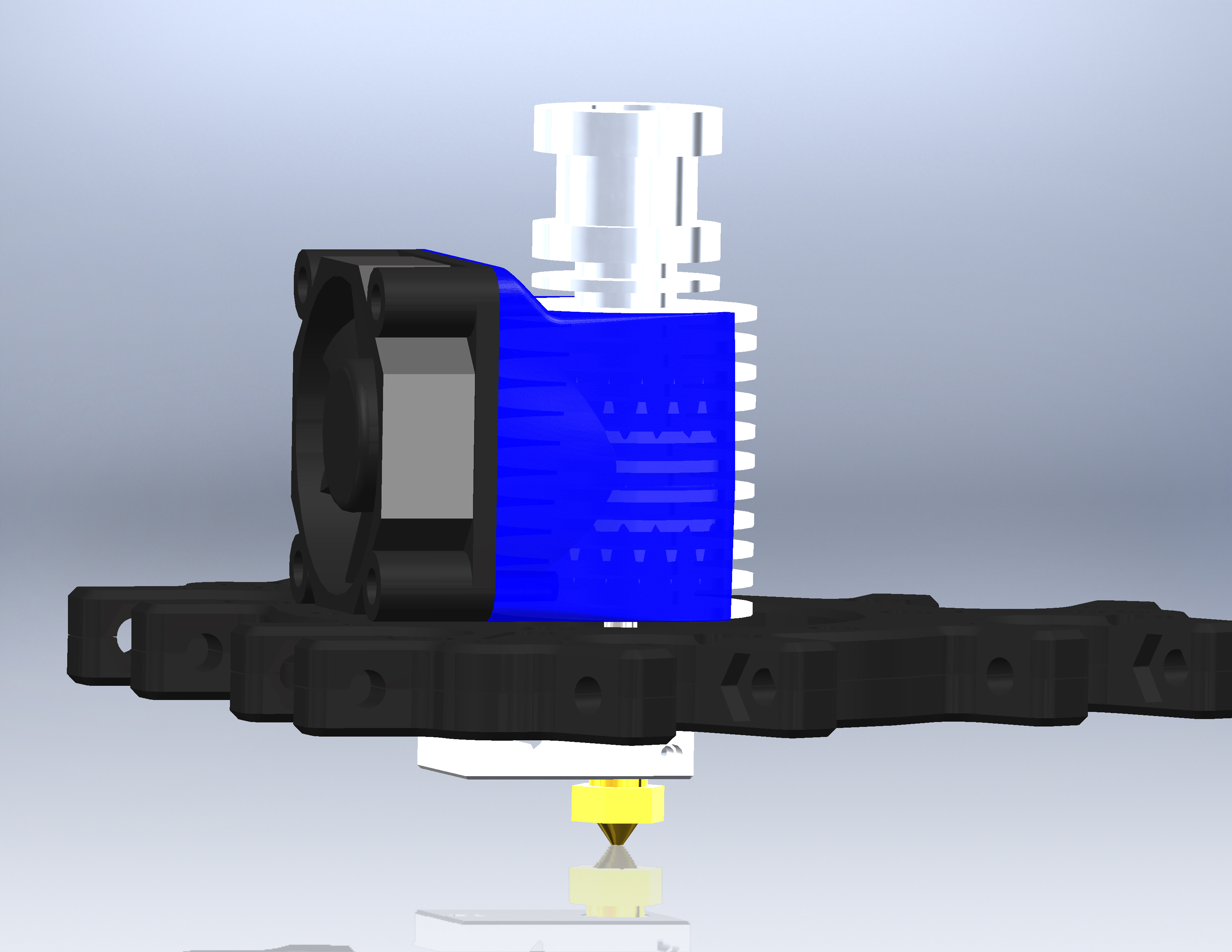

Eaglezsoar wrote:Good News! E3D has announced the release of the Version 6 of their HotEnd!...

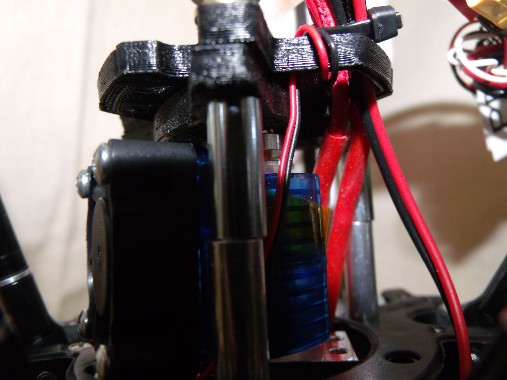

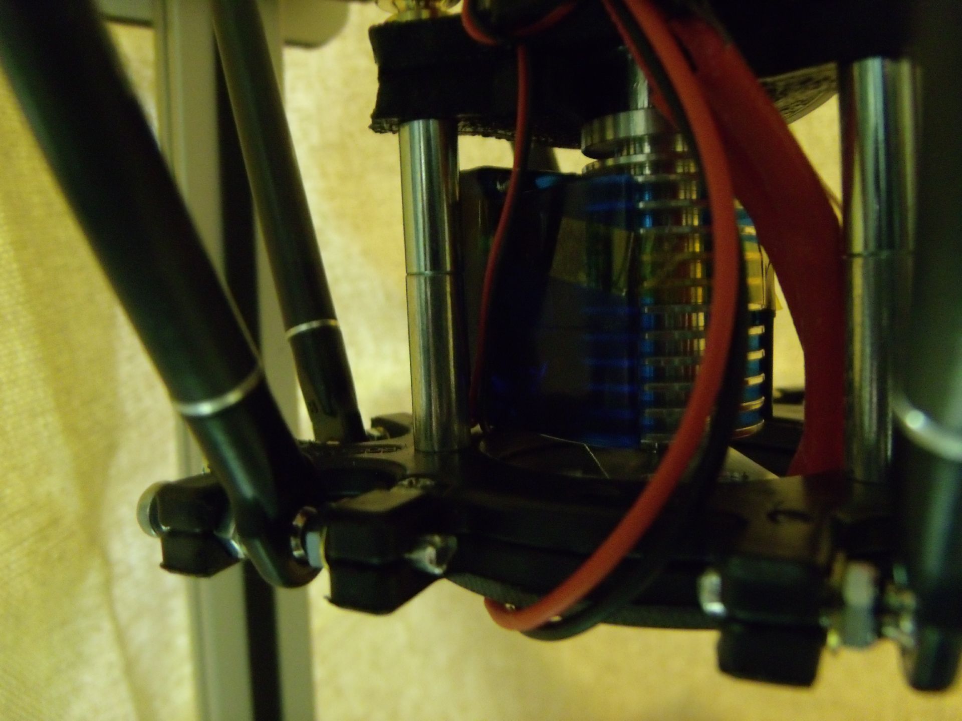

Eaglezoar- Could you post some pictures of this installed on your Orion? I bought 2 (one for my Max and one for my Orion) and it would be helpful for me to see how you have it set up as I prepare for my install. This goes for anyone else that has one. I am pretty good with step by step instructions, need all the help I can get when I get a closer to the cutting edge.
Here are a few, the spacers add up to about 1.5"

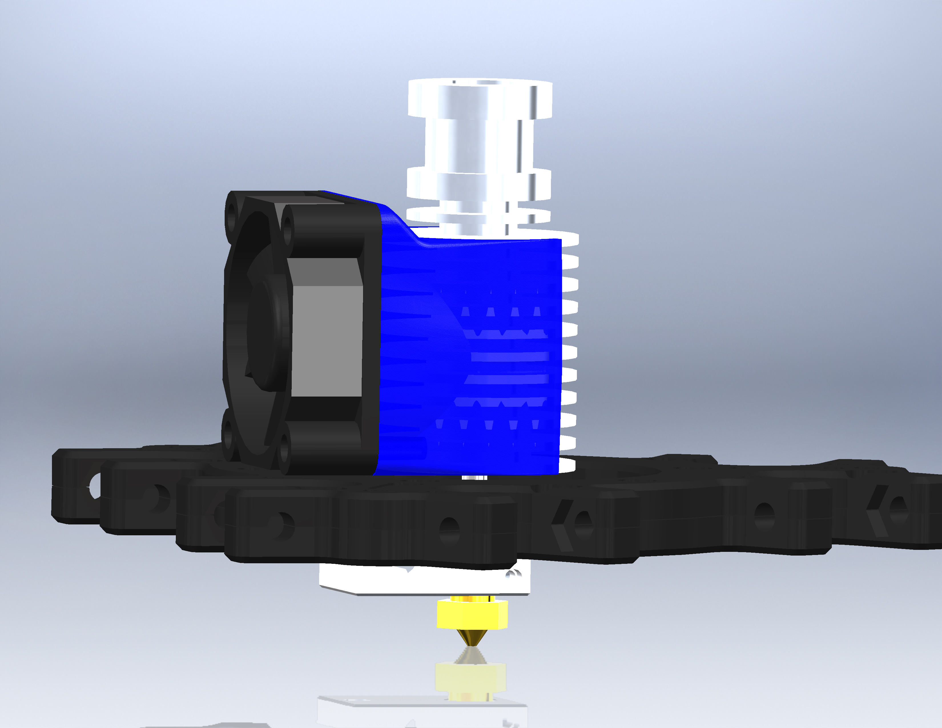

It should protrude thru a decent amount if you flip the duct 180 (e3d's site says it can be mounted in either orientation), I noticed it because I went and modeled it up and mounted it on the Rostock Maxx V1's platform to see if I could come up with a solution for it for when I get mine and it protruded thru plenty, then noticed you had your fan duct in the flipped orientation.
The v6 thermister mounting is much nicer now. I chose to use it rather than a screw-in thermister and it is very easy to install and secure. Nice and simple.
Shizuma wrote:
Eaglezsoar wrote: The one negative that I can report has been true of all the E3D models and other
You are correct and I never noticed that when I mounted mine. Thanks for bringing that to my attention.

I wonder if some of the benefit is from the improved fan duct. I designed a new one for the v5 hot end that focuses on washing the very bottom fin, which I think is exponentially more important than any other. (In fact, I think the heat sink could be half its current height and work just as well. If the bottom fin is room temperature, what are the rest for?) Exhaust air is ejected out the side and two vents on the back, but kept AWAY from the heating and temp wires from the hot end so that it doesn't wind up getting redirected towards the hot end. I theorize that a lot of these hot end jams are because those wires are causing fan air to cool the hot end directly! After installing the new fan duct, duty cycle went down by about 10% (reflecting less exposure of the hot end to fan air) and there have been a lot fewer failures. It's still a pain on the 0.25 nozzle, but reducing speed tends to fix that.
