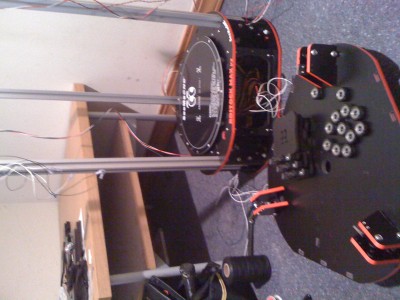

The build is coming along nicely. I sanded off all the crappy paint and started over. It's looking really nice now!!
Build - day 1
Build - day 1
One question: in putting the sleeves on the cheapskate bearings, almost all of the sleeves have small pieces of the top/narrow edge coming off. I believe this is called flashing and is a byproduct of the manufacturing process...but I'm not sure. Should I just trim the pieces off, or are the sleeves defective?

Re: Polly's Rostock MAX build
Posted: Fri May 02, 2014 6:05 pm
by Eaglezsoar
You are right, that is flashing and is normal.
