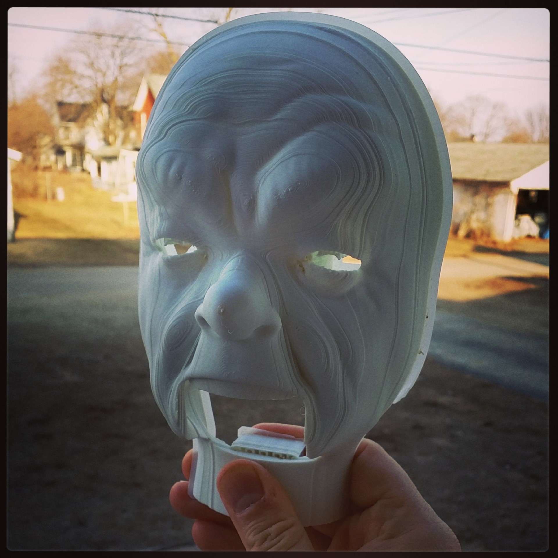

Hi Folks,
While I'm pretty happy with how this print turned out. There was issues with it sticking to the bed. It peeled up around the neck. Do you think that is what caused the poor registration? That was my thought. The head may have been hitting the print knocking it back and forth creating these exaggerated ridges. If you look at the tip of the nose it has excellent registration and there is no course ridges there.
Does someone out there think that it might have been caused by some other problem? I'd love to hear your thoughts.
Edit: It truly says something when you can FAIL a post in the FAIL section! I have uploaded an image for your review!

It seems that your carriage is being shifted out of position for a couple layers until it comes back in to where it should be. There's a few ways can happen. It could be anything from slop, nozzel catching a tiny bit, or just skipped steps, to a few more problem areas.
I would suggest:
Check your set screws on you're pullies.
Check the belt tensions on each tower, you want them equal.
Check the arms and carriage for any of the delta arm blues related issues.
If all those appear to be fine, there are two likely scenarios at play. First, you may require a small fan or heatsinks on the stepper motor drivers on the RAMBO board. They can trigger their thermal protection and skip steps that would otherwise be sent to the motors. (there's also thermal protections on the motors themselves, but those are less likely to be the issue) You can also turn up your stepper current limits in your firmware and re-upload it. Going over 190 in settings is very likely to require cooling on the board to ensure the thermal protections aren't triggred. Turning up the currents IS a cover up solution, there are units with the motor current settings down to 130 running well.
Turning down your jerk setting in the EEPROM may alleviate the issue as well (for testing set it to something like 4). If it clears up with that we'll be happy to go through finding the source of the issue so you can have it at a better value as well. Lowering your speed and acceleration are other values to change to see if it clears up, but again we'll do our best to help you have those at practical levels.

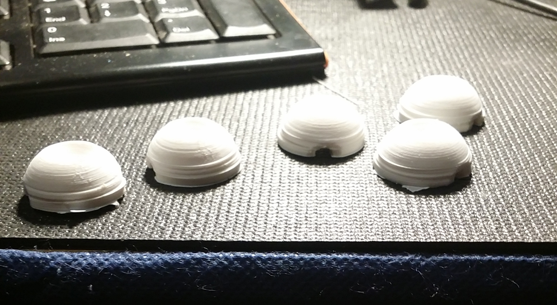

So I have been working on trying to get the ridges out of my print with little success. I have found some issues that needed to e fixed along the way, but nothing that gets rid of the error. The first problem I found was that the bed was super loose. Two of the blind nuts had stripped and weren't working. So I replaced those thinking that had to have been the problem. Nope. I also then checked the belt tension. Sure enough they were not all equal. At first I over tightened them, and was having prints that would crash Repetier. I loosened up the belts and that went away. I checked the set screws for the timing pulleys and they were fine. I added a fan to blow air on the RAMBO during prints, changed the current settings for the motors in firmware and lowered the jerk settings to 4. I'm pretty positive I don't have any of the Delta Arm Blues. I purchased a depth gauge when I upgraded to the Trick Laser Carbon Fiber Arms a couple of months ago. I have the Delta Radius dialed in pretty good. I'm looking for any other ideas to try. I'm going to try and post a photo of some test prints that I have made in a little bit here. Any ideas are greatly appreciated.
All the best,
Steve
Re: Ridges in print.
Posted: Mon Apr 21, 2014 8:09 pm
by grasshorse
Here is a photo of the aforementioned test prints.
Steve
Posted: Mon Apr 21, 2014 9:28 pm
by Eaglezsoar
Steve
Have you made certain that the cheapskates are not too tight?
Posted: Tue Apr 22, 2014 12:25 am
by grasshorse
OK, I gave that a shot. In twisting each of the cheapskates I could feel that one of them could torque a little. So I turned the casters to add a little tension and remove a little slop in it. I then loosened up all of the cheapskates (the screws between the belt clamps) so they could move a little easier. Alas, the newest test print still has the same problem.
What I don't understand is how this just "shows up". Have others had this problem as well? Do I need to do a rebuild of the machine. It seems like I did that not so long ago as I mentioned before.
Is there something in the firmware that may be causing this? Could it be the slicer? It makes no difference if I use support or not.
Most of the speeds are around 27mm/sec with the exception of travel. If it will help I can do a screenshot of the speed settings.

Thanks for your ideas! I'll give them a shot. I tried a much simpler print of a cube and it printed much better. There was one big ridge, and then some noise on two of the four vertical sides. I have the trick laser arms, so I wouldn't expect them to be much fiction there, but I will take them off and have a look. Anyone think putting graphite on them would help? I think the z-lift is a great idea. I'll up that and see if it helps.
