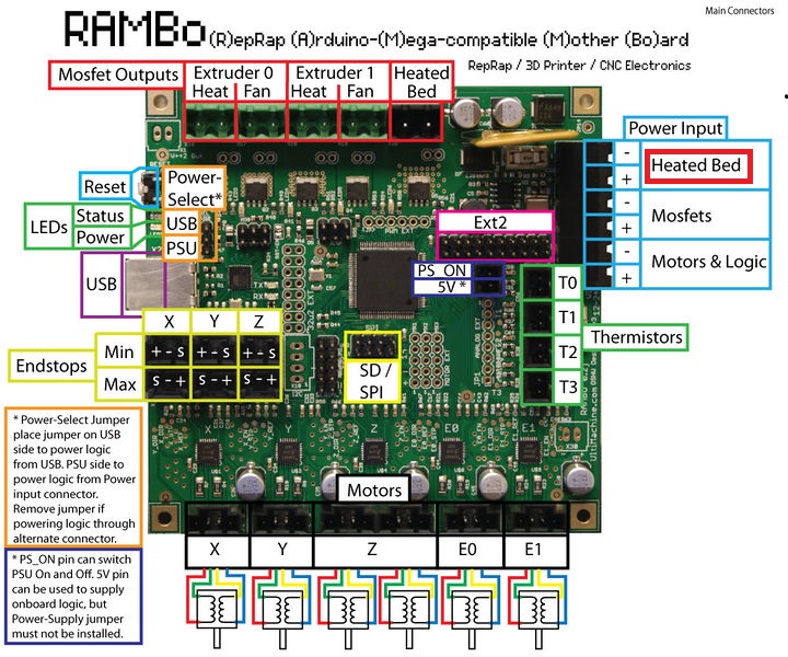

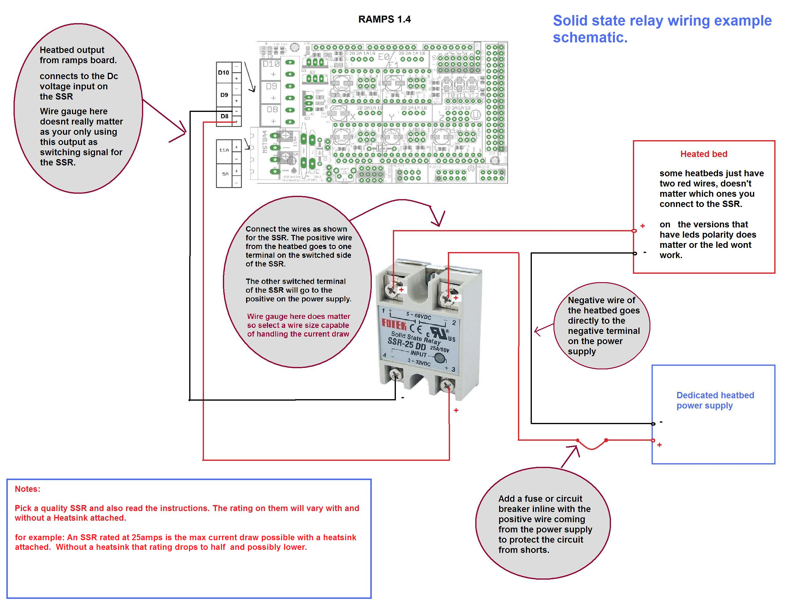

I got an additional power supply but I'm not sure I'm going to wire it correctly, does anyone have a wiring diagram?

by cambo3d
grimmindustries wrote:I got an additional power supply but I'm not sure I'm going to wire it correctly, does anyone have a wiring diagram?
having an additional power supply isn't going to do much unless its an 18- 24v supply. Just adding another 12v supply (assuming your adding another 12v supply) will net you nothing because its still 12volts. You need more voltage to get more current going through your onyx in order for it to heat up faster.
I run mine with a dedicated 24v power supply and ssr. heats up to over 100c around.. 5min. http://forum.seemecnc.com/viewtopic.php ... =24v#p7627
as far as the wiring goes here's is an example using an additional 24v power supply just for the heated bed.. (the 12volt stock power supply is still used but not for heated bed power) This shows a ramps board but the idea is the same......you use the output for your heated bed on the rambo board to control your solid state relay. The power for the ssr is strictly through your dedicated source to your heat bed.

by grimmindustries
Thanks, I did get a 24v power supply and when I wired it directly to the Onyx it heated up super quick but then it didn't stop heating up. Do I just add the power supply inline with the existing power supply?
Re: Onyx Temp Limit
Posted: Tue May 06, 2014 7:52 pm
by grimmindustries
I see what I did wrong. I connected the new power supply through output instead of input. :(
The new 24v power supply is great, it didn't even take 5 minutes for the Onyx bed to get to 100 degrees C.

Ohms law says that current = voltage / resistance.
If the voltage is 12V and the resistance of the bed is 2 ohms the total current is 6 amps.
If the voltage is 24V and the resistance of the bed is 2 ohms the total current is 12 amps. I don't know how you say the current would go down.
In actual practice, the current to the Onyx with 24V is approximately 17 amps, if you plan on using the Rambo only you would need to increase the fuse value to 20 amps.
I use the DC-DC SSR because I do not want to run that much current through the traces of the Onyx.

Most of us used these:
http://www.ebay.com/itm/Meanwell-Power- ... 3f35668a64
http://www.ebay.com/itm/1pcs-Solid-Stat ... 2a3b6a9c05
And a heat sink for the SSR from Ebay or Amazon

Before spending all that money on a 24V power supply and an SSR, have you tried adding another pair of 18ga wires from the Onyx Rev3 to the RAMBo yet?
