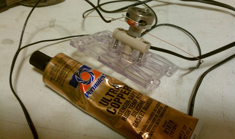

Does anyone have any pictures or know of any pictures that would help me assemble the hot-end ...? Specifically about how to wrap the resistors with aluminum foil and then positioning them...? Also how to secure the thermistor with the adhesive? What kind of adhesive should I use specifically?

The H-1 Assembly Manual walks you through it. I am working on photos to add to that section and the H-1 Electronics Manual too. Wrapping the resistors is pretty well described in the manual. Insert the thermistor and then squirt a dap of silicone on it. Don't put silicone in first, it can actually act as an insulator, you need the thermistor to contact the aluminum (but not its leads!). The adhesive is also described in the manual - high temp silicone, you get it at auto parts or hardware stores.

Here's a couple pictures pasted from John Oly's Yahoo Groups photos. They really helped me a lot. I've also included his captions
"Use aluminum foil to take up the gap in the resistors and the housing. You don't want the foil too tight, and also be sure to NOT LET THE FOIL roll over the ends and touch the wires. That will cause a short and burn up the heater board. Make sure the screws are in holding the steel cap on before inserting the thermistor. Use permatex "ultra copper" or a similar high temp non conductive sealant. I use permatex because i know it can take the heat, and if I ever need to replace the thermistor, it's rubbery and i can peel it back out of the hole and off the housing! Note the resistors are wired in parallel, and make sure the leads can't touch any metal and short out."
"Side view showing the thermistor siliconed in and the clamp screwed down on the resistors. Careful not to crack the resistors by using too much foil, and also you don't want to scratch the green enamel coating either."

Thanks Fiero2M6, I hesitated to post those photos because John solders hide resistor leads. I don't recommend that, they can get hot enough to melt the solder. Use a crimp connector on the leads instead. No sense taking chances!
Otherwise, the photo of the foil wrap is great. As is the thermistor installation. I also (as described in the manual) use a toothpick to spread a thin layer of silicone on the thermistor leads to make an insulating barrier to prevent shorts.
