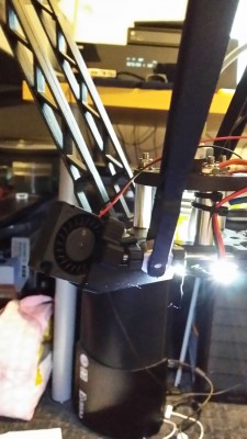

Typically with PLA you'd want to run a parts fan to cool the filament as it's being extruded. There is quite a bit of info and it's easy to find pictures/videos of how people have set up their fans.
http://repables.com/r/171/ - This guy here is the fan shroud you can print to use the squirrel cage fan that comes with the Rostock.
Ends up like so.
Ends up like so.
I had a regular house fan blowing on my prints before I had the fan shroud printed. If you don't cool the PLA, it stays 'mushy'. Particularly on corners.
