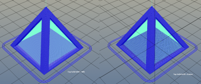

One thing you could try too is to change your extrusion width settings. Even just as a test. Another good thing to do is take measurements with a set of verniers over various points on a few meters of filament then take the average of the readings. It'll help dial in the extruder so it's not pushing out too much or too little.

That's what my settings are for some of my prints. You could changing the widths to 0.6mm; I've read a few guys on here use that number as a safe medium.
Looking back at your original pictures, I'd wonder about the Z-height. That first layer looks really squished flat and if you're getting any ridges from it pushing the material around, the next pass is going to hit knock it loose on the bed. But it is a bit hard to tell, so I may be wrong.
Last thing. You can try pulling up a file in repetier, then use Slic3r (kind of built in) and make some changes to that top layer width. Then go to the 'G-Code Editor' tab and take a look at how the top seems to be filling in. Try a different setting, save and go back. You might find a width or a fill percentage that works better for you.
Testing with top fill to make the prints nicer and more whole.
As you can see in the picture, the one on the left had a much nicer finish to the top layer and didn't leave much room for gaps.
